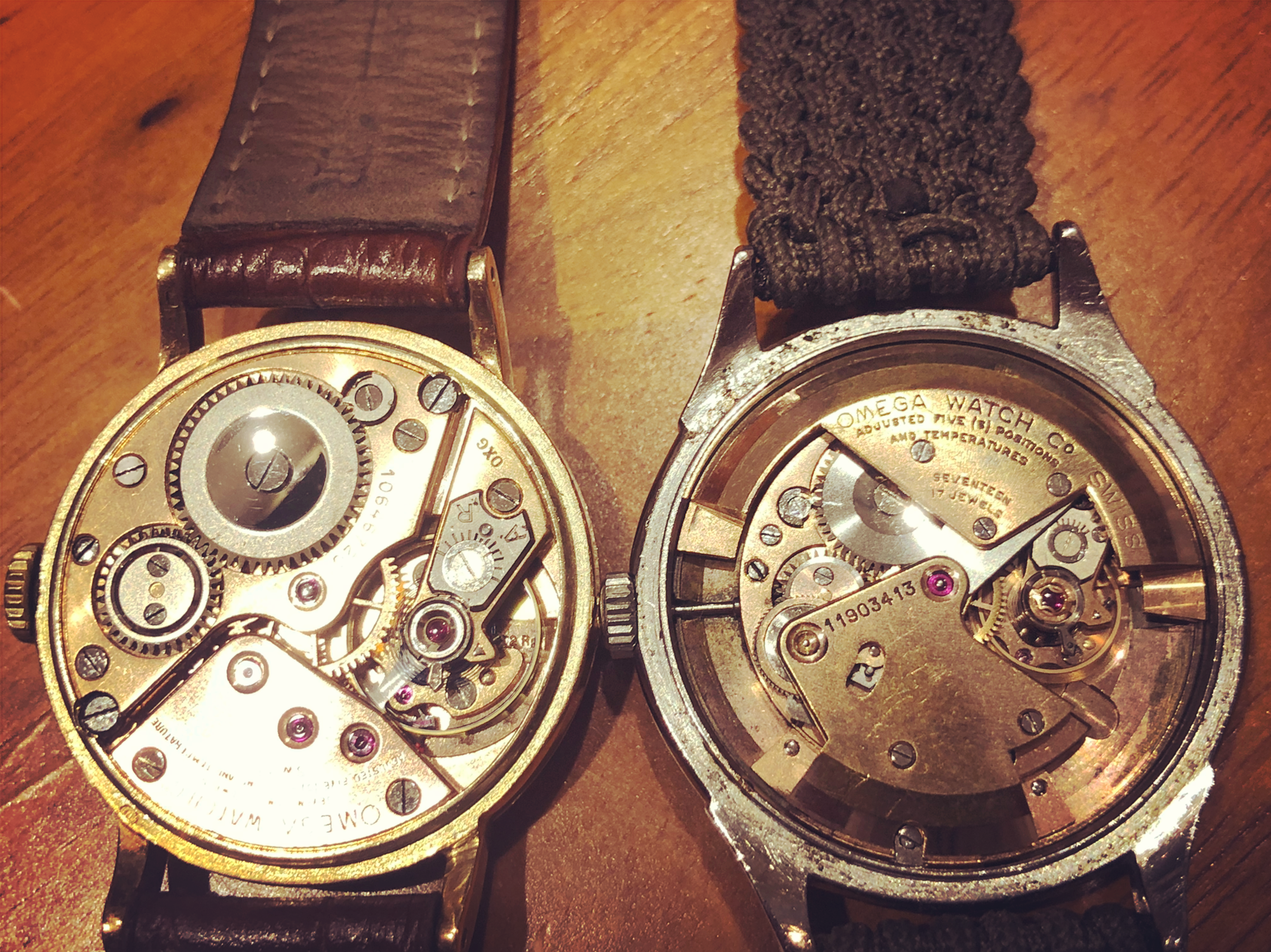

It has been fully serviced. Error when wearing + - 2s / 24h when wearing for cal 333rg and + - 4s / 24h for 30t2rg😀
