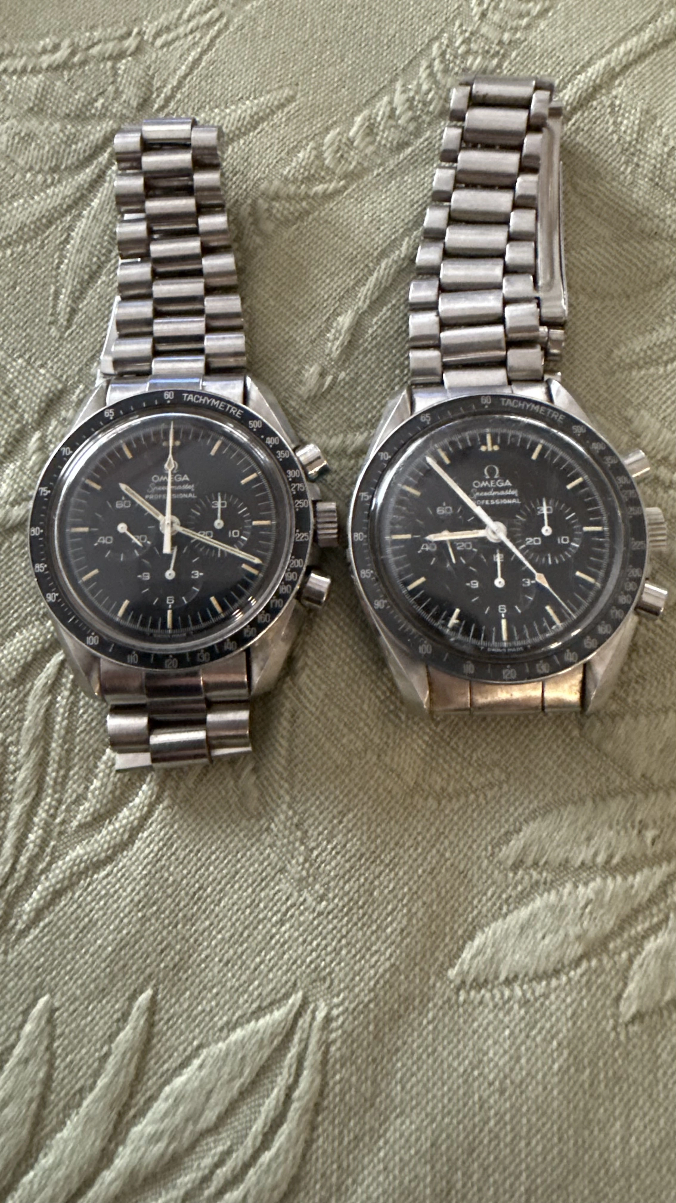

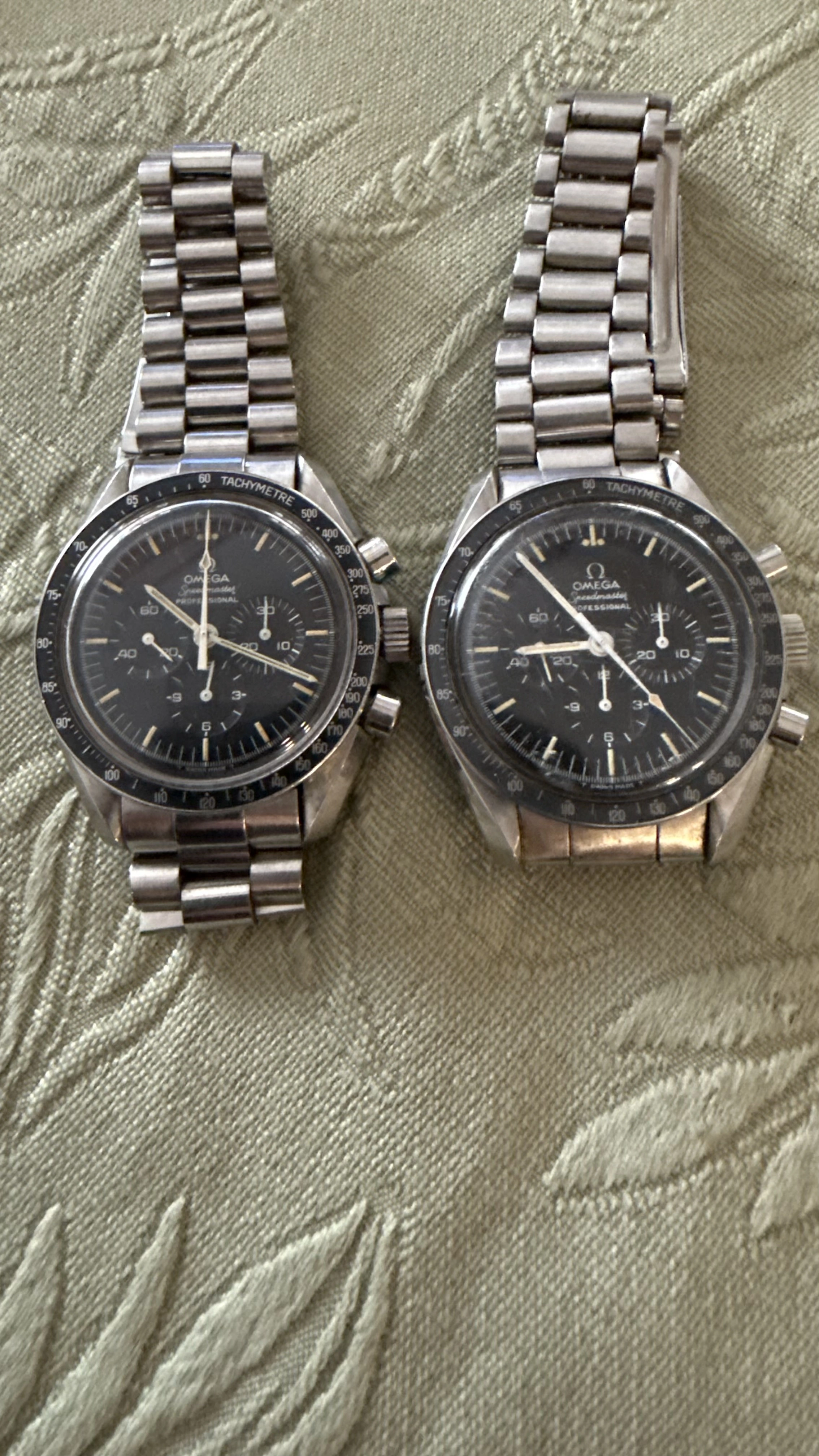

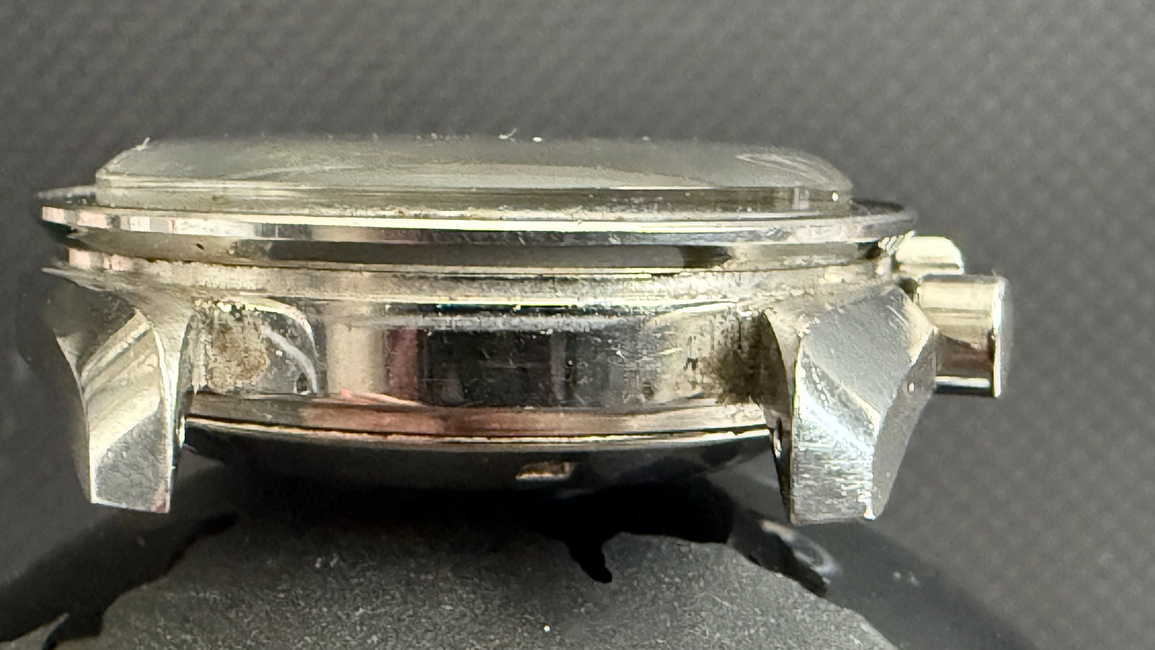

My dad just gave me 2 original 1971 speedmasters. They have been sitting in a hope chest for the past 40 years. He bought them new, one for him and one for my grandfather. One has the original 1171/633 bracelet and works. The other has cheap replacement bracelet and doesn’t work. The stem pulls completely out. He thinks he still has the other original bracelet somewhere. But we all know how that goes. Looking forward to getting the non working one fixed. I plan on keeping one with the original bracelet and putting a nice leather one on the other.

Nice pair! Being Calibre 861 they shouldn't be too much trouble to get in perfect running order again, just try to preserve as many aesthetic parts as you can with the exception of the movement, crystal and probably crown
249
136
Lovely!
Yes, be sure to tell the watchmaker to keep as much as possible of the original parts.
The hands for an example - service hands will look totally off on your nicely patinated watches

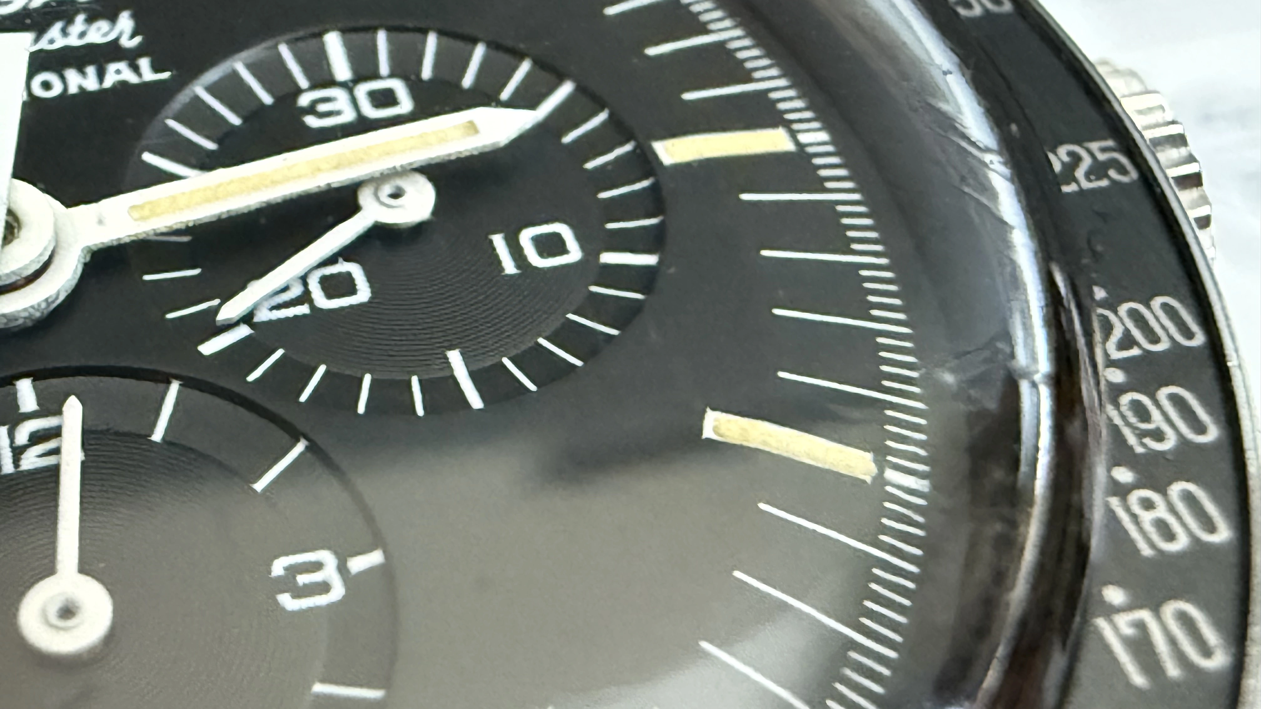

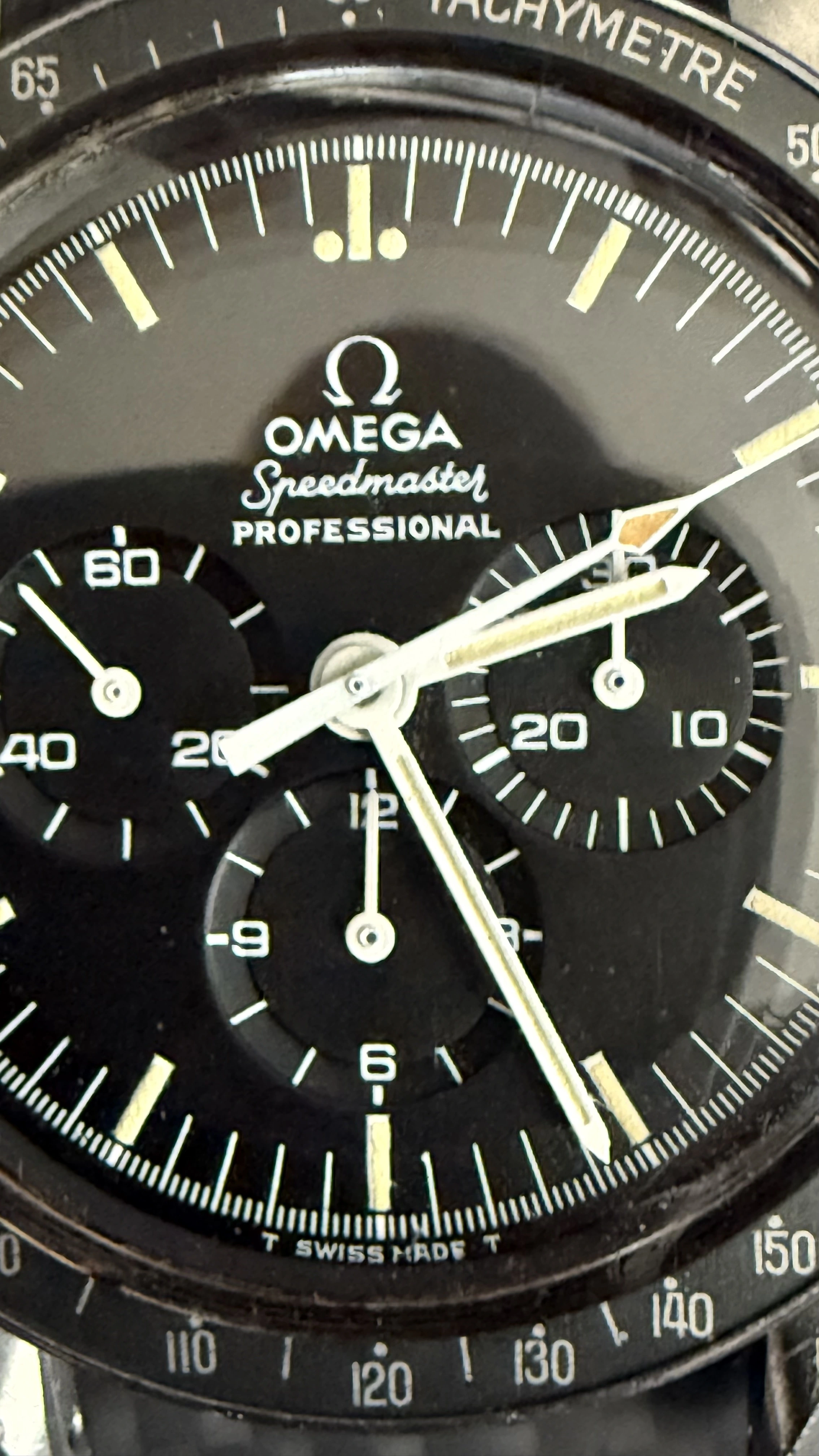

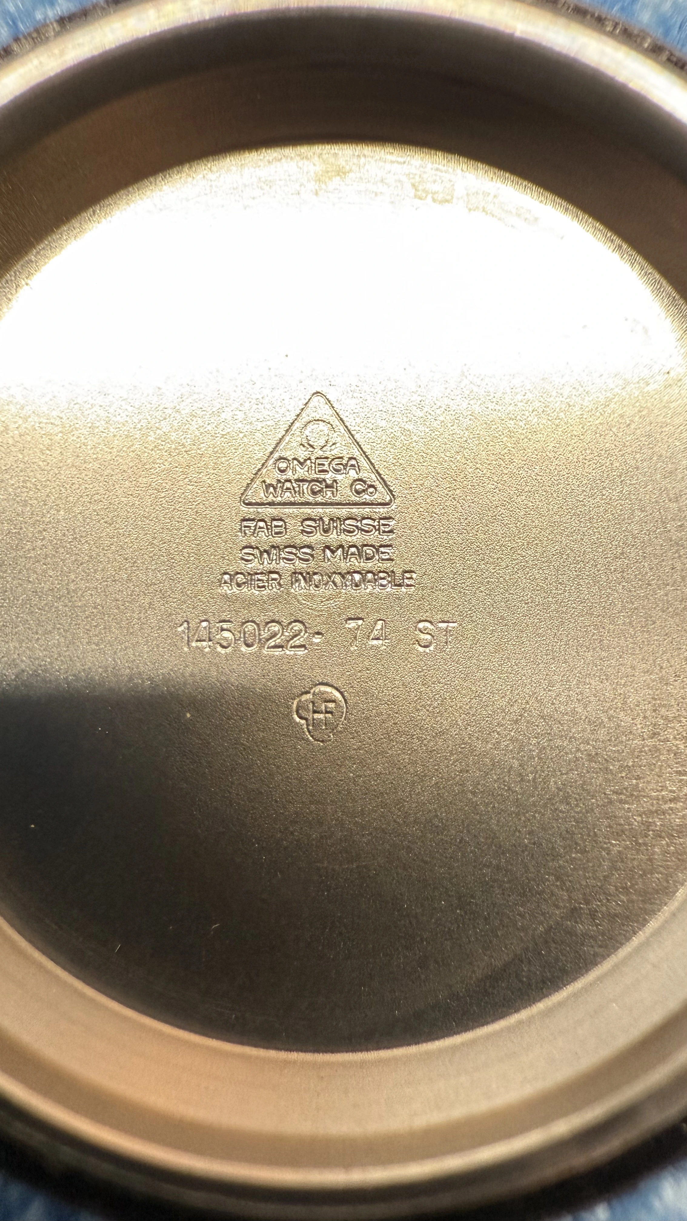

Can you provide a clear picture of the Speedmaster writing on the dial?
Also casebacks?

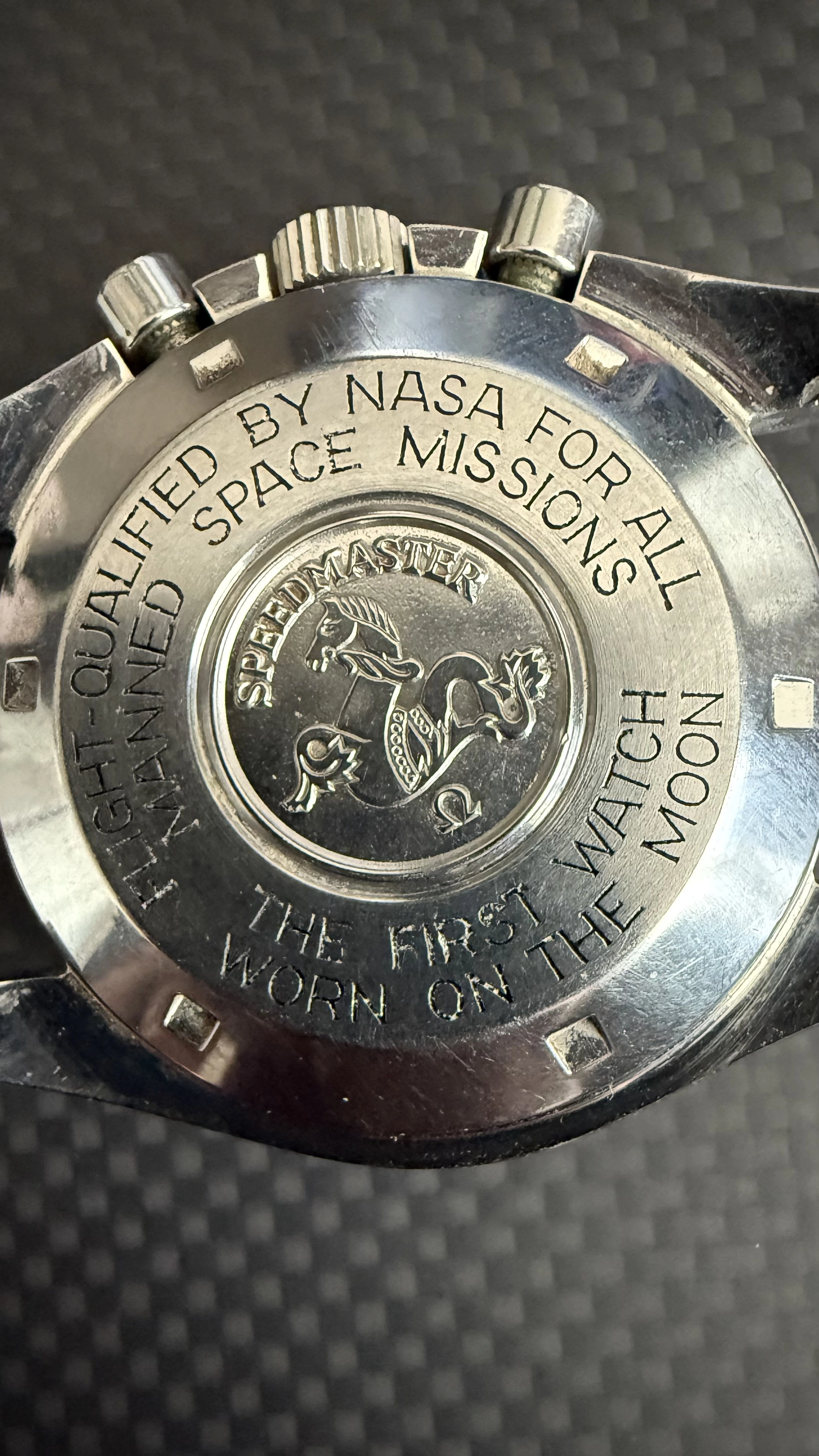

A bit curious - how do you know they are 71´s?

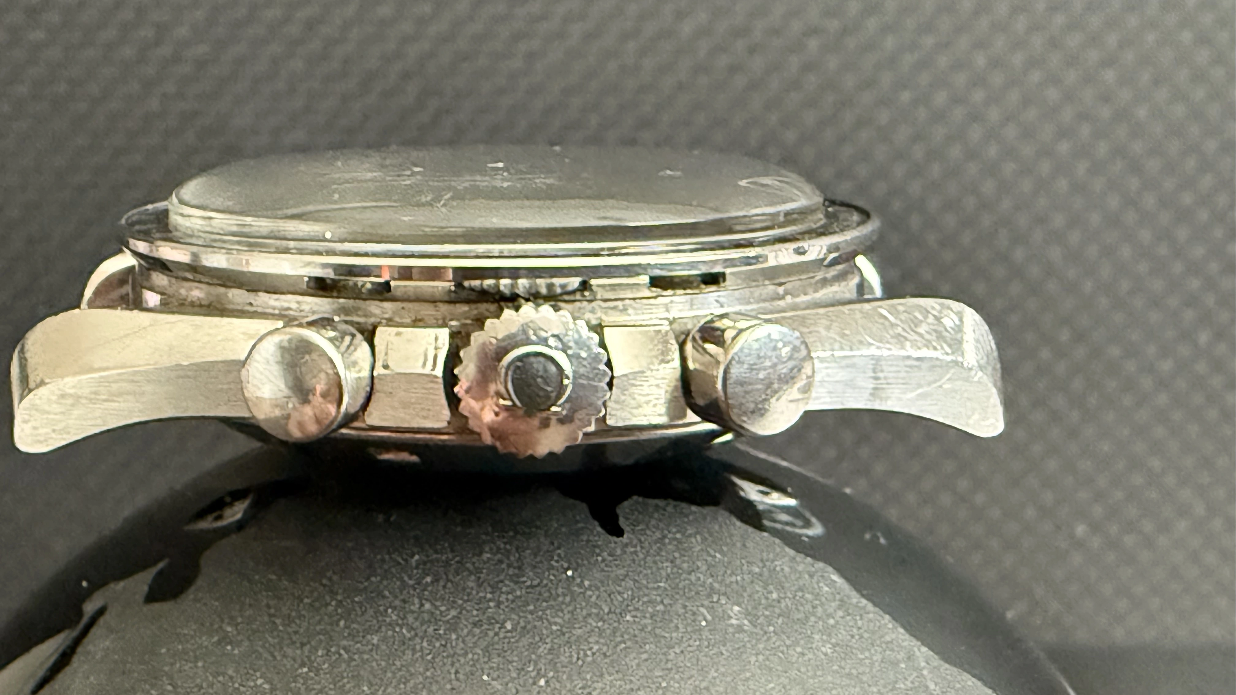

You could also share more pictures - we LOVE Speedy pictures!
I believe 1971 was the first year they put the flight qualified ….. for all manned space flight on the back. My Dad said he bought them in 1971. But you are right, that is my conclusion. Until they are opened and serial numbers checked, I really don’t know for sure.

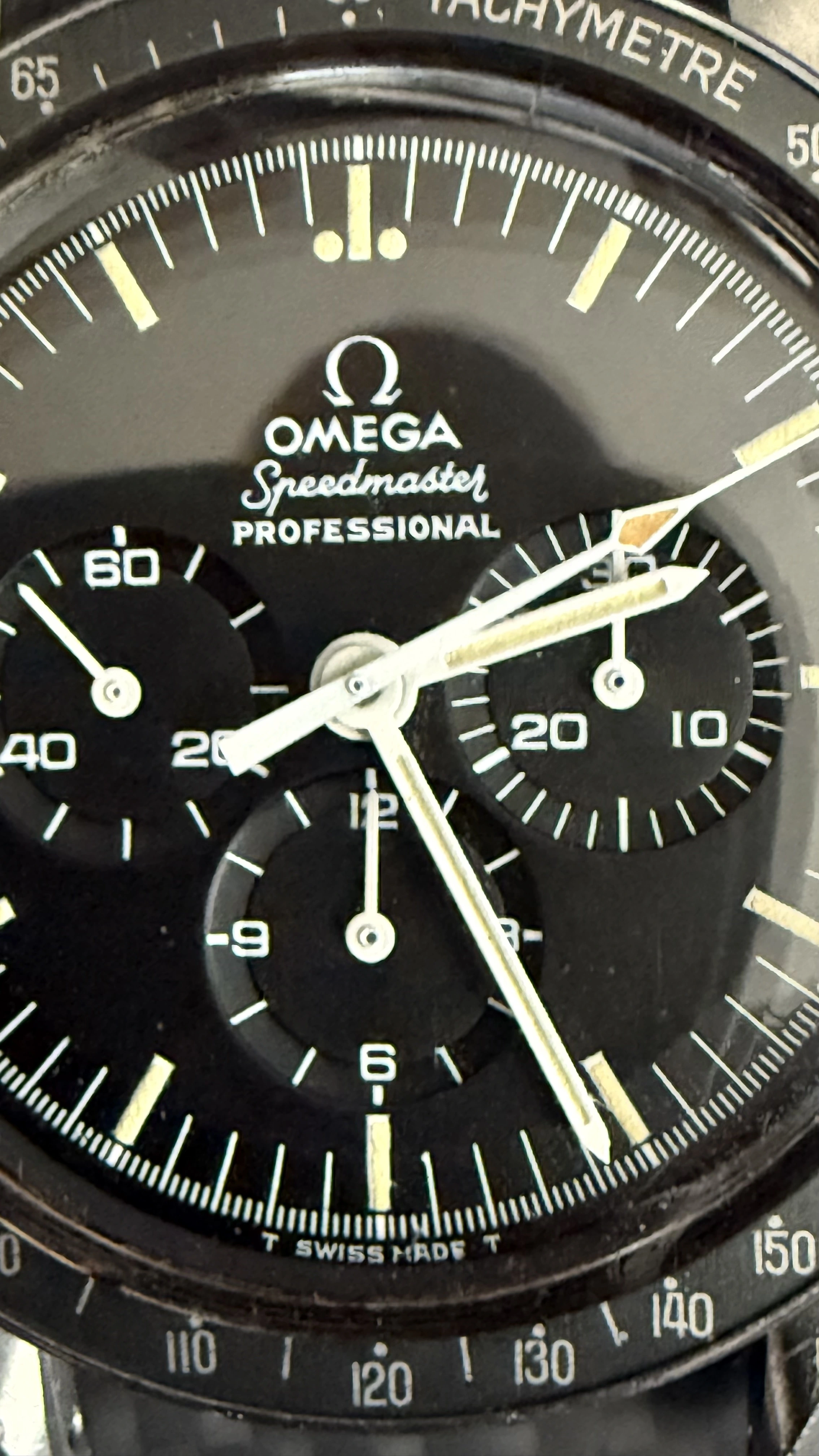

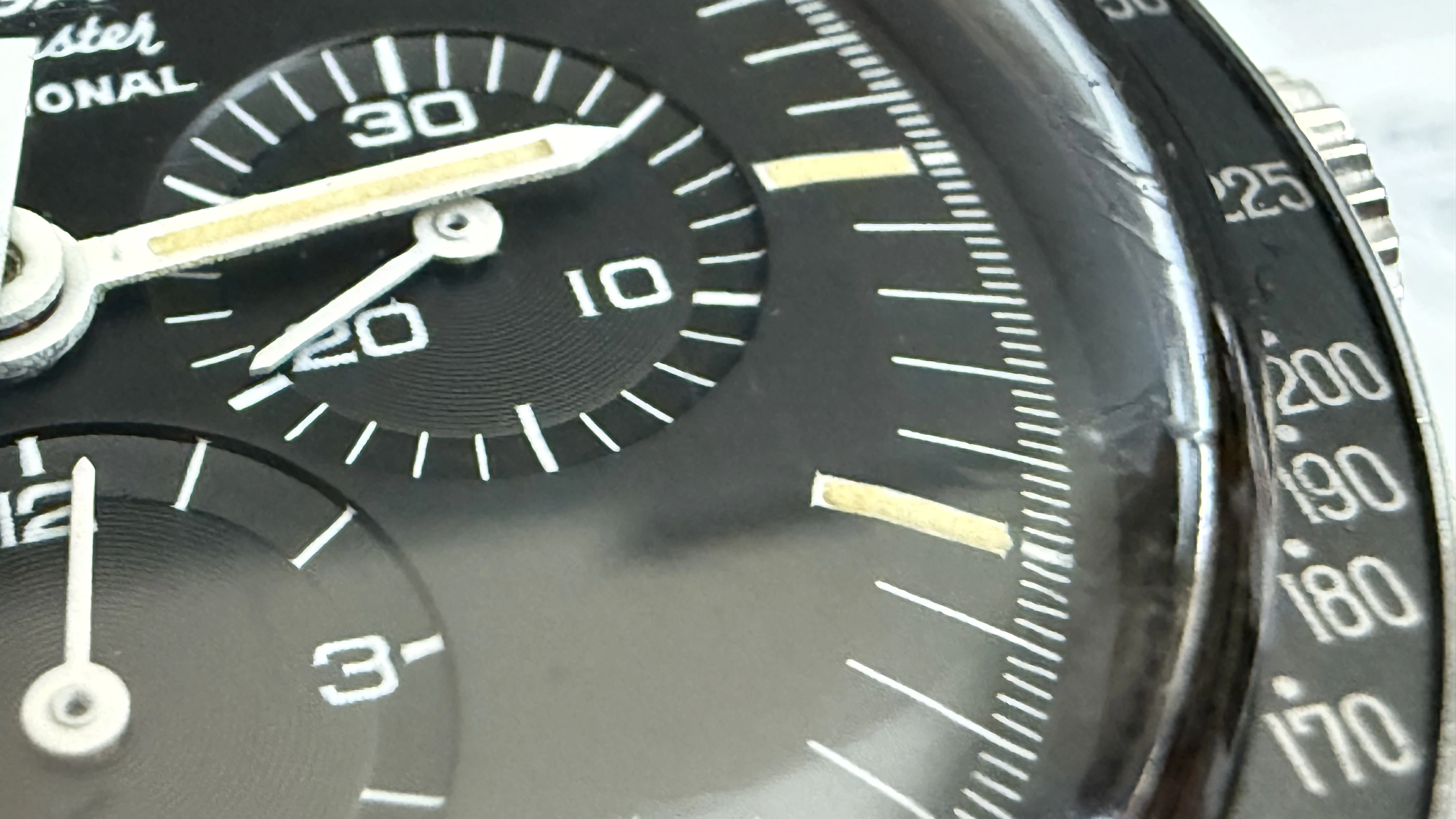

Here is one of them up close as requested. I’m having the other evaluated for repair by a local jeweler that has experience with Omegas. I know I should send it to Omega, but it’s just an initial evaluation.
6,609
26,784
I don’t see a step dial, so this wouldn’t be a -71. And no, don’t send these to Omega. They would not be the best option if you want to keep originality.
12
26

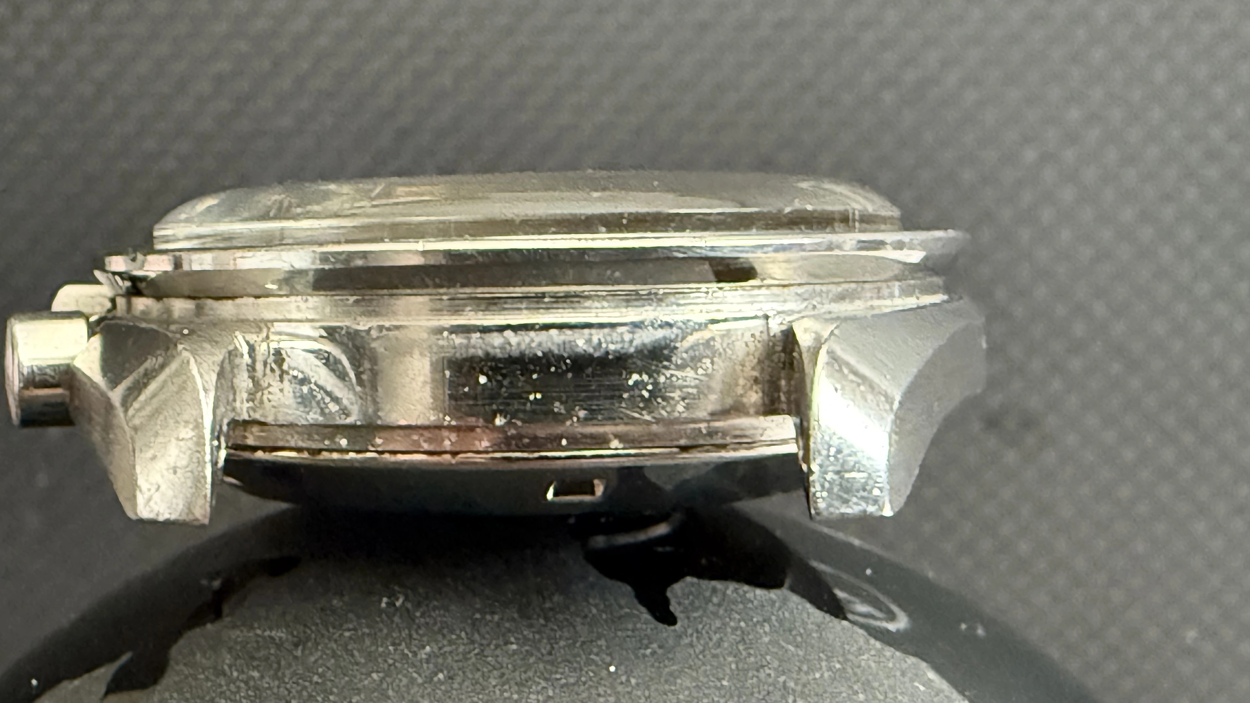

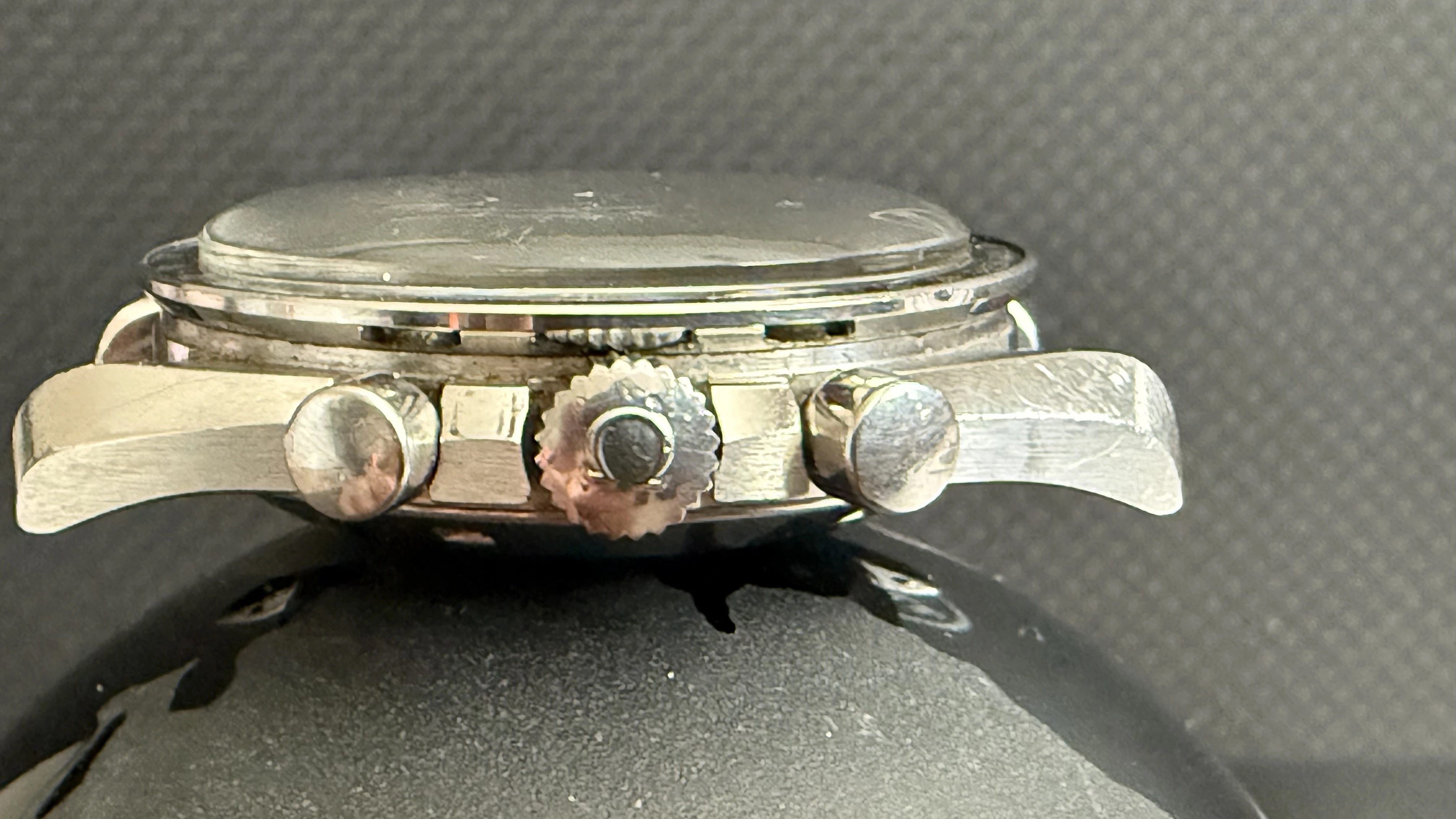

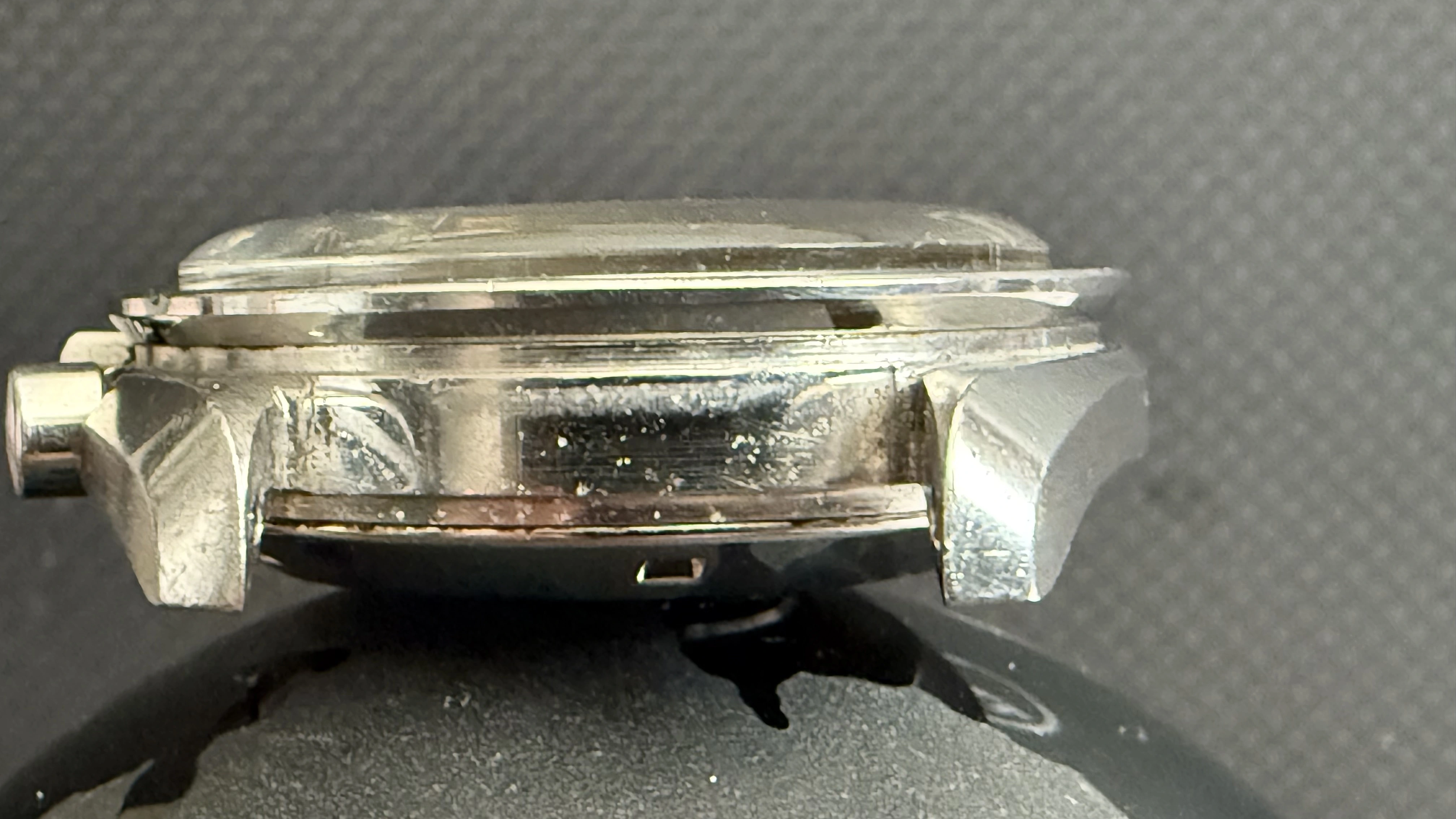

Another angle, yep, no step. Learned something today. I guess the old man’s memory ain’t what it used to be. So maybe an early -74?
6,609
26,784
They are still excellent pair with a lot of character & charm. Enjoy and have lots of fun wearing them.
18,330
27,698
That’s going to be my guess….
Although it’s possible it’s a 71 that has a service dial and updated caseback.

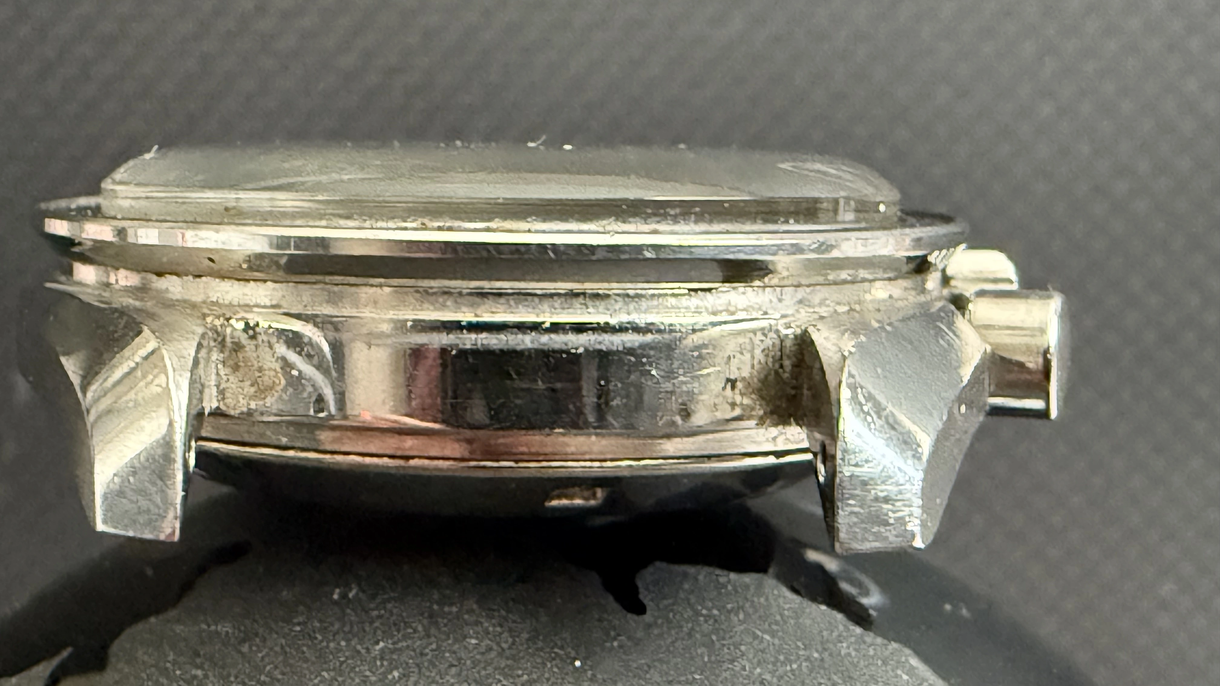

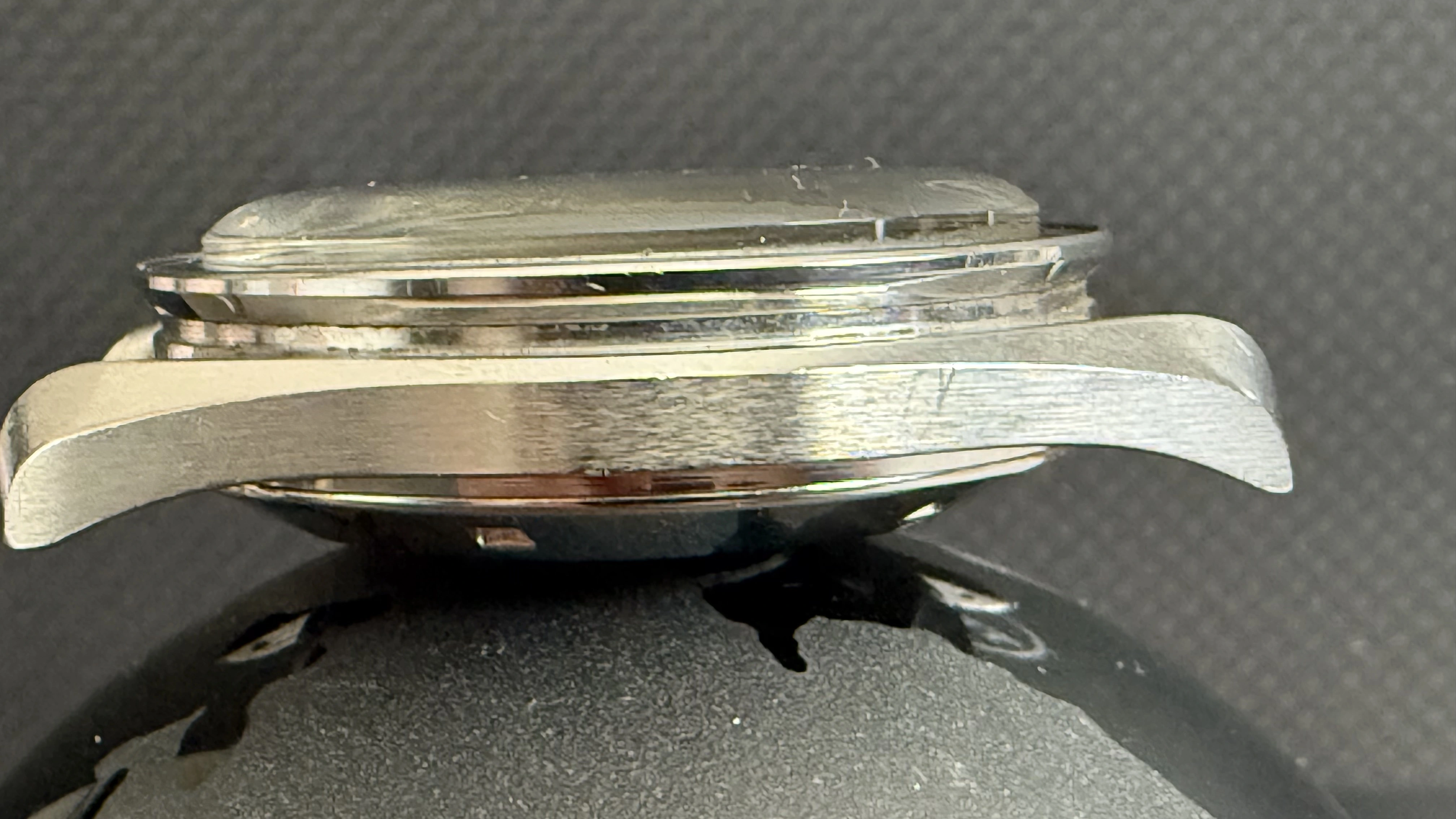

12
26

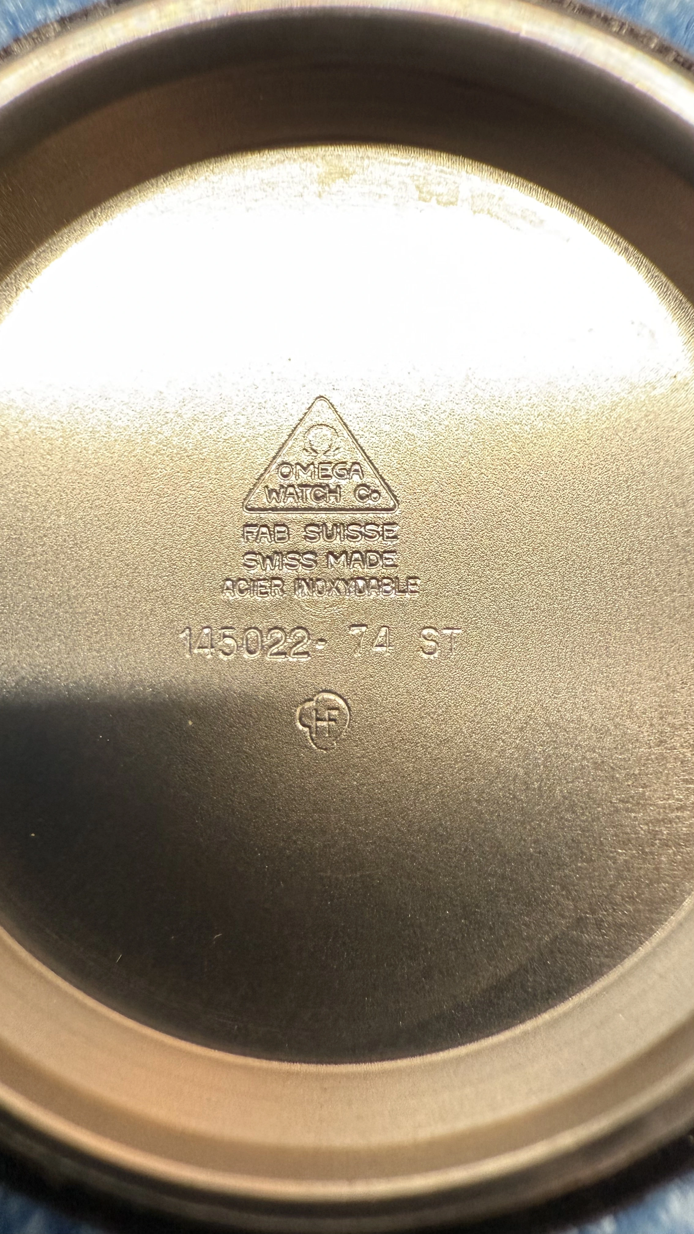

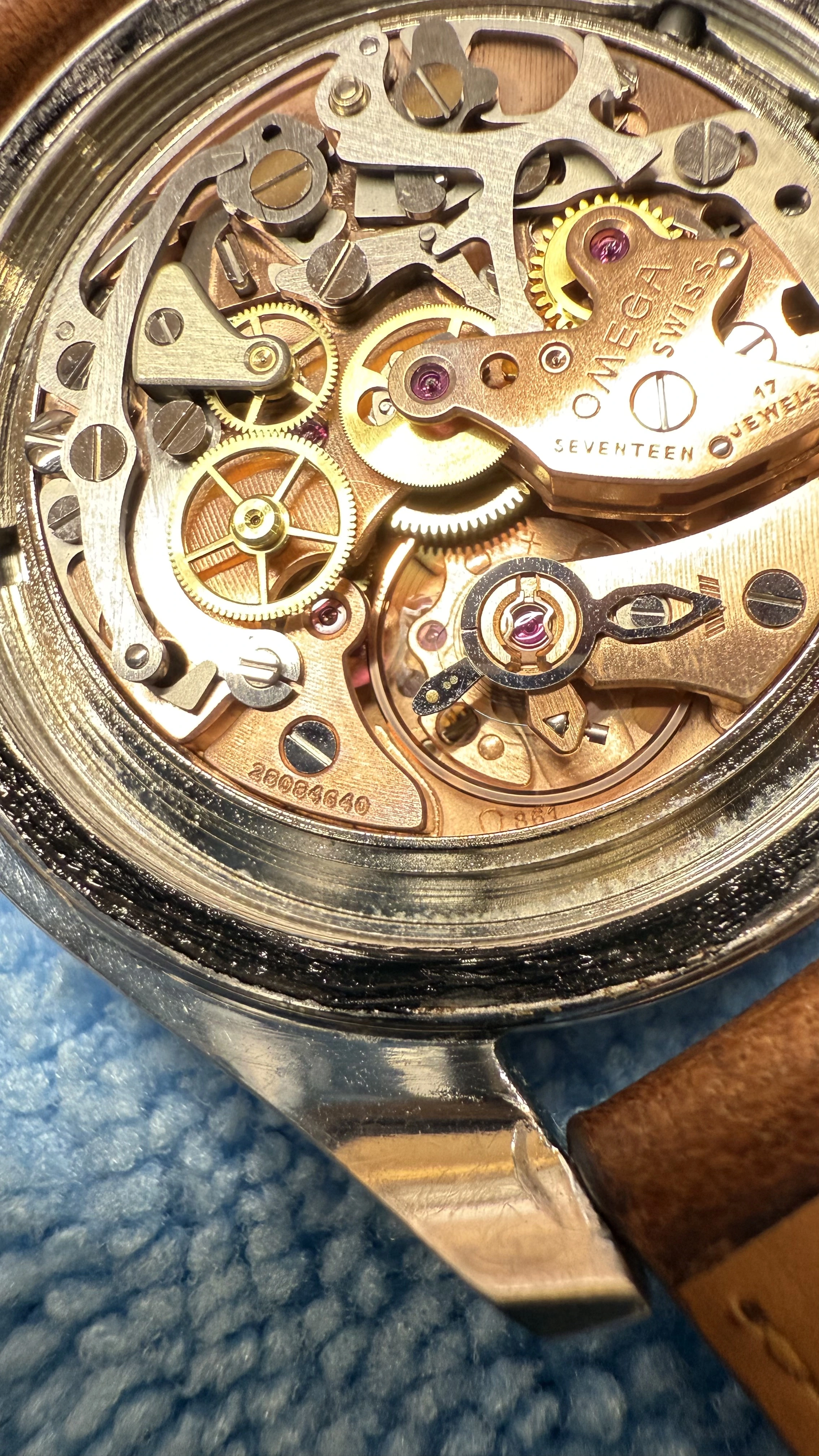

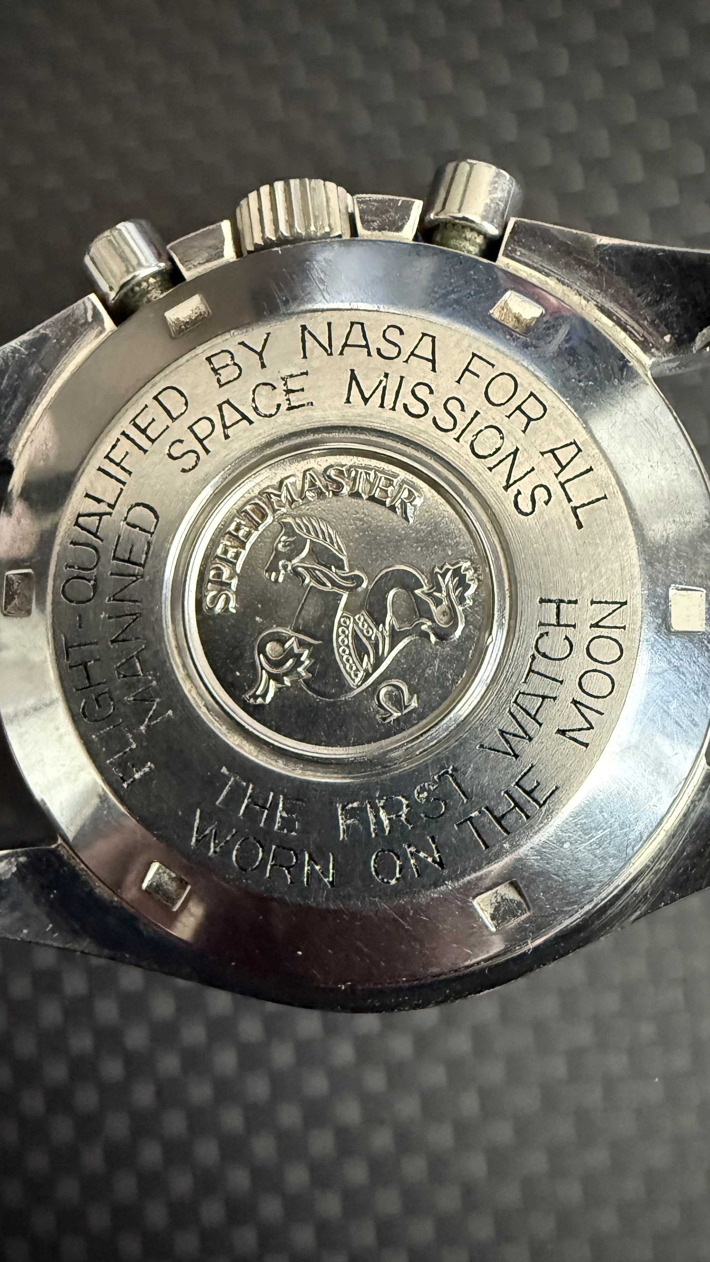

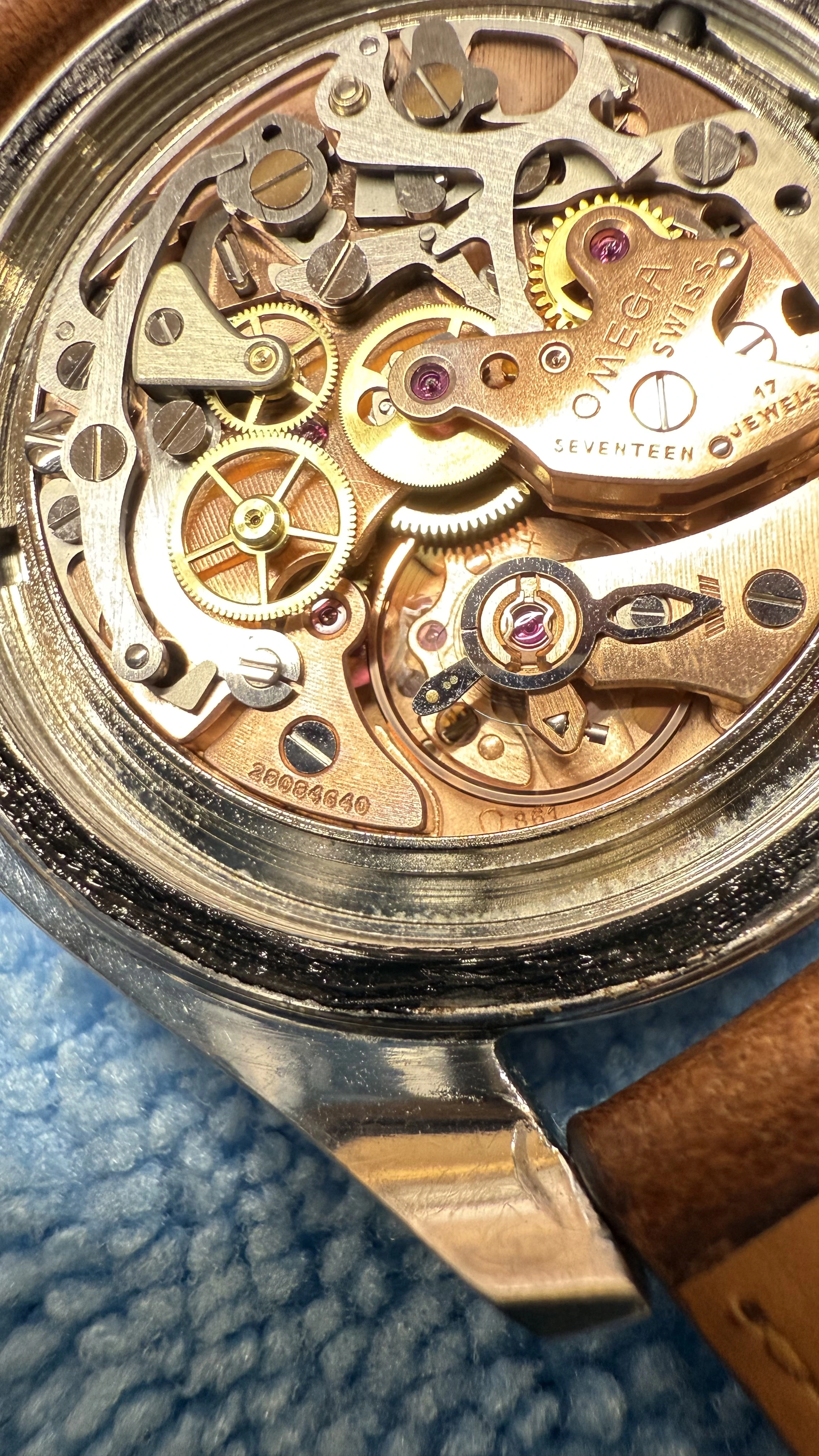

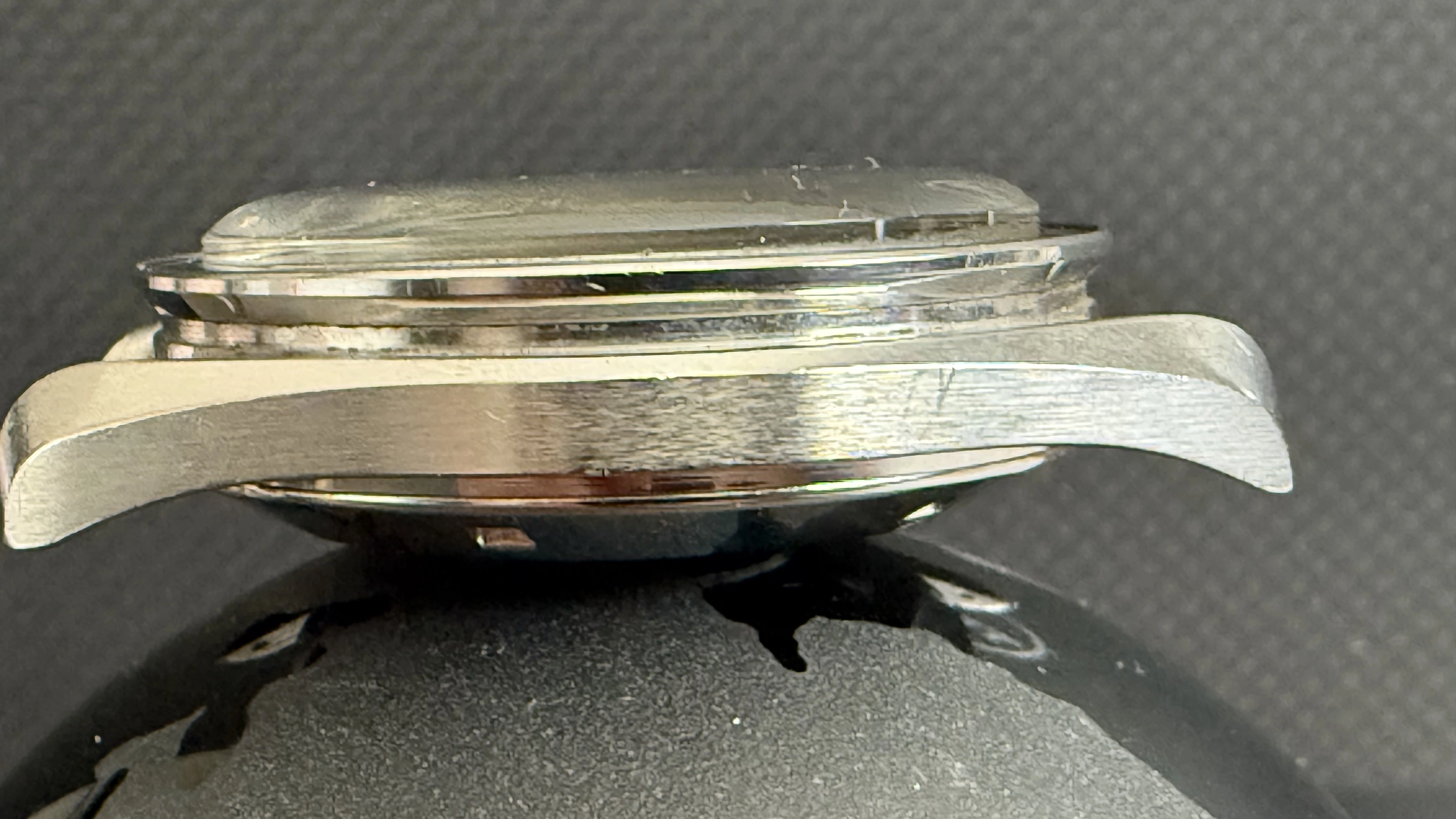

I finally got one of the watches opened up. Still waiting to hear from the watchmaker. I can confirm the case back is a 1974, however the caliber 861 internals show a 28084640. Is the stamp below on the case back a jewelers/watchmakers mark? I used the Ilovemyspeedmaster.com to search that number and it says production date October 1969 not a moon watch. Any ideas? My father says he bought them both new. He did say he had one of the hesalite crystals replaced, not sure of which one. One was my grandfathers, the one currently being evaluated for repair, and the other my dads. My understanding is the later 74 models also had the plastic ‘brake’ this does not not. Possible this has the internals of a 69 model with a 74 case back a dial?
221
491
More likely than not, the original movement was replaced somewhere along the way for a variety of reasons. As you pointed out, the movement number is out of range for both a 74ST and a Speedmaster Professional.

That movement is certainly not correct for a -74 so we have a caseback, dial and movement that don’t match.
Given the story, I’d say the most likely scenario is it’s a -74 that had the movement swapped when it flooded after swimming.
