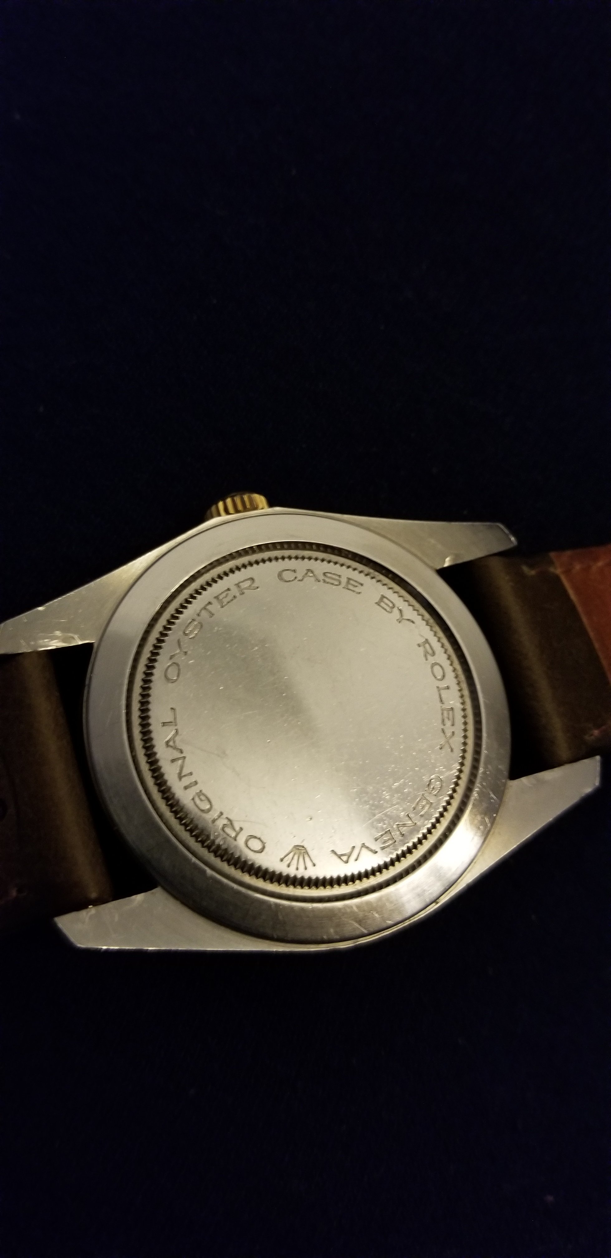

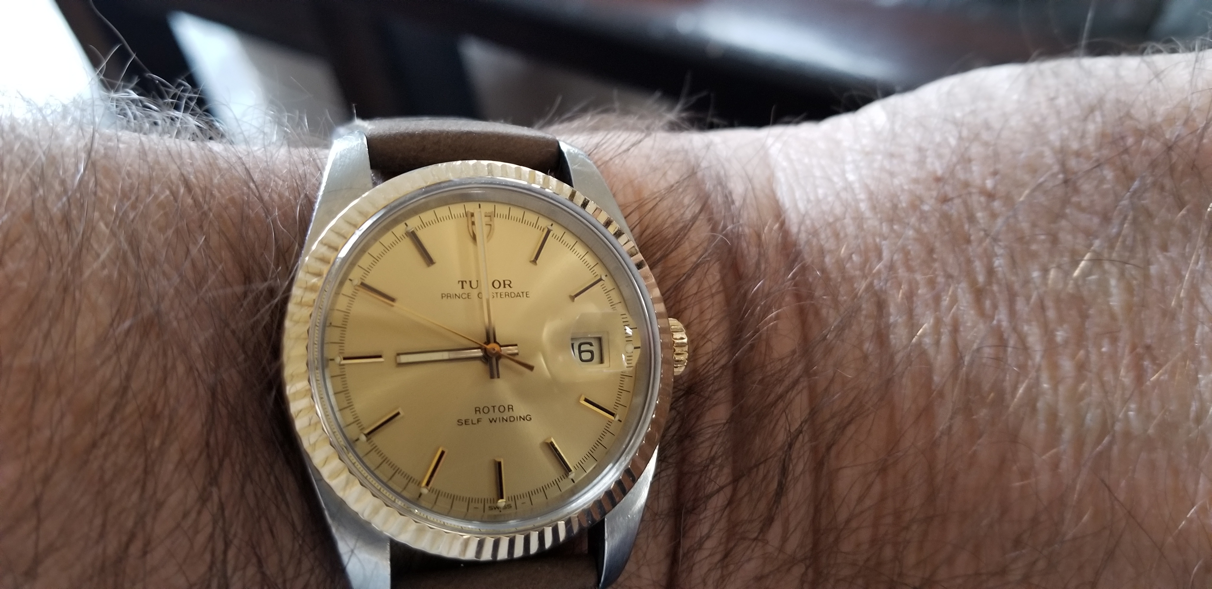

Hi all. I guess this question is for any watchmakers or someone who knows. I have this Tudor that has the ETA 2824. I noticed when changing the time/date that the date doesn't change until 2, not 12 like every other watch that I have. Was curious to know if anyone has ever seen this and if so please let me know. Otherwise the watch keeps perfect time no other issues

Could be watchmaker error, loose hour hand, should be an easy fix at the next service.
16,305
45,025
If it snaps over at 2 every time, most likely as @Canuck suggests, the hour hand just needs to be repositioned back 2 hours.
