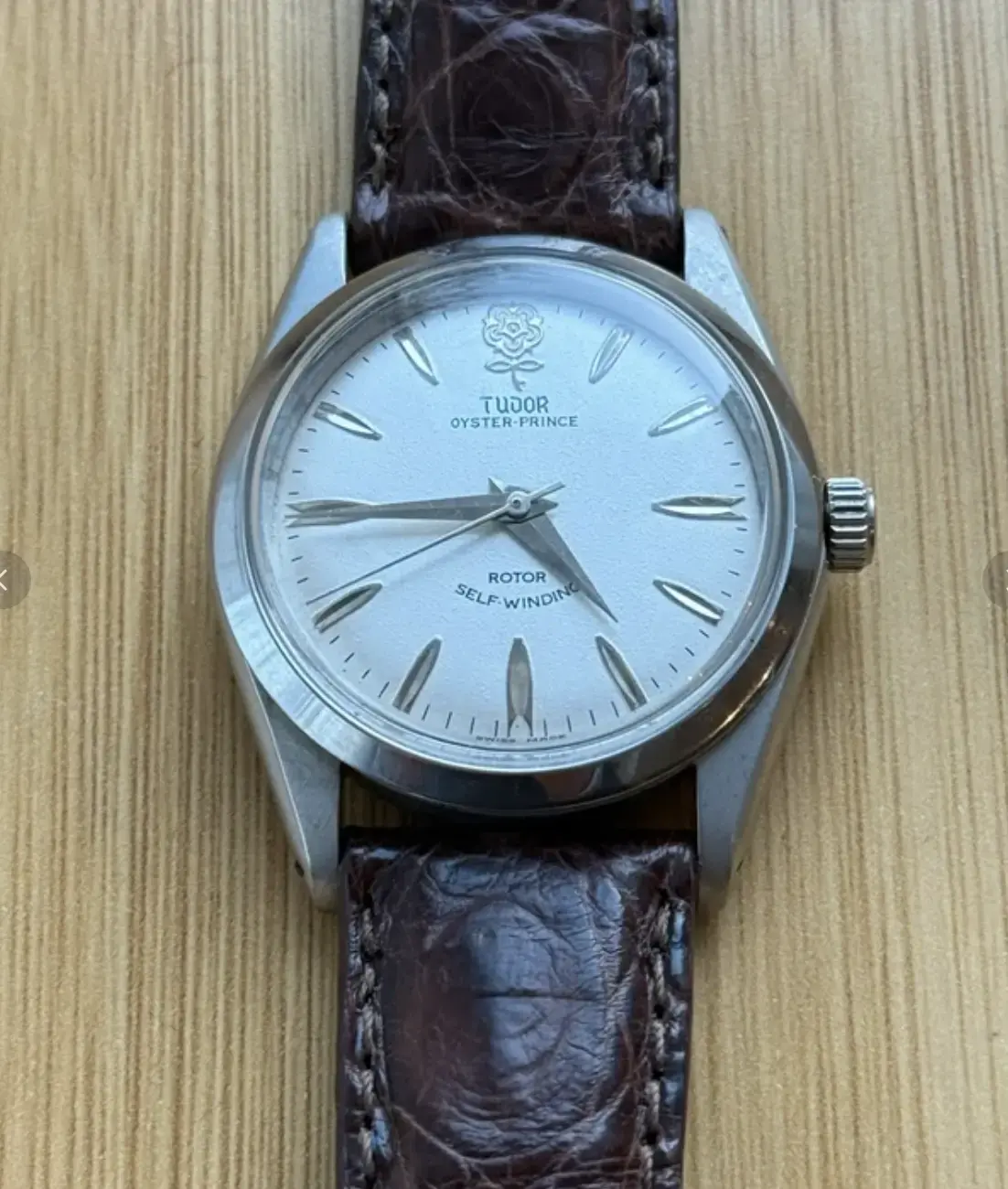

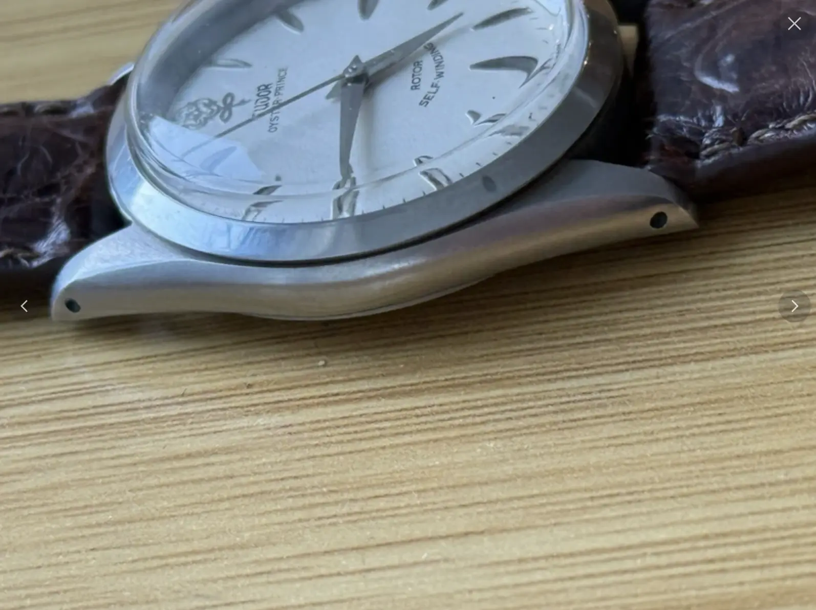

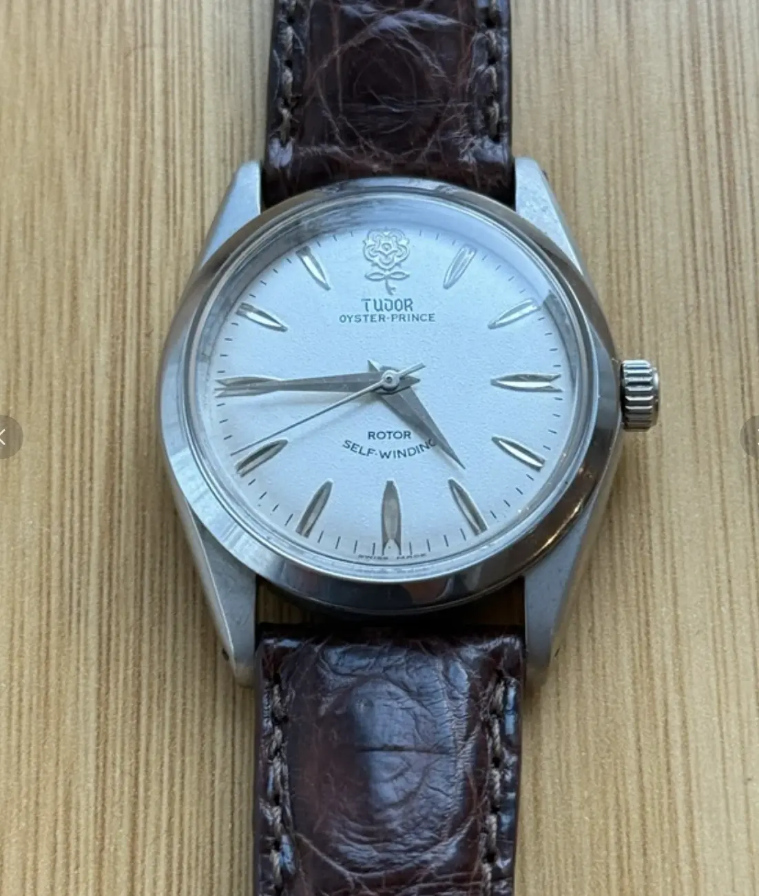

Hi,
Newbie here. I'm quite sure this is a re-dial, looks too crisp. The guy is looking for €1000 and I'm tempted, I just love the big rose. Any experts have an opinion?

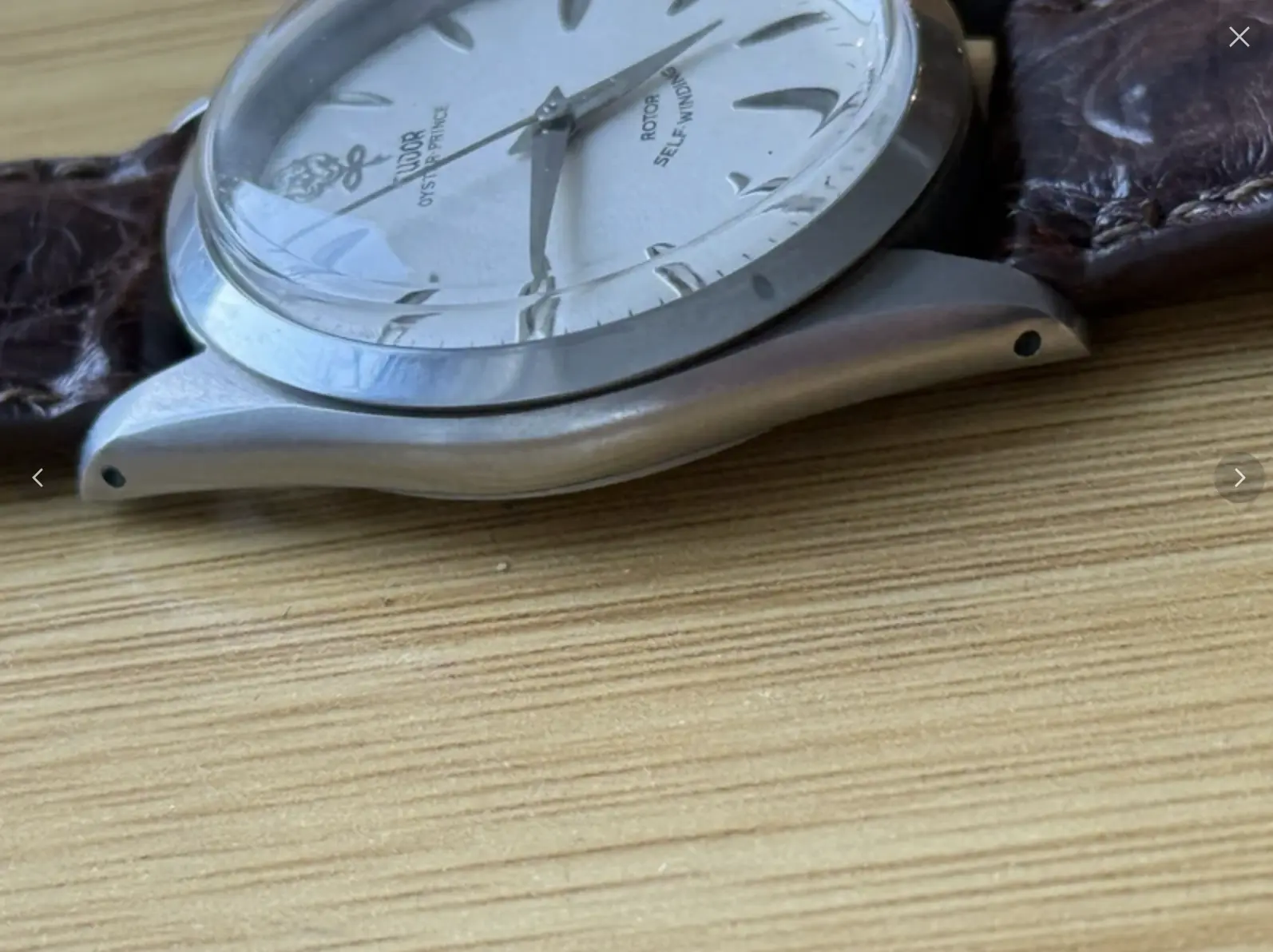

Also the case seems a little too crisp also?
Any help much appreciated!

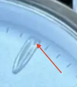

Is there a tick mark printed on the one-clock marker?
24,257
54,023
Really, in the photo there really looks to be a tick mark printed on the raised marker. And something on the two o'clock marker as well.

Nice spot. I'll ask him for some better photos, I can't tell if it's a tick mark or the indentation on the marker
27
6

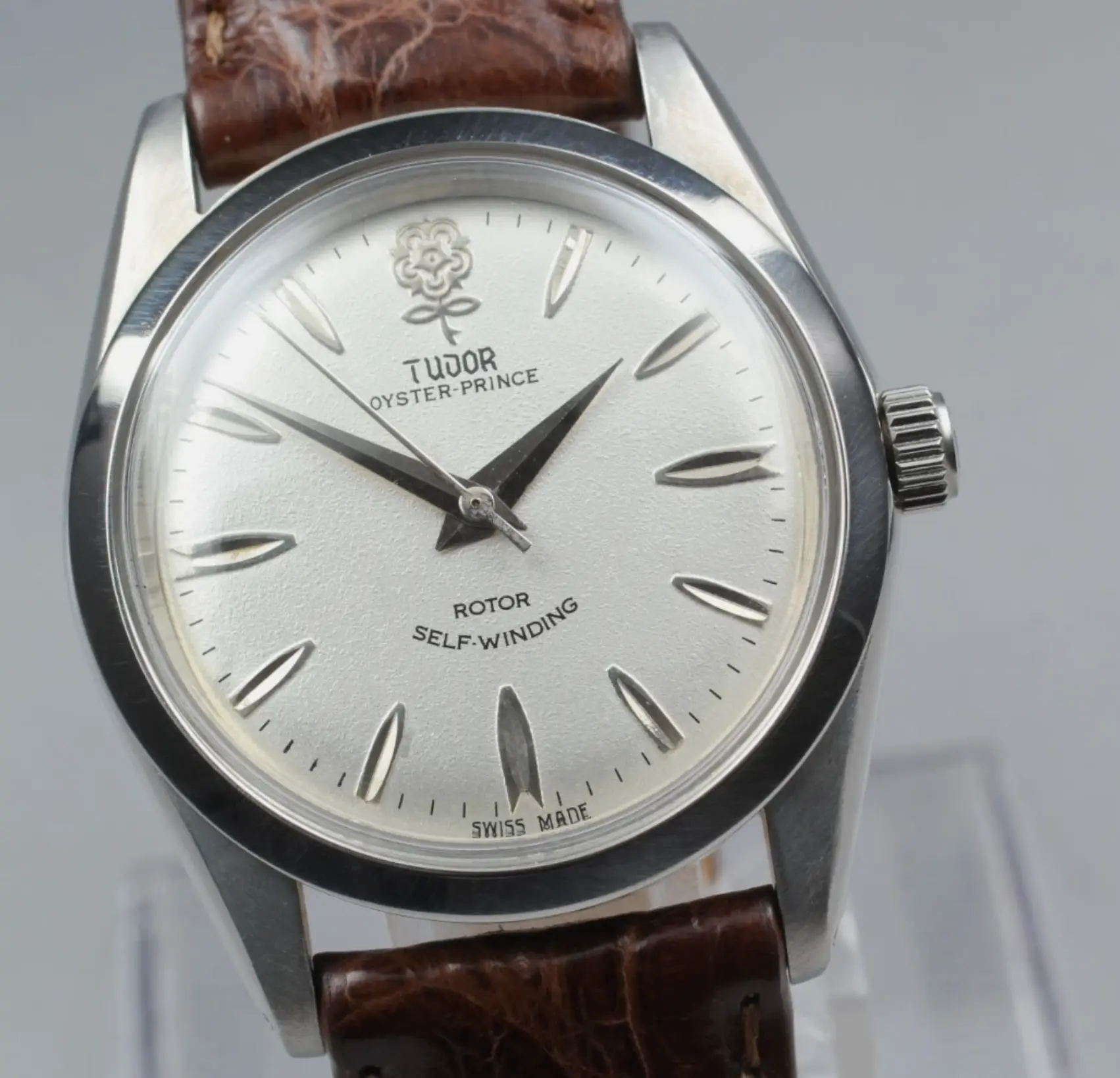

A cleaner pic of the dial. I don't think there's any tick marks on the raised markers
