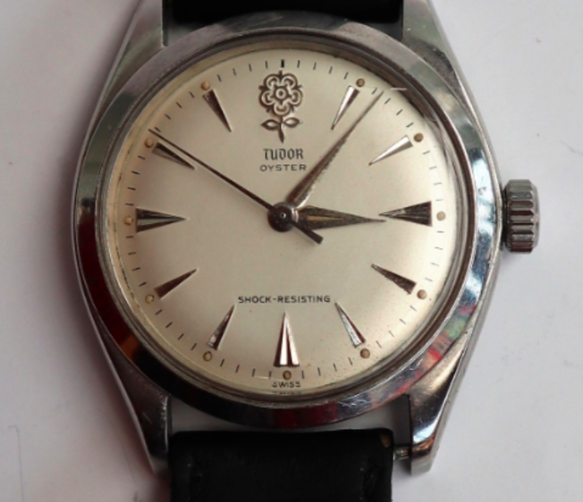

Hello All,
I just found a Tudor Big Rose 7934. It has a generic crown and I would like to find a correct replacement. Any idea of what it should be and does anyone have one to sell? Thanks in advance!
Best regards-DON
Here is a pic of the watch:
532
2,317
Don, standard Rolex 5.3MM crown. Numerous cheap ones on Ebay. Not sure the condition of your tube but search for rolex 5.3mm crown on the Fleabay
OR because you do not want to do this yourself, find a local watchmaker that probably has them and can swap it out as you will need to remove the stem from the movement
