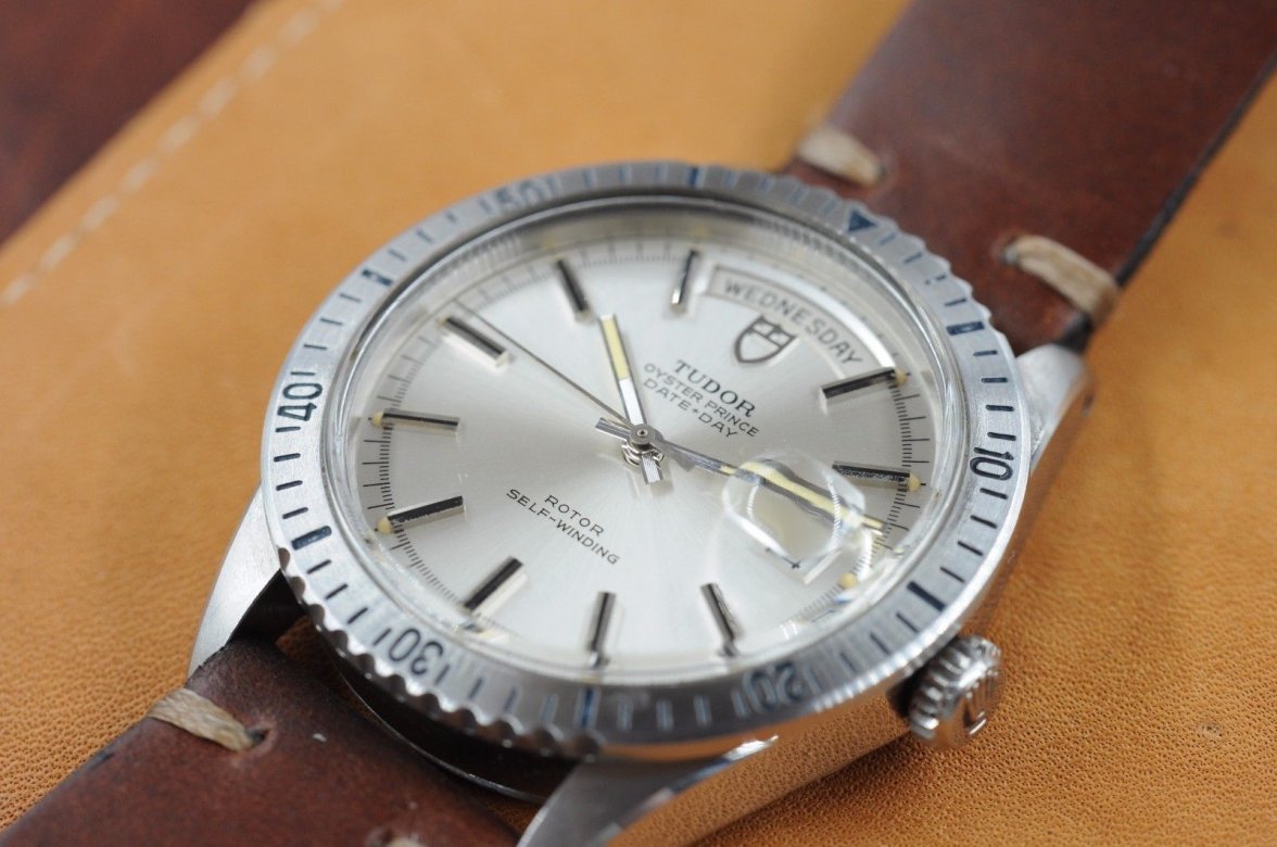

    Hi folks,
    Starting collector--appreciate all the detailled discussions and helpful advice here. I've been chasing a black dial Tudor date+day 7020/0 for a while now, and have been reading up on this watch quite a bit.
    So, having found this 7020/0 listed on Chrono24 a few red flags are raised for me: a bezel with minute marks that I haven't ever seen before, "day-date" on the dial (instead of "date+day) and convex "self-winding" instead of straight. Also: princess oysterdate? It's sold as a men's watch!
    So I wanted to check with you guys. Are my assumptions correct?

  3. ScubaPro Actually dives with dive watches!!! Sep 8, 2017
    212
    204
    Everything on this watch looks odd to me, especially the things you mentioned. But, that means nothing. It could certainly be a legitimate Tudor, but I've never seen this particular model anywhere. But the thing is, like most big manufacturers there are models issued in limited quantities in limited markets that may be completely new to wherever you reside. I never buy watches online anyway. If you don't see it and inspect it in person before getting it, you're truly asking for trouble. Nothing is faked more than watches, and this goes back to way before the internet and buying stuff based on photos only.

    Unfortunately don't know enough, but seems a rare variant. Toothed areas of the bezel also seem in the same place as 7020/0, meaning about from 55-05 and 25-35

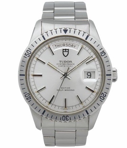

    Here's a TB bezel

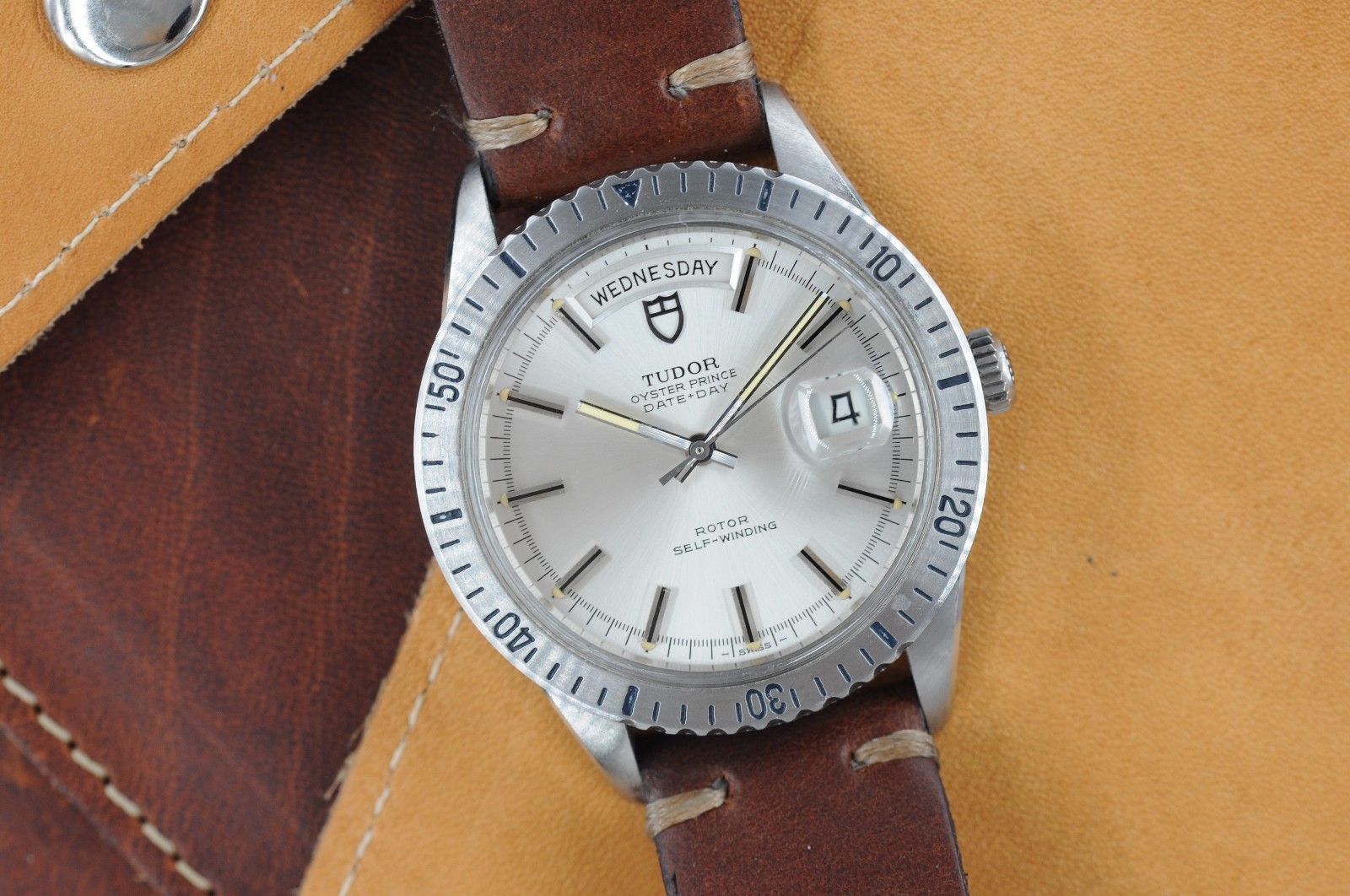

    Couple more examples of the turn o graph bezel with minute markers -->
    This dial looks ok, as does the bezel
    red crowned, watch3s and jaspers like this.
