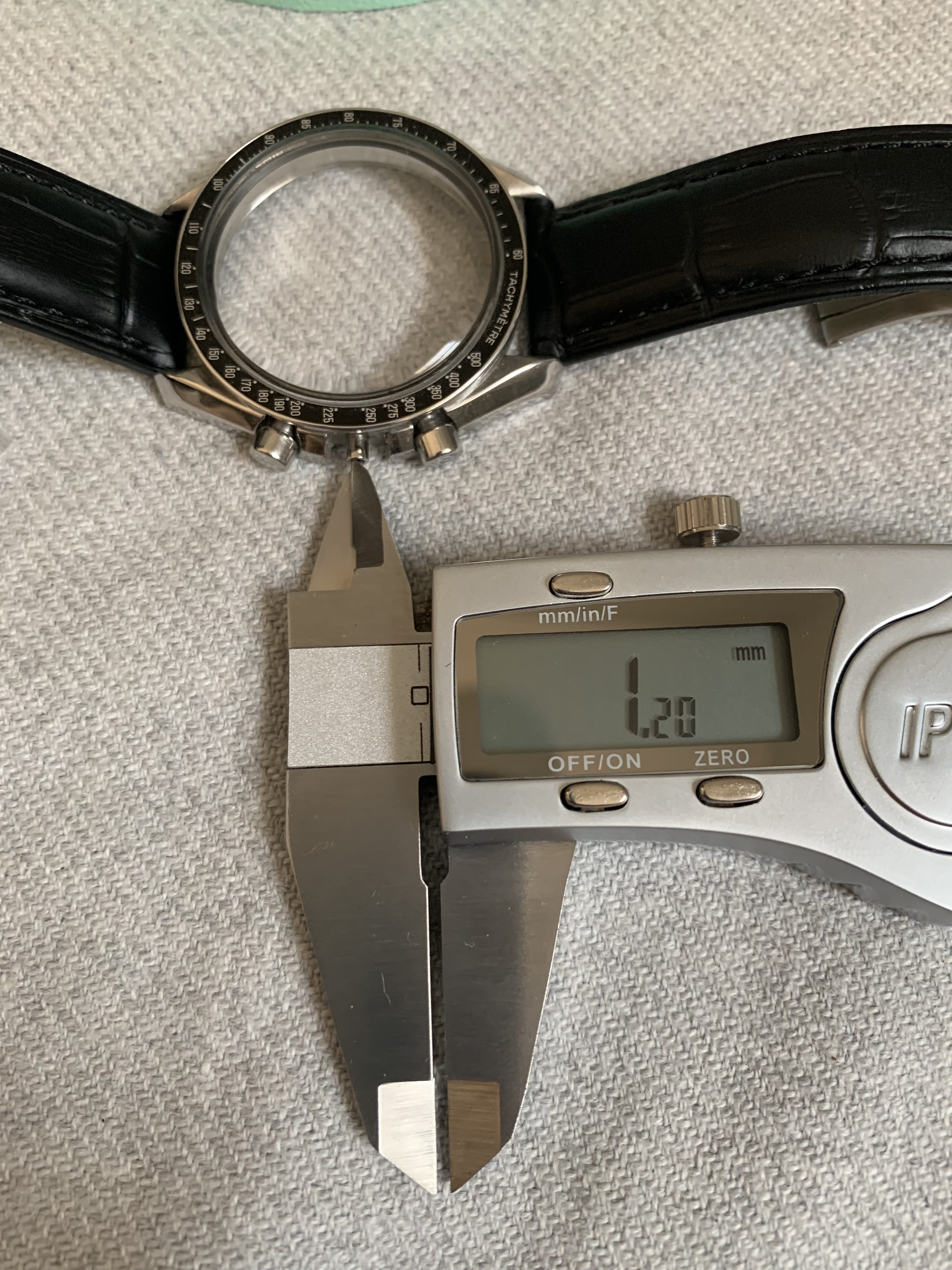

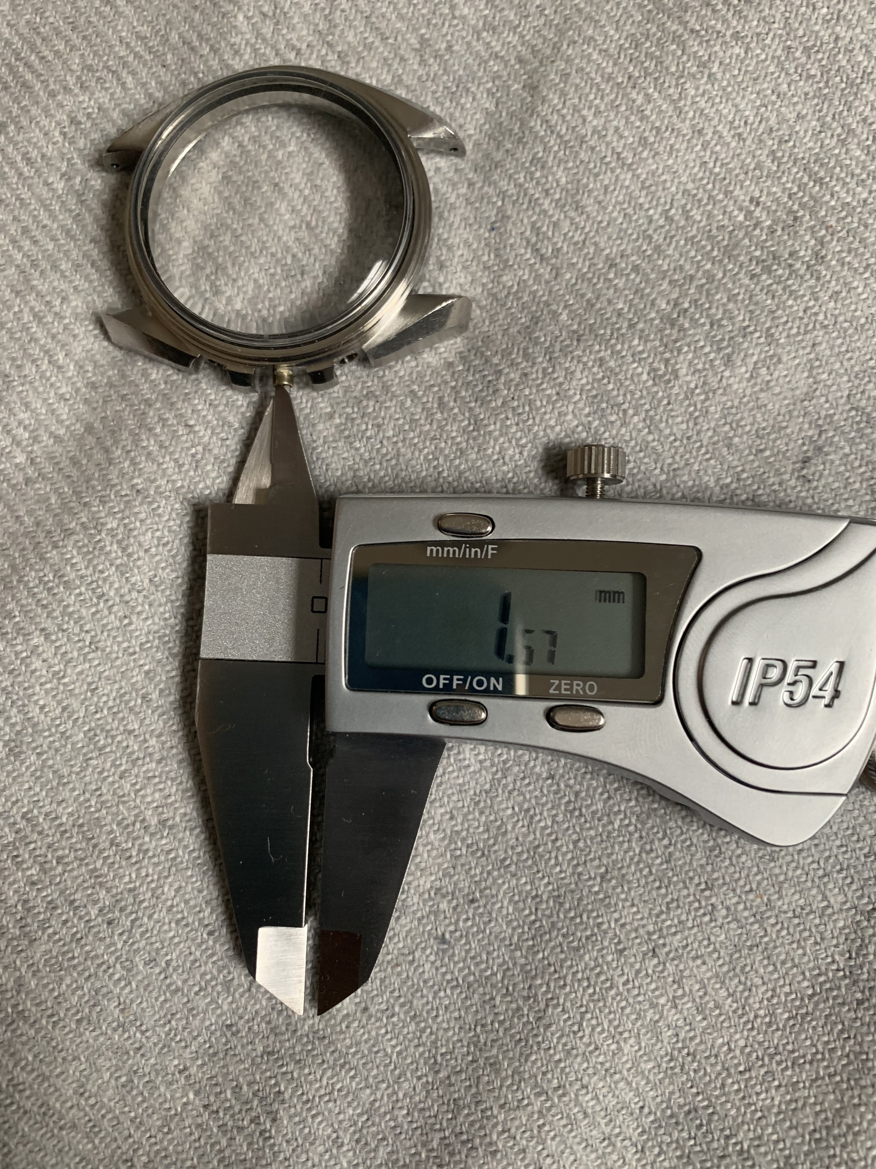

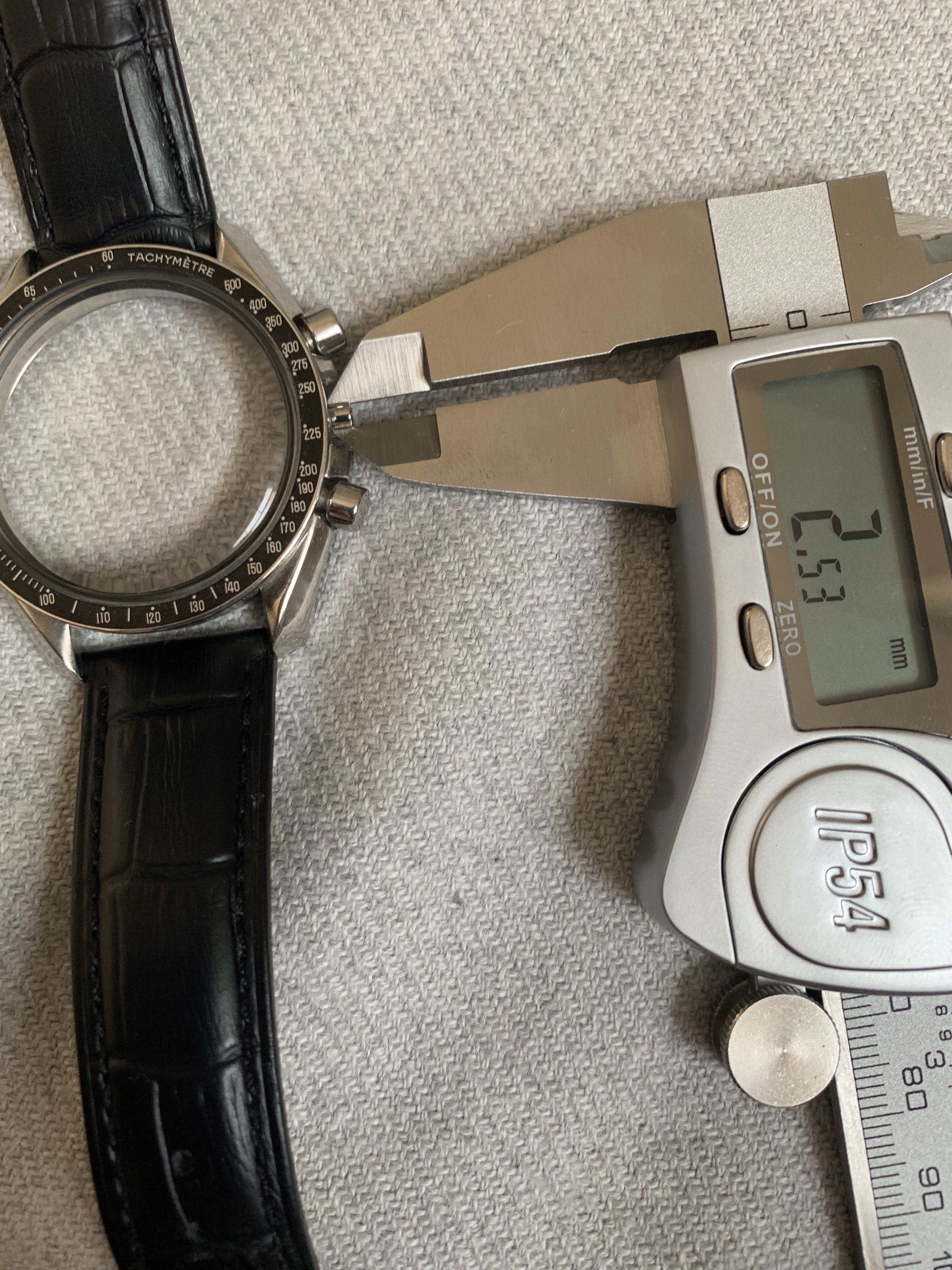

Two measurements today. Need to dig out the Ed case.
Outer seems to be consistent at 2.5mm ish. Inners do seem to be different.
From this measurement - around .4mm. Which seems close enough to the eyeball diff.
