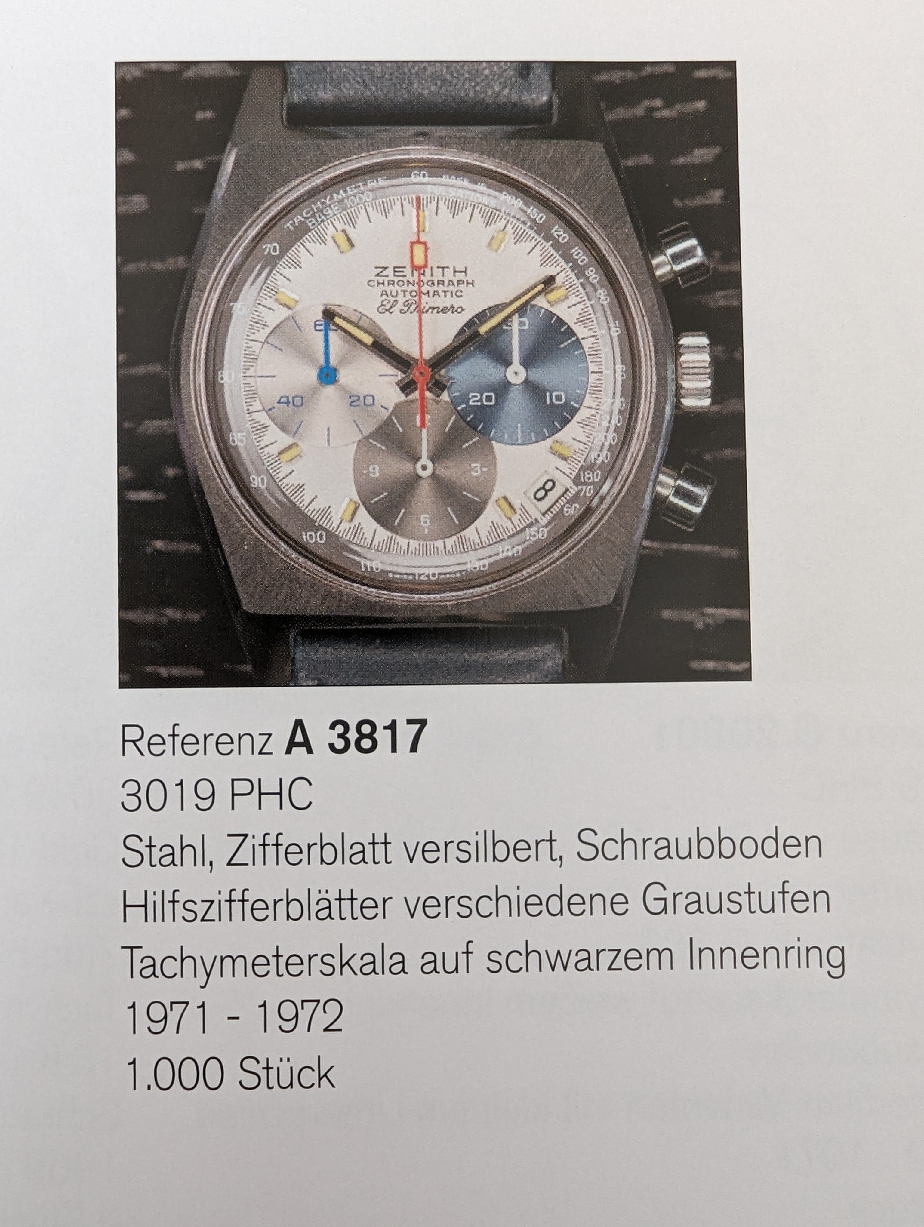

Trying to identify this El Primero
4
5
Hello
I am fairly sure that this is a A386 MK3. (232EXXX)
BUT:
1. I've never seen the blue seconds dial
2. The outer tachymetre dial is usually white.
Can someone bring me up to speed on this version and how rare it is (or not...).
Thanks!
4
5
It's an A3817.
Would you by any chance know, how I could look up by the case number (232EXXX) when it was built ?
Thanks so much!

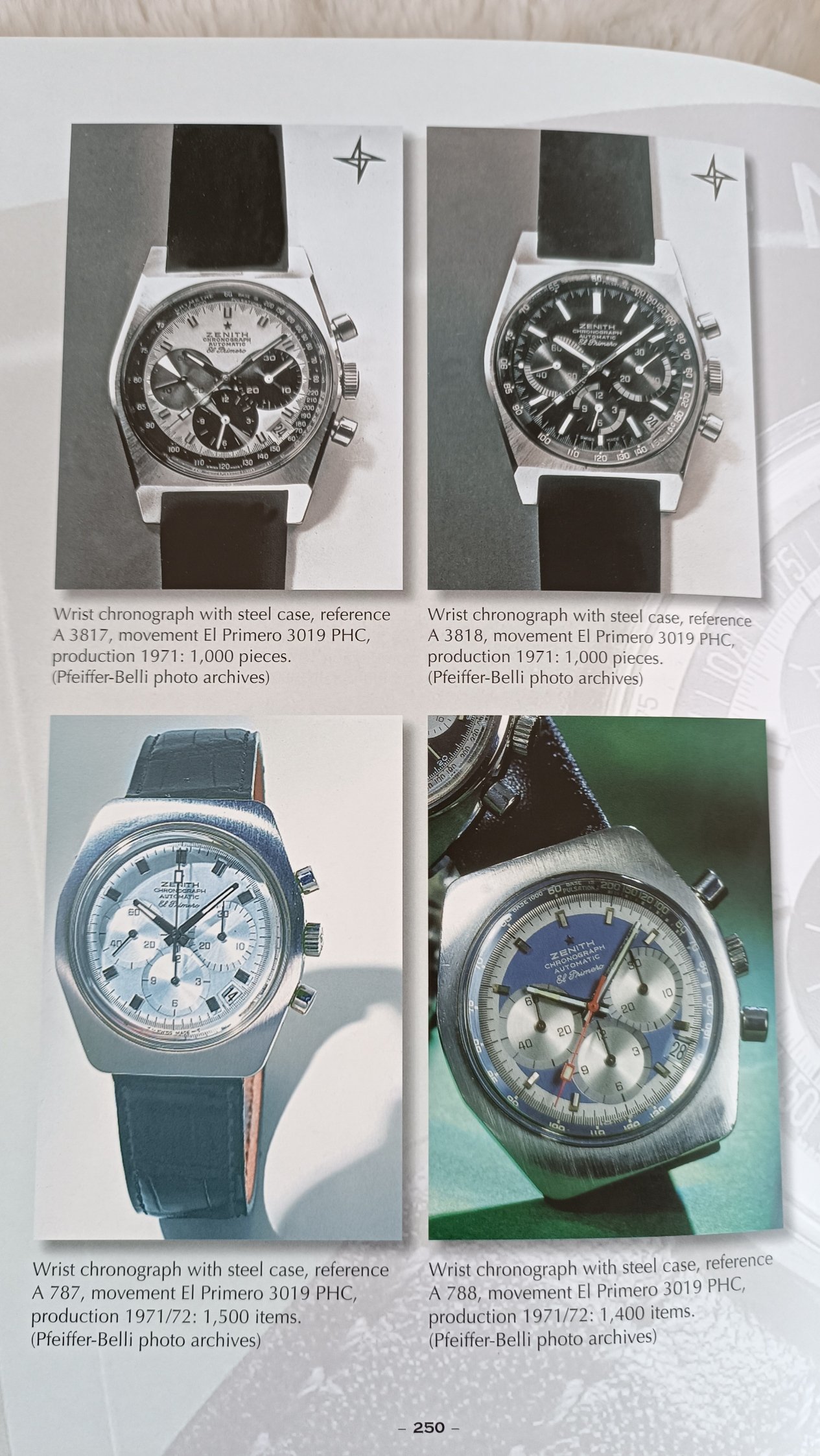

Unfortunately the picture is in black & white, but you can see some info on this model in Manfred Rossler's book on Zenith
6,484
31,920
So 71~72, OP could maybe mail Zenith customer service to see if they are willing to check the serial?

In the small Roesler it is coloured:
Thanks a lot to all of you!! I'll check with CS from Zenith.
