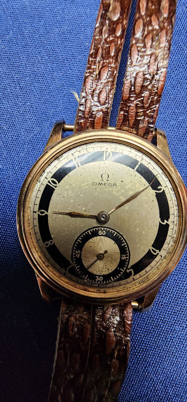

Got a watch passed down to me from my dad, it belonged to my great grandfather, he bought it in like the 1930s (or somewhere around there). I'm just trying to find out more information on it and try and get it in for repairs it's currently not running.
I did some google reverse image searching and I've found the Baby Scarab looks similar but I haven't been able to find the exact watch face. I've also checked some archival sites and Omega's own catalogue to try and pinpoint the exact model but no luck as yet. There's no markings on the back of the case as I've found that watches of this vintage only had the markings on the inside and unfortunately no watch repair place in my area wants to even touch the watch when they find out the age of it. Any information or pointers people might have would be much appreciated.

What is the size? Are there spring bars? What does the case back look like? It has the looks of a calibre 26.5, doesn't it?
10
3
no idea about the caliber it's on the small side though, maybe 5cm across? the strap bars are fixed (not spring bars) and there's no markings on the case back
*EDIT* I measured the diameter of the circular part of the watch body, it's just slightly under 3.5cm (1.4")

The info you really need will be on the inside of the case back. Not sure where you live, but you should be able to find a competent watch maker to service it and get it up and running again. Looks like that minute hand got banged up and is possibly rubbing against the dial, which will scratch it up, so that needs to be sorted. It's a family piece, so IMHO, totally worth getting it serviced properly

from the dial design and shape of the hands it looks more like a cal 30 watch

Keep it dry, don't wind it or drop it. If you have access to a caliper, measure the outside of the case diameter, say from the 10 to 4.
Any hallmarks or stampings on the outside metal?
There are many very similar dials from about 1940 with the 30mm movement or perhaps the 23.4 or 26.5.

Identifying an old watch like this from photos on the internet is not always possible, even for people with encyclopedic knowledge. There were many many dial and hand variations, and when you talk about watches from the 40s (or possibly even late 30s in this case), they're not always so well documented. This particular watch will not have a model name, and it may not even have a real reference number. Fortunately, you really don't need that information in order to have it repaired, a good watchmaker will know what to do once they get it opened up and see what is there.
You may need to send it to someone who can repair it. Unfortunately, it's not always easy to find local watchmakers who are willing to work on old watches these days; it is becoming less common and more specialized. You can find recommendations in many other threads if you run a search. It's an appealing watch and obviously it has great sentimental value.

You can always ship it to a good watchmaker for repair. I don't think you said your location. You can get recommendations on this forum.
The watch world is a precise thing. A case diameter of 35.0mm vs 34.5mm vs 35.4mm means something to the experts here. So a precise measurement with calipers and a pic of the case back may yield more info.

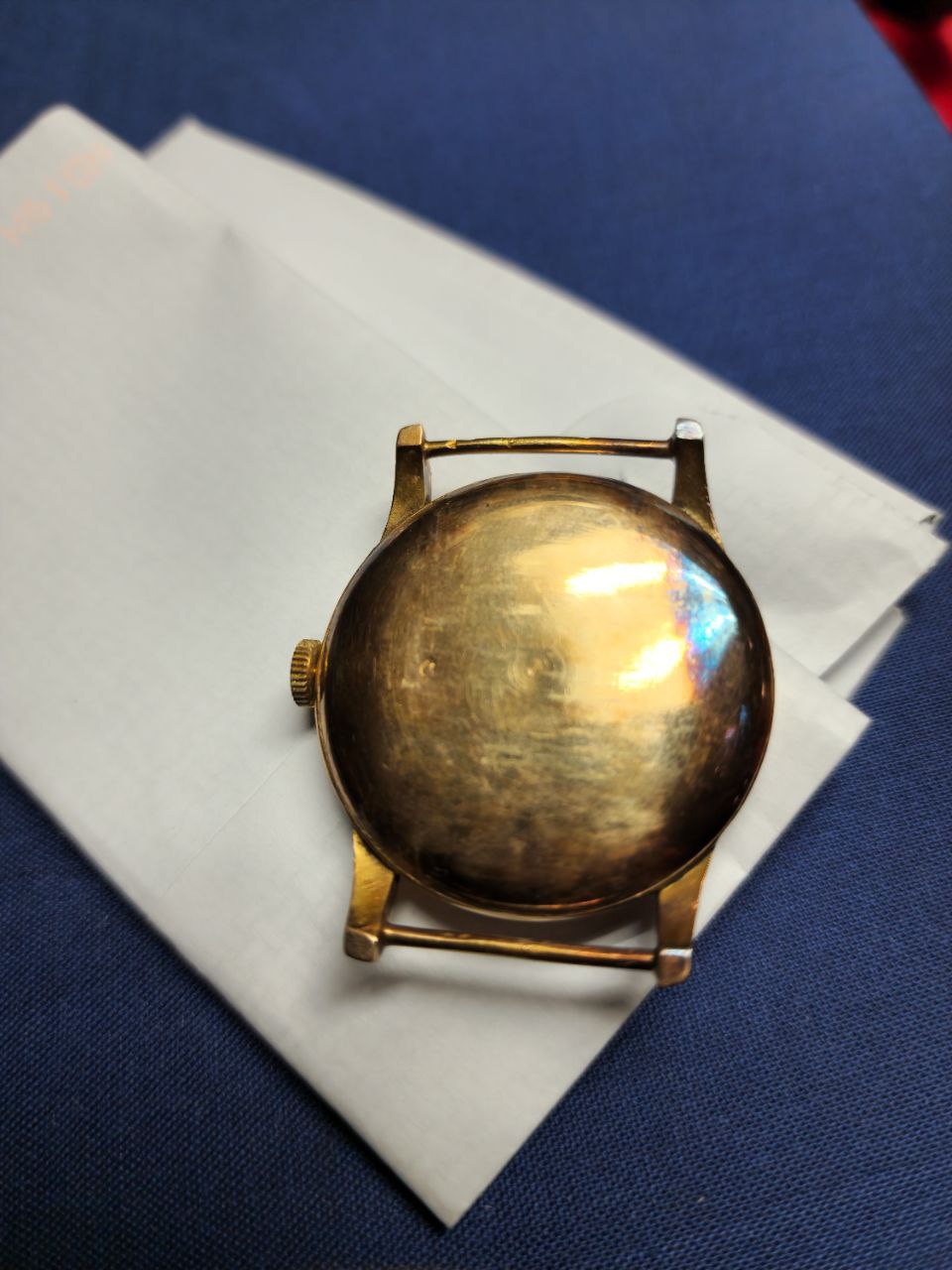

*EDIT* took a pic of the case back

Small but significant update, found a local friend who is into servicing and repairing vintage watches and he took it on as a project; this watch has a 30t2 (15 jewels) movement and is from 1940 (serial number is 9XXXXXX, a little under halfway through the run).
looks clean af inside, no markings on the inside of the case back either and astoundingly it runs; I must have jostled it in my pocket or something because when I took it out it was running and my friend said it was only 30 seconds/ day fast... he oiled the top jewels and got it down to 20 seconds/ day.
5,727
9,513
Can you put more effort into taking better pictures in focus from the inside case back ? You want info's from us and we need pictures in focus. Oiling the cap stones might be nice, but if you want to wear it, have it dismantled and serviced. Which means to clean every mini part first ...

Small but significant update, found a local friend who is into servicing and repairing vintage watches and he took it on as a project; this watch has a 30t2 (15 jewels) movement and is from 1939 (serial number is 9XXXXXX, a little under halfway through the run).
looks clean af inside, no markings on the case back either and astoundingly it runs; I must have jostled it in my pocket or something because when I took it out it was running and my friend said it was only 30 seconds/ day fast... he oiled the top jewels and got it down to 20 seconds/ day.
9m serials ran from around 1939 to 1944 so if you want a more accurate date you’ll need the second and maybe third digit.
10
3
edited my update post, i meant to say that the inside of the case back has no markings; apologies. also that the actual manufacture date is 1940.
