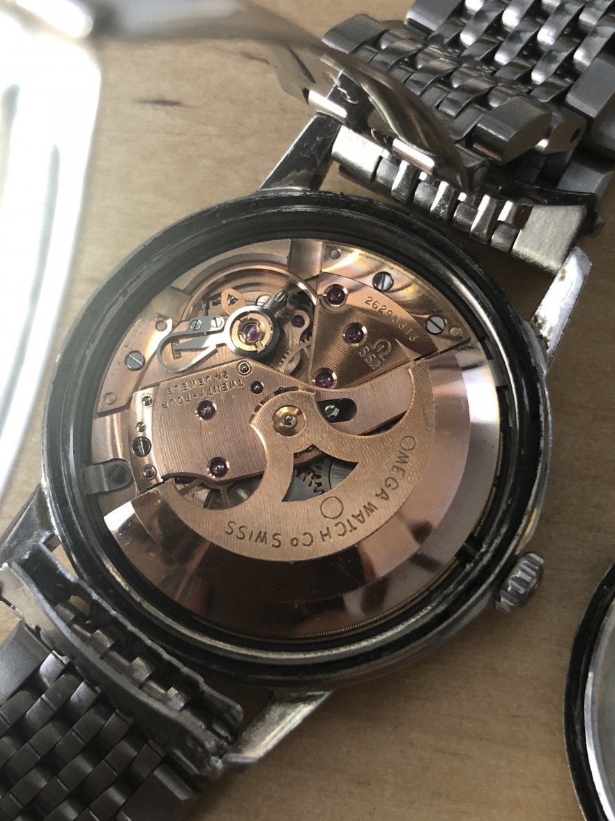

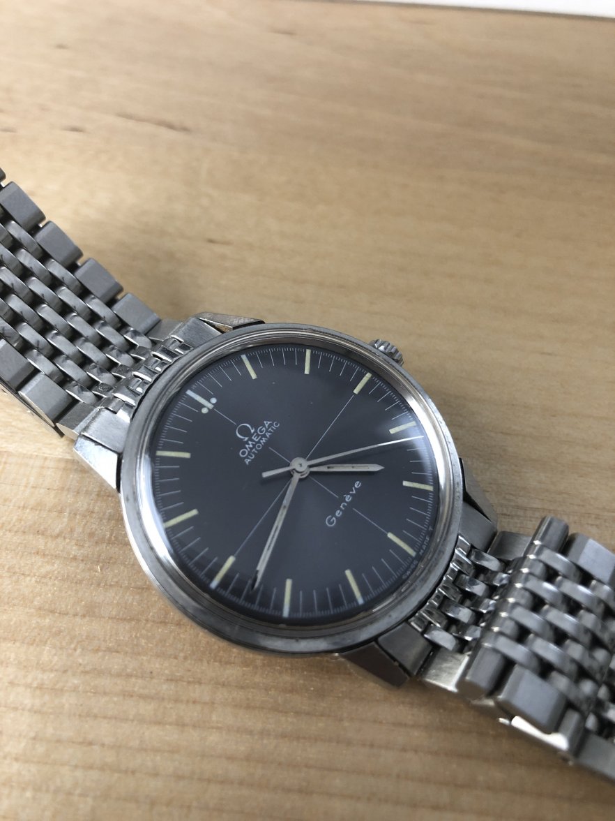

    Hi there! First post and so happy I discovered this forum. I purchased this Omega Geneve and some opinions that I have gotten from research and a friend looking at it are that it is a redial - can anyone confirm or offer any thoughts on its authenticity?

    Dial looks all correct... :)
    the802 likes this.
  4. JimInOz Melbourne Australia Mar 27, 2019
    15,398
    32,153
    I'd be happy with it, can't see any issues with the dial.

    Speedmaster Companion, looks fine.

    Looks good!

    i've seen such kind of dial before. in fact, it was patterned after speedmaster dial indecis.

    Looks legit - here is another:

    Very beautiful watch ! Congrats.
    It’s very difficult at times to understand if they are redials or not, but the movement looks good and in line with the dial !
    Question... from the two pictures posted here it seems like these dials have a tendency to have the lime flake off. Is this common for these watches?

    What about the crosshairs? At 12 and 3 they don’t connect to the indices.

    And look at the placement of the Omega Automatic text.
    Compare it to the example below..

    If this is a redial, I need to know who's the guy who did the relume, because IMO he must be the best one around to be able to fake crumbly vintage tritium.

    This is just my opinion, but I really do not like the missing lume on the dial and the blackening of the lume on the hands. Also remember that all those bits of lume that have become displaced really only have one place to go and that's into the mechanism. If it was mine, I'd want some consistency with the dial and hands and either have the rest of the lume removed or get it sympathetically relumed.
    Then again, that's just my opinion and if you are happy with the way it looks, then enjoy it. Still think it should be serviced and the remaining lume at least stabilised if practical (and not too expensive).

    At the example I posted for comparison you have the same thing at 12 and 6, I don't think this is a proof for a redial

    The watch in the OP is not a redial.
    Slight loss of lume? Yes.
    Redial? Categorically not.

    I wasn’t saying it is a redial just that there is a noticeable bigger gap.
