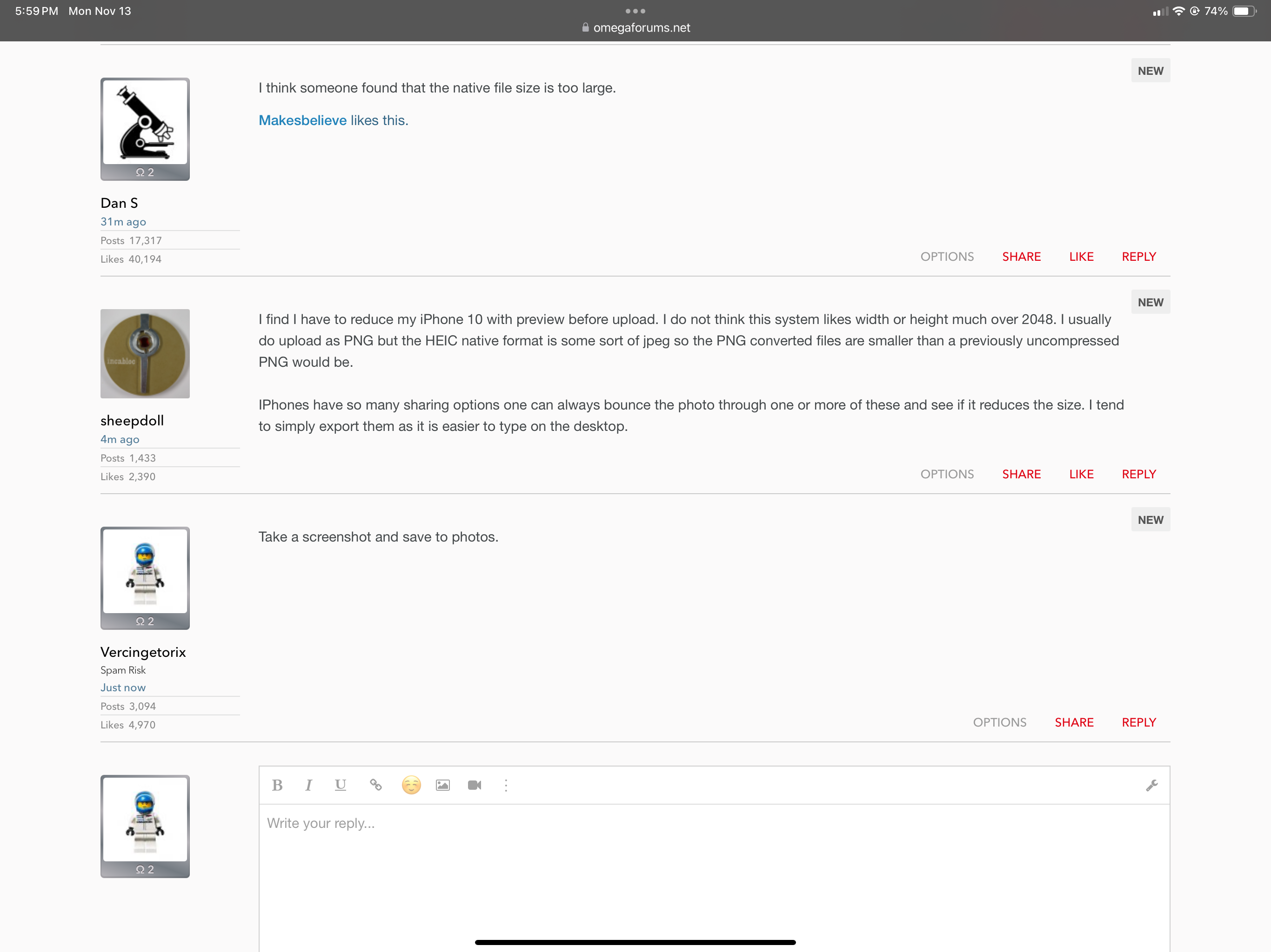

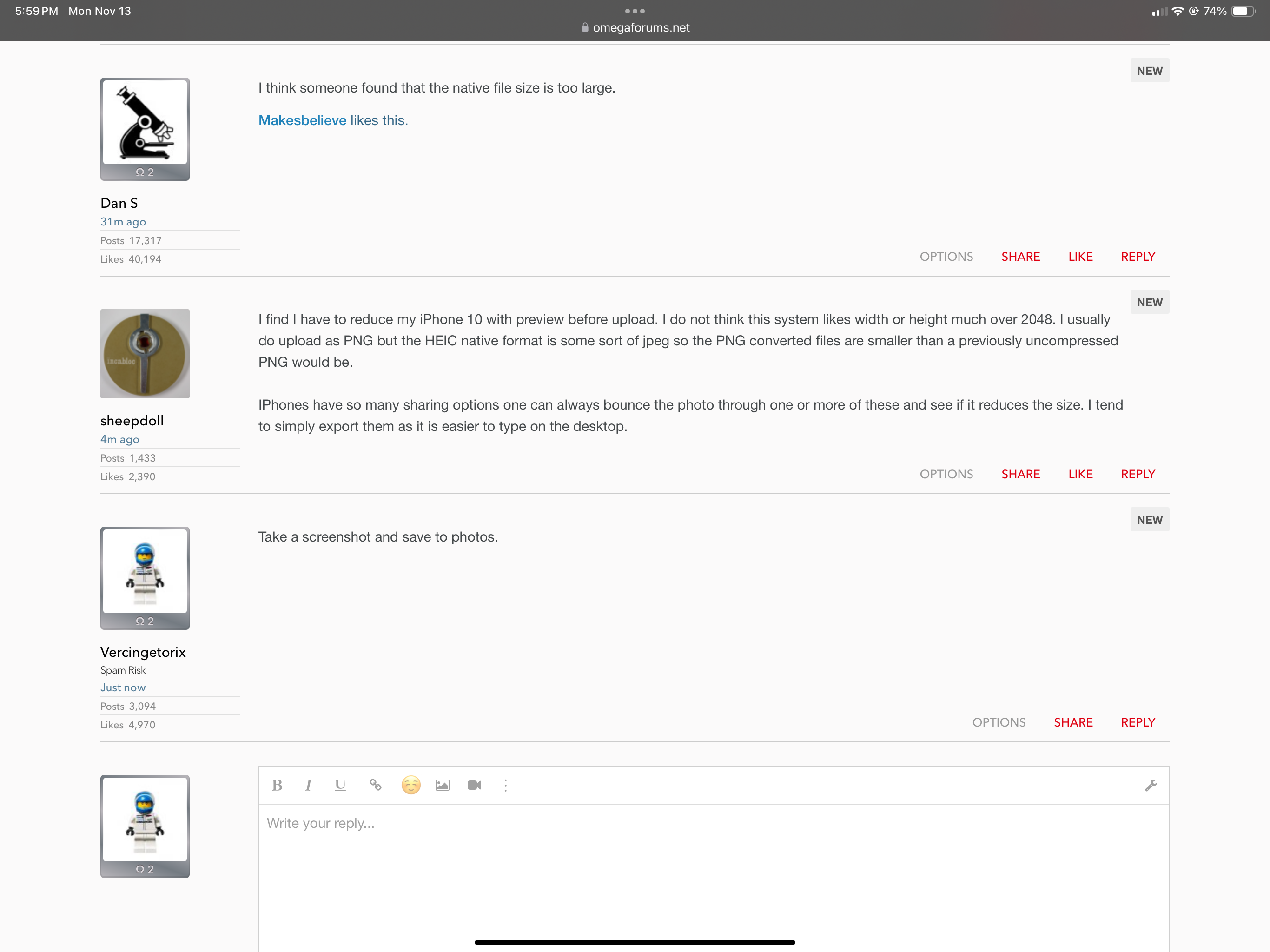

I think someone found that the native file size is too large.
3,012
4,778
I find I have to reduce my iPhone 10 with preview before upload. I do not think this system likes width or height much over 2048. I usually do upload as PNG but the HEIC native format is some sort of jpeg so the PNG converted files are smaller than a previously uncompressed PNG would be.
IPhones have so many sharing options one can always bounce the photo through one or more of these and see if it reduces the size. I tend to simply export them as it is easier to type on the desktop.
