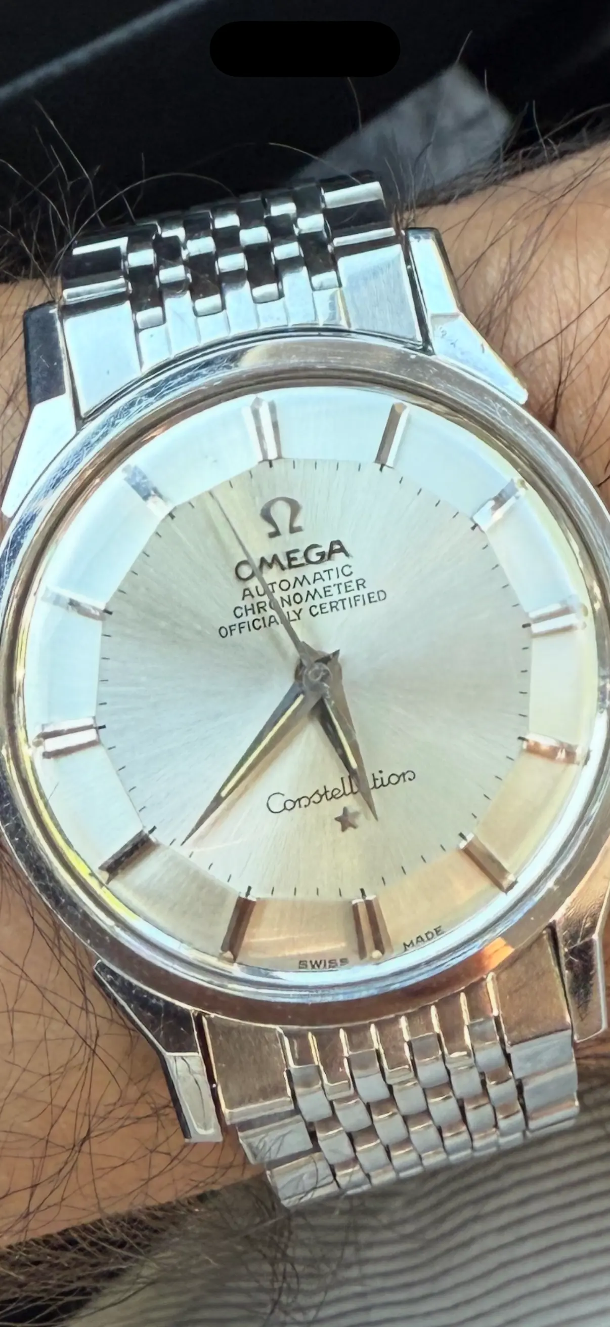

hello guys,
Could you confirm if the lume is radium o tritium?
Teglia per torta Omega Constellation 165.005 del 1962.
I know that omega start to mart the swiss Made t from 1964.. so this could be tritium without the t Mark or radium?

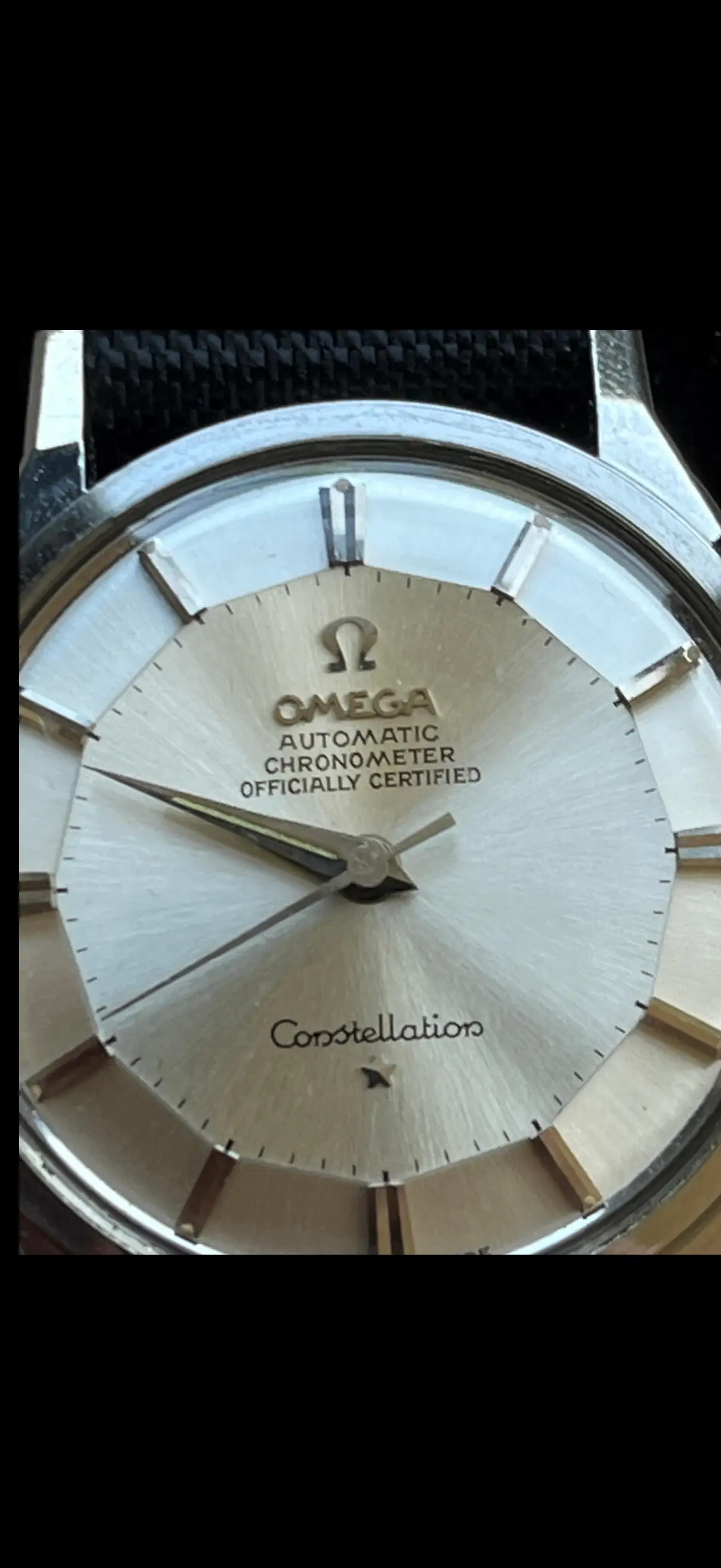

Radium and tritium tend to age differently and from the colour of the hands inserts and the lower lume pips, the lume looks very much like tritium.
The upper lume pips on the other hand look more like radium but it may just be a factor of differential lighting in your pics or the upper area of the dial was exposed to moisture at some point. (you could confirm if the lume pips are all the same colour or not)
In saying that, to my knowledge, I don't think we have ever seen a radium lumed dogleg on OF.
It would help if you could also confirm the reference of the watch (it should be a 167.005 or the earlier 14900) and the actual movt serial number.
167.005s were officially released in 1962 and there are plenty of examples of tritium lumed Constellations around with no T markings on the dial from that period before Omega began applying Ts in around '63.

Thanks for your reply! The points seem are the same and the correct reference is 19349467. What do you thinks is the year and confirm this series have tritium?

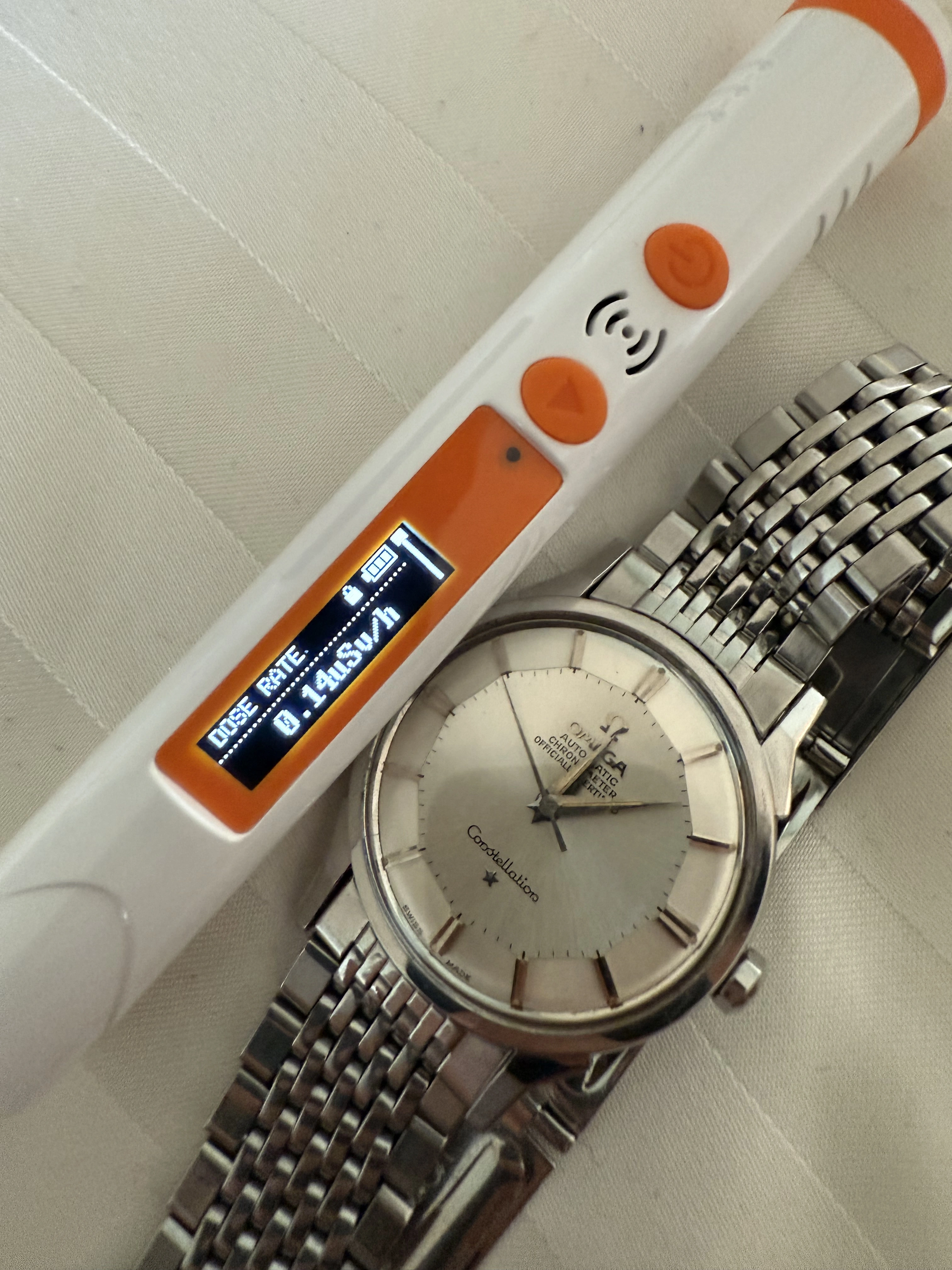

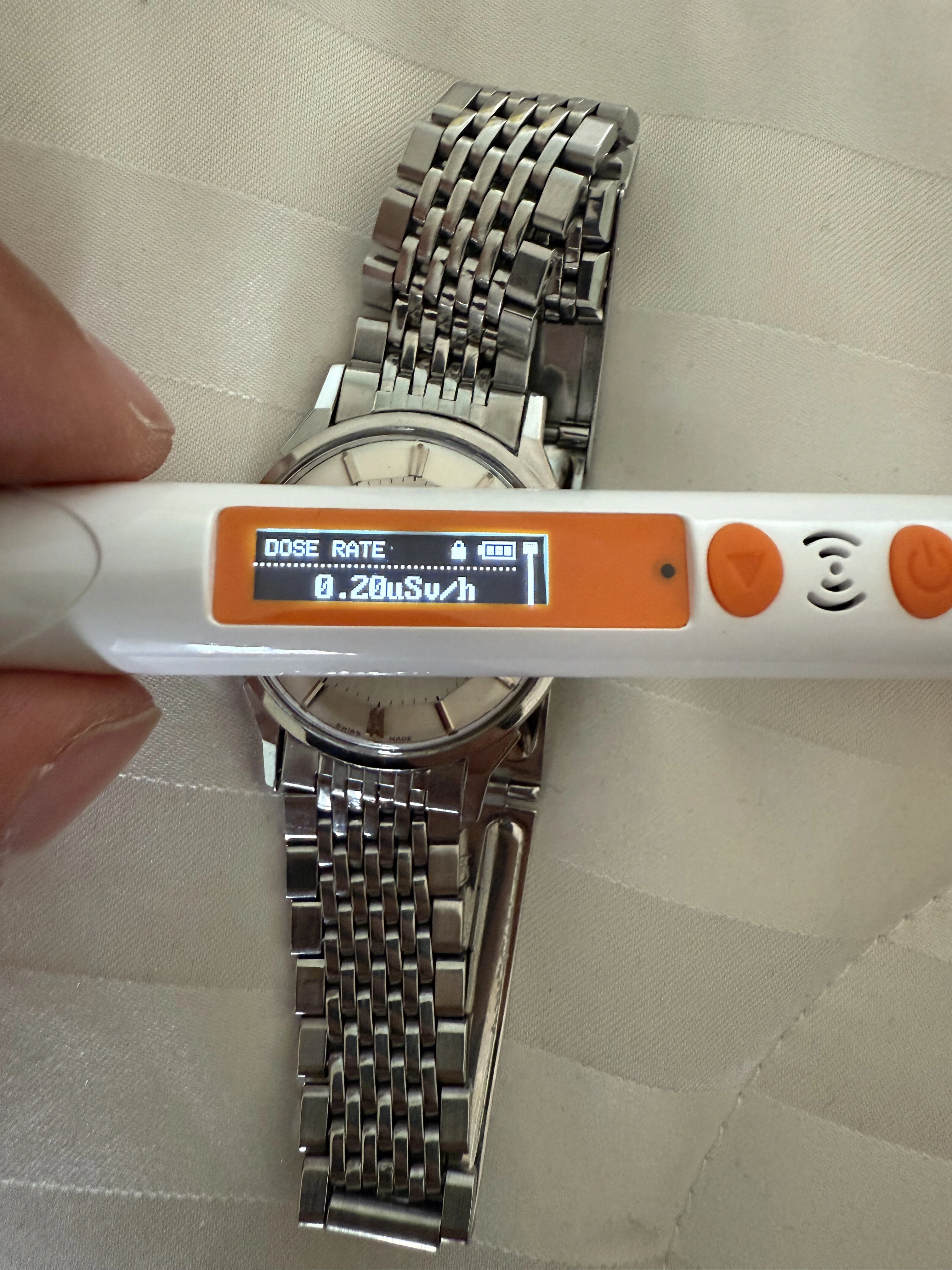

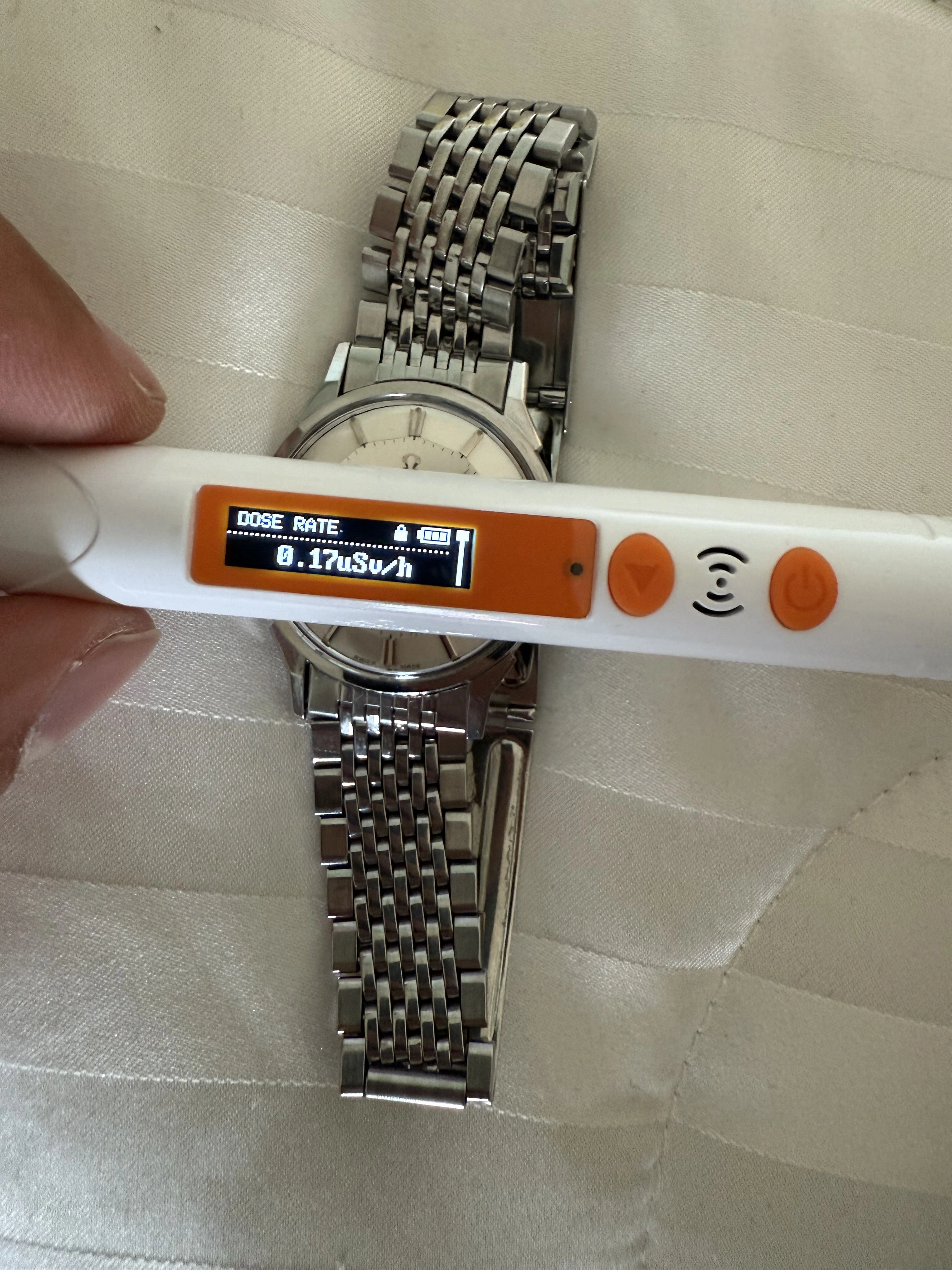

Hello, i buyed a pen geiger. This is the max value and is aroun 0.14usv/h and 0.20

It looks like suspiciously pale tritium to me. I wonder if it was redone at some point.
What is your background reading? With that serial it could indeed be either but I’d want to see a noticeably higher than background reading to be confident it was radium. Tritium won’t be anywhere near as big a difference. If any at all.
ps I know from experience cheap meters are not very accurate at all!
