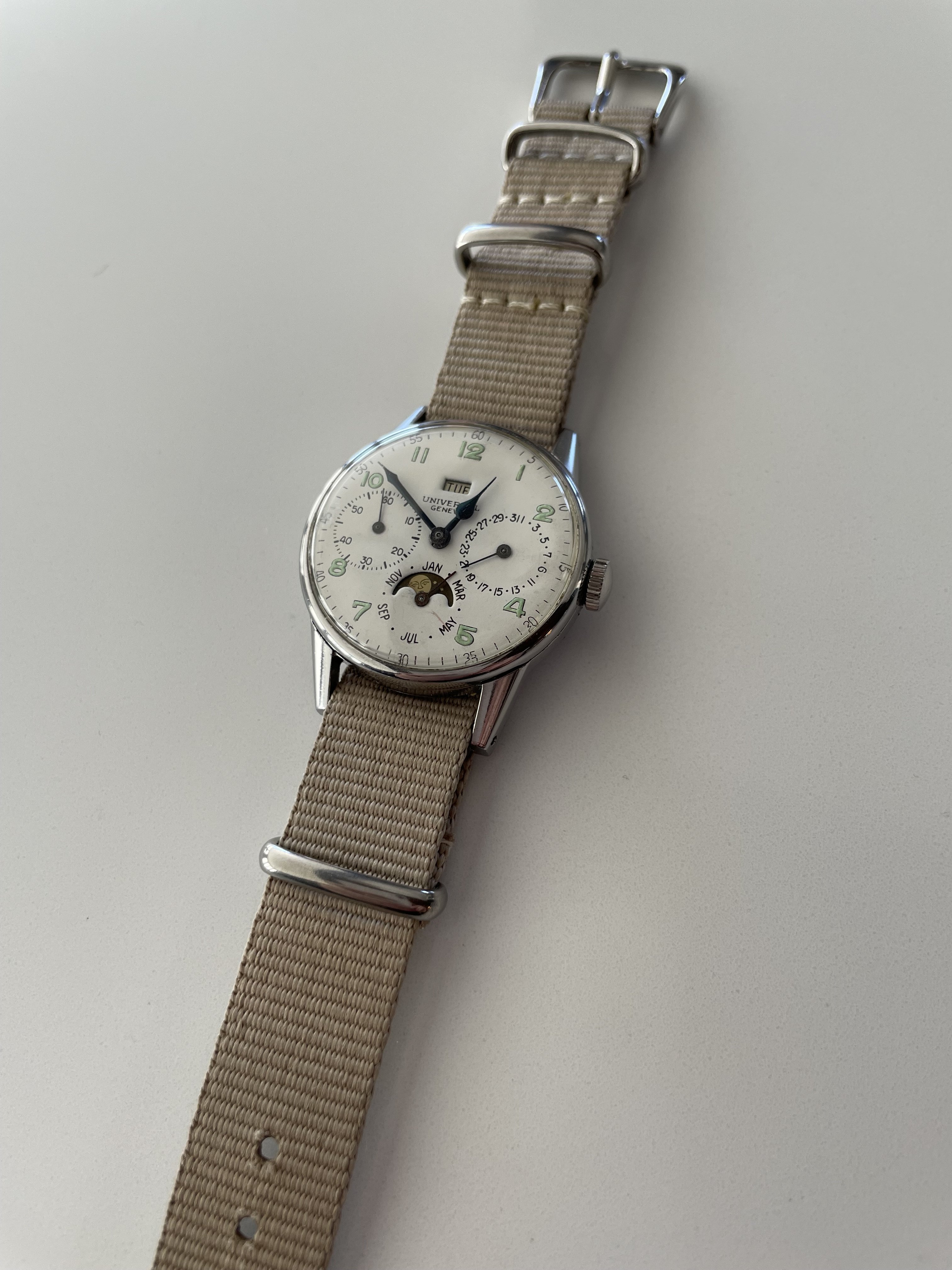

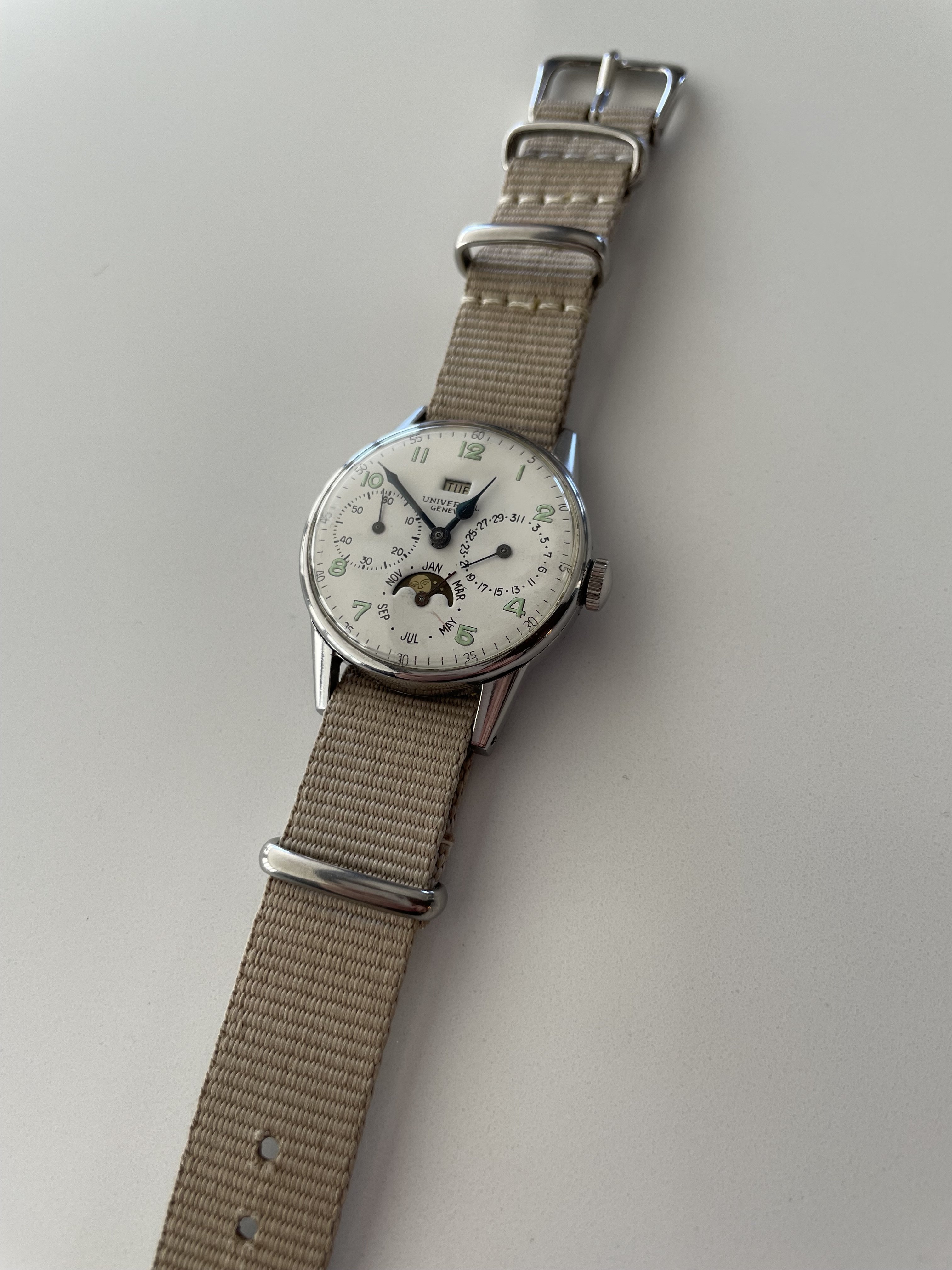

Hello, new to the forum. I recently purchased a triple calendar moonphase 21308 caliber 291 with a refinished dial. I know, shame shame, but this watch is exceedingly similar to one owned by a great grandparent that was lost from the family many years ago. So wanted to get it just as a sort of tribute, not to be this perfectly correct heritage piece.
ANYWAY
Someone has lumed the numerals along the way and the hands are clearly incorrect, not the proper lozenge diamond style with lume. So the lumed numerals make no sense at all as you can't see the hands in the dark!
Can anyone tell me where I can buy an hour and minutes hand for this watch, the correct size and shape? I'm cool if they are aftermarket, new, etc. I just want to get it more right than it is.
Thank you all so much!

Here it is, I know all about it being a redial and whatnot -- it's perfect for my specific use case. So just looking for hands that are more suitable.
3
5
And sorry to your question -- I am positive it should NOT be lumed. But I actually like it and my daughter does too who's going to wear it so I'm just looking for something with correct dimensions that has lume so I can make it work for her. I'd prefer the lozenge style if possible but any information you have on the correct size/length would be helpful.
And don't worry the retread nature was factored into the price 😀

You don’t have to defend your watch, even though most people here don’t collect redials, the main point is just making sure buyers are fully informed before making purchases.
that’s great that you and your daughter enjoy the watch as is. I don’t have suggestions offhand, I think finding a UG pair of lumed hands will be extremely difficult. I don’t know if you can make something else fit. I am not home with access to hand sizing but I assume cal 291 should be on ranfft database?

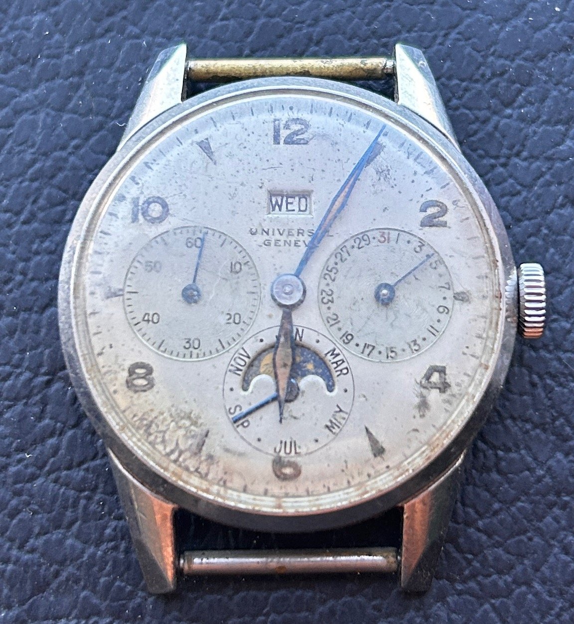

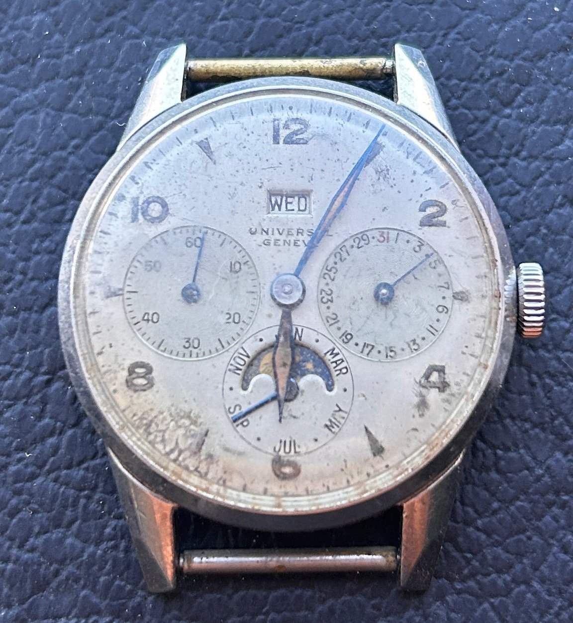

Redial and wrong hands. This is how a correct TDM UG should look like with luminous hand and luminous disl
228
297
Correct hand hole sizes are
Hand Hole Sizes Hour@ 1.58mm x Minute@ 0.98mm
cal 291 is a 13 Ligne movment and about 29.3mm in diameter
Thanks to Mr. Ranfft and his new website
