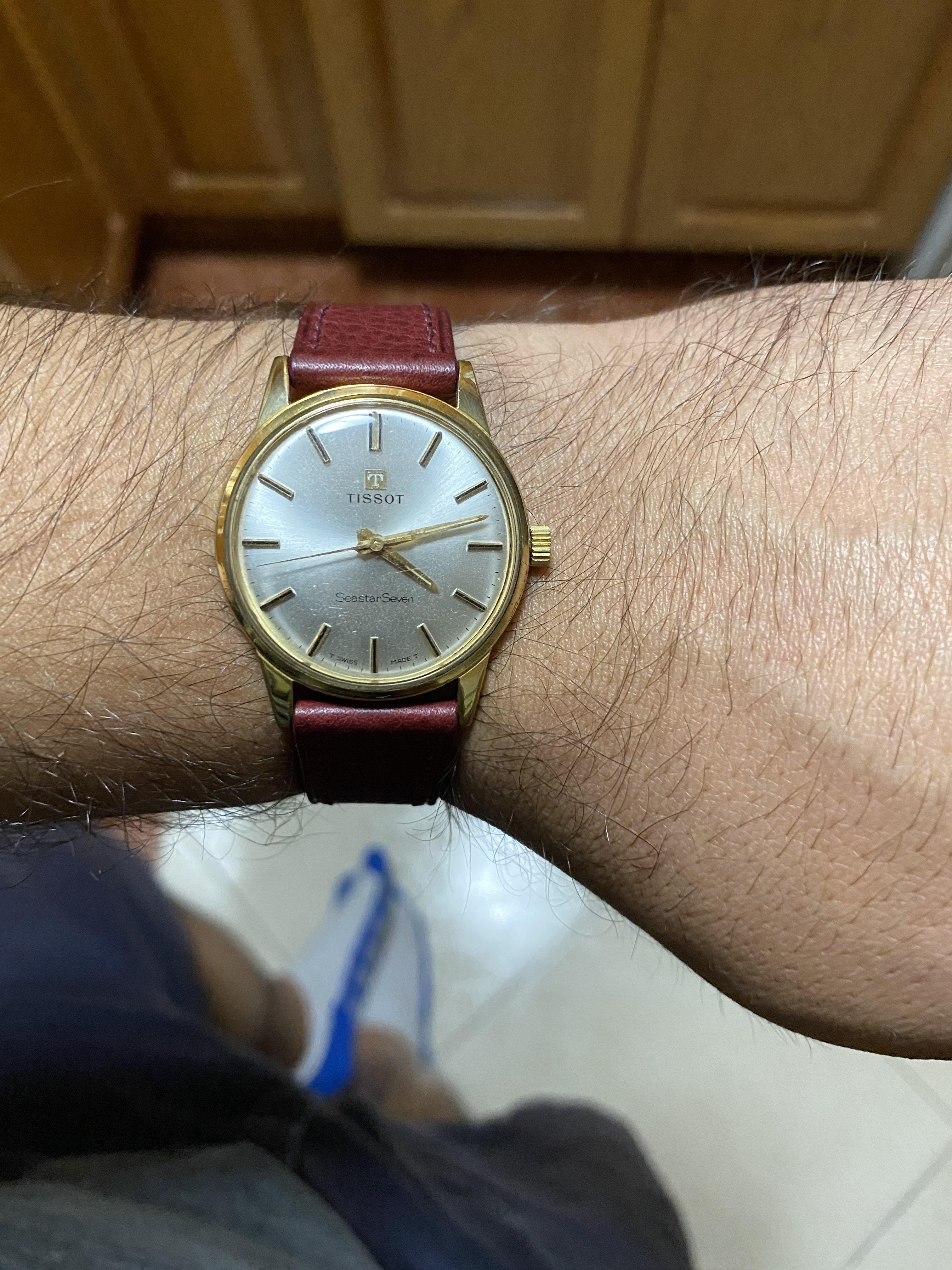

Hi,
I stumbled upon this Tissot Seastar Seven Automatic and I'm considering buying it. It is recently been serviced. The crown is original and I don't think it is a redial.
However I have one concern. At the 8 and 12 hands is some yellow tarnish forming. I assume this is the age of the watch since this watch was introduced in the early/mid 60s (right?). My question is, is the tarnish going to expend over time and how can this be stopped?
Also the watch is listed for 200 euros without box and papers. Is this a reasonable price for this particular watch?

It's not mandatory that dials get such marks over time. It has to do with how the watch was used/stored/worn or, perhaps, various accidents.
The watch is from the 1970s btw.
The hands don't have any lume, apparently. Did it fall off or is this how it was designed ? (usually it should have had lume but I don't know this particular model) Tbh I wonder whether they are the original ones for the watch. Might be replacements...
I don't know what caused the marks. Usually if you take good care of it and if it has been cleaned/treated accordingly it shouldn't spread but sometimes the damage to the paint/laquer can cause it to flake as time goes by but those are pretty extreme cases of damage.
Is the seller based in India/South-America by any chance ? Be careful of those. Can't tell for sure if the dial is genuine. Seems a bit suspicious... The positioning of the swiss made... the ink...

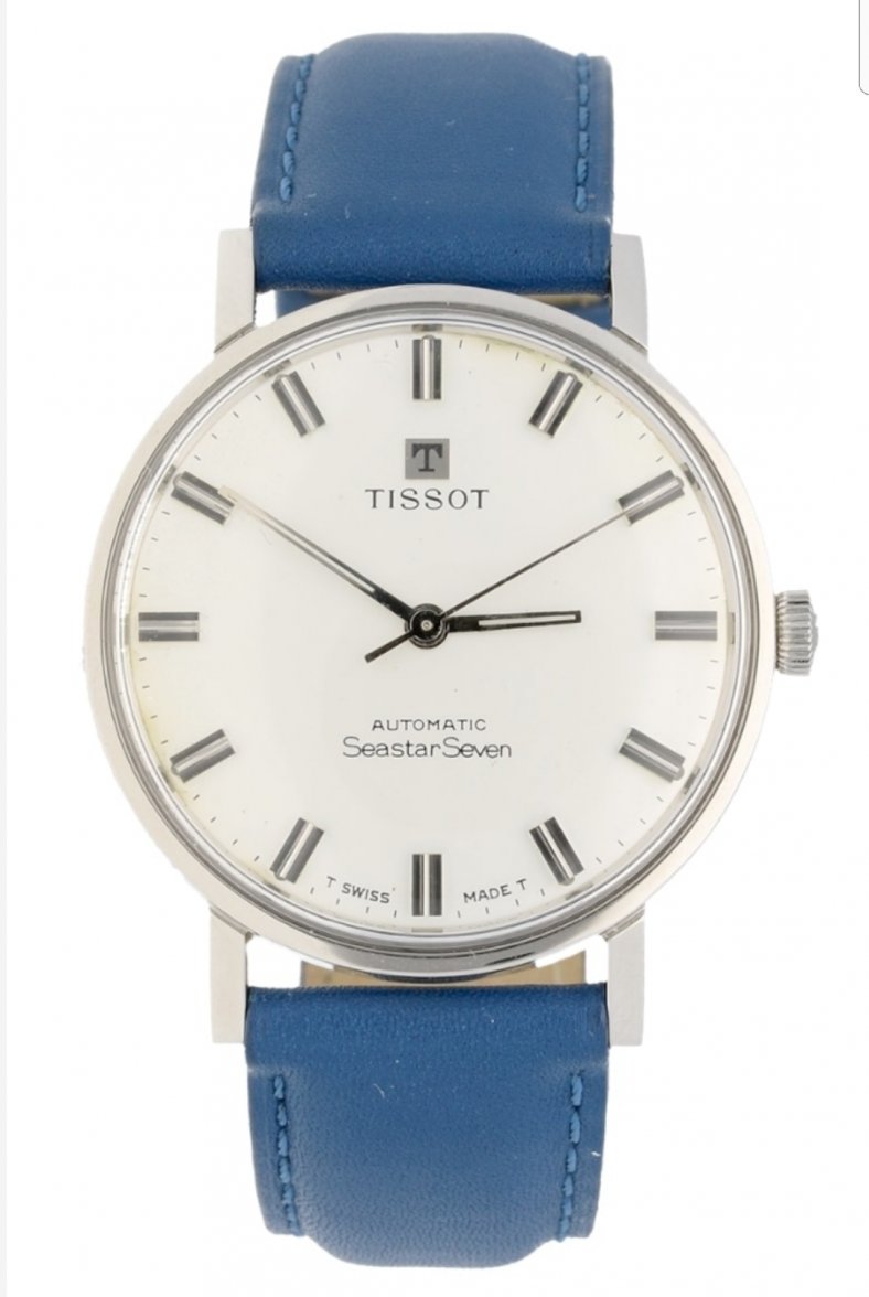

Looks a bit like this one but there are slight differences. Seconds hand, dial font is a bit different... Case has been polised, definitely.

Hello @rensvdberg and welcome to the forum!
The Seastar Seven was introduced by Tissot in 1964. The "Seven" refers to seven "essential qualities" that Tissot felt set the watch apart from others in the same price range. It must have been true, as the model line was quite successful.
The yellow tarnish that you mention is probably a deterioration of the dial coatings. It's what watch collectors refer to as "patina." Some folks think patina adds a vintage charm to a watch while others hate it.
If the tarnish bothers you, you should look for another example. There are dozens of Seastar Seven models available on eBay (and many of them look brand new) so you should take your time to find one that is really nice.
If you choose to hunt for another example, look for one that has an unpolished case with crisp, sharp edges that look like it just left the factory. Also, look for an example that retains some lume on the hands. Even though the luminous material no longer glows, it's better than having a hole in the hands where the lume should be.
However, if you're happy with the example you found, €200 including a service is not out of line for a price on these. You can find cheaper prices on eBay but you will need to factor in the cost of a service if you intend to wear it as a timepiece.

I don't know why but I'm not confortable with this dial....
Regarding the service, if there is no official bill from a watchmaker, let consider that it's not done.
It's may work properly or not .....

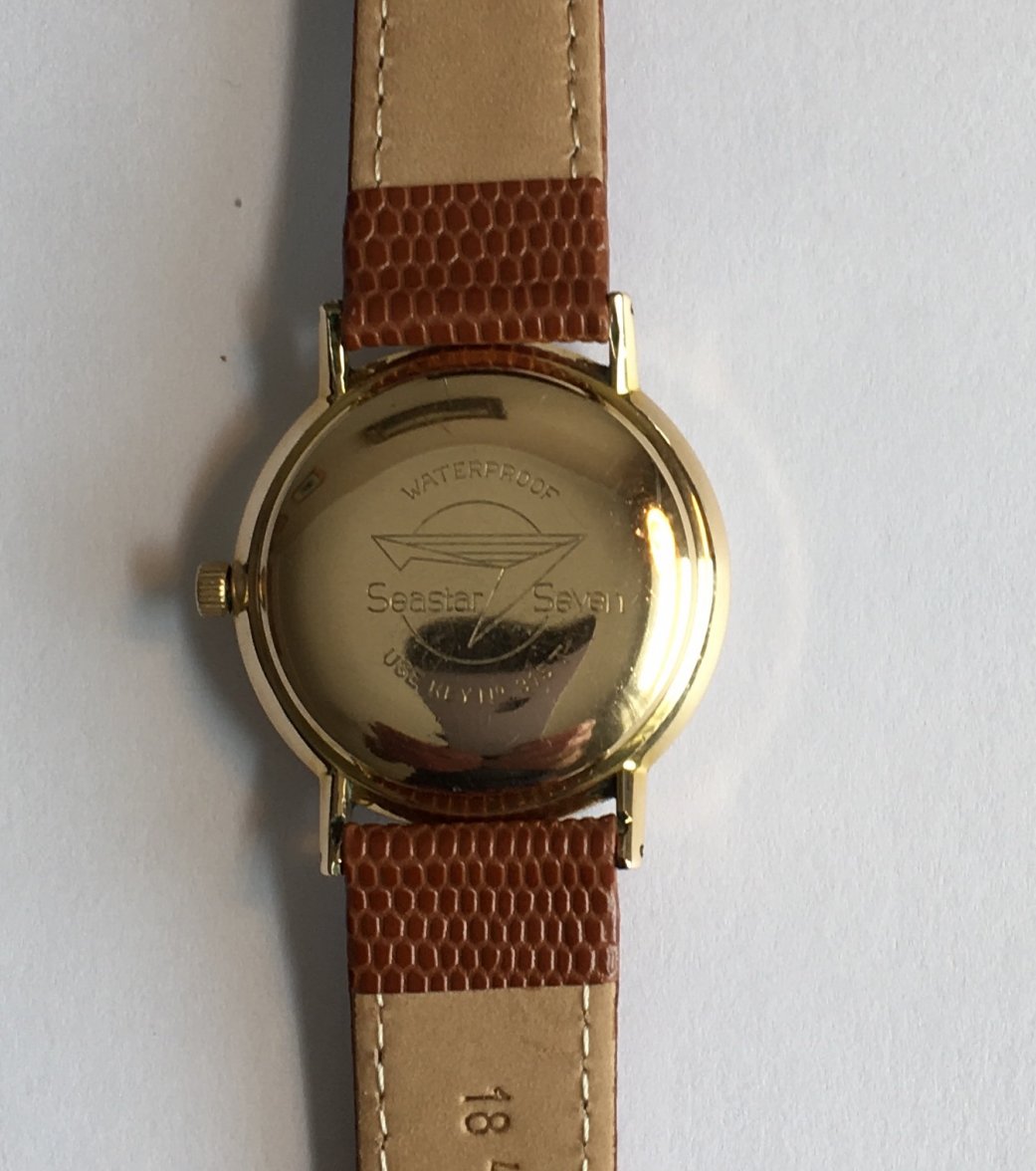

Be aware that SeastarSeven are front loader and that you will have to remove the crystal to have access to the movement.
If you want a SeastarSeven, let search for one with the engrave boat behind.

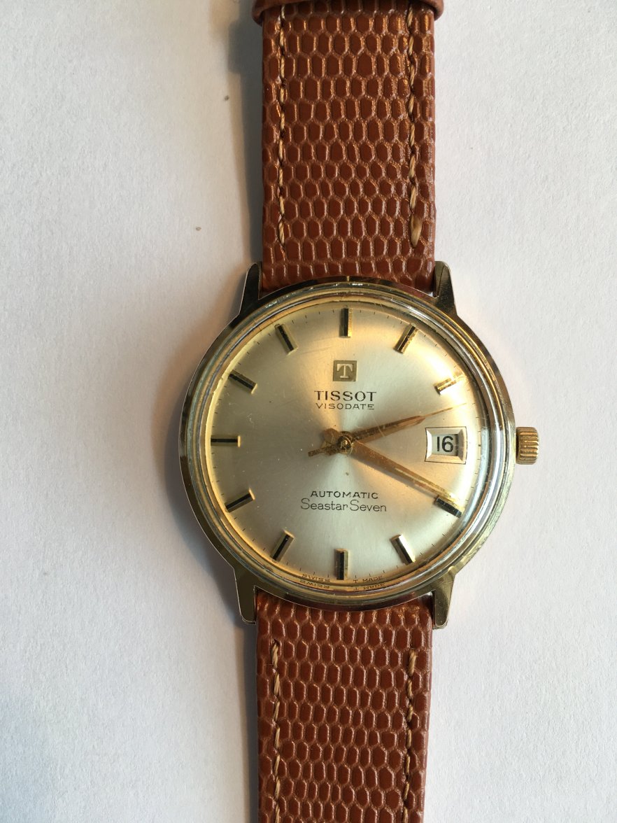

I have a soft spot for the (long title alert) Tissot Visodate Automatic Seastar Seven. These have a less clunky case/profile than the other Seastar varieties I’ve owned and I’ve always enjoyed wearing them. The drawback is that they are front loaders and (in my experience) not every watch repairer is comfortable servicing them.

Thanks for all the info! Seller is based in The Netherlands. Good point about the lumen missing, I didn't notice that yet. I think it is better to look for another better example!
Thanks again!

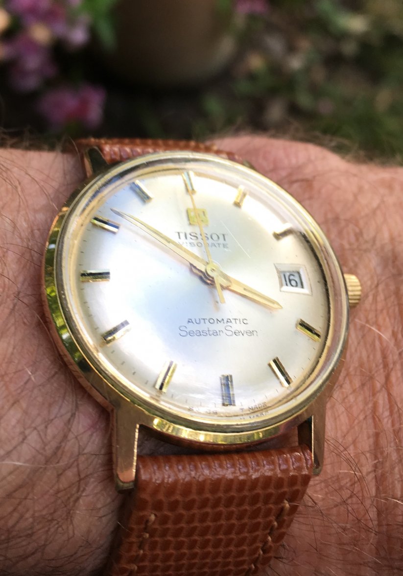

I have the same one as yours ,I love it
