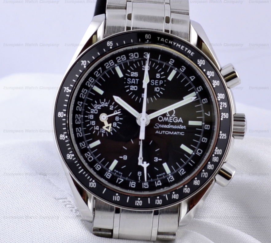

    hi, a guy offered me this Omega Speedmaster Reduced, ref. 351050, serial 56,168,810 (so 1998?)
    to 1200 Euros. with box but no documents, only from legitimate sources Document.
    Latest revision Unknown
    I wanted to know from you experts if the price is appropriate and if the watch is in order.
    Thank you all

    Are you in the market one? Are their other watches you want? Do you want to own a Speedy Pro?
    I only ask because if you have your heart set on one, this is probably an OK price, but if you just buying "because", I would pass, save my money, and work towards a Speedy Pro.

    Could be okay! How would we know about the condition? It looks okay from the exterior. Problem with the "reduced" is that many watchmaker's that service the Speedmaster Professional, won't touch the "reduced"! I speak from personal experience, being the owner of one of these. I had owned the watch for ~ 20 years. It had been an abominable performer! Totally unreliable. I sent it to Omega, Canada, for an estimate. They quoted me somewhere south of $600.00 (Cdn.). I told them to do it. Six weeks later, I got the watch back. I immediately checked the movement. They hadn't serviced the original movement! They replaced it! Today, it is a highly accurate, reliable, thoroughly satisfactory watch, and I am very happy I had it done. I like the watch!
    €1,200.00 ? Can't help you there but to say you'd pay a chunk more for a Speedmaster Professional! That translates to just south of $1,800.00 Canadian! Add to that the cost of servicing the movement (or replacing it)? Pretty well bite the bullet, and take your chances! Maybe check out the return privilege if the watch doesn't measure up?
    In a recent thread on this MB, the reduced was compared with the Professional. There was a landslide in favour of the Professional! So if you follow the consensus of those who might reply, you might lean toward the Professional. I have one of those as well. Follow your nose, and buy what you want. But before you buy, you might check out the reduced vs. Professional thread on this board.

    The reduced looks to have had next to no wear. Mine looked like that after 20 years of ownership because I couldn't rely on it. I think you are in a situation where, if you buy it and it is to your satisfaction, so much the better. But if it is a lemon like mine was, how will you feel having to spend another €400.00 or so to have the movement replaced? Even if you have to do that, Lady Luck is smiling on you! You have the watch you want for less than you'd likely have to spend on a Professional. And who knows, buy a Professional, and it could be you'd have to ante up a chunk of cash to have it serviced! I'd say, Go For It! Let us know what you do, and if you buy it, let us know how it turns out for you. I have a reduced, and a Professional, and as chance would have it, today I am wearing BOTH of them! That reminds me. As soon as it hit the reply button, I have to wind the Professional. No worry on the reduced!

    As I've said before, in Canada these are "serviced" by performing a whole movement exchange. The movement in your watch was removed, checked for major damage (for example rust), and sent to Bienne to be refurbished. They then install a previously refurbished movement from someone else's watch from somewhere in the world in your case.

    It's not a moonwatch though, technically, so in some ways, I agree with watchknut. If you're getting this instead of a moonwatch, then it's worth waiting and saving a bit more. If you want the same look with auto movement, then this is definitely a good choice.

    I have no problem if someone wants to buy one of these, but I don't think there's a problem with pointing out the potential pitfalls of this watch. Aside from some of the technical things, it's not unheard of that someone buys one of these either thinking its a Pro, or not fully understanding the movement. It's also very common for someone to buy one of these, then realize a short time later they really want the Pro, and they take a hit on resale.
    Feelings on this movement are certainly mixed. This recent thread talking about problems with the movement after service, and slop in the hands being "normal" are things that I think people should be aware of as potential problems:

    Hey @stefy56, the price is about right, based on what these sell for open market (no box/papers/recent service).
    Based on your wish for a smaller cased watch than the Speedmaster Pro (Moonwatch), it might be worth looking at both the Speedmaster Date, and the Speedmaster Day Date.
    Both are similar case size to the reduced (1mm larger), but as far as I understand it, are thought to have better movements.
