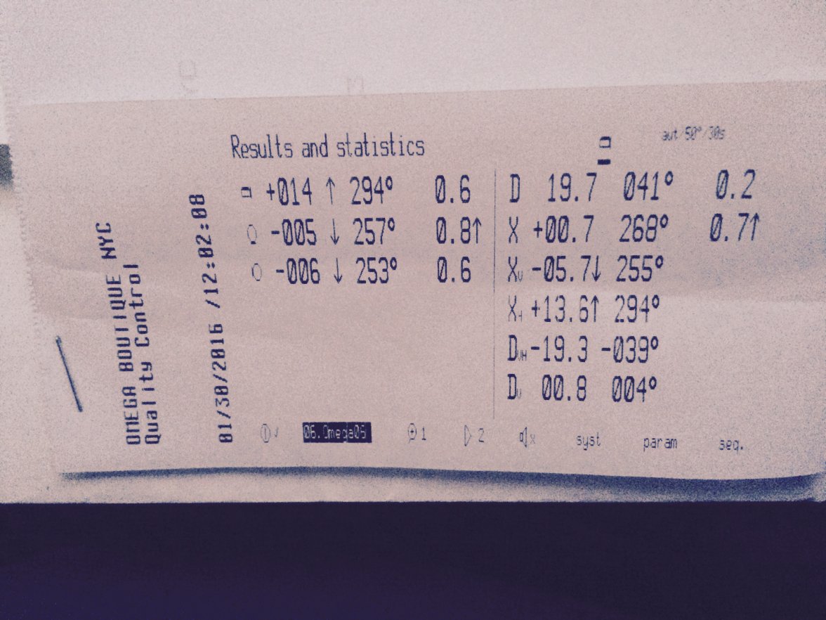

    image.jpg image.jpg I was in the vicinity of the Omega boutique in NYC today and decided to stop by and have them take a look at the movement of my recently acquired 145.022-69.
    It was an interesting experience to say the least, more on that below.
    But first, I was hoping for some advice from forum members on interpreting the timegrapher results. The watchmaker said that the seals looked good and the pressure result was good, and that the movement was running well but could use a full service as the oils were probably drying up. No surprise there for a 45 year old watch. I've attached the results. Does anything stand out as problematic?

    You can't tell if the movement is fine from the timegrapher results as it could be running dry and chewing the pivots. Have a search on here for something by Al @Archer as he posted a thread with one watch that measured okay but was suffering wear.

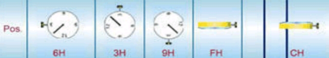

    From an interest point of view, the numbers on the left are for three positions, which is all an 861 non chronometer needs to be measured in but, most people would do all six. The three positions are CH, 9H and 6H. Here's a little picture of the various positions (5 for a Chronometer) but missing 12H which is an unnatural position on the wrist.
    So, you have horizontal amplitude of 294 degrees and vertical of 253 degrees, minimum. Both of these are fine but vertical could be a little better.
    The daily rate varies across the three positions from +14 to -6 seconds a day. Can't remember the spec on these but I think it's a delta at full wind of 25 seconds Max.
    You have a Max beat error of 0.8 ms which just happens to be the maximum allowed.
    All the numbers on the right are derived from those except the small ones at the top which are the lift angle (50 degrees) and, likely, the test period of 30 seconds.
    So, assuming this is full wind, it doesn't look too bad but I would not be happy with the rate variation or beat error. You really need to make a +24H check as well (wind fully, leave for 24 hours and do it again) as there are another set of specs then as well as average rates between 0H and 24H. You should also test with the chronograph running when there is an allowable amplitude drop. There is quite a lot in this....
    Long explanation to say I'd get it serviced anyway.

    Chris has covered the timing machine results just fine, so although amplitudes look reasonably good from what's there, there's little doubt the watch needs to be serviced to prevent damage.
