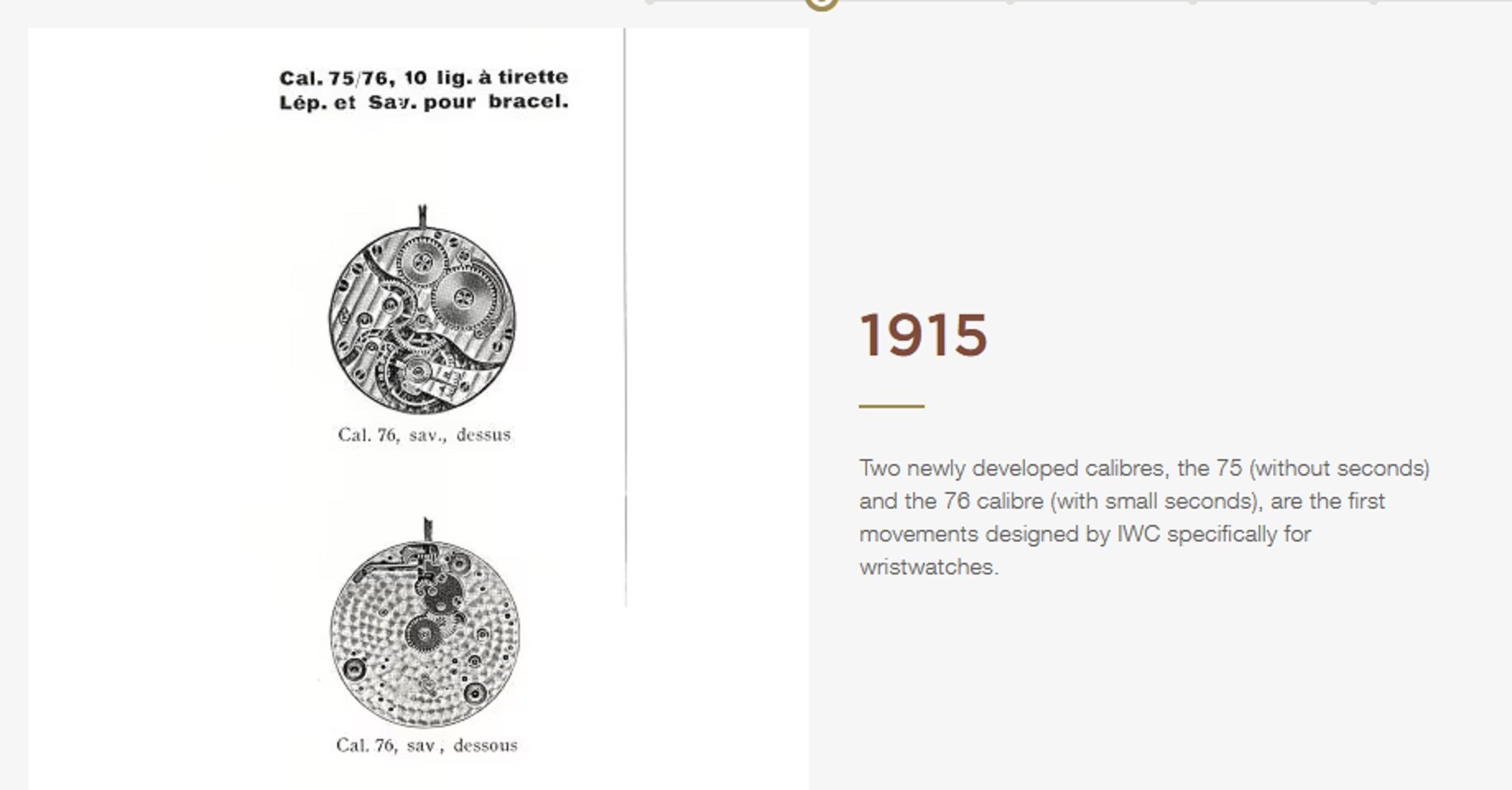

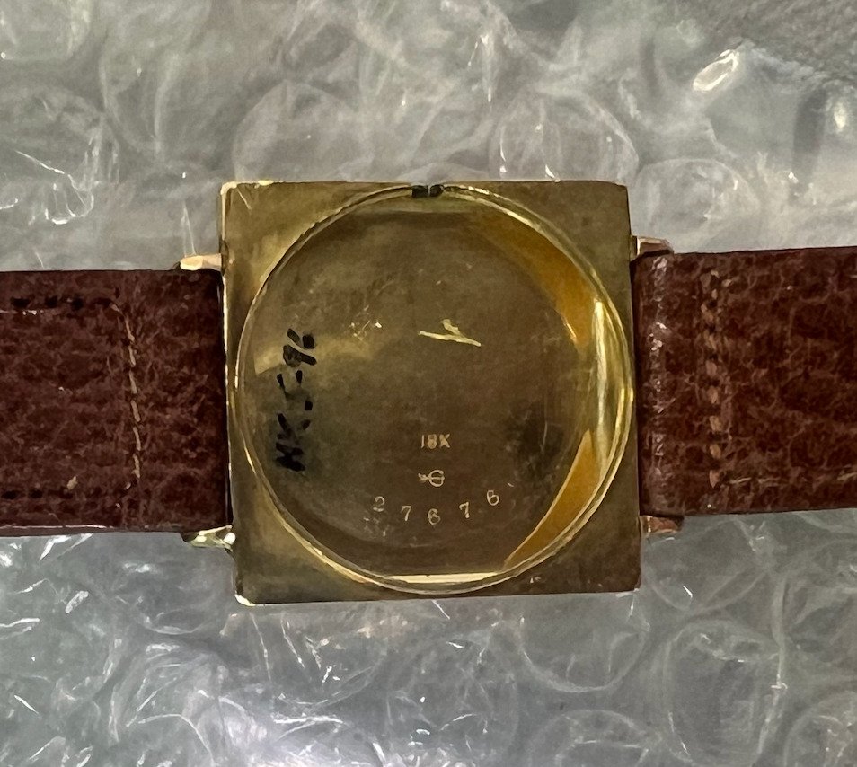

The movement is an IWC cal. 75, 10´´, which was the first wrist watch movement produced by IWC. The cal. 75 was intended for women´s watches in round cases and for men in square cases. The case bears the Cresarrow trademark and was made by Henry Blank & Co., USA. In 1912 Henry Blank had journeyed to Europe to conduct dealings with IWC, among others. He returned to the USA on board of the Titanic and survived. His firm was a supplier to Tiffany, including watches. These historical details match the date of the movement.

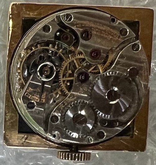

The movement has the IWC trademarks and is of the highest grad. It has an overcoil hairspring, 19 jewels, and is regulated in 6 positions. The import of this movement into the USA must have been rather expensive.

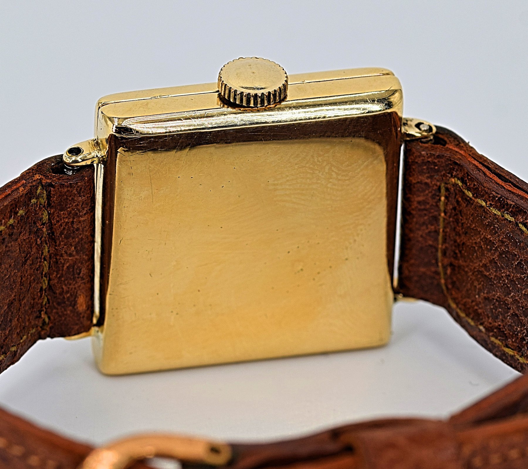

The case is in 18K gold, really heavy and of exquisite quality.

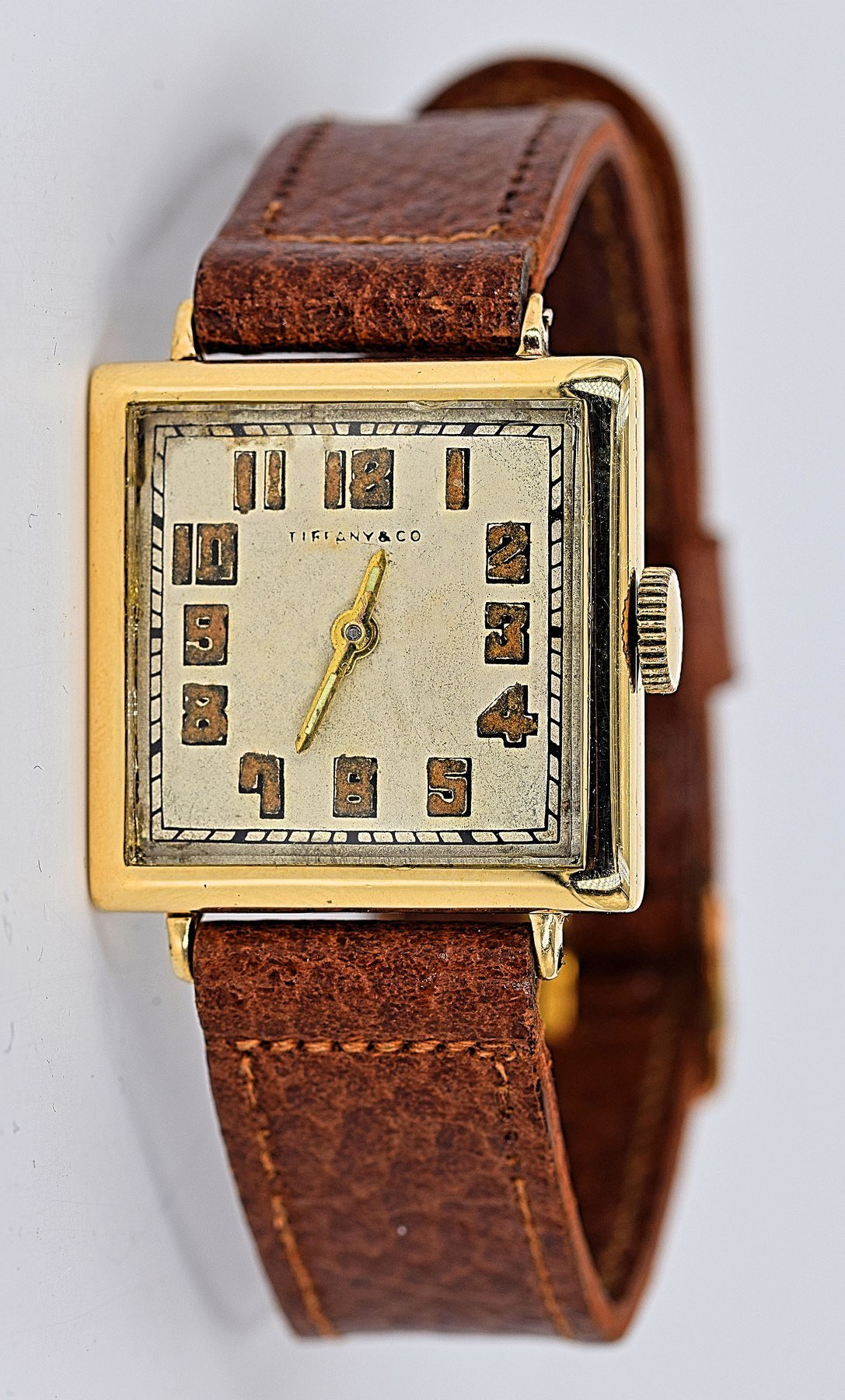

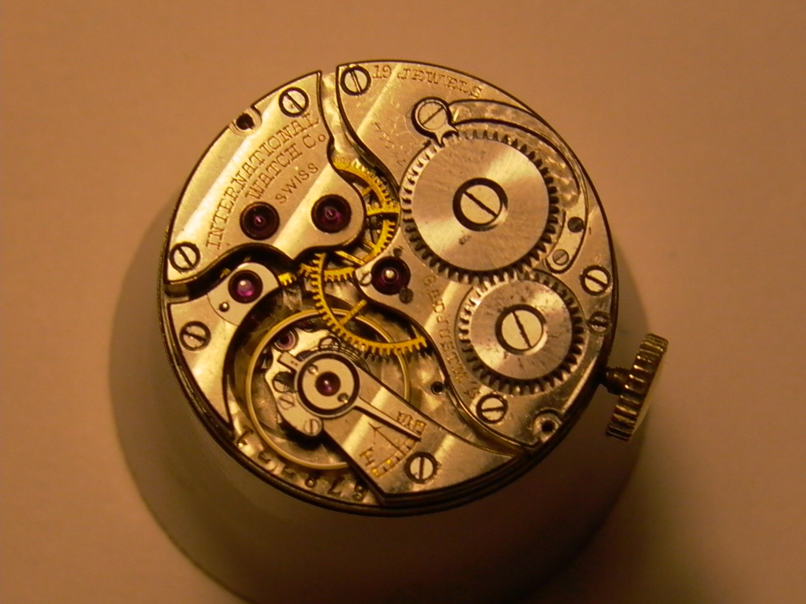

Here are few sellers photos, the movement photo really fuzzy. Would you have recognized? It was a positive surprise to see the movement being of highest finishing grade. Good movement photos of both movement sides are to follow.

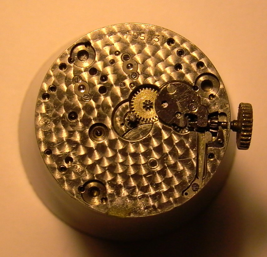

Here are photos of the movement, which I made yesterday evening. The three large circular recesses in the dial side of the movement are subject matter of the Swiss patent CH 55231, which is noted on the movement. This patent relates to a special fastening feature for dials. In case of my watch the dial is however attached in a conventional way. The dial has a rim and is snapped onto the movement.
The movement runs well and the missing/broken off screw of the center chaton seems to be an optical flaw only. I do not intend to touch that.

Nice catch! I like it. The movement is marked “6 adjustments”. I suspect that doesn’t mean adjusted to “6 positions”, but rather three or four positions, heat, and cold, and possibly to isochronism. I still like it.

The coolest watch I have seen this year, even with the slightly unlikely looking hands. Congrats, fabulous.

Also nicely aged radium for how old it is 😀

The cal. 75, as the first wristwatch movement of IWC, was intended for both, men and women. With round cases (and thus a bit smaller) for women and (somewhat larger) square for men.
With respect to the "6 Adjustments" one can only speculate. For example you can find American pocket watches marked "Adjusted to 6 positions'", which is rather uncommon to Europeans, which are more familiar with 5 positions (and additionally heat, cold, and isochronism, if any).
Yes this one indeed would have had the risk of being melted down, in particular in view of the really massiv case. I estimate it to have more than 25 g. Henry Blank & Co. were mainly active in the jewellery sector for companies like Tiffany & Co. In a time where the name Tiffany stood for really exclusive luxury.

given how exclusive this watch must have been in its time, it might even be worth it to ask Tiffany's in New York themselves. Where they might usually yawn and decline going into their musty archives, I guess they may be interested in this. While I'm pretty certain that the hands are not original to the watch, everything else looks ... museum quality, almost.
It's possible they still have some sales catalogue, or maybe something can be found out with the serial number in the case? It's a (super) long shot, but who knows, you may get lucky. And if I was working for Tiffany's, and if they have anything like "interest in their own history" & an archivist position, that would be the perfect excuse for said archivist to go on a deep dive into "why Tiffany's was a great company back then, and still is now". It might make for some great publicity for them...
