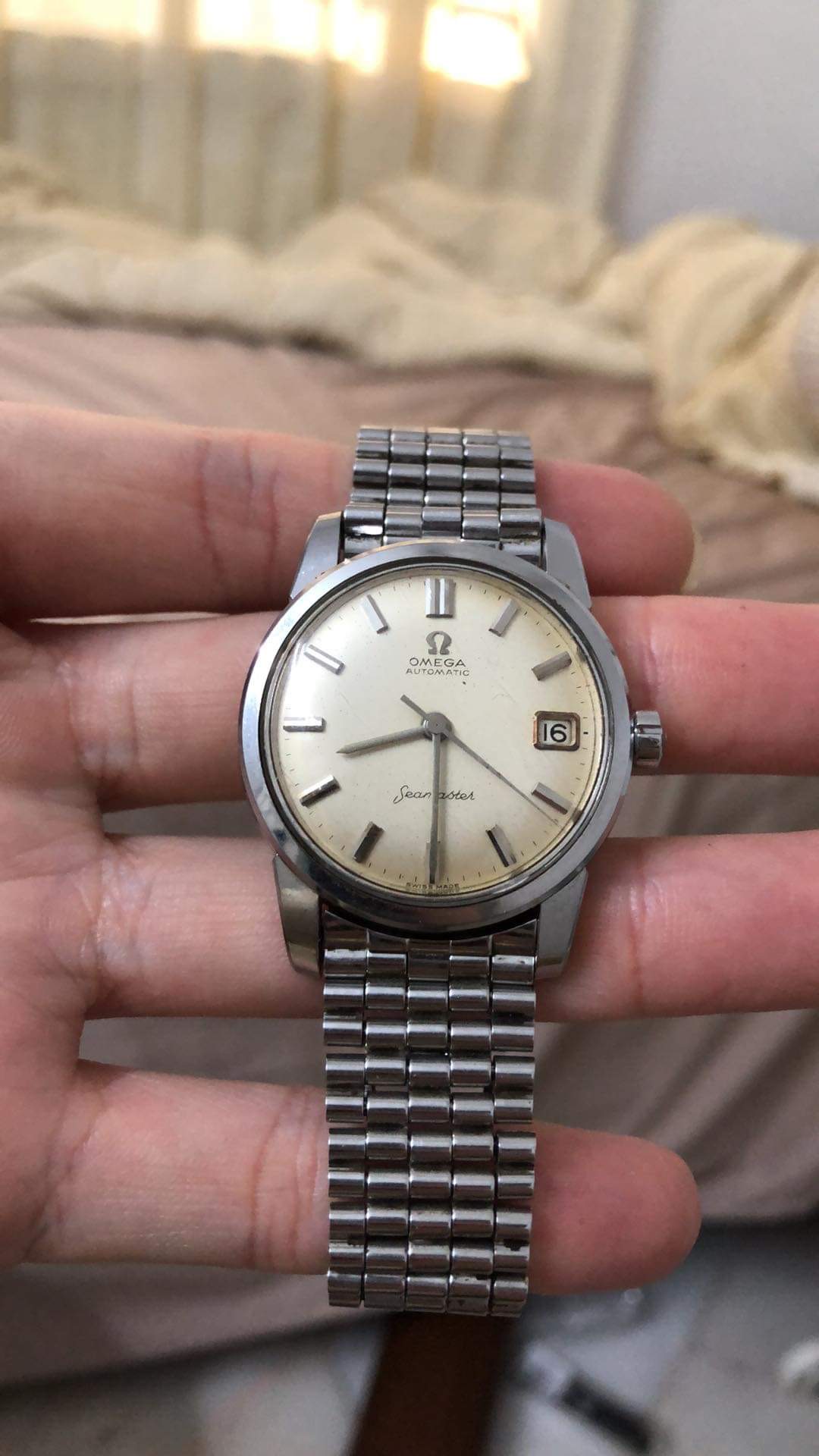

Hi guys!
I think the dial/case looks good but the hands look a bit weird. So looking for some opinions on the authenticity of the hands
Movement is Cal.503
Appreciate the help!

Hands are omega but from another reference, imho.

I am used to see hands with lume on this model but i seen that on the lower side on the dial it's only written "Swiss made" without "T" so maybe are correct. You can also search more details with the reference number from inside the watch.

I don't see lume on the dial so this is a non-lume watch, also may pre date 1962 so there would be to "T" with Swiss

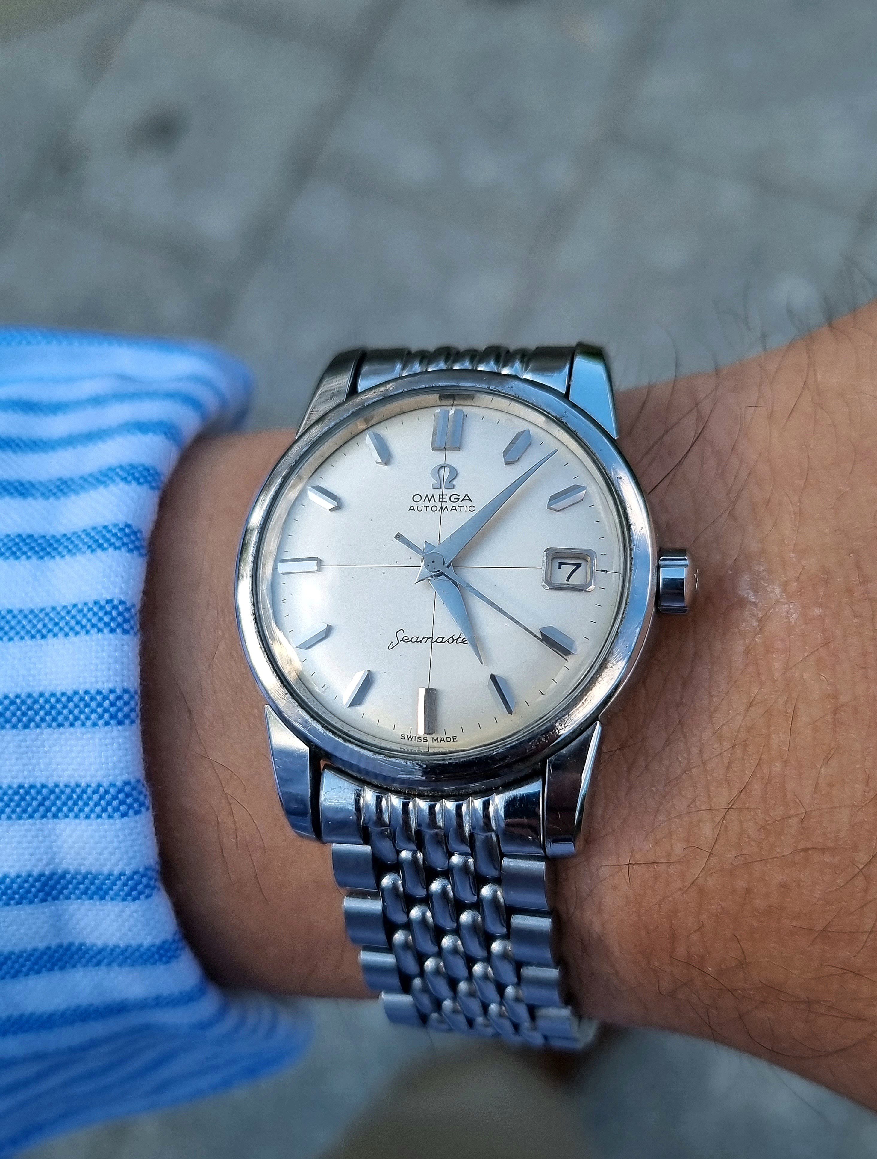

As noted, the hands should be dauphine. Here is an example:
Yours has an extremely sharp and nice case though. As well as a very nice dial. 👍
If very cheap, it could be the start of a project. But non-lumed hands can be hard to come by.
