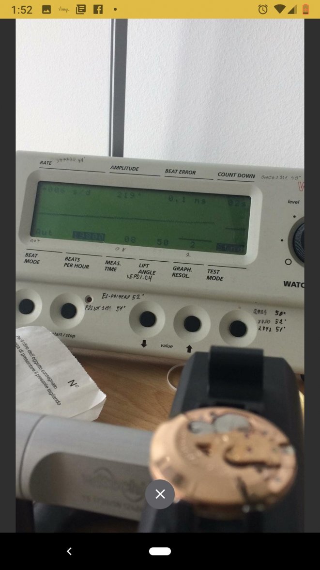

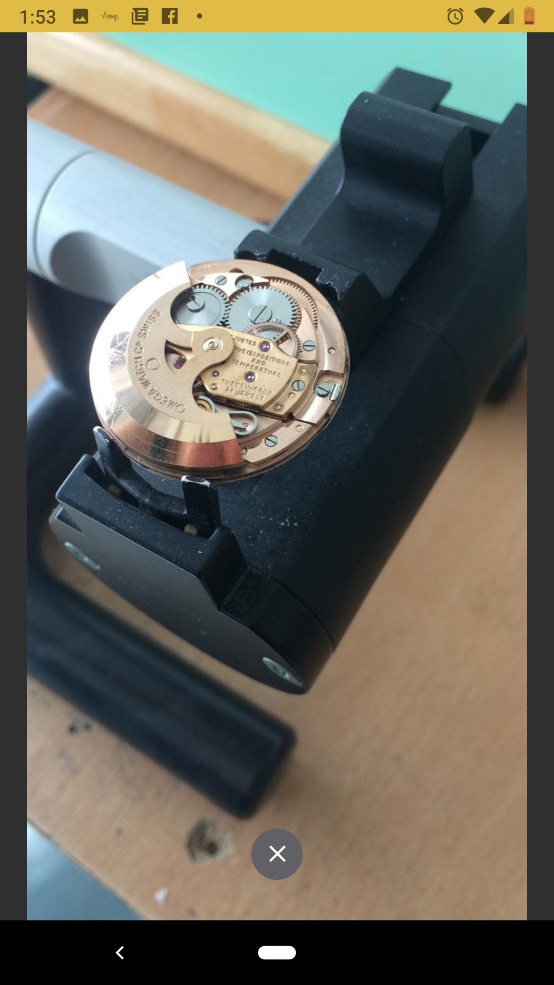

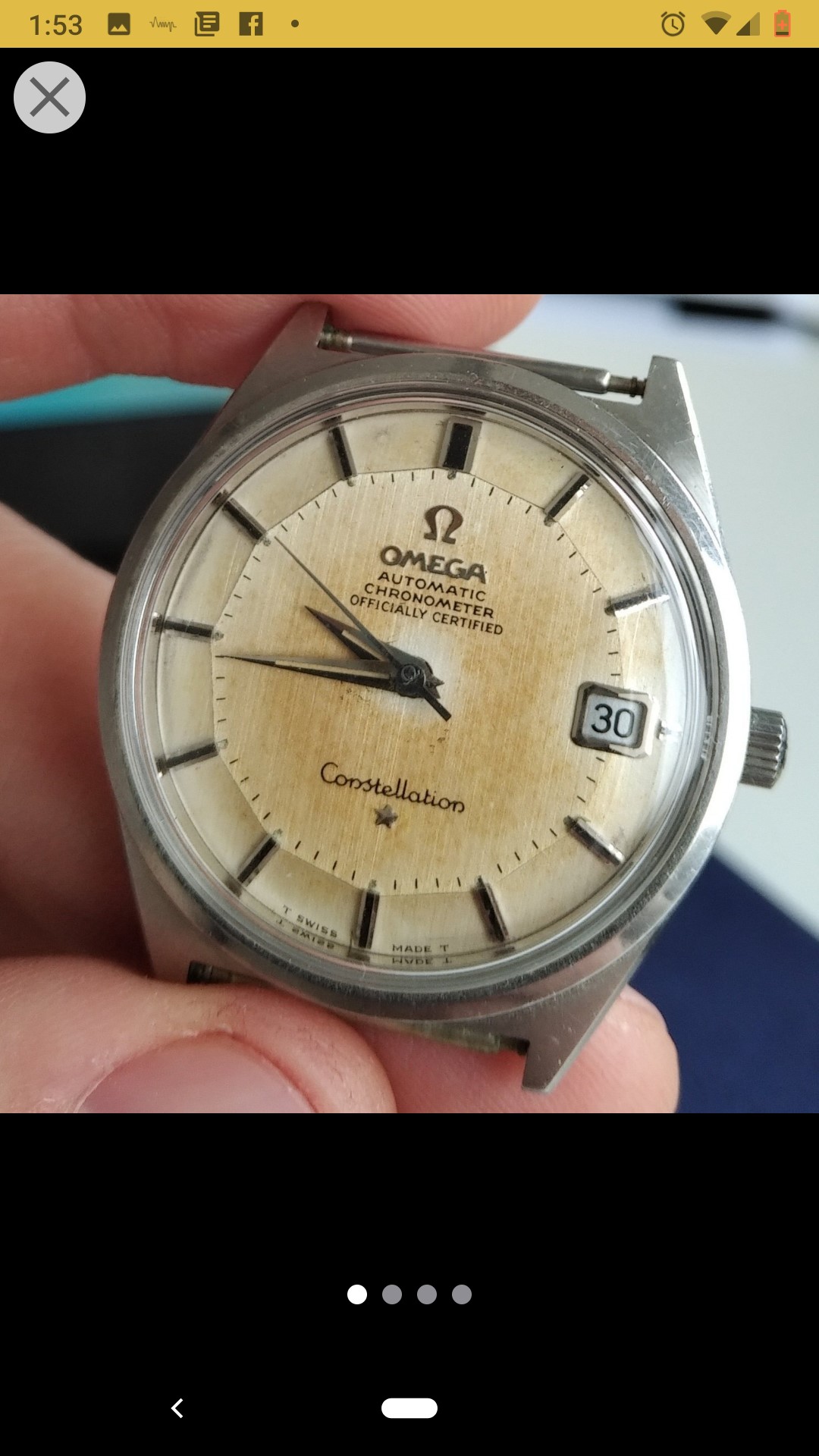

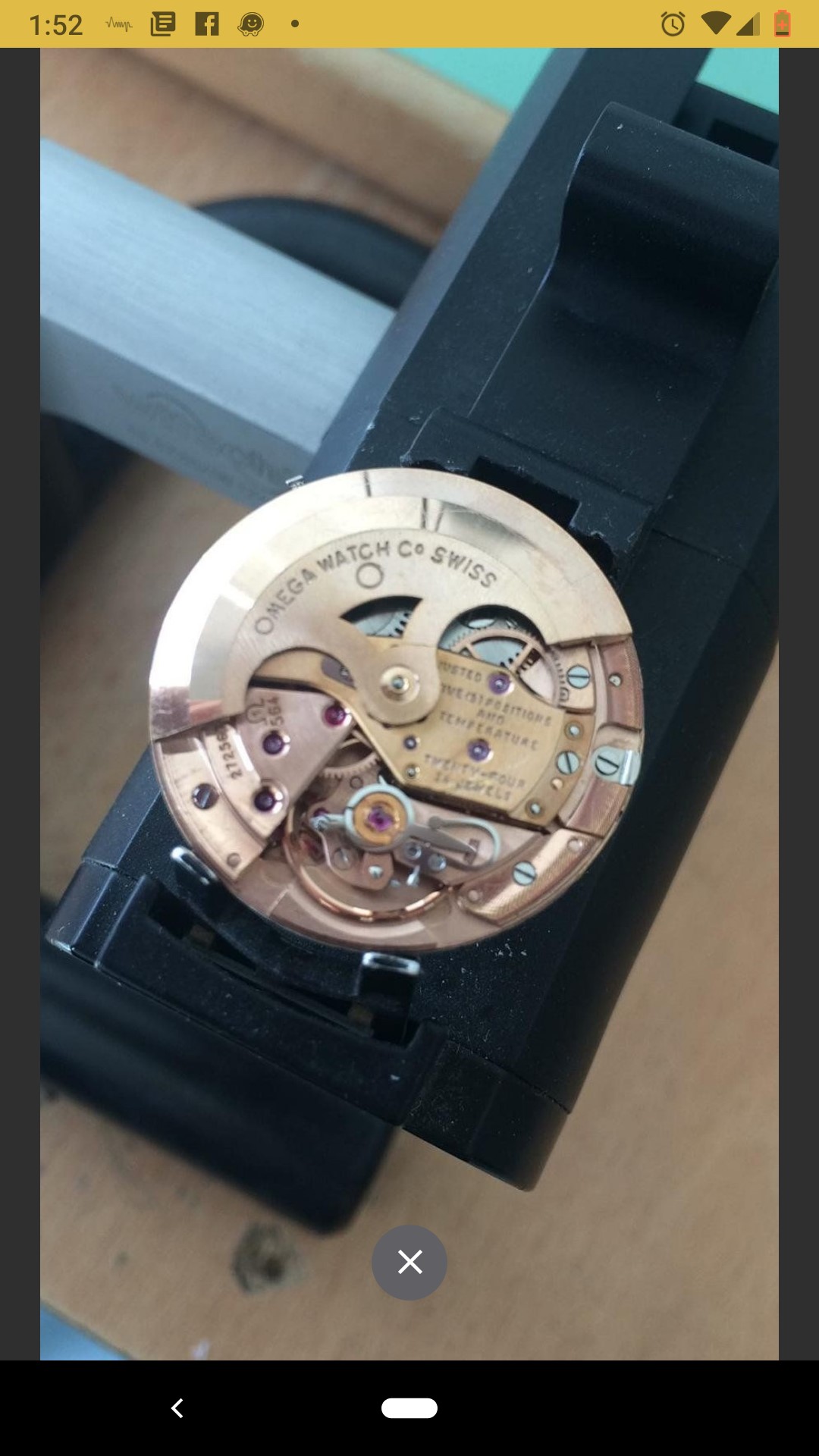

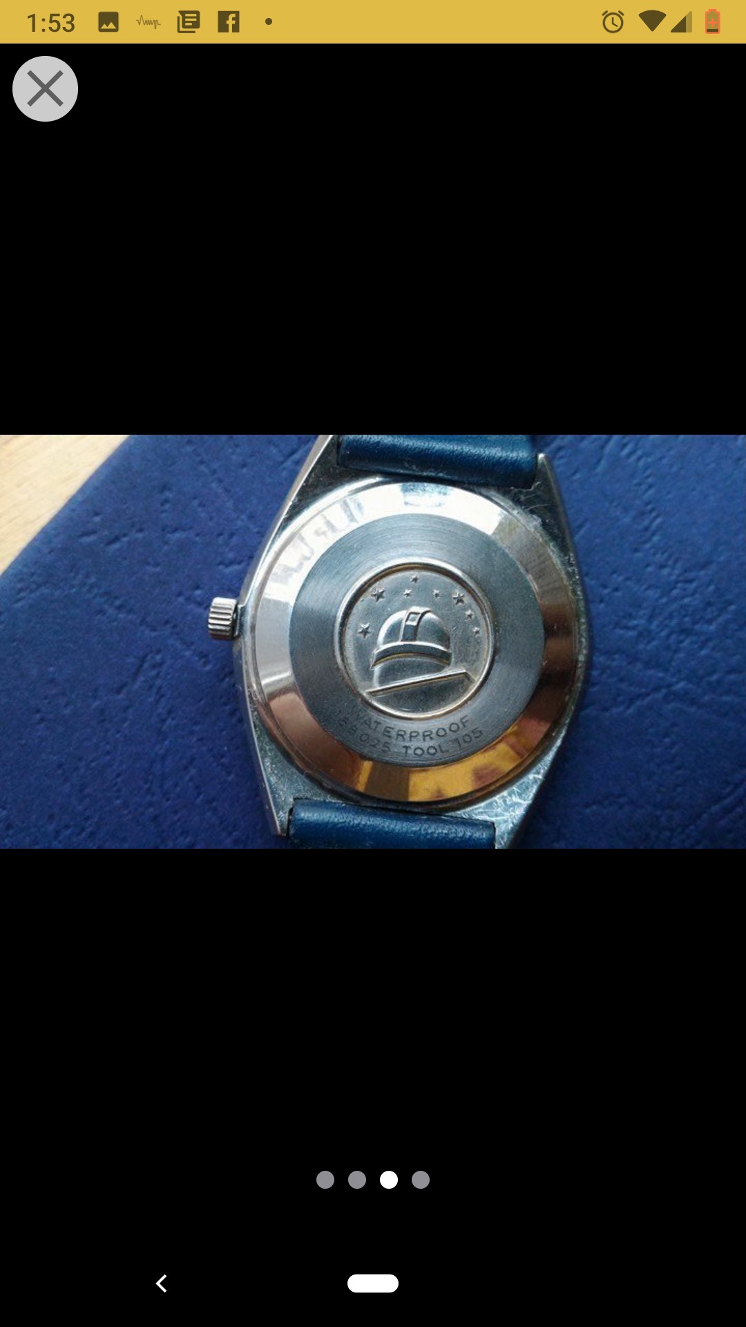

    What do you guys think about this one, a bit patina on the dail, is it too much?
    Does everything look ok?
    "Original, genuine Omega Constellation from 1967, Size approx 35mm, 168.025, caliber 564. Watch has been serviced approx 2-3 years ago. Good working order. Very nice patina. Original Crystal & Crown. Reasonable reserve"

  7. ChrisN May 3, 2019
    2,218
    4,756
    Lift angle wrong in the timegrapher so, it's just above 210 degrees in reality. If this is at full wind, then it is 20% low so reckon on a full service in your bid. Can't commit on the rest as on my phone and it's hard to tell but, I don't like the dial patina...
    Cheers, Chris
    Archer, Anders and efauser like this.
