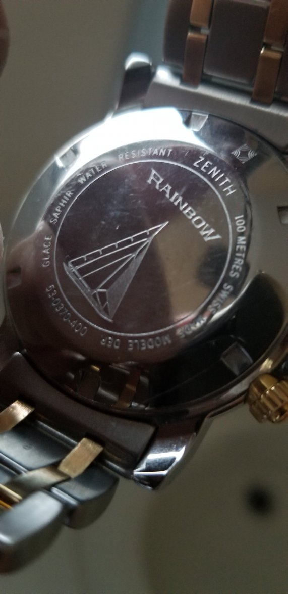

Thoughts on this early 90's Zenith Rainbow
1,534
3,246
Here is the back of my 1993 Rainbow and it is engraved, not laser etched. The rest of the watch looks legit to me.
90
159
Agreed.
