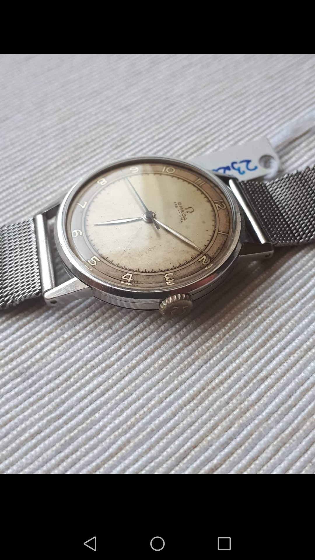

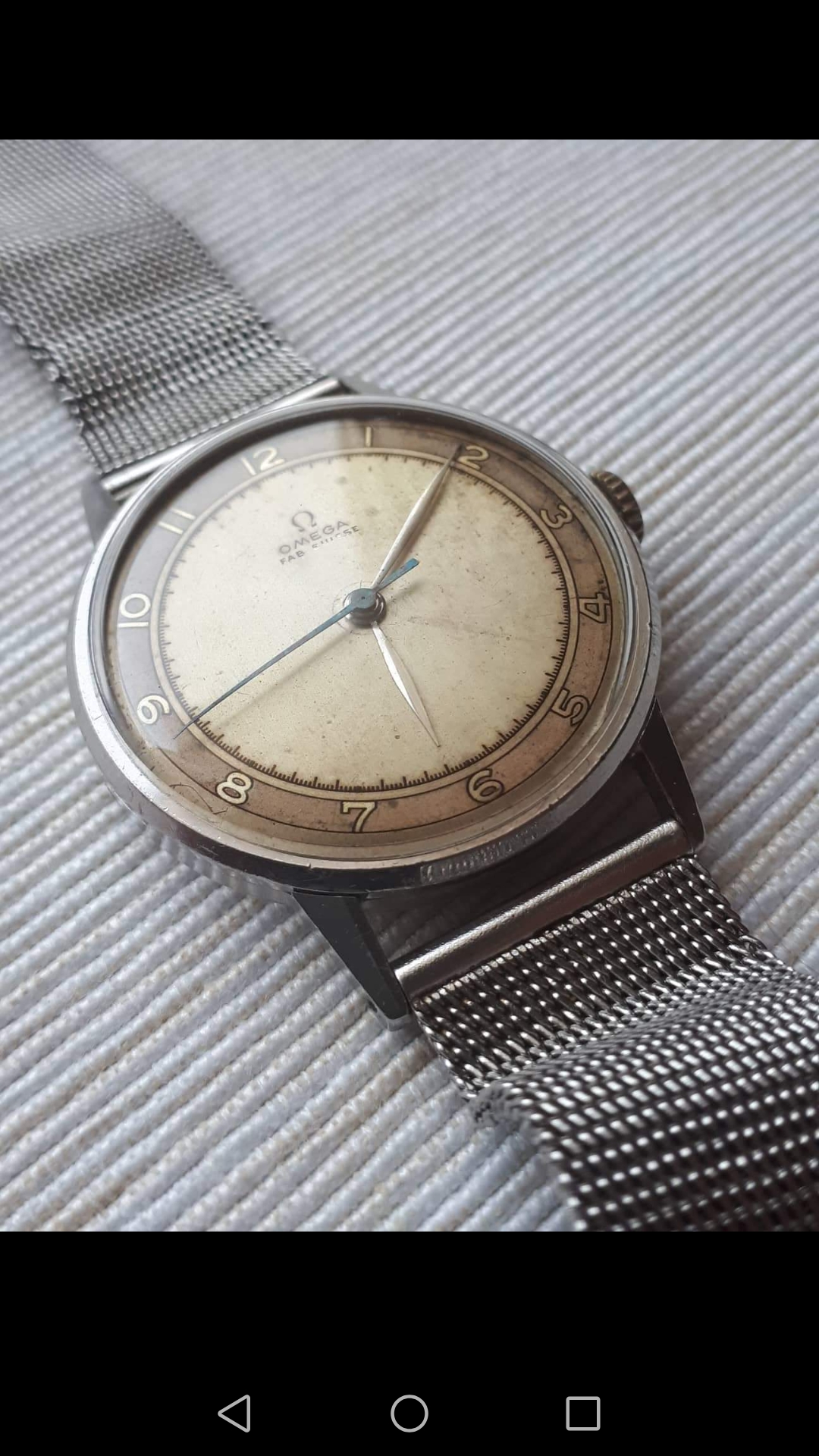

    What do people think of this 30T2? Seller asking 510 euro including shipping. It is 35mm. Original dial and crown?
    Thankyou

  2. Tony C. Ωf Jury member Jun 10, 2019
    7,387
    24,221
    Looks nice, and the dial, I would say, is both uncommon and desirable. Crown may be a later replacement, but that's not a big problem.
    I think that the second hand may also be a replacement, as typically the point would end directly on the second track. However, if the case is correct, the back is clean, and the movement is also in good condition, I would say that it would be tempting at around that price, as the minor issues could be resolved.

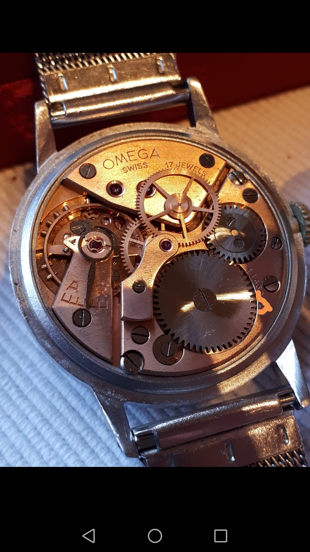

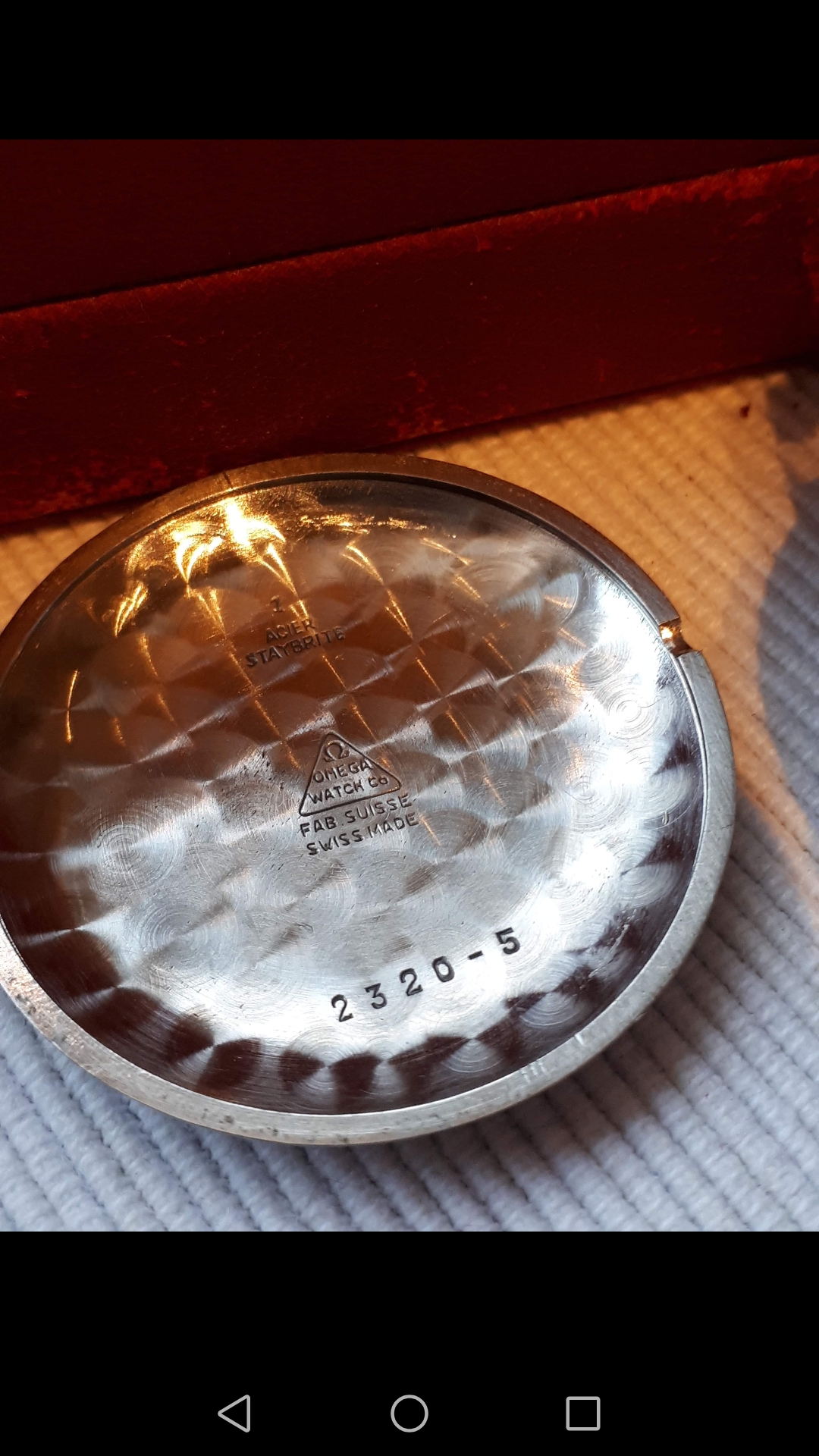

  3. Sam11 Jun 10, 2019
    163
    81
    Screenshot_20190611_131919.jpg Screenshot_20190611_131838_com.facebook.orca.jpg

  6. heavenscloud Jun 11, 2019
    253
    127
    Not necessarily. Welcome to vintage Omega :)
    I linked the Omega Vintage Database record to show that your watch is case reference CK 2320. The OVD is often incomplete--not taking into account that Omega may have used more than one movement per case reference over time. Also, movement nomenclature changed around 1950. For example, cal. 30 T2 SC PC became cal. 280. The watch in question appears to be using the older nomenclature with the caliber number engraved on the plate under the balance wheel.
    These 1940s watches are getting harder and harder to find in good condition. The case is in good condition and the movement looks "clean," however the movement will need to be evaluated by a watchmaker. Speaking from a collector's perspective, the movement looks good. The seconds hand is at least period correct. The condition of the crown, dial, and seconds hand is not ideal, but I think the price is fair.

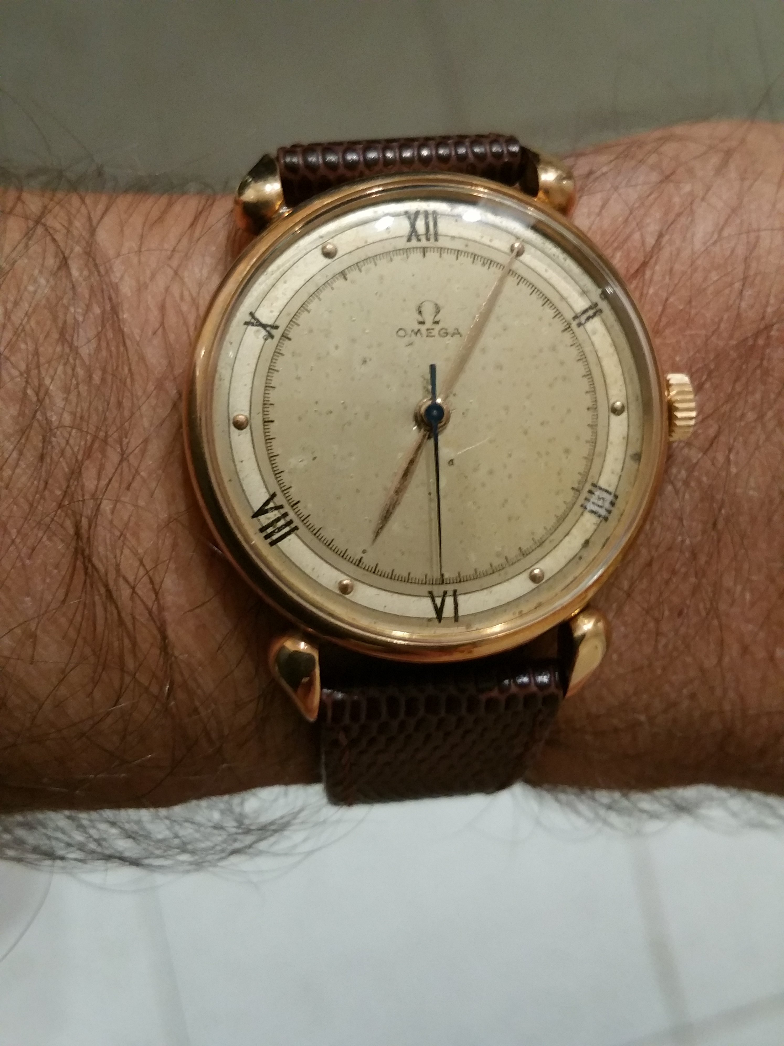

  7. Germanicus Jun 11, 2019
    67
    61
    Second hand far from minute track I think is incorrect..
    Probably one of the last 30T2 - SC or not- till the new ref 26x-28x.
    Probably from 1948.
    Correct price for this rarity.
    One of mines
