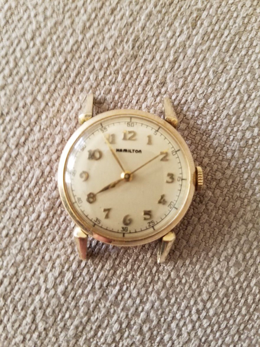

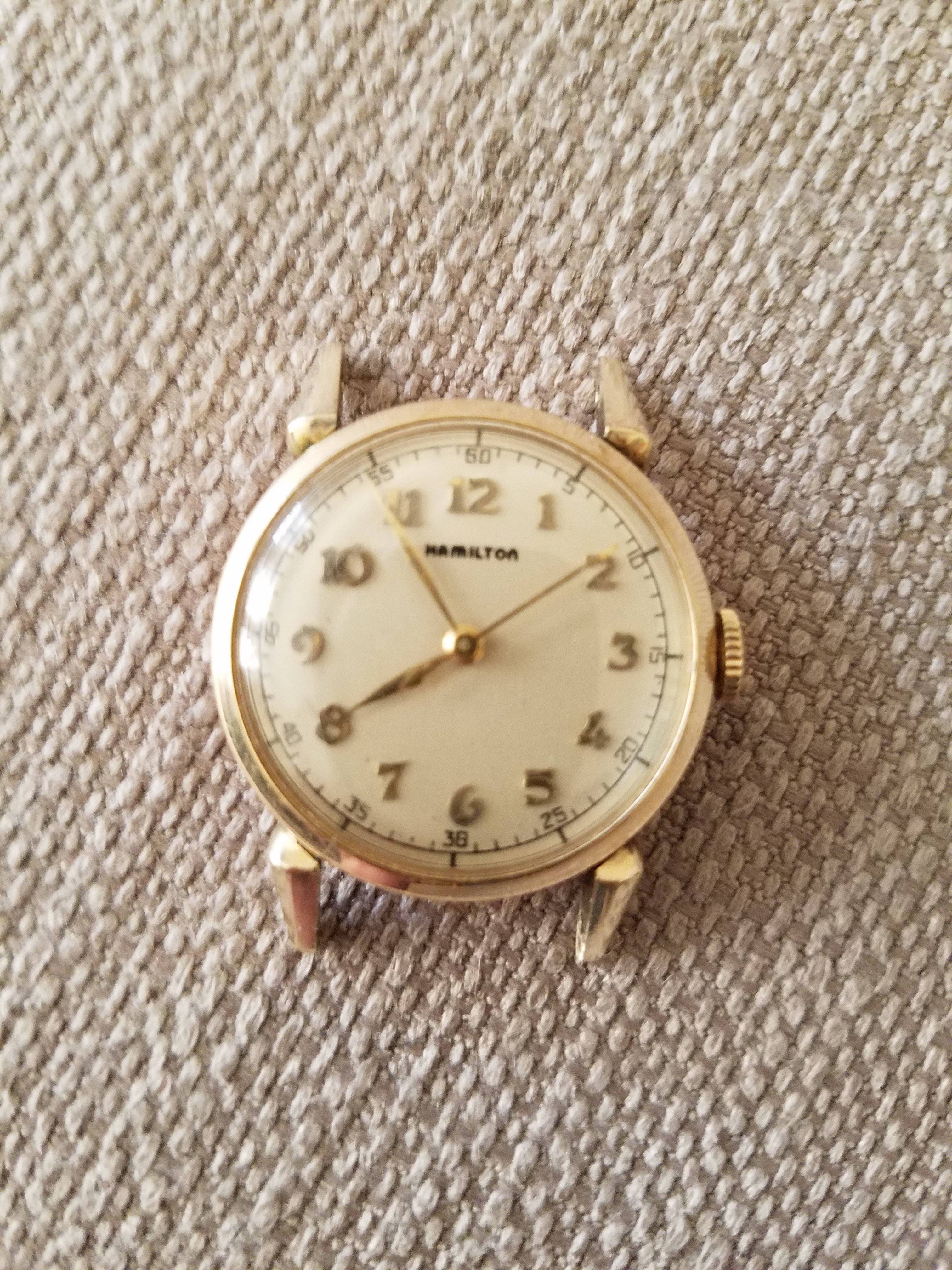

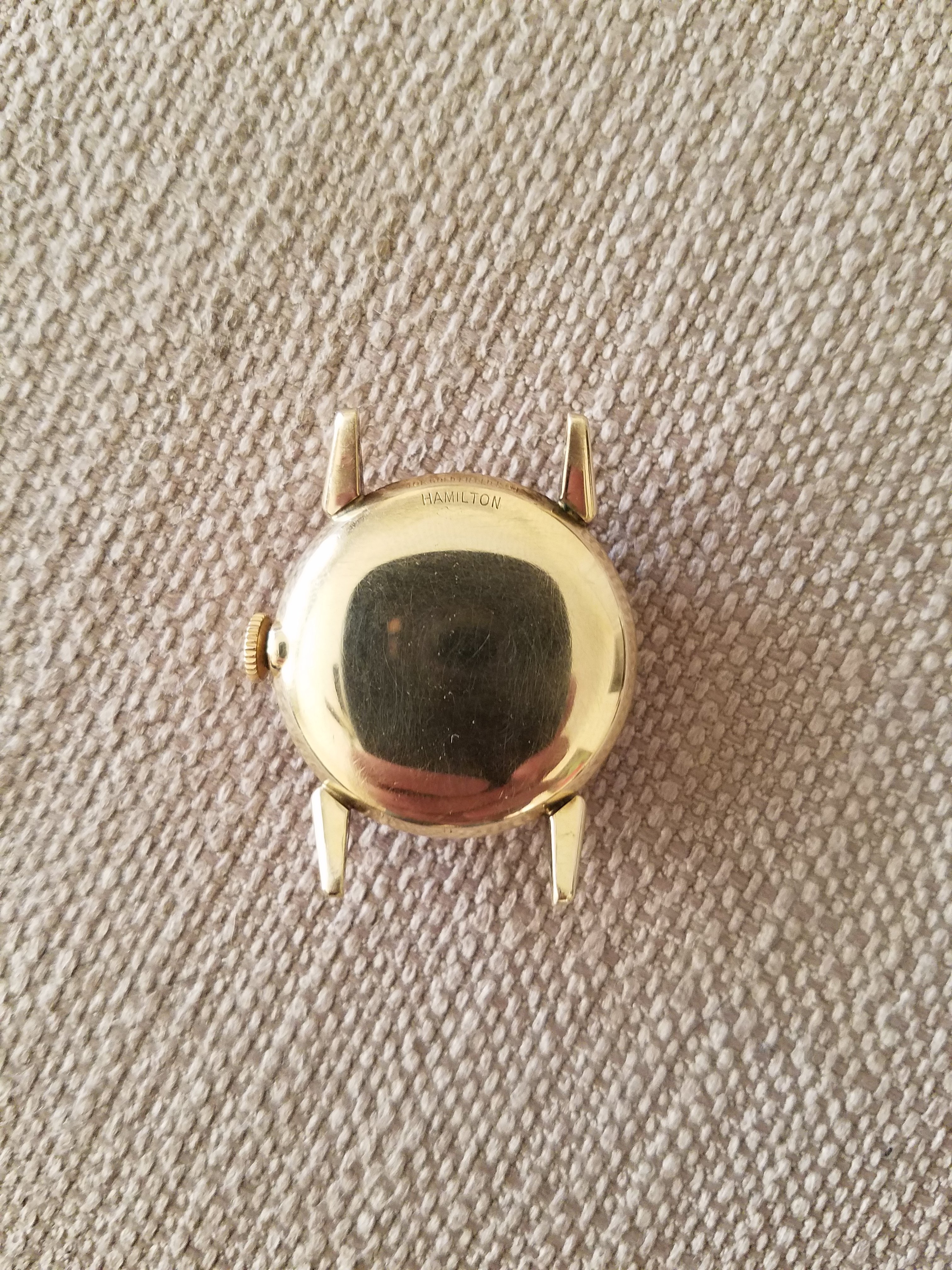

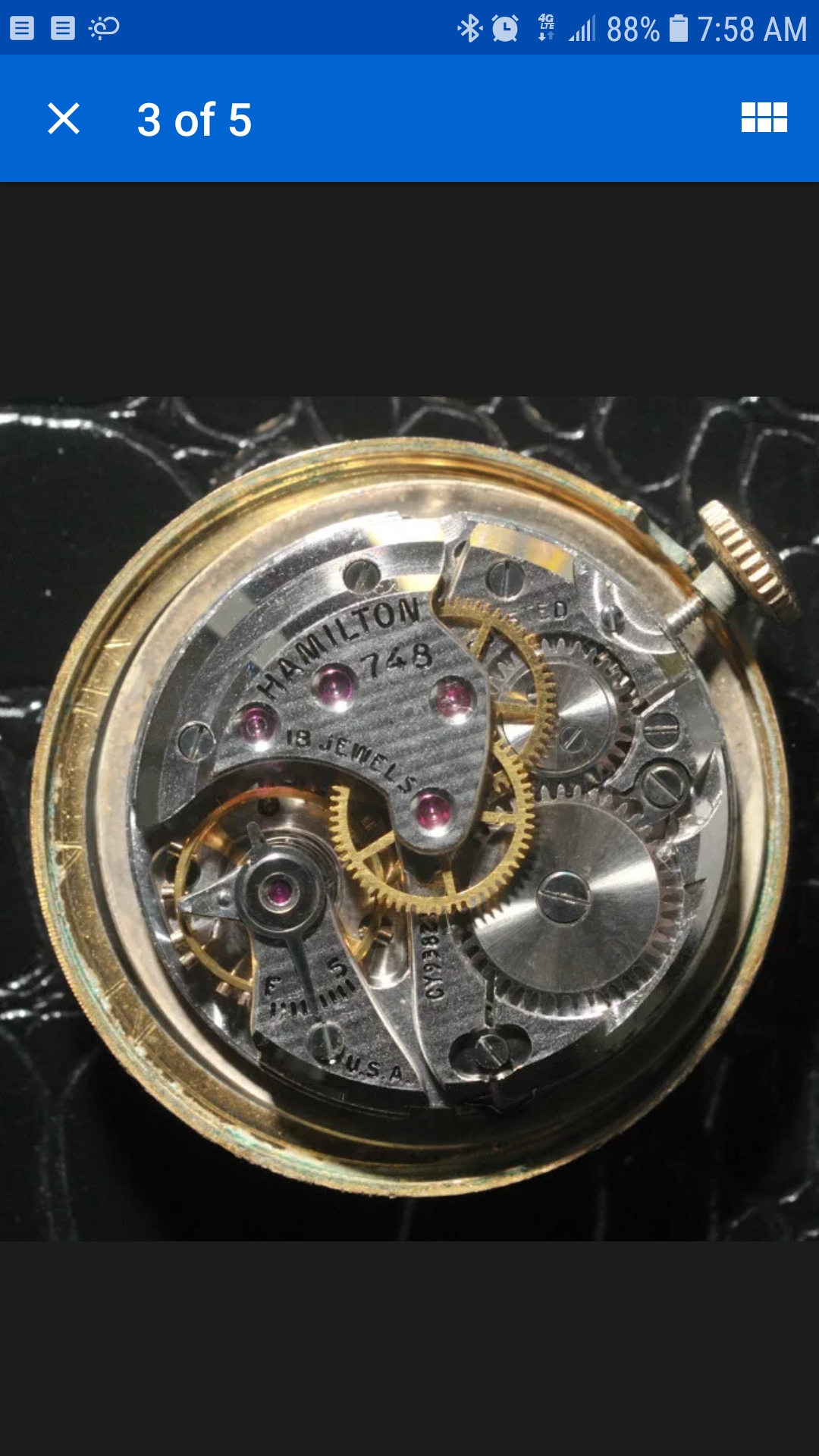

I'd appreciate any comments and observations on my new Hamilton Secometer-B. It arrived last night. I wound it at 6pm, and it was still going strong at 8am this morning. It did gain a minute though.
13,554
18,861
The watch should not gain a minute overnight. The movement probably needs a service and an adjustment.
The dial has been re-painted, as the inking on the logo seems much too thick. With Hamilton collectors, redone dials are not as big of a deal as they are with Swiss brands.

Thanks, it does have the pointer on the second hand. I was thinking the dial had been redone due to the 30 second marking. I'm in for $76 delivered, so as long as it runs well, I'll be happy.
