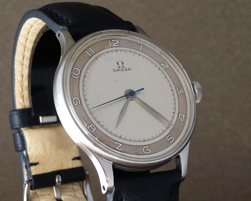

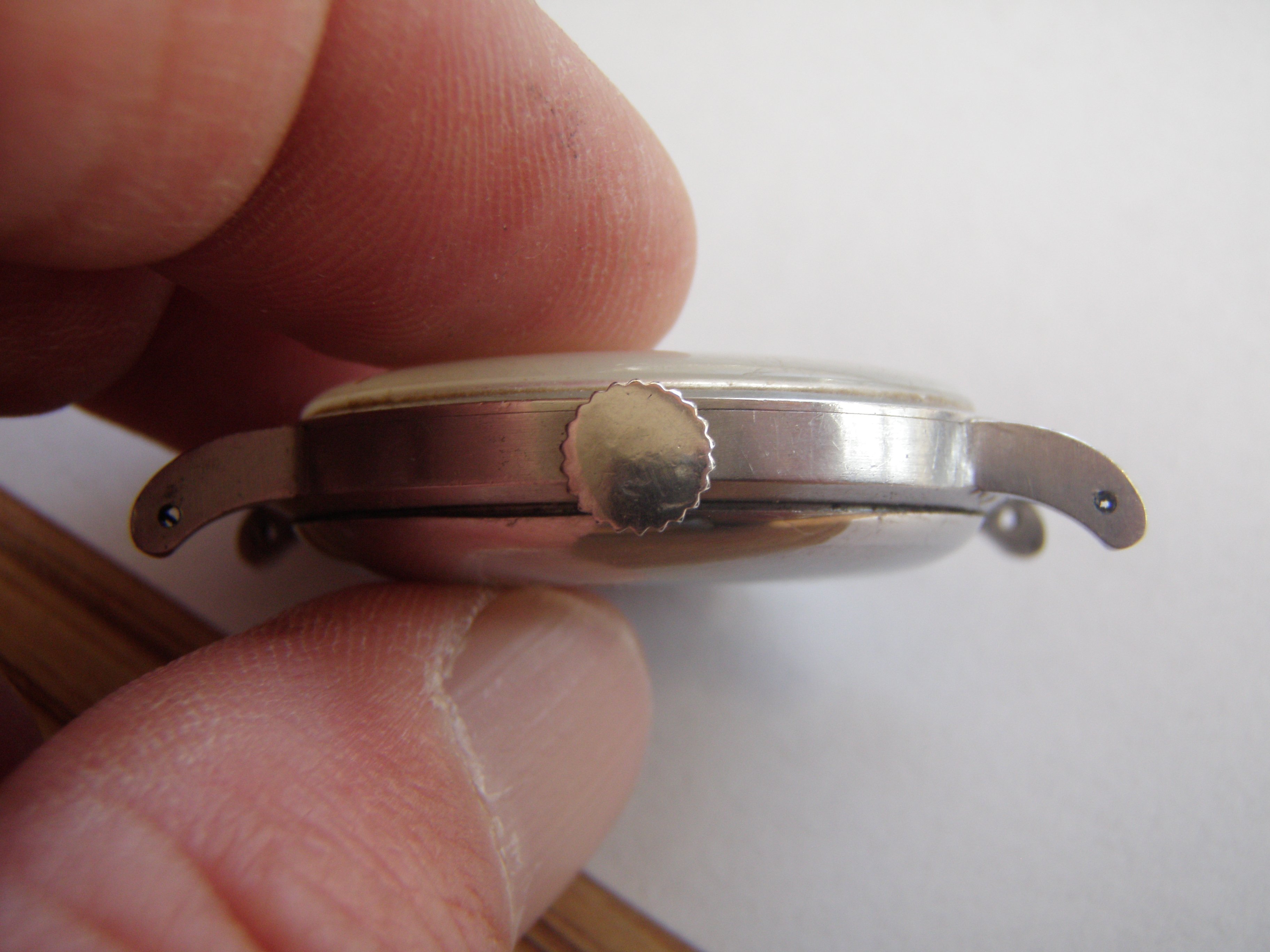

I'm concerned that the dial may be refinished. It does not state "Swiss" or "Swiss Made," but the Omega text and symbol looks correct. Also, the crown is unsigned.

The absence of "Swiss" or "Swiss Made" is not necessarily a sign of a redial. There were many vintage watches produced and sold without such designations.

Another point of concern is the long minute hand doesn't go well with the shorter second hand or the dial.
Everything else looks good for the period. Size may be too small at 32.5mm.
Thank you for pointing that out. Also, a blued seconds hand appears to be a common feature of late 30s watches (26.5 SOBs), but this is the first time I've seen one on a mid-40s watch....

Blued second hands were used well past the 1930s, so that shouldn't be a particular worry, either. Having said that, the minute hand does seem out of place given the placement of minute track.

Sorry to contradict - all the hands are legit!
There is a small series of references/dials with this particular "inverse" hands design with the short second hand and the long minute hand.
I have a watch with a very similar dial/hands combo in my collection.
