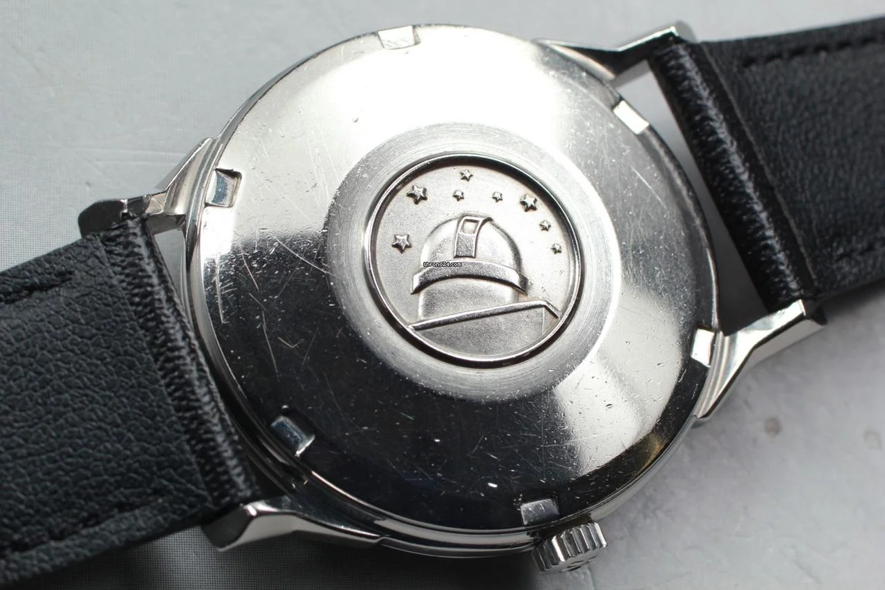

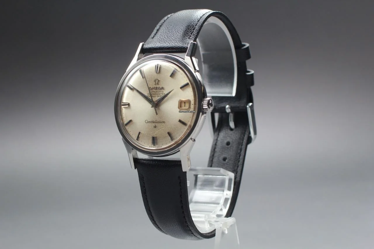

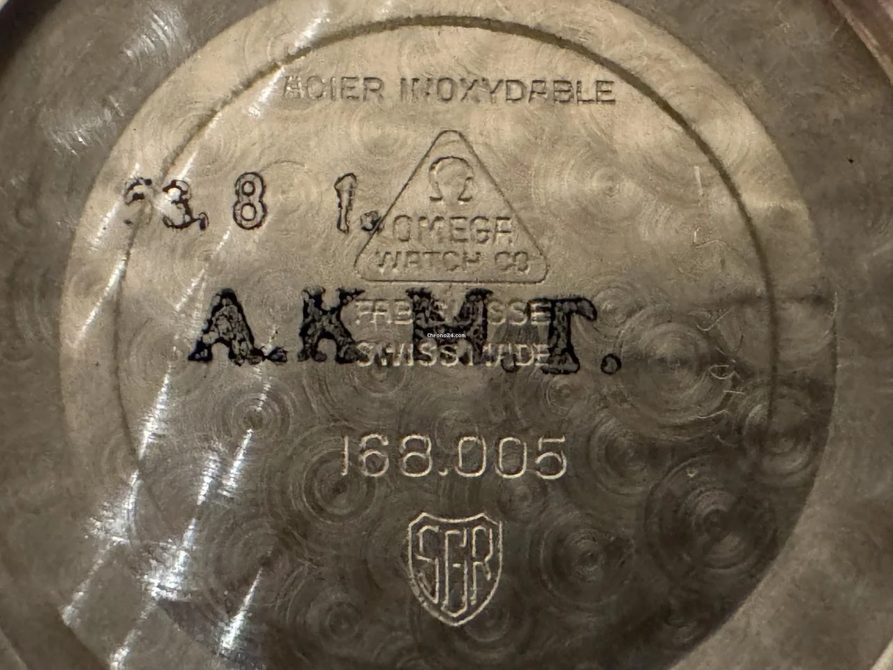

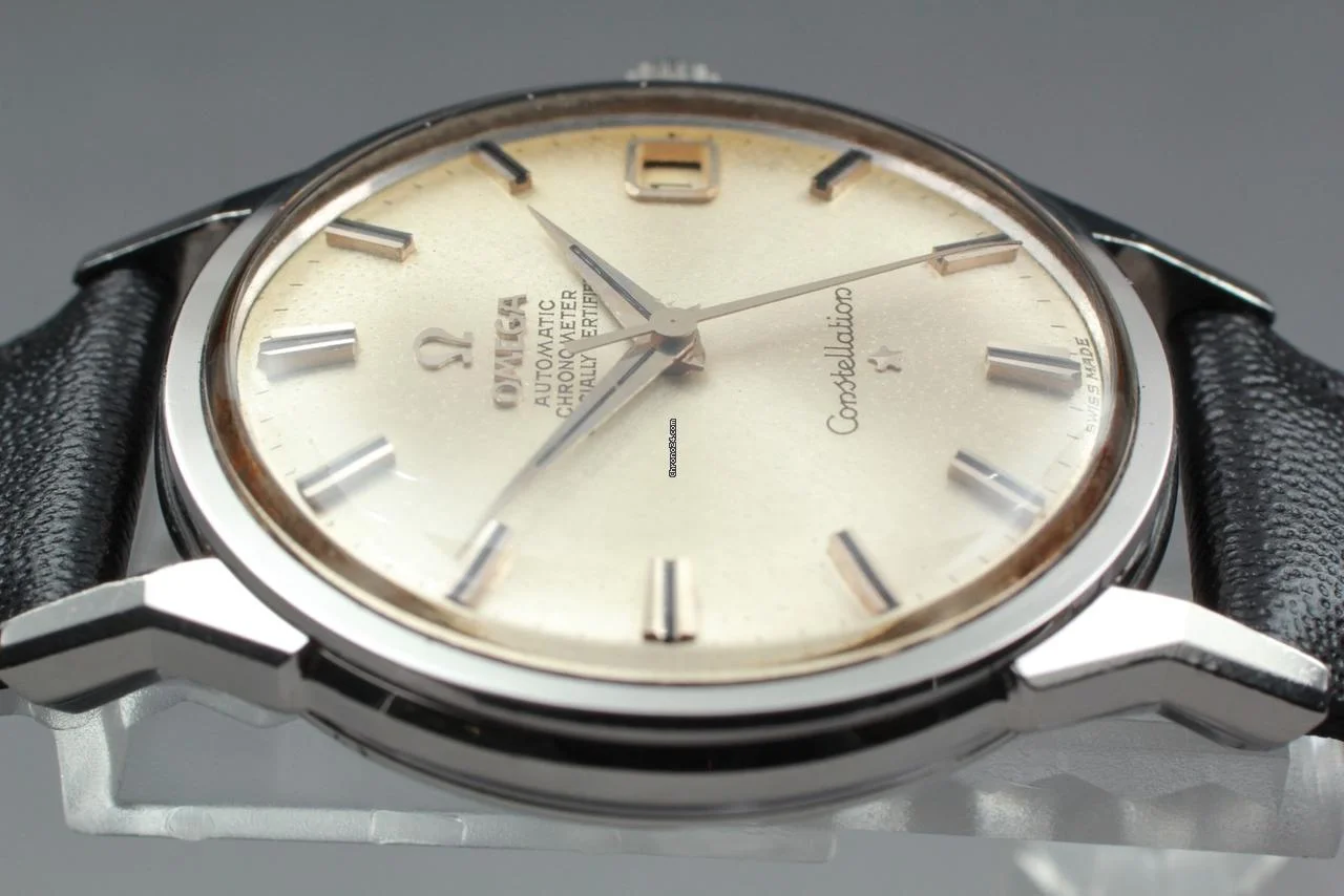

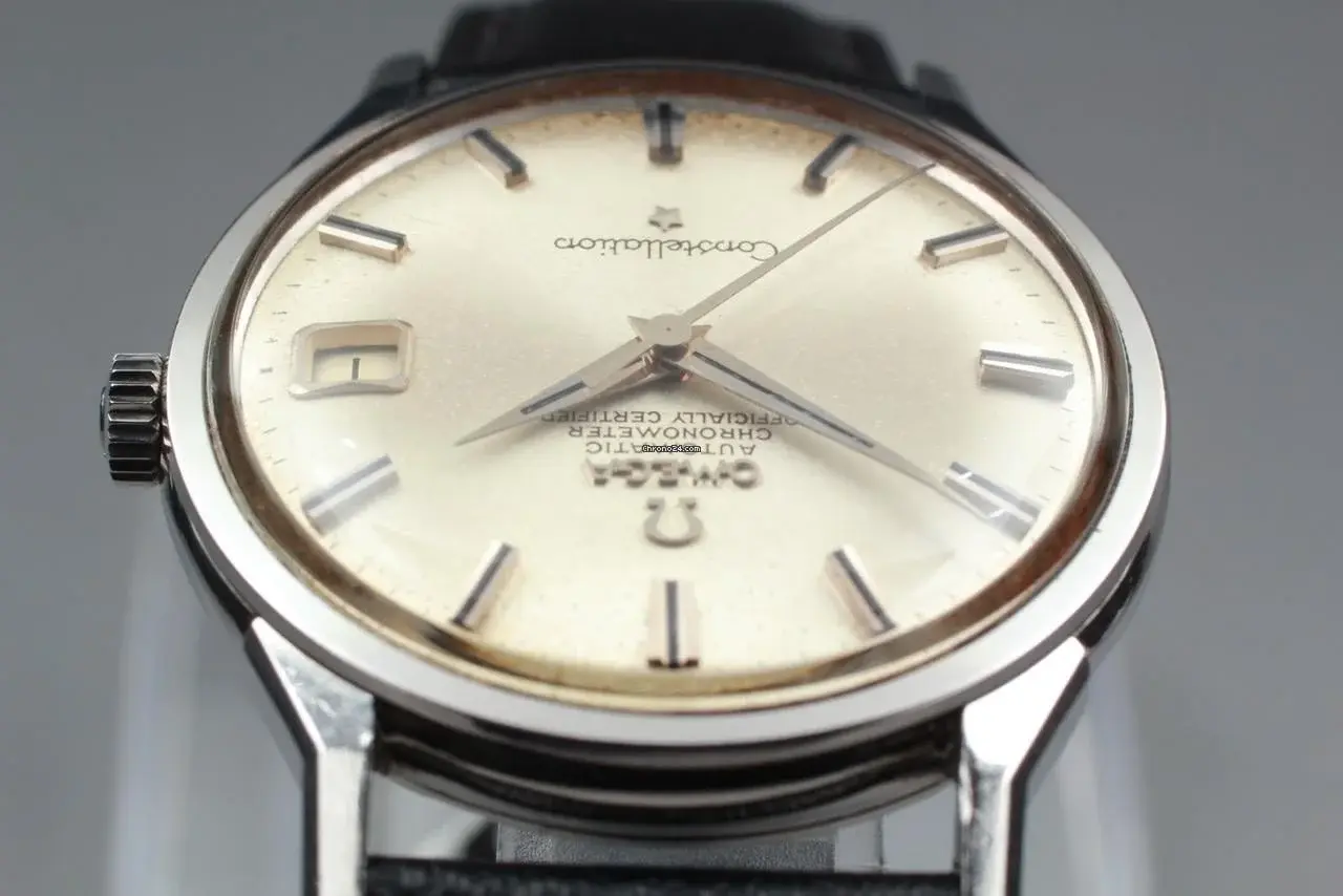

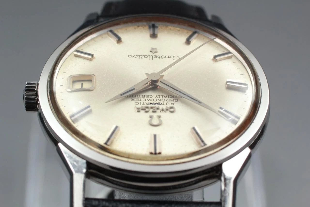

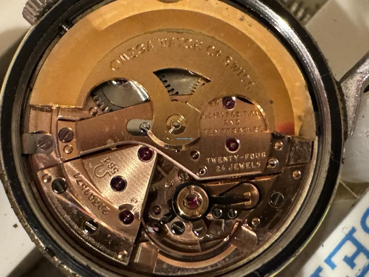

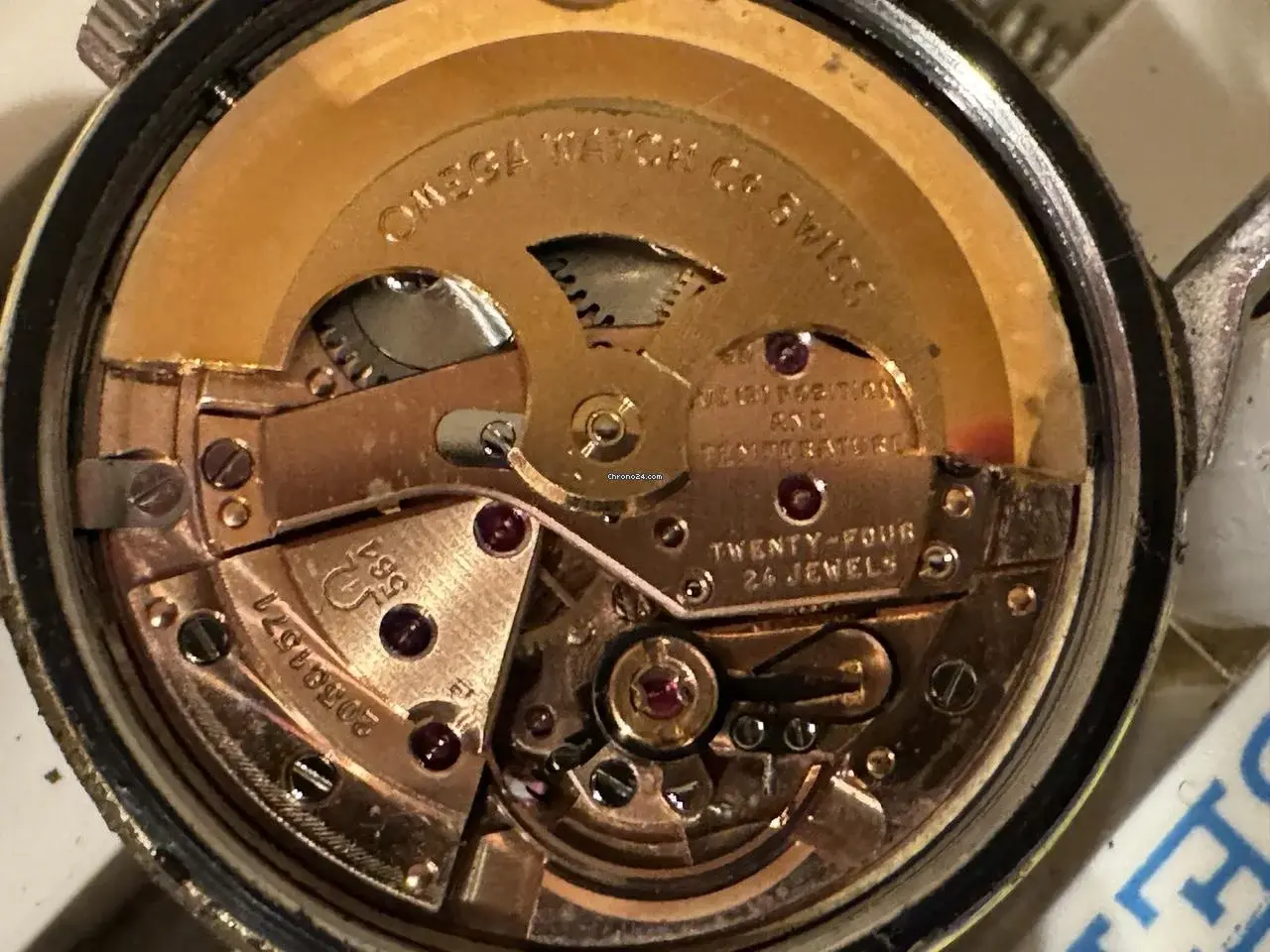

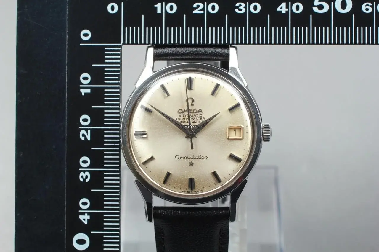

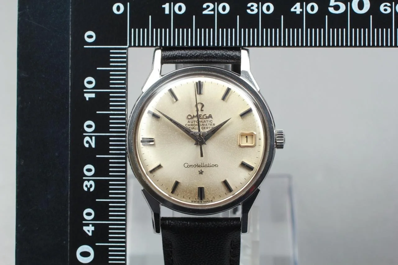

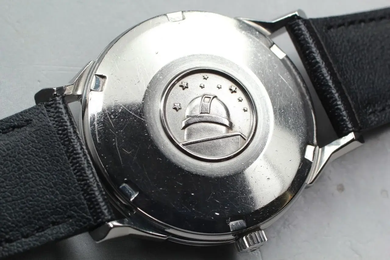

Hi, just bought this 168.005 Constellation from 1963 and thought to ask other people's opinions about authenticity and markings on the caseback. Watch comes from Japan.

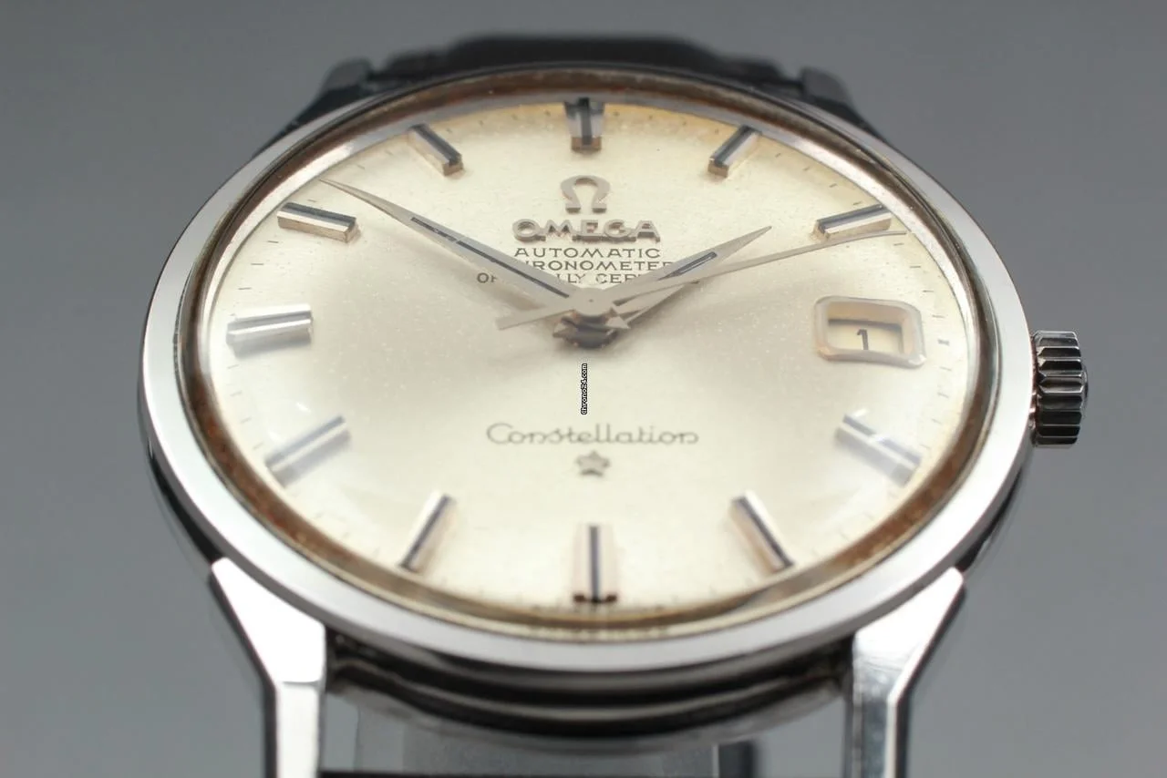

I know the dial has some damage, but otherwise to me it seems like an honest specimen. But many here know much more than I. I think the dial condition was also counted in the price (1040 USD).
There's some dirt around the rim of the caseback, so closer inspection will tell if full service is in order. But the rotor bearing I alredy ordered, so slack there gets handled.

Photos are really too poor to say much.
Since you have already bought it, not sure what questions you would like answered.
Do you have watch in hand?
Always good idea to plan service if you’re going to wear it.
And I would recommend that you leave sourcing of parts to an Omega certified watchmaker with Omega parts account, rather than trying to collect parts on your own.
34,872
39,441

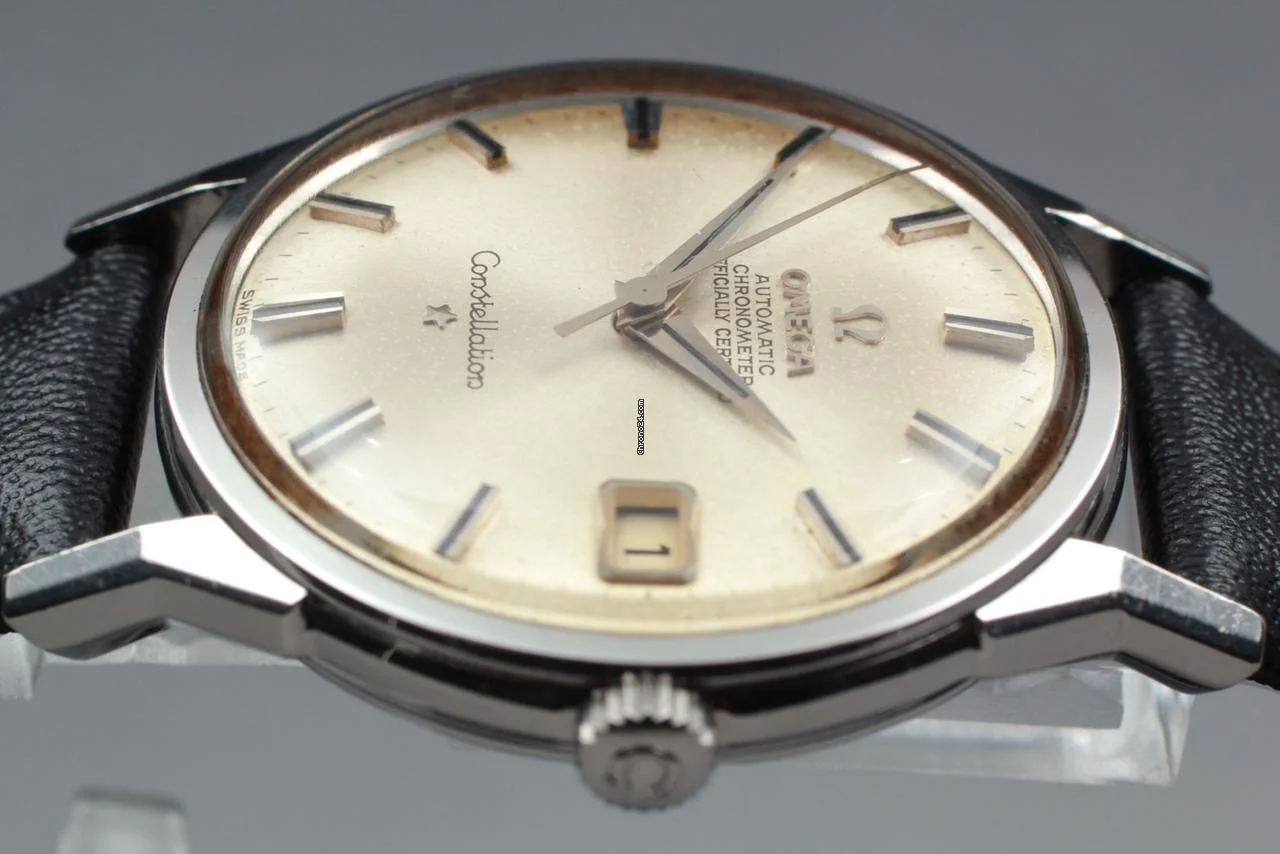

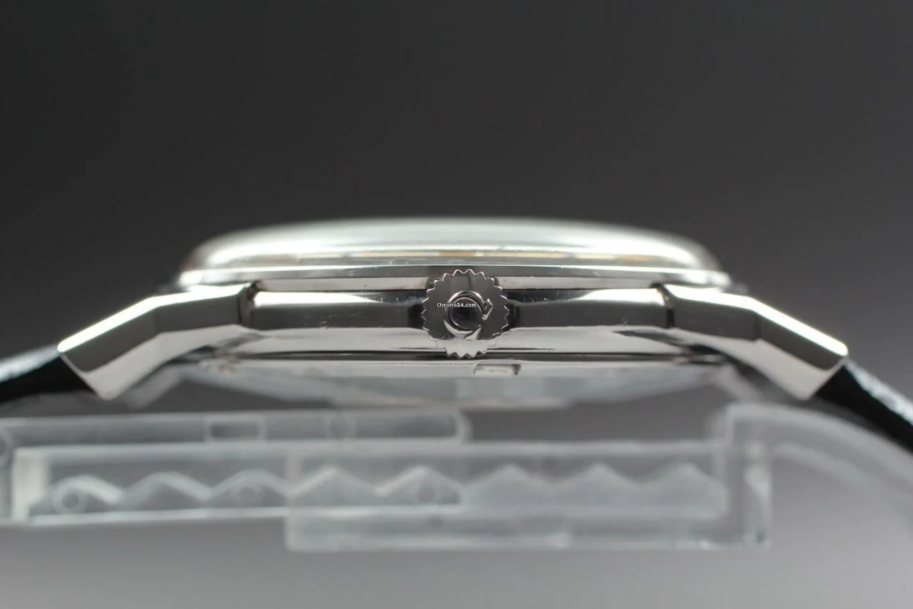

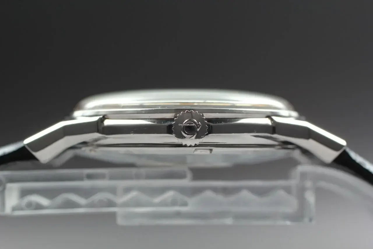

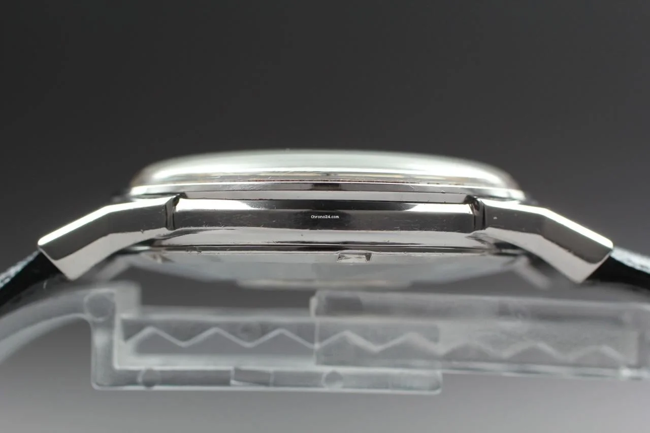

Case is a little polished but decently sharp, crown is a replacement, dial has a bit more patina than I would like at that price but not too bad, as @SOG53 mentioned above, you typically leave the parts sourcing to your watchmaker, they know what they're doing and will cover the parts installed under warranty if they source them while they won't do so for any you supply
202
242
I personally would’ve held off for a better example but this isn’t awful. I just wouldn’t be able to live with the dial issues. As dsio mentioned case has been polished but not too drastically. At the end of the day, an example you can wear everyday, enjoy and not have to worry about.
Thanks for the reply. Yeah, photos aren't mine since I don't yet have the watch. They aren't otherwise bad quality but lens was set to too wide aperture making DoF so narrow that most of the area is out of focus.

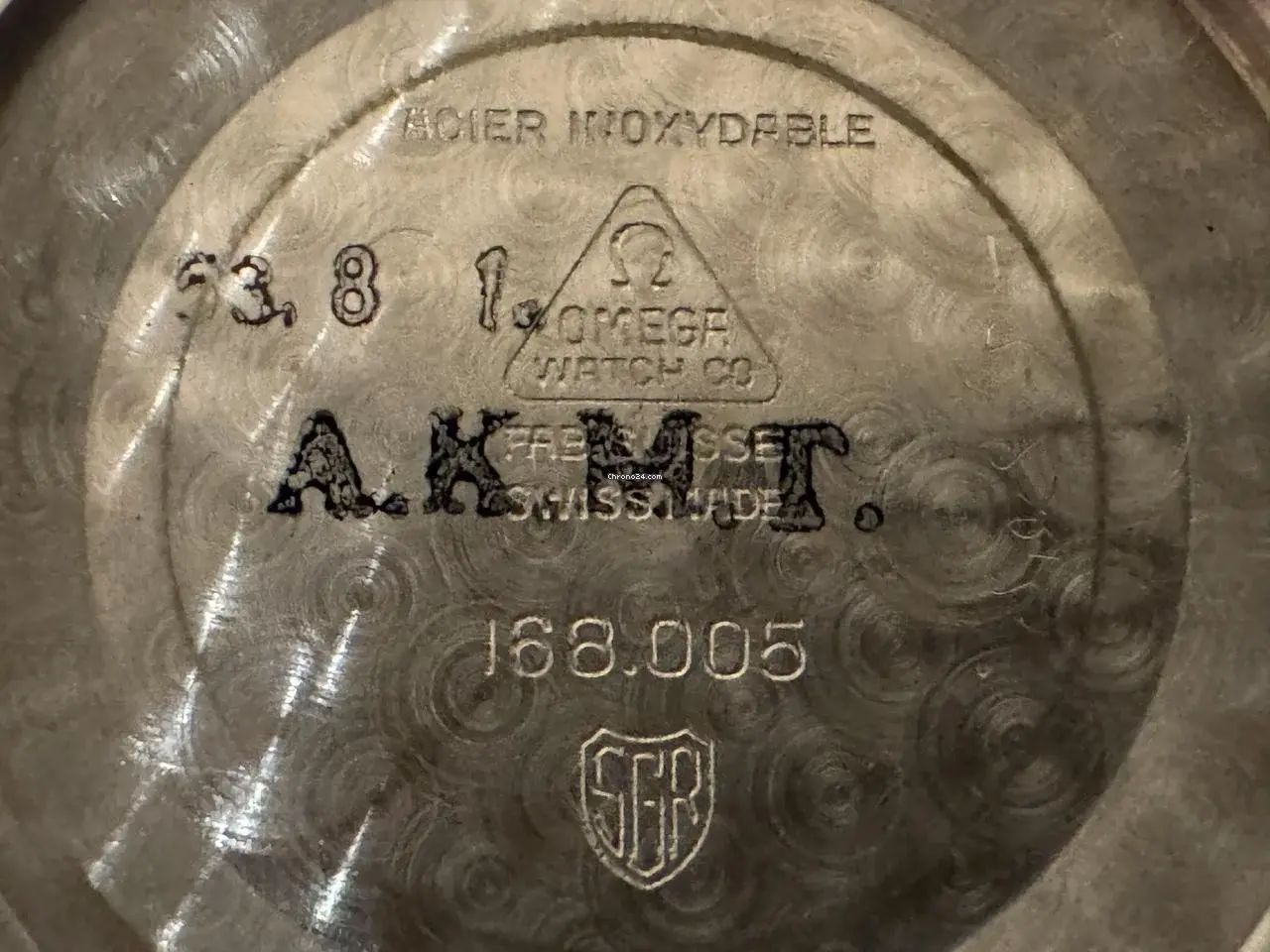

Like mentioned I was interested in knowing if someone has info about the markings on the caseback. The seller didn't know for sure and said that they are maybe just service markings. I was thinking if they might have been related to original seller or importer in Japan. Then I was interested in knowing if I had missed something obvious pointing out this being redial or some other way not original.
I only use two independent master watchmakers who aren't Omega certified and when a client knows what part is needed they prefer client sourcing the most difficult to get parts. This watch needs a rotor bearing (Omega part number 1429 for base cal. 550) which I could find in NOS condition from only one seller in the World. Part has long time ago stop being supported by Omega. So that's why I bought it directly myself.
Thanks for your info! Good to know about the crown especially.
Yep, I can see the dial condition being an issue for many. Like you suggested I was planning this to be not quite a beater watch but something I can wear without too much worry about it. Of course can't treat it as waterproof still.

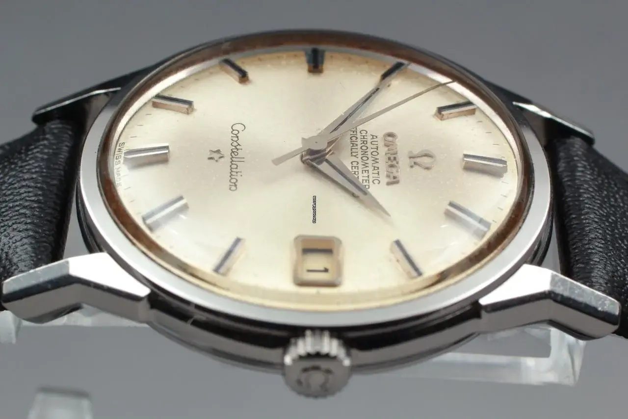

Ah yeah, I think this kind of crown would be the original one, right?
Makes sense! That’s the trouble. As these pie pans become more desirable a pristine example becomes more scary to wear! I know from first hand experience 😂

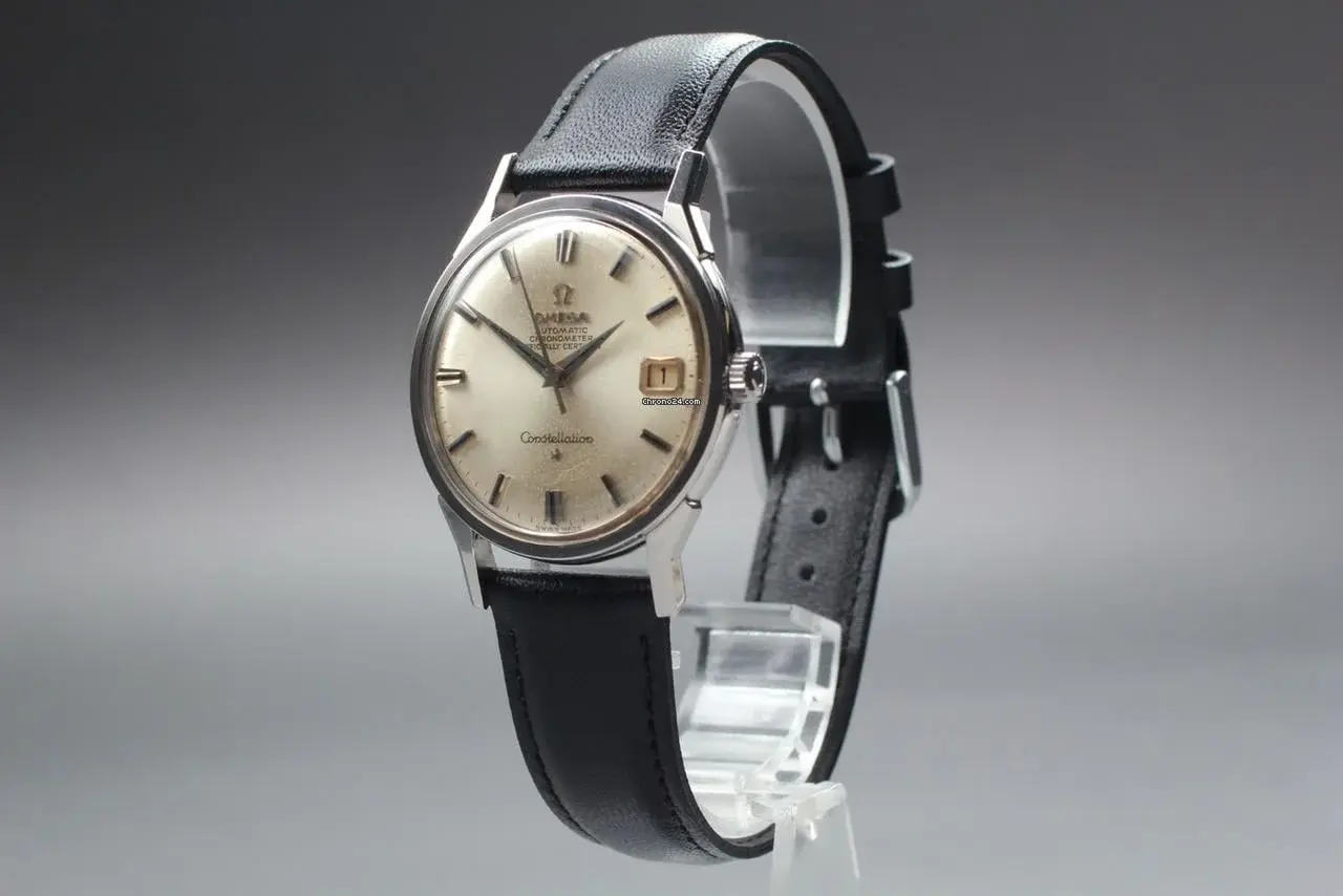

not a pie pan, you show a dome dial example in your pix
202
242
not a pie pan
Meant to say dog leg 🤦🏻 in my head I always think of them as one and the same which they’re quite obviously not!
I'm sure this was just a slip of the keys but as @reggie_v says, it appears that the current cohort consider 'dogleg' to be synonymous with 'pie pan' because that is what is getting all the exposure on the net these days.
I do wish these same folks would take a closer interest the watches they are drooling over - but that would require a certain amount of effort and attention span.
Sweet deal for them! Make the customer do your work...
Not sure what you are saying here, but to clarify Omega still sells parts, and they still support this caliber family completely. The rotor bearing (rotor pinion is the proper name) is still sold by Omega - I just bought some last week.
Ah, it must have been that I misunderstood then and the reason for unavailability from Omega was due to not being a certified Omega service.
Regarding making the customer to do the work, I'm happy to do it when my main watchmaker charges me 92 USD + tax from a full service (extra if mainspring or crystal needs changing).
