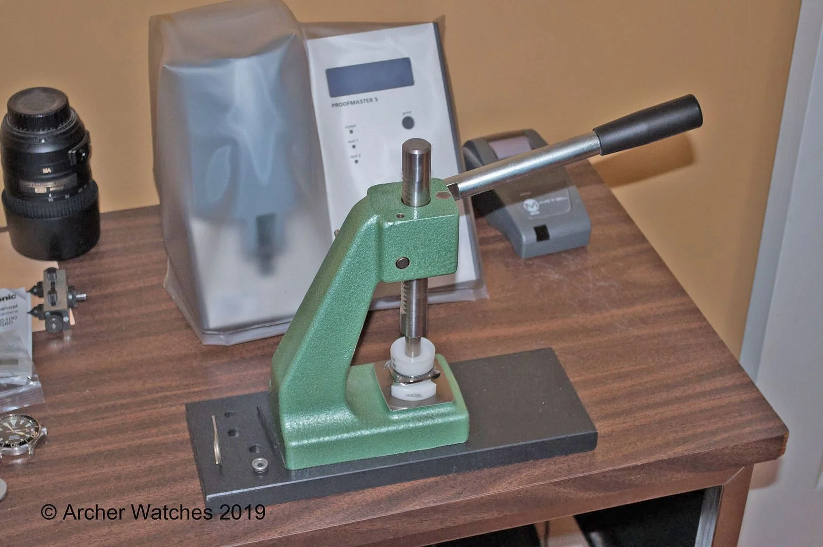

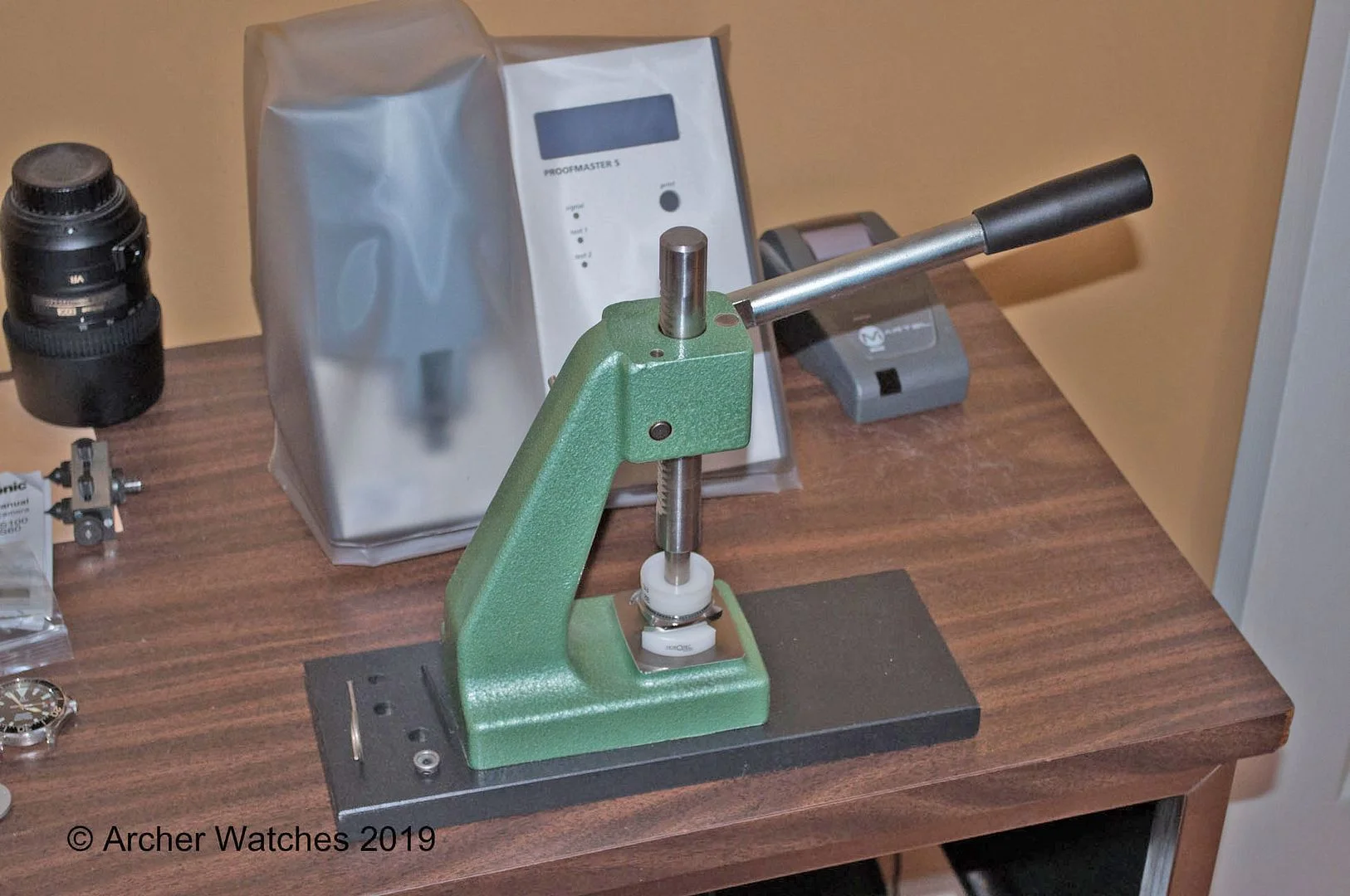

The tool is not used to install the crystal, only to remove it. The crystal is installed using a press:

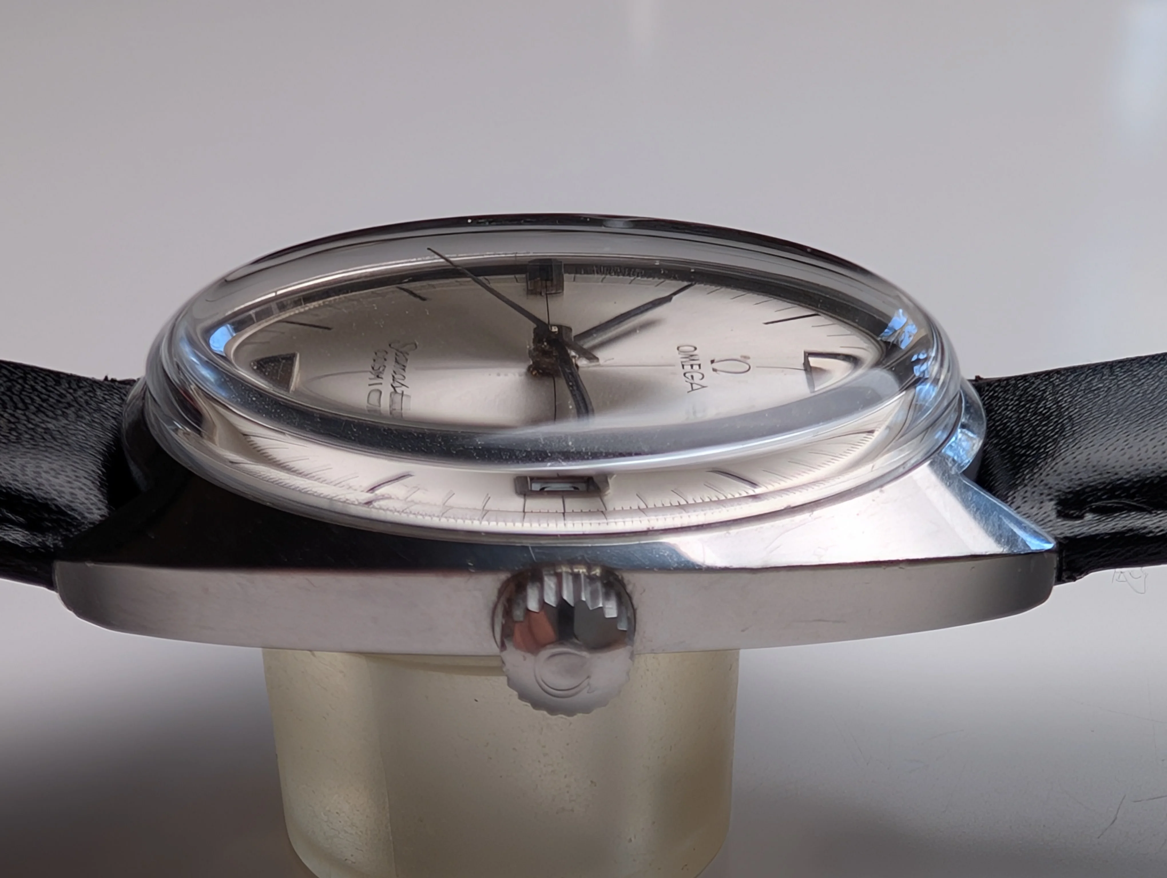

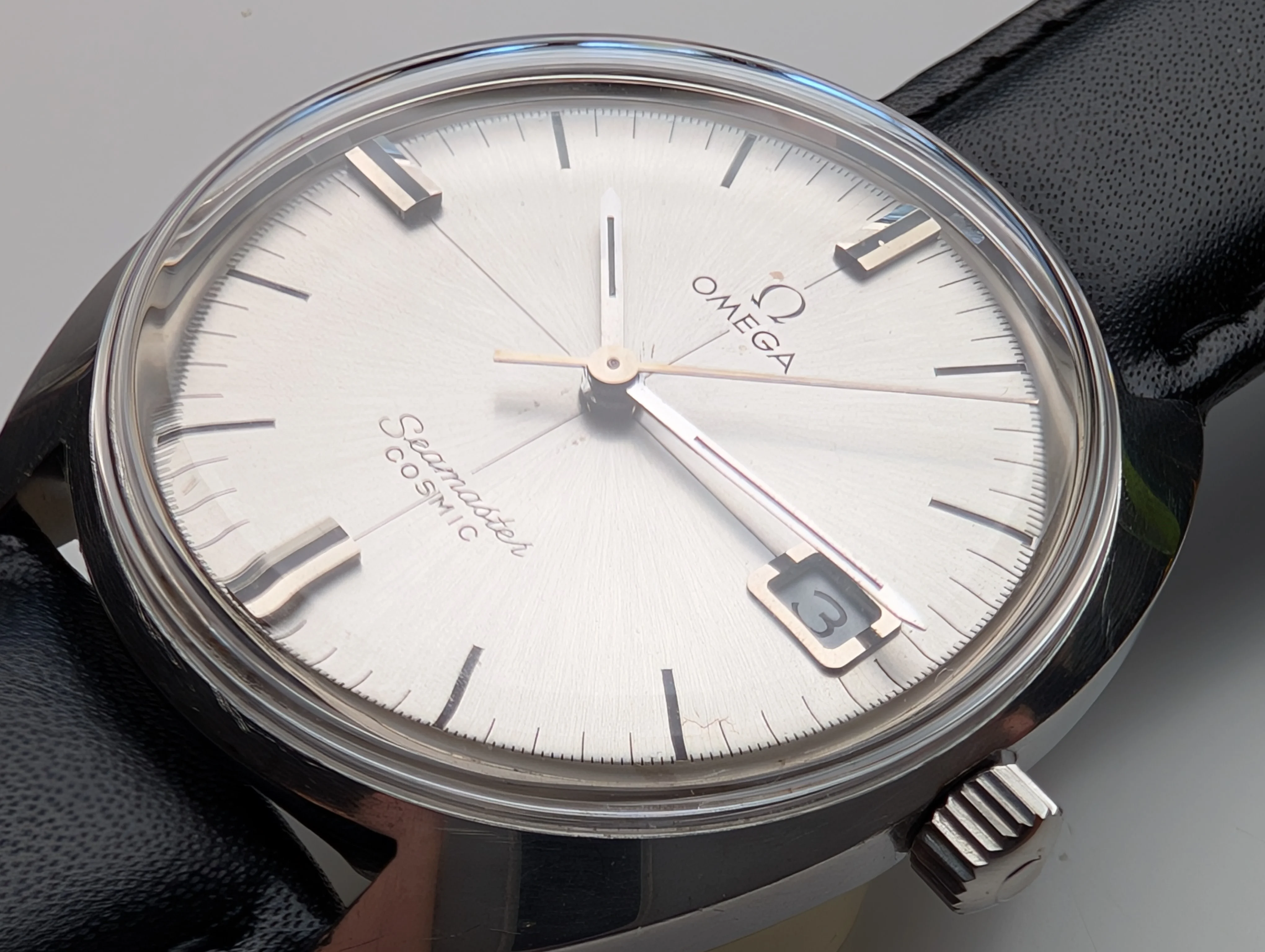

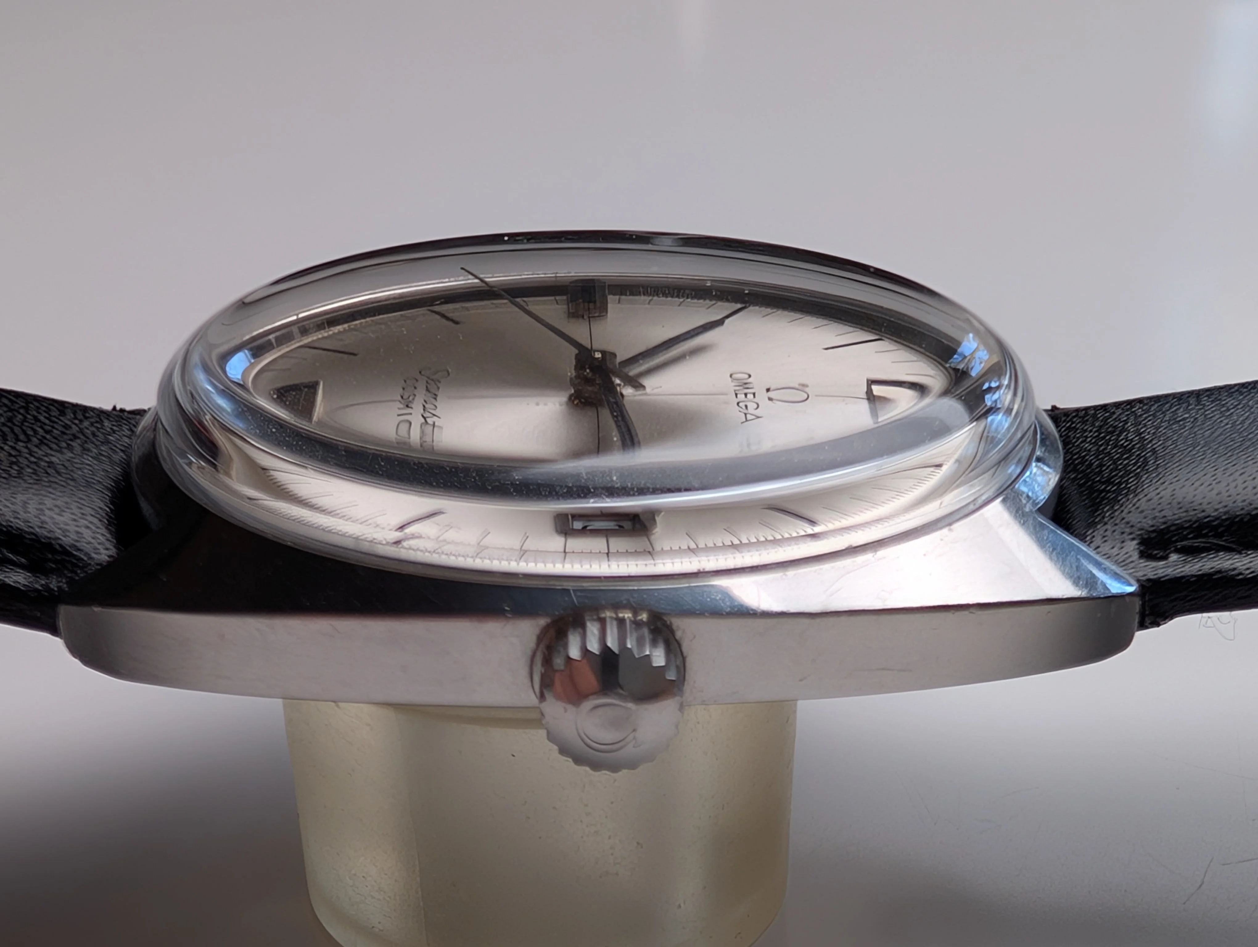

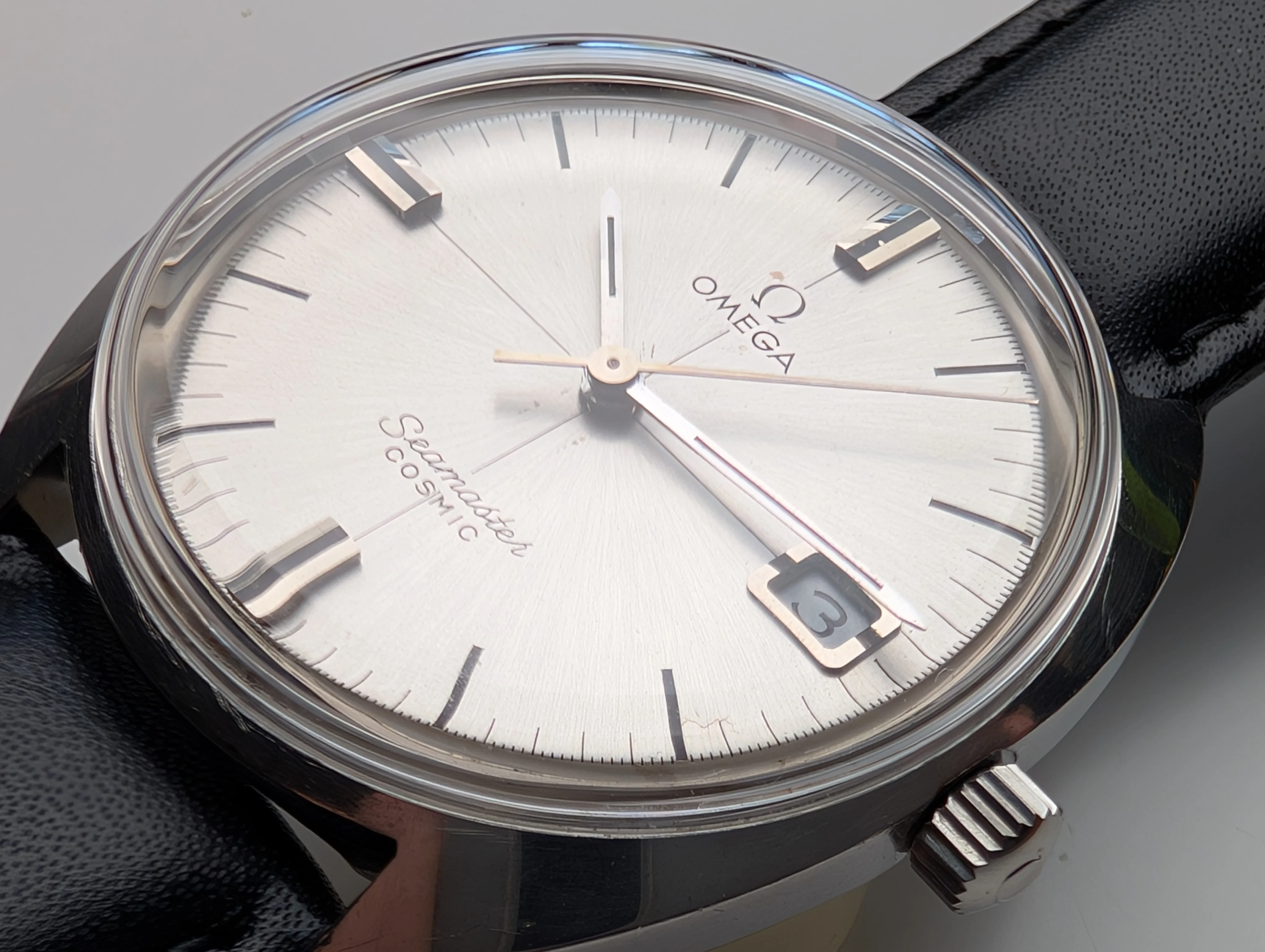

I just broke 2 crystals with the Bergeon lift tool (trying to remove, then installing a new one).
To press a new crystal in to a Seamaster Cosmic what die would I use? Does the tension ring go in the crystal first or into the case, then the crystal pressed into it?
The tension ring goes into the crystal, and both are pressed into the case, the die should be specifically made for installing tension ring crystals - they are typically identified as such.

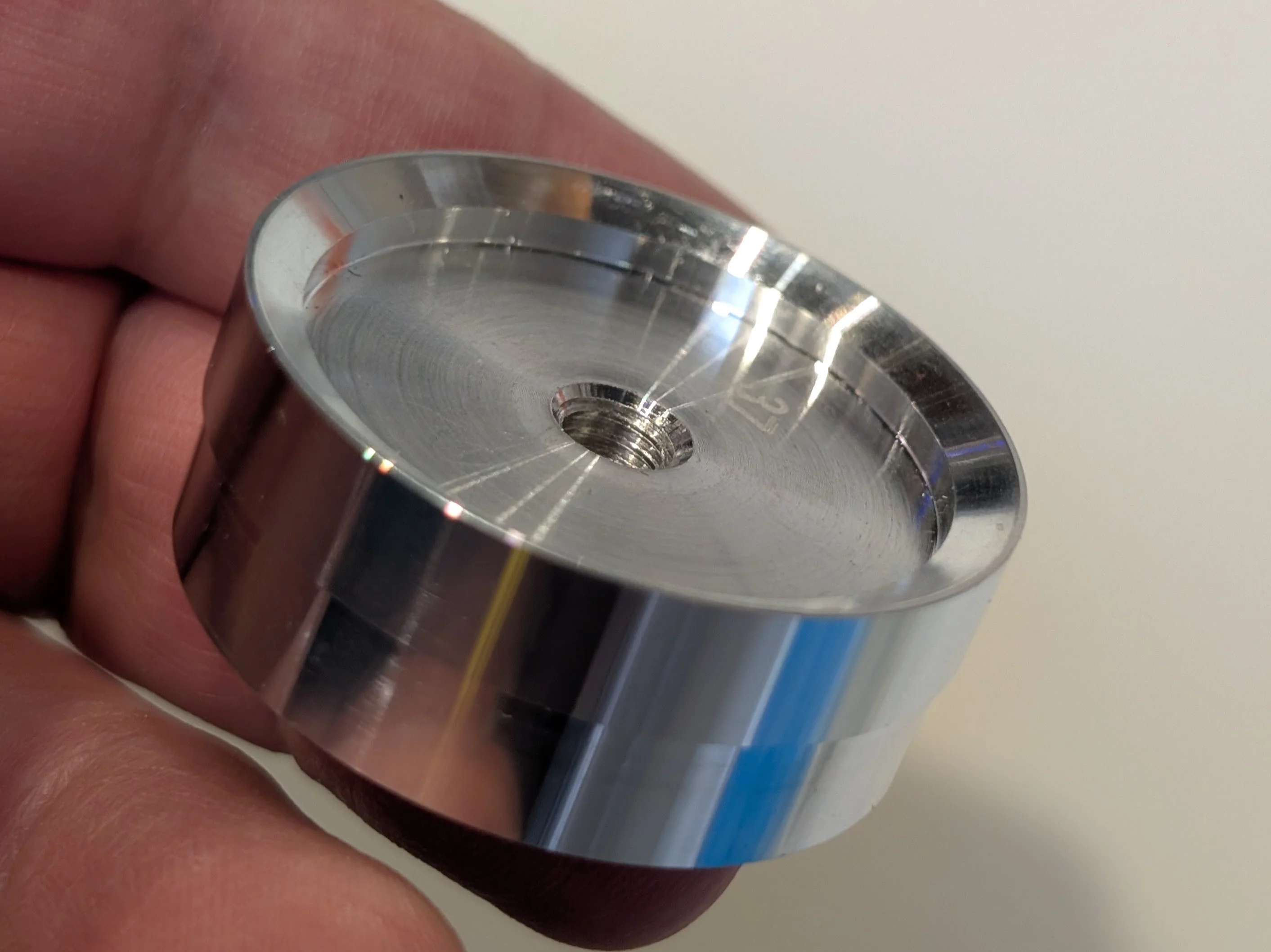

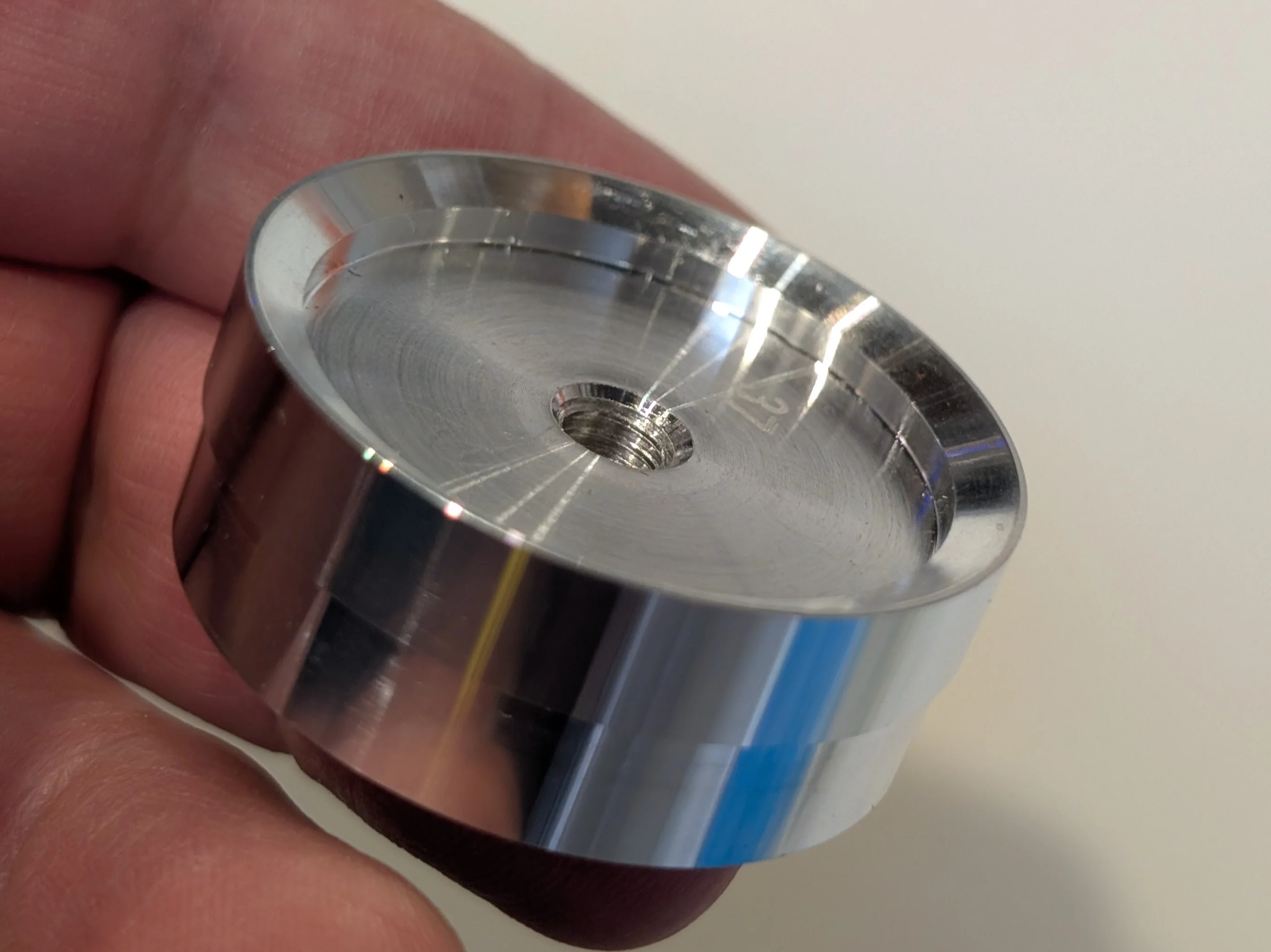

Thanks so much. I tried to determine what those dies look like and there is conflicting info online. Most info suggests a taper sided, not a straight sided die, correct? That lines up with your previous guide here for crystal install.
This is what I have, is it sufficient / the right taper?
30,205
77,993
Yes the inside of the die is tapered. The one you show appears to be a bit shallower than what I use, but you could try it.

Thank you so much for your guidance. I was finally able to successfully install a new (old stock) crystal. I also used the nose grease trick and it clicked right into place without too much pressure.
