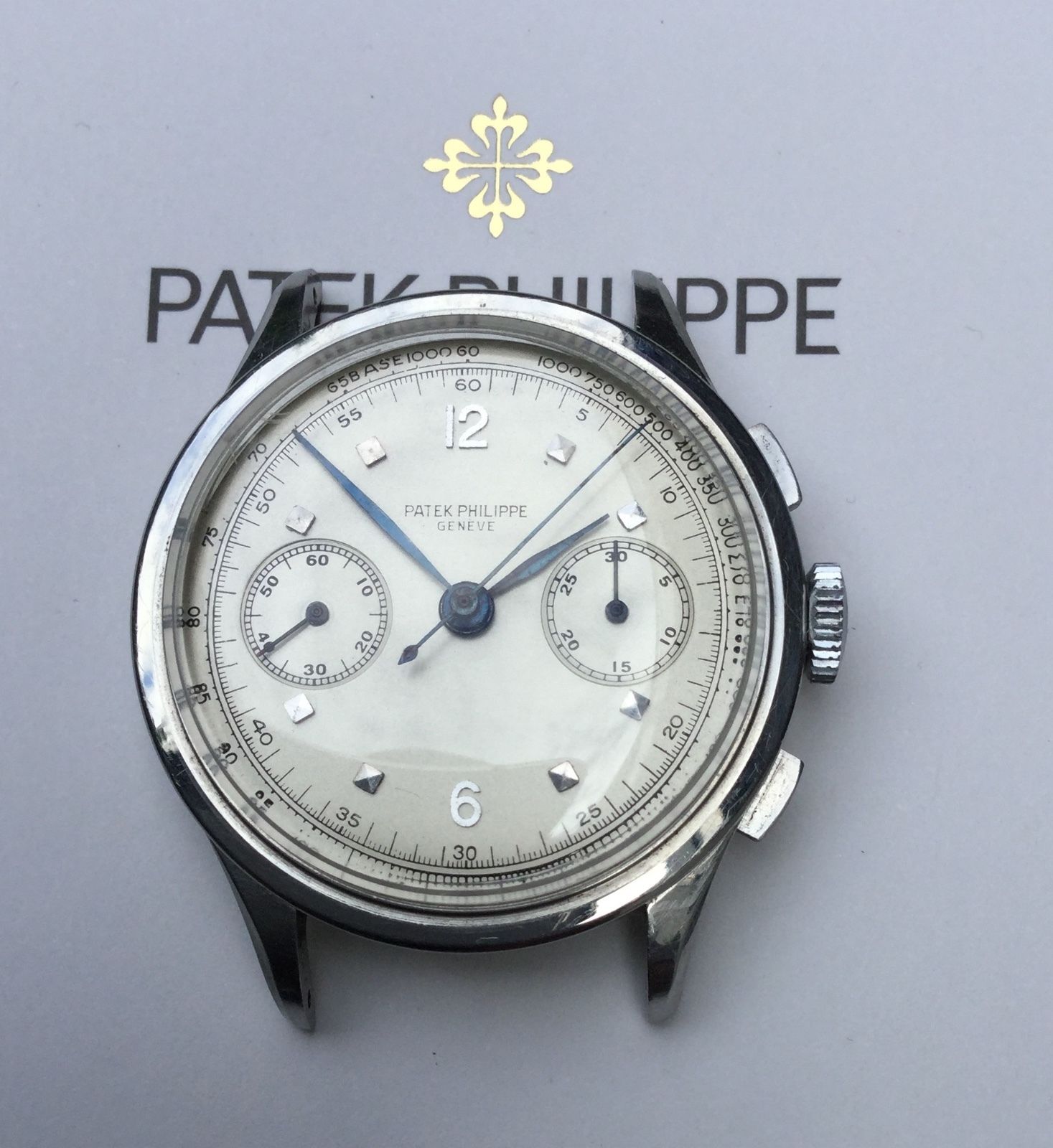

Attention all 35mm case lovers......here's one for you! 😜 Is a nice dial overall, but I would have done something different with those hour markers

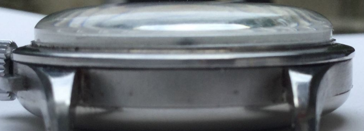

Highly questionable watch - dare I say, an outright fake. The dial looks like a fairly poor attempt and the case is incorrect - ref 530 did not have chamfered lugs and the inner caseback would have most likely been perlaged (not to mention the suspicious looking engravings). I think all of the parts except for the movement are fake.

Is it just me or is the 30 under the 6 hour marker totally wonky?
7,635
21,906
And likewise, compare 50 and 55...

Not keen on the use of both open & closed 6's - That does feel off

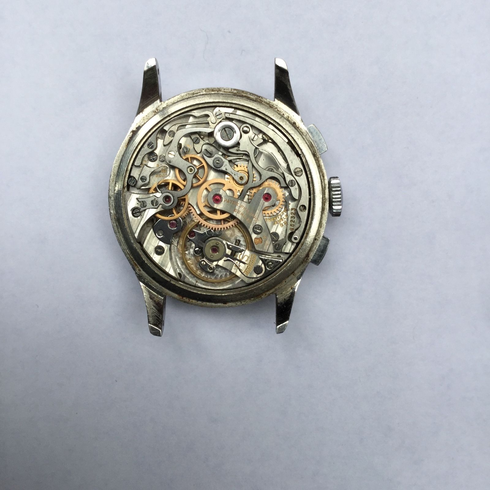

Seriously, someone is going to spend that much on an iffy looking movement like that off ebay without ever handling the watch?
Some have more money than brains!
