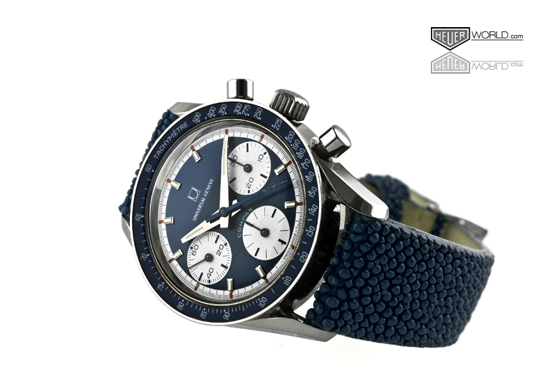

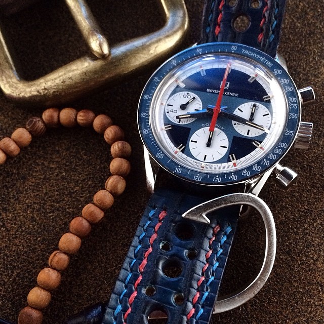

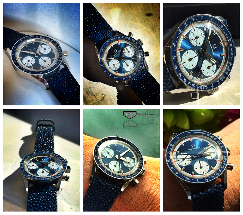

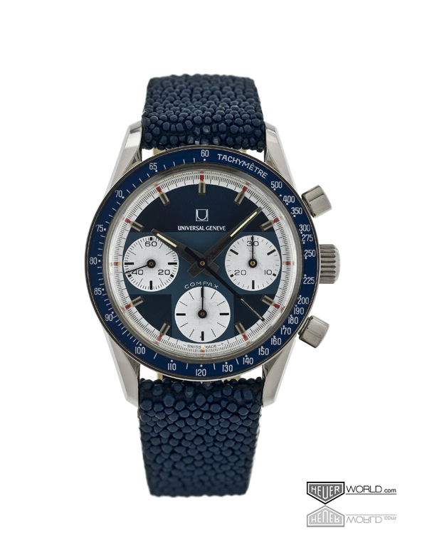

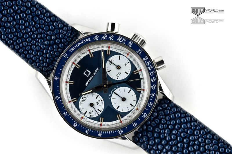

    Revisiting this post I can just add some pictures of my reference 885108 for comparison. Firstly, I call mine the "Exotic" dial Compax. Well we have the Nina Rindt and the reverse Nina Rindt so why not the Exotic. The dial is just that with the metallic dark blue that sparkles when it catches the sunlight and the red accents at the hour markers make this rather Exotic to my eyes. My example has the thin register hands and the crown is incorrect (needs replacing). It is a little jewel in my collection and enjoy wearing it.
    regards
    Paul
    www.heuerworld.com
    172 UG Compax Blue no1.jpg 172 UG Compax Blue no2.jpg 172 UG Compax Blue no3.jpg 172 UG Compax Blue no4.jpg

    Superb pics as usual, Paul. Is it on sting ray?
  6. dsio Ash @ ΩF Staff Member Mar 12, 2014
    25,558
    31,318
    That's awesome, the sunburst blue completely transforms it, the peeled blue Stingray strap looks great on it too

    Hello Paul,
    Thank you very much for showing us these gorgeous photos of your great watch. It's only the second example with thin needles I saw.
    Thanks also for the reference number. Is there a minor number like in "885108-1"?
    "Exotic blue" would be a bit more significant. This term would also allow to distinguish this model from the other blue model, the "exotic silver"?

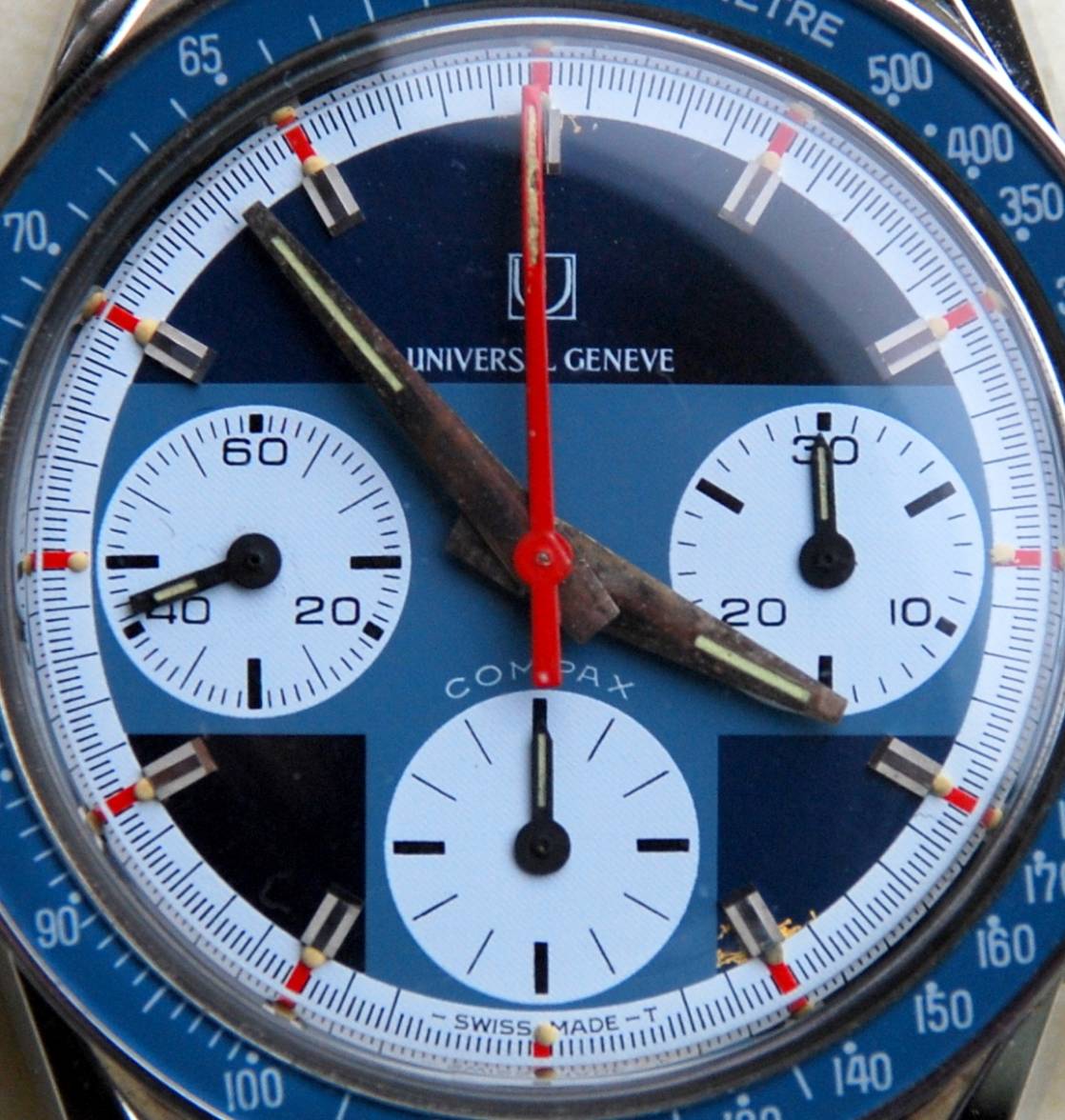

    It seems that your watch shows similar marks on the white sub dial as mine:
    [​IMG]

  8. PaulG Vintage Heuer Connoisseur Mar 12, 2014
    38
    81
    Mick - Exotic Blue is a fine name for this execution and I will adopt that name for the future. Maybe it will stick :)
    My example does not have an additional reference number just 885108 and serial 2,892,9xx.
    As for the band I blieve it Stingray also know as galuchat. It came with the watch and I think its a good match however I would say this is made made material to look like galuchat.
    regards
    Paul
    www.heuerworld.com

    Mick - my example also has some fine marks on the sub dials. Maybe the same, slights shakey watchmake as yours.

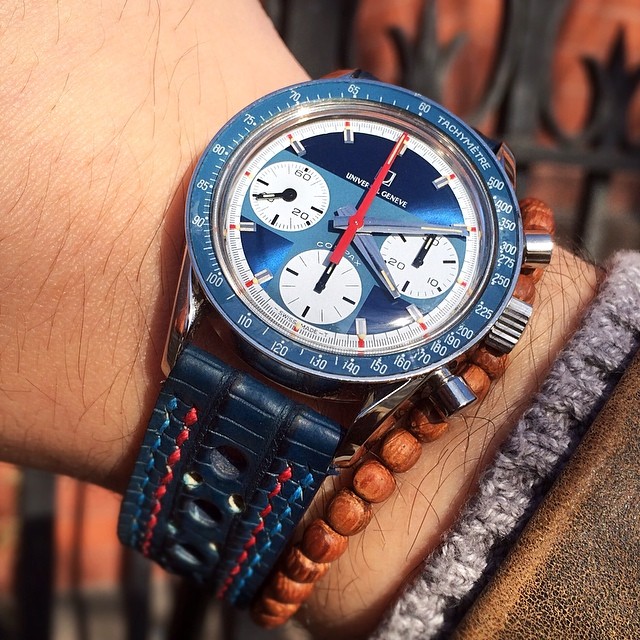

    Mine has the wider sub-hands with the lume in it... no submarks on the subdials. I wonder if it's one of the reasons they changed it? Exotic Blue is definitely a good name. I call my Nina my Nina, for obvious reasons, and the Blue, usually just the Blue UG... but I think Exotic Blue makes more sense. Here's a few pics of mine, two of which are on a custom strap. That sunburst really makes it.
  11. billfactor Mar 12, 2014
    25
    83
    PS - Paul, Your second photo of your Exotic Blue... without that T shape. Man, if they'd made it like that this thing would be... 200% perfect.

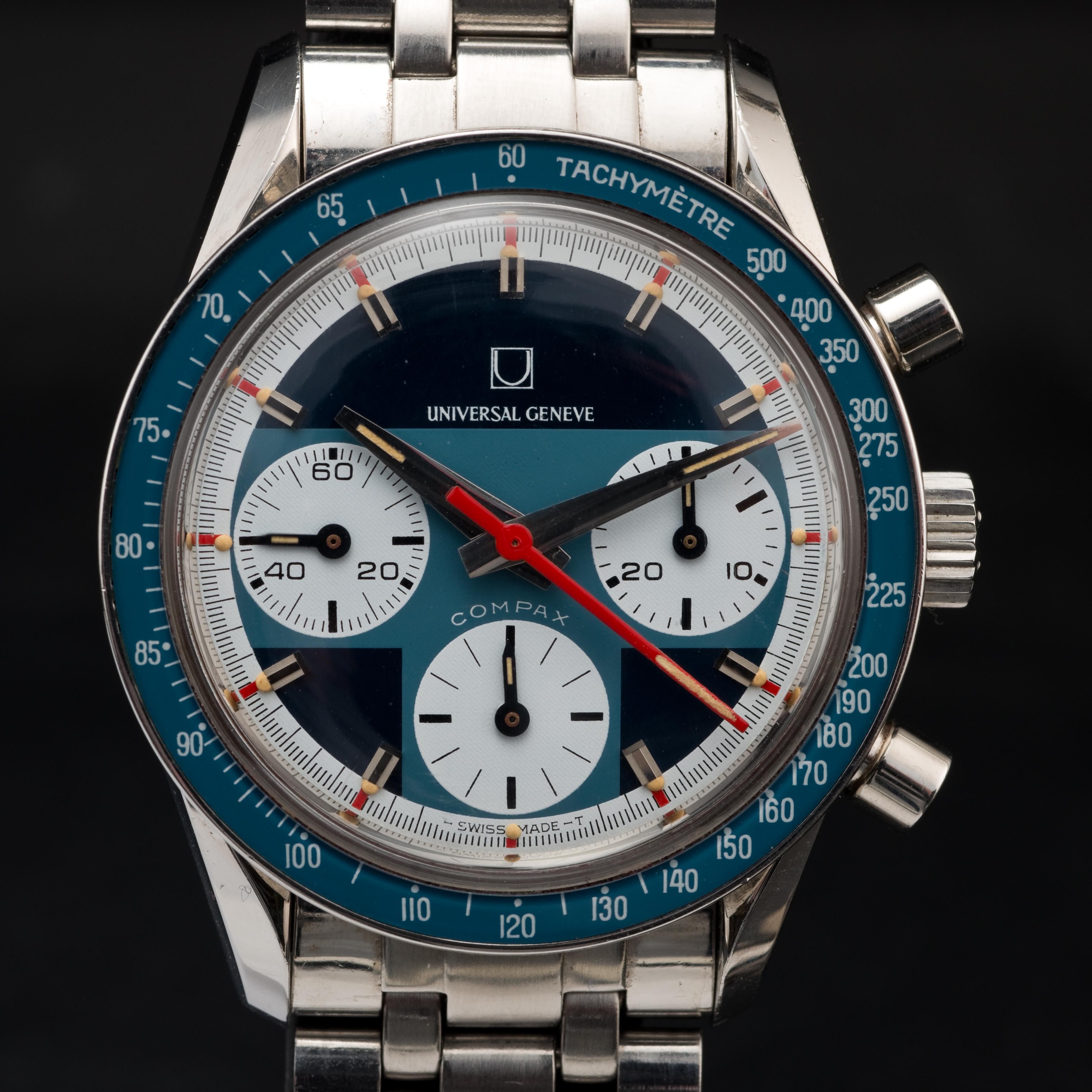

    An high res scan of mine…….

    Thank you very much for this huge image behind the link.
    Could you please tell us something about the metal bracelet I saw already in another of your photos.
    Regards,
    Mick

  14. cozzani1978 Mar 13, 2014
    84
    222
    Hi!
    the bracelet is a JB Champion for Universal Geneve, with UG logo on the clasp.

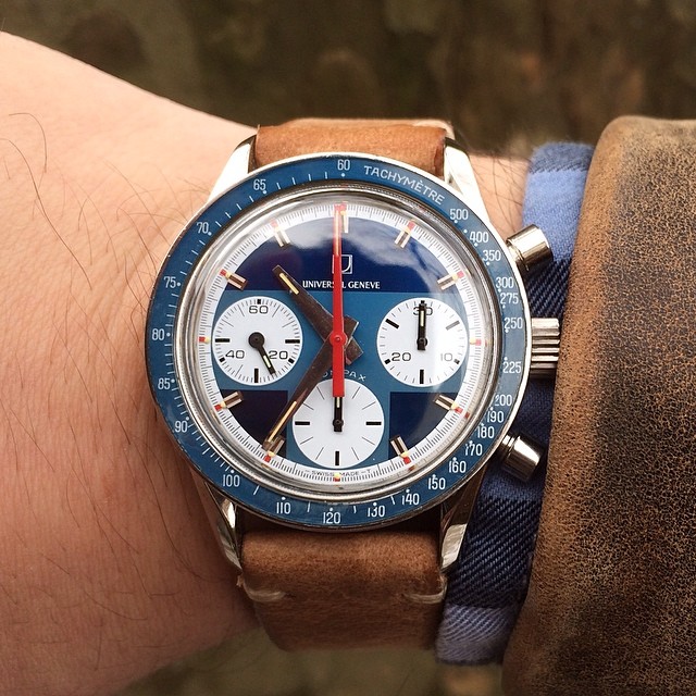

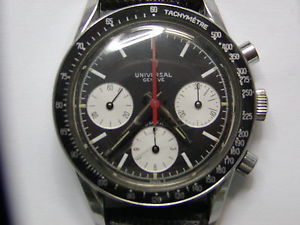

    Bumping this thread with a recent pickup as well as an example that sold on eBay
    Picked up a black dial Compax with applied logo and needle subdial hands. Serial is 2354XXX. Needs a service but I'm thrilled with the watch.
    The second picture is an example of the same reference (885103) with serial 2355XXX. Sorry for the low res, I saved it down from eBay after the auction ended.
    My example has light marks on the subdials - hard to see them in the pictures as the crystal is crazed, but they are there. Seems to follow the trend that the earlier needle hands may have had dragging issues?
    Also, I wonder if we can get enough serial numbers to estimate production numbers?
