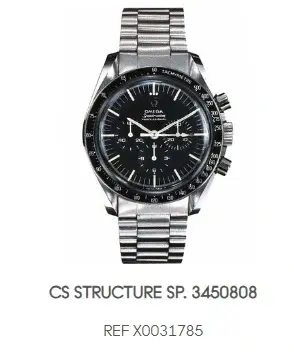

When I look at the image that the Extranet pulls up for the X reference, it's grainy, but to my eye the Omega logo on the dial is an older style, narrow logo. The logo on the 35925000 is the more common rounded, modern Omega logo. That more modern logo is what is on the OP's watch, not the one from the X reference.
So why was this X reference put on the paper? Well clearly there was something different in the case back, so the deep dive required an explanation for that, and that is what the technician gave the OP. Unfortunately it has lead them to believe that this watch is something that I don't really think it is.
I would be interested to see if inside the case back both case numbers are present - 1450808 and 3450808. I've seen that before.
For me this is a 35925000, and nothing more, at least at this stage.
And it looks applied, plus the long hour markers and DO90 point to a 105.012 or 145.012 reference Speedmaster.

So Omega just used a wrong image then ?
528
1,969
Regarding the extranet image, I’ve never seen a Speedmaster with this combination of elements:
Cal.863
Applied omega logo
Long indices
Squared chrono second hand
DON bezel
1447 bracelet
Very strange 🤔

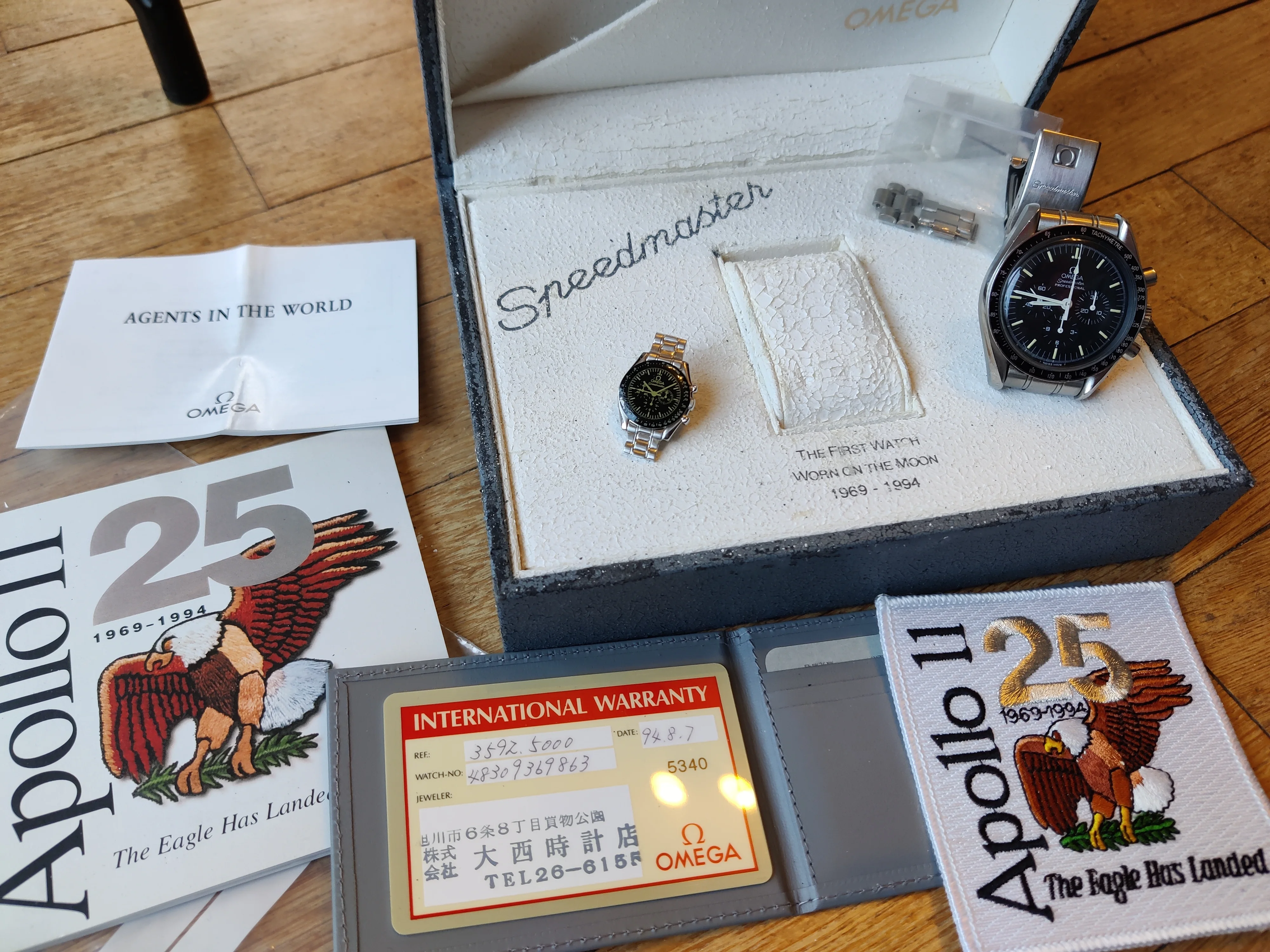

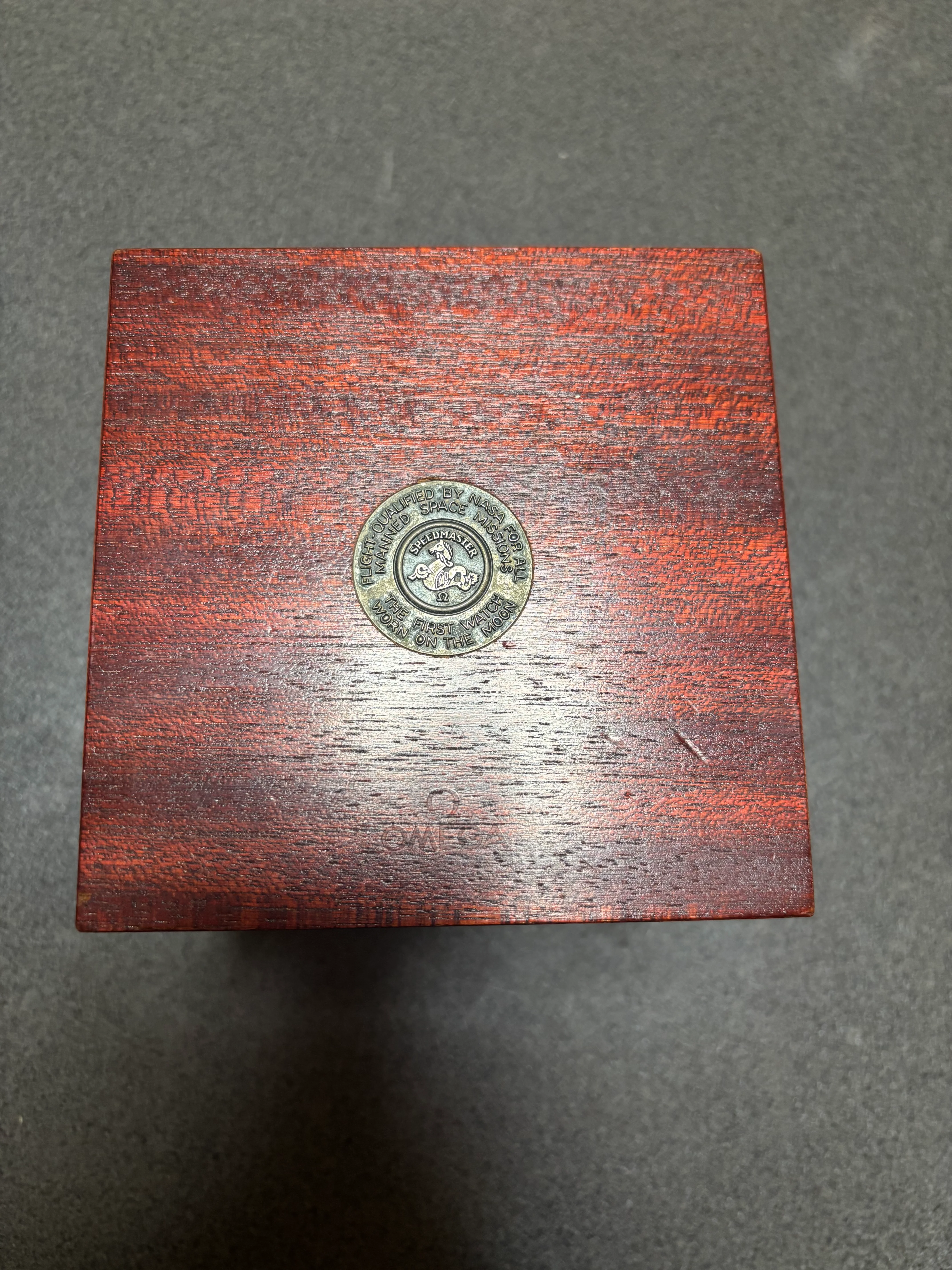

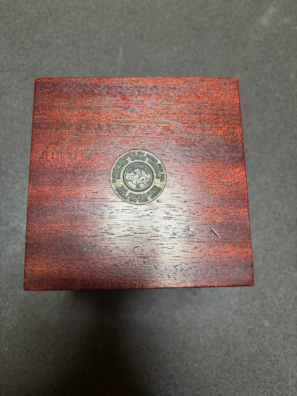

Looking at my Speedmaster based on this link, I do indeed have a matching 3592 model!
However, I have one question. The accessories include a mahogany wooden box, a patch, and a booklet in Spanish. Are these also included with other 3592 models?
209
237
Unfortunately, the set sometimes doesn't match the watch, so it can't be used for identification. I also had a 3592 with a complete 20th anniversary set; either the authorized dealer made a mistake during the sale, or these are sets that were later reassembled, which is more common.
209
237
the waranty card fit, but not the rest...
It's important to remember that sometimes customers don't want to be bothered with the box and documentation; some just want a watch to wear, and the set stays with the authorized dealer before being given to another customer or resold elsewhere.

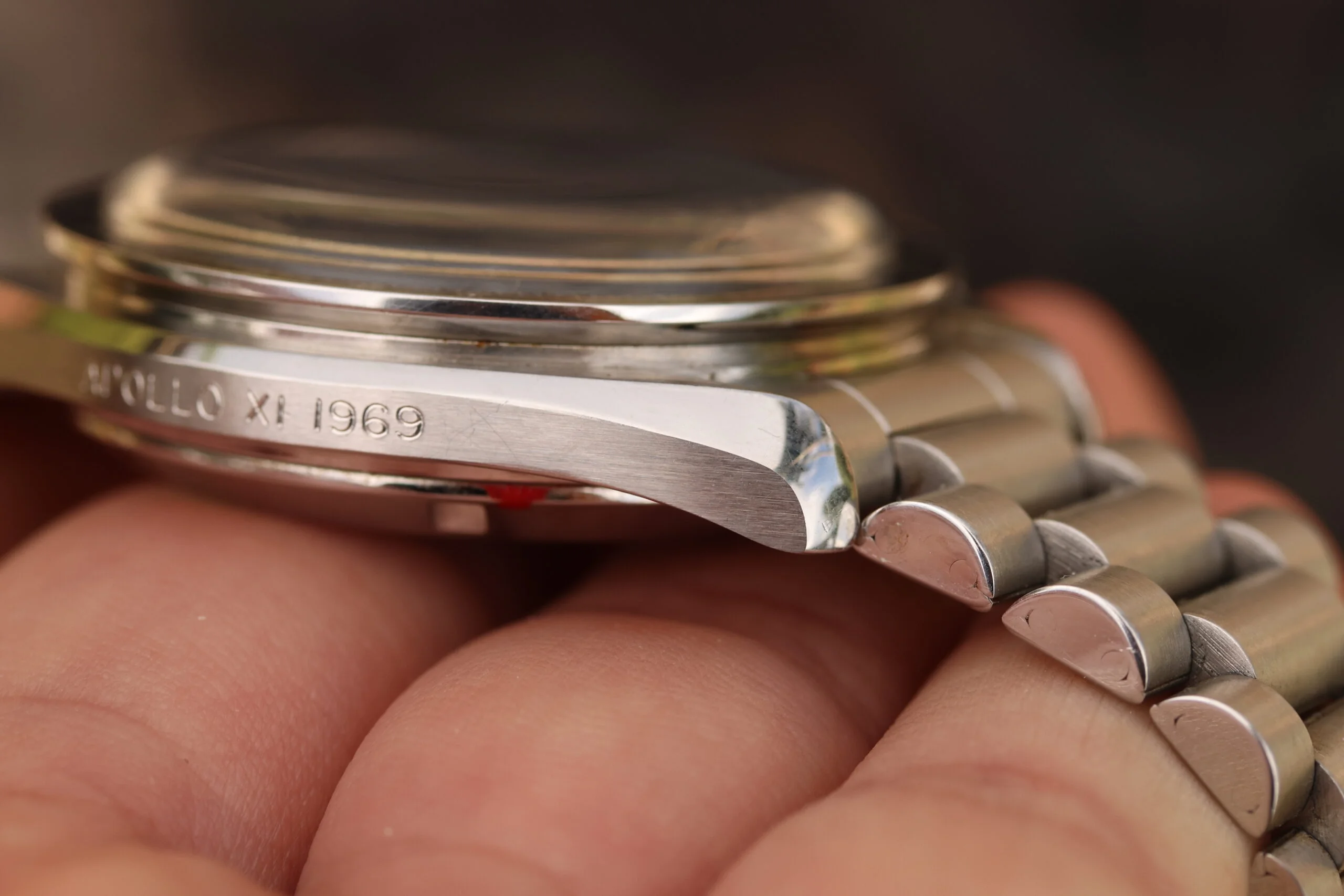

209
237

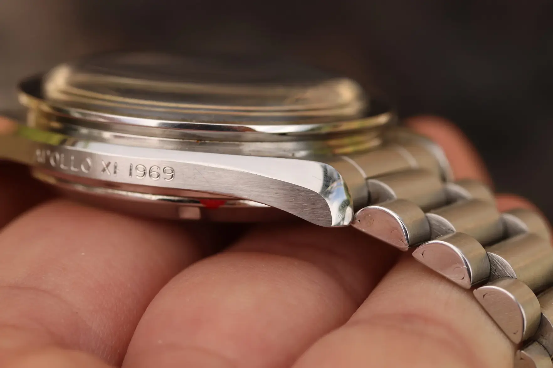

There is no doubt, as the attached certificate clearly states that the watch is engraved "Apollo 11 1969," a feature also found on the case edge of some 20th-anniversary models. This is not the case with your watch, proving that the documentation does not correspond to this specific model.
here the watch corresponding to your certificate
investigations closed

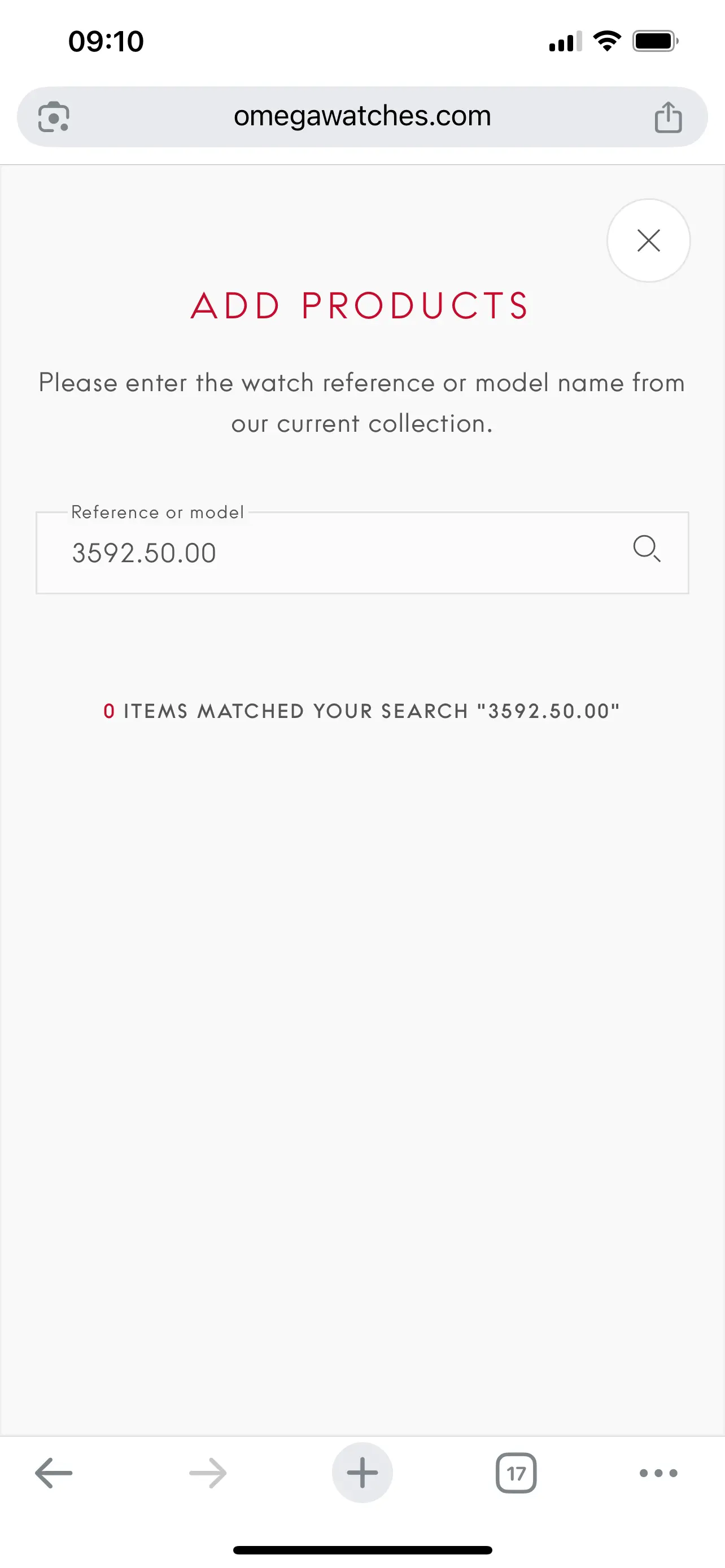

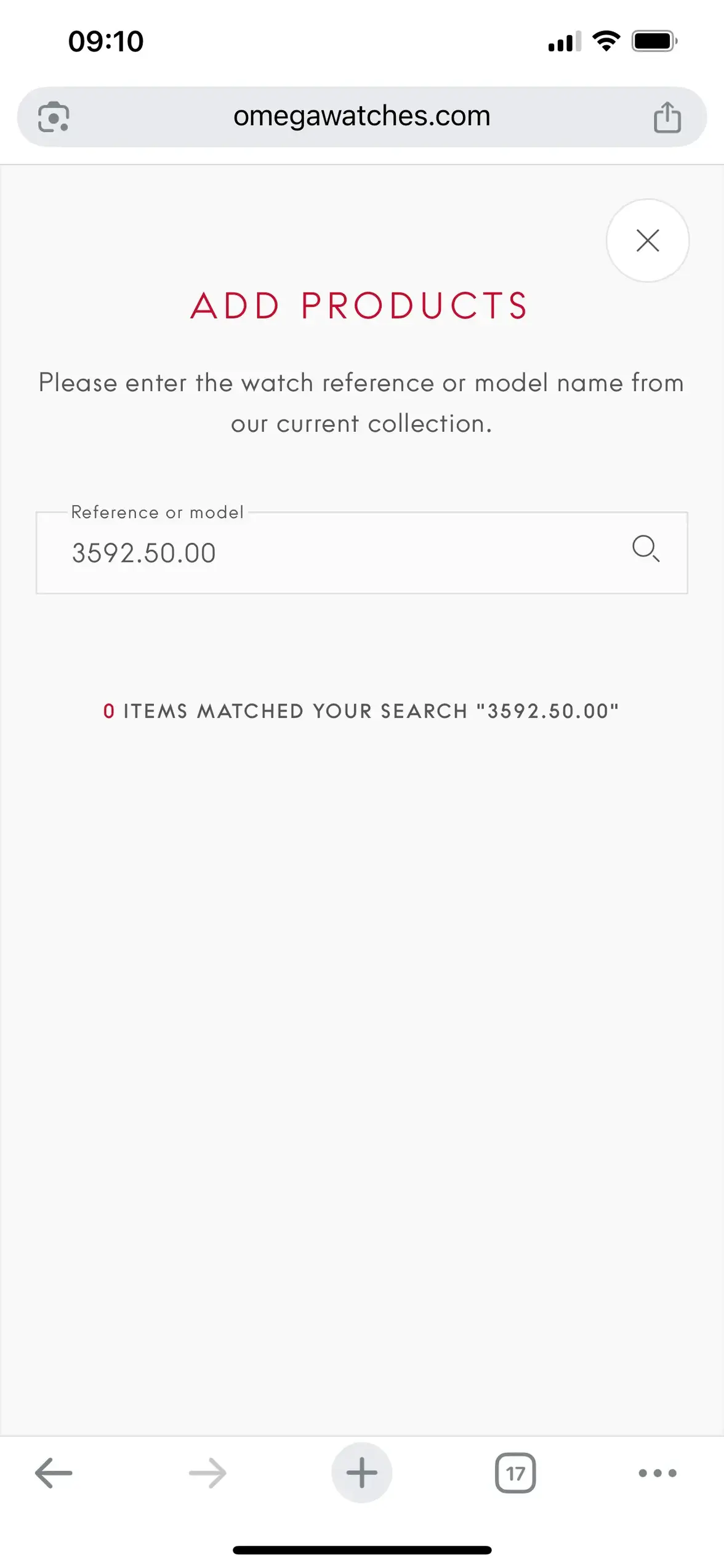

It’s interesting that Omega could not tie a watch to a PIC, but this reminds me about their website dashboard, since I have to map my 3592.50.00 to 3572.50.00 because Omega said their no such reference.
