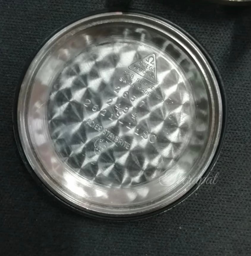

Hi forums,
I want to share and ask this forums.

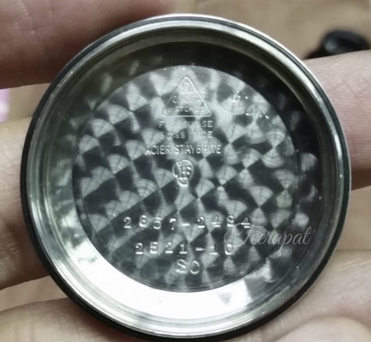

Does anyone get the watch with “3 case reference” in one watch? (I see most coming with only “2 ref” such as 2852-2853 or 2846-2848)
My watch:
(it looks original one and correct to my eyes):
I think this combination can be found in “jumbo” (36.5 mm excluding crown) seamaster with “officially certified” that using caliber 354.
I search about the ref. 2657 that should be “sub-second” version
However, it should look like another reference such as “2846-2848” that can correctly use cal. 491(sub-second) or cal.501 (center-second).
Thanks @hoipolloi for always advice me.
Regards,
Teerapat
1,024
4,126
Is there any combination of “triple reference” ?
Mine : 2657/2494/2521
@seekingseaquest : 2765/2764/2771
Thanks for sharing.
