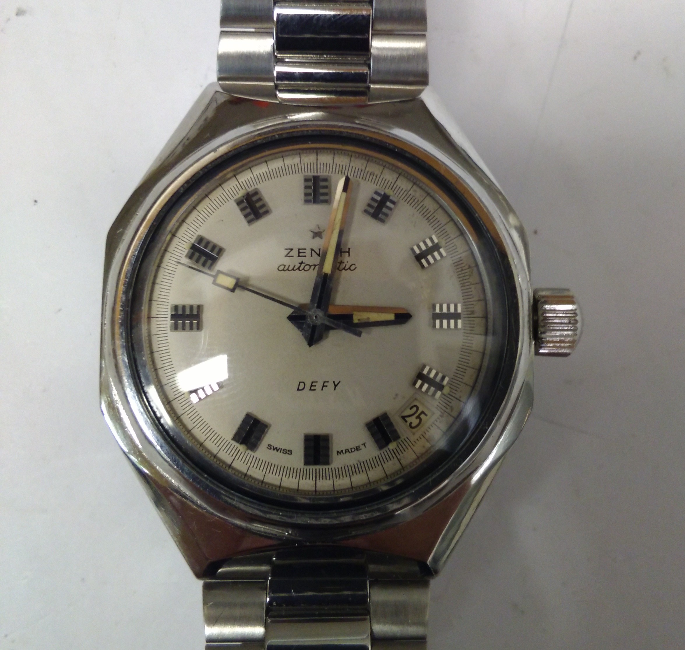

White (A xxxx)
White (A 3643)

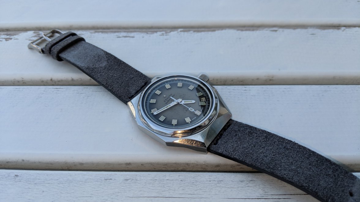

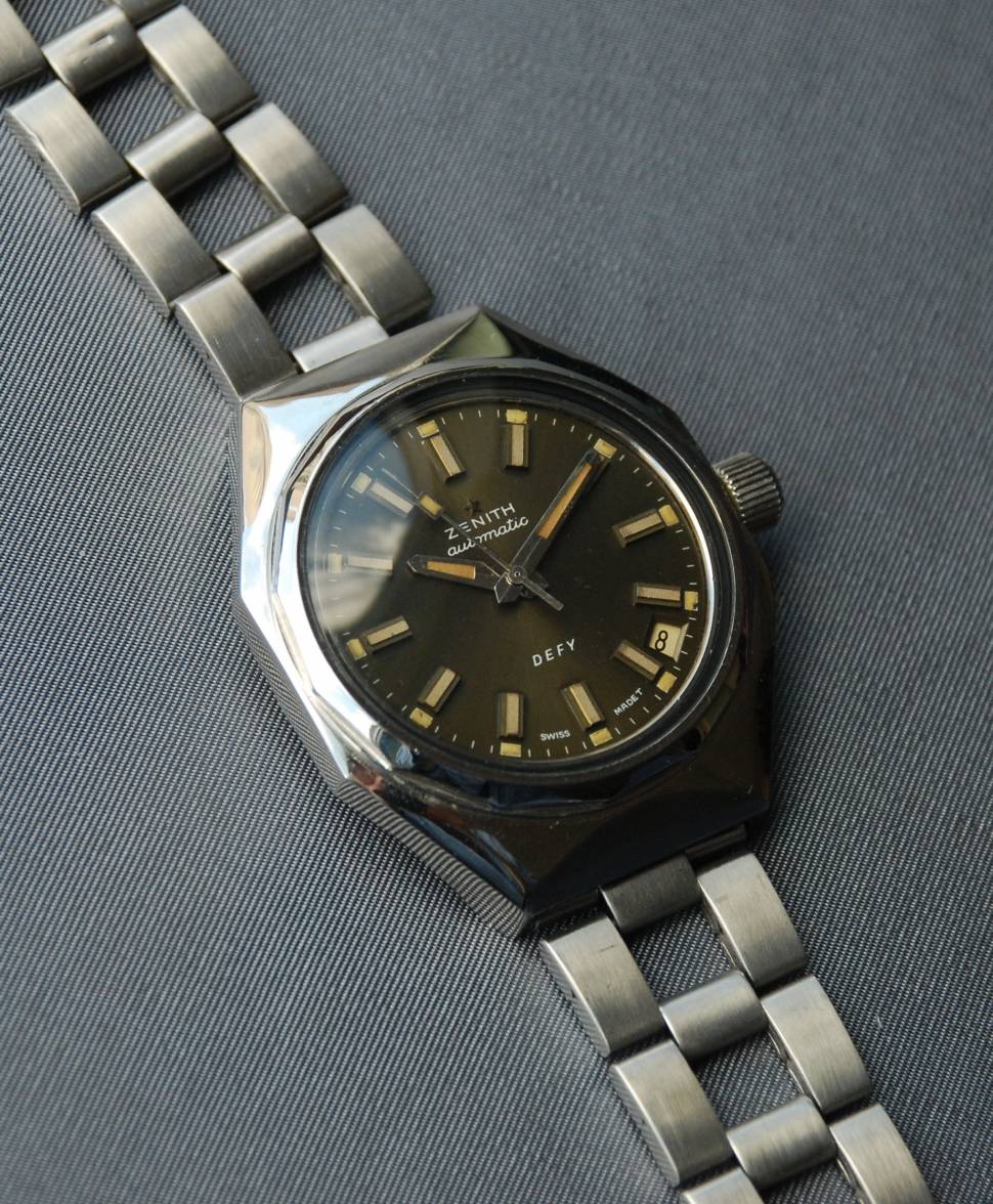

Black/charcoal (A 3645)

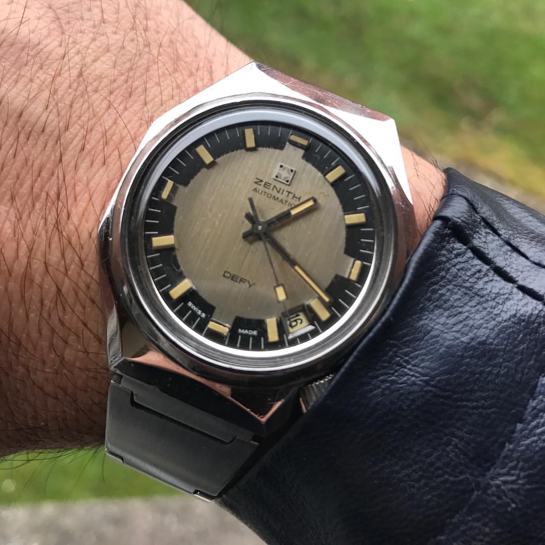

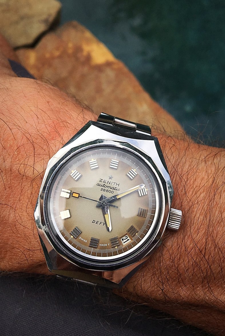

The later models have the upgraded cal 2562 PC movement that beats at 28,800 bph. There are five different dials – khaki, white, black/charcoal, turquoise, and burgundy. Some have the elongated hour markers while others have the square, chunky hour markers. Notice the 28,800 printed on the dial.
Khaki (A 3642)

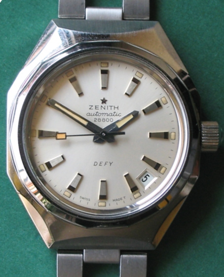

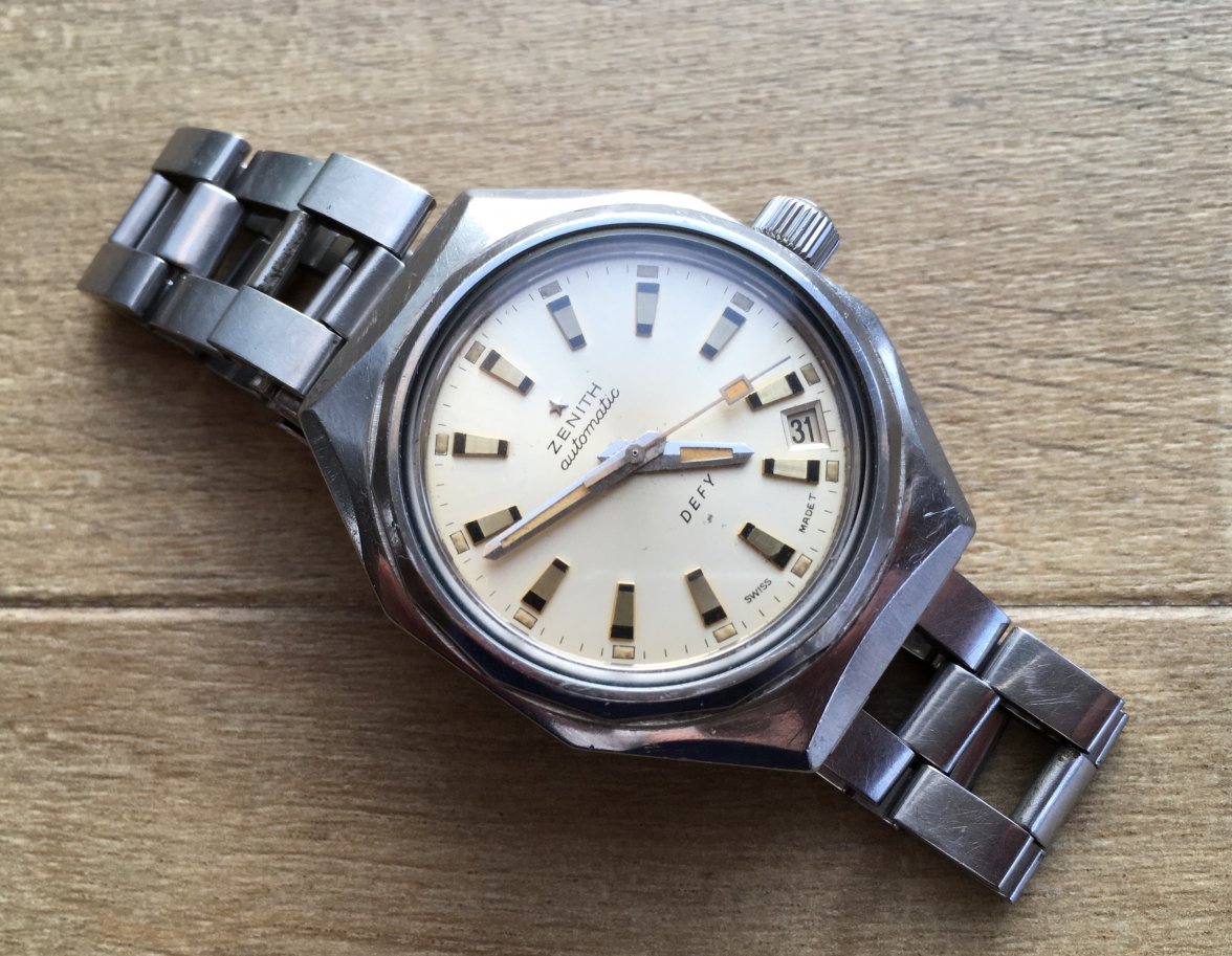

White (A 3643)
Black/Charcoal (A 3645)

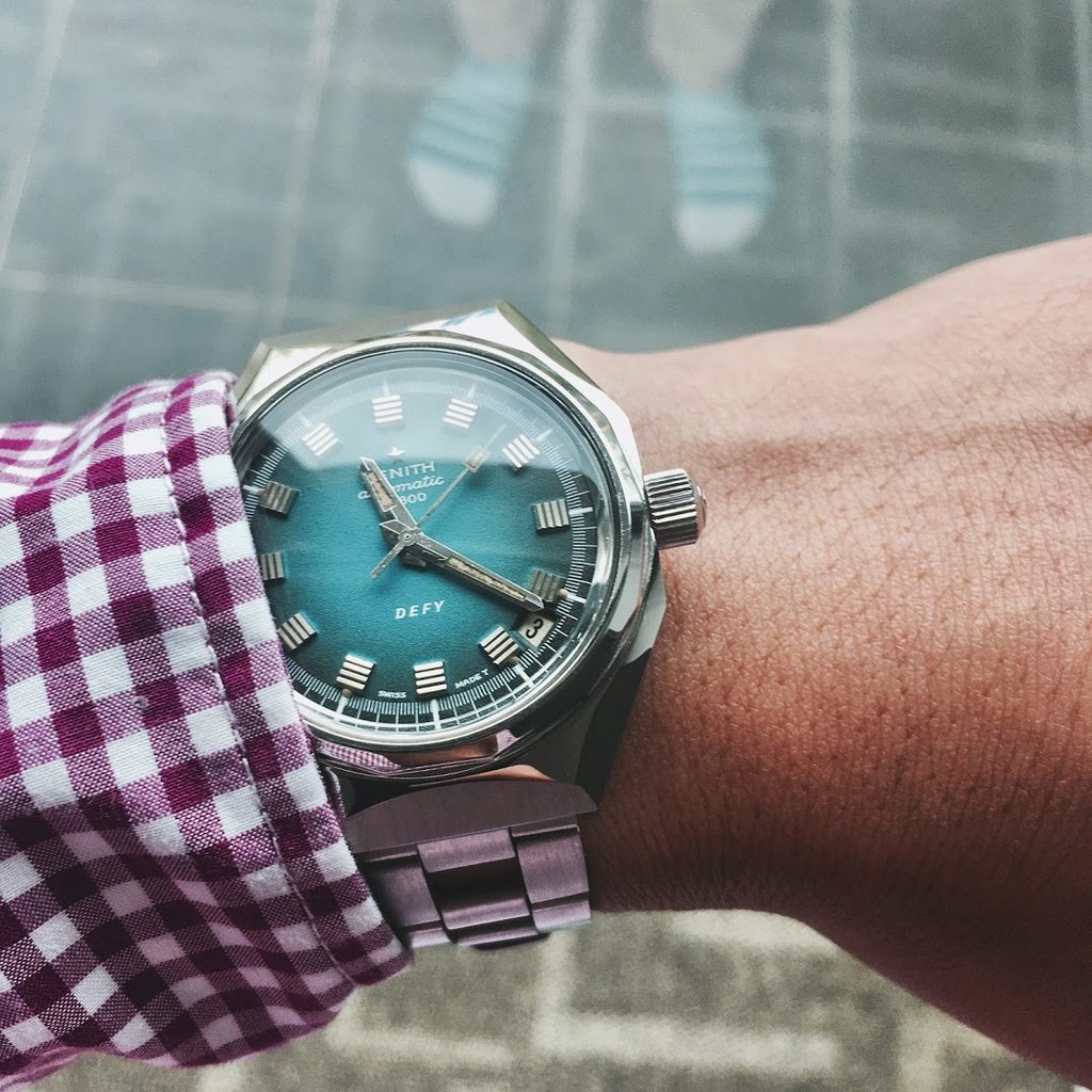

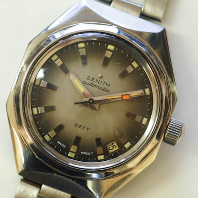

Turquoise (A 3690 - reference number unconfirmed)

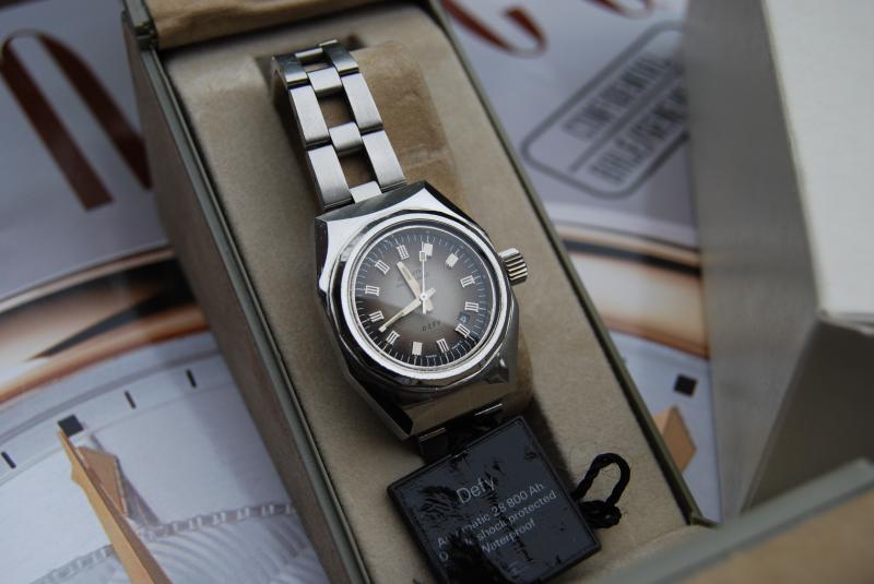

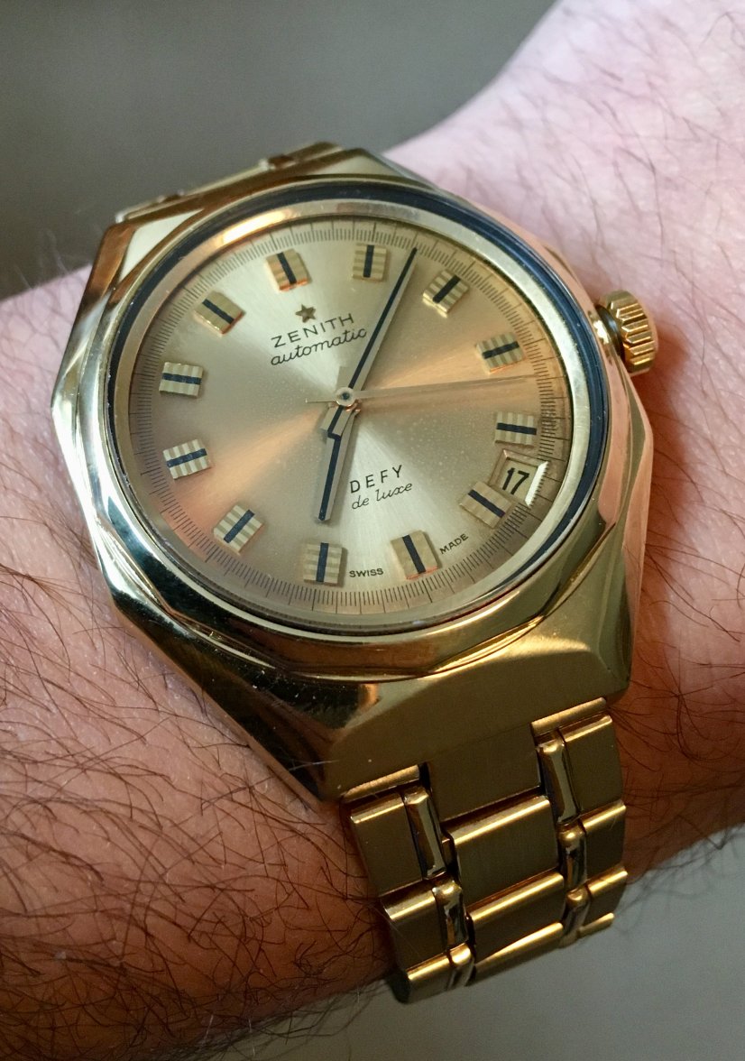

Then there is the 18k gold version available for both men and women. The men's version comes with either a gold or dark green dial while the women's version comes with a white dial.
Men's, Gold (G20672)
Men's, Dark Green (G20672, same as the gold dial)
Women's, White (ref needed)

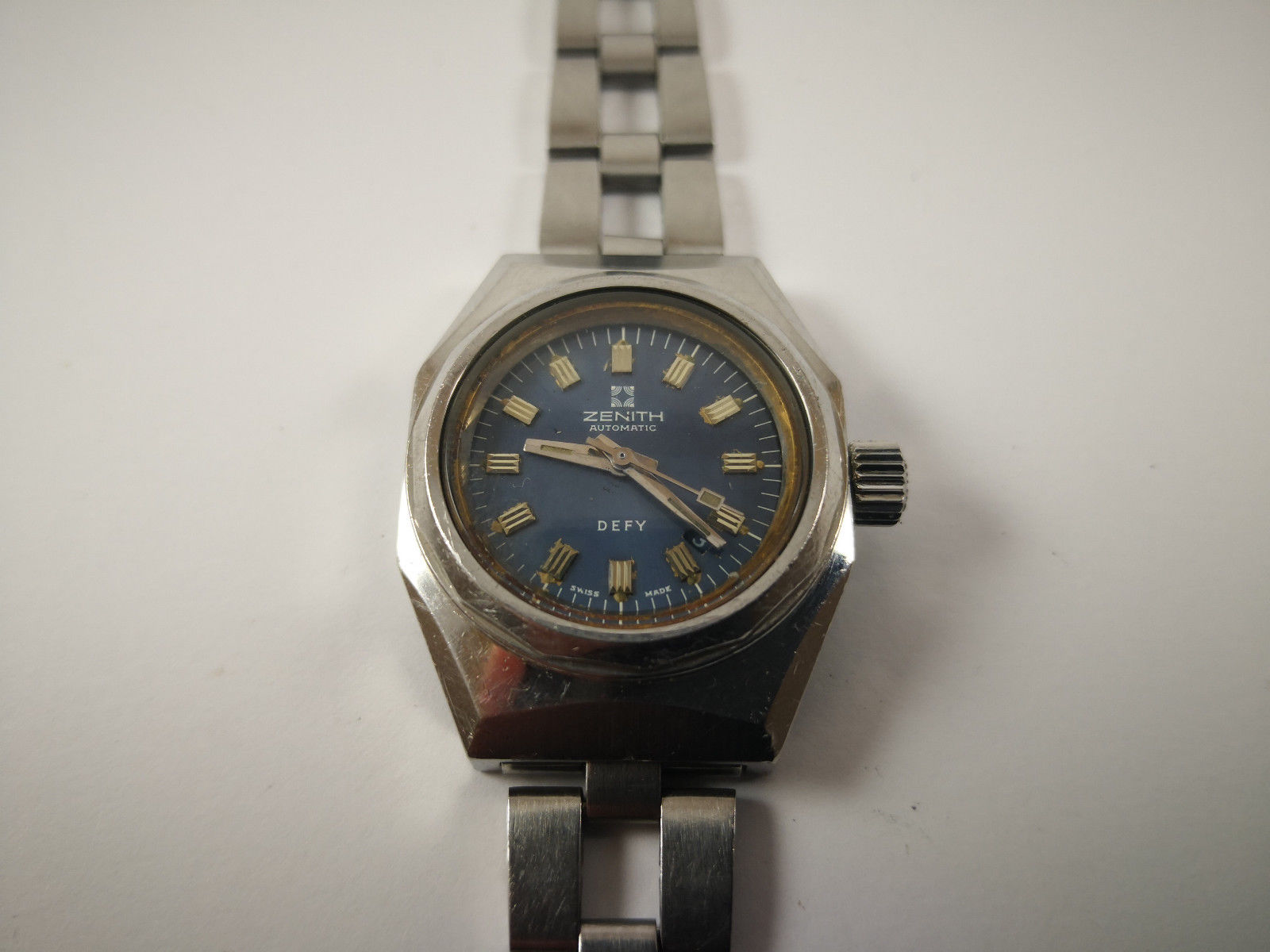

Blue (ref unknown)

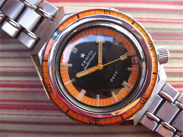

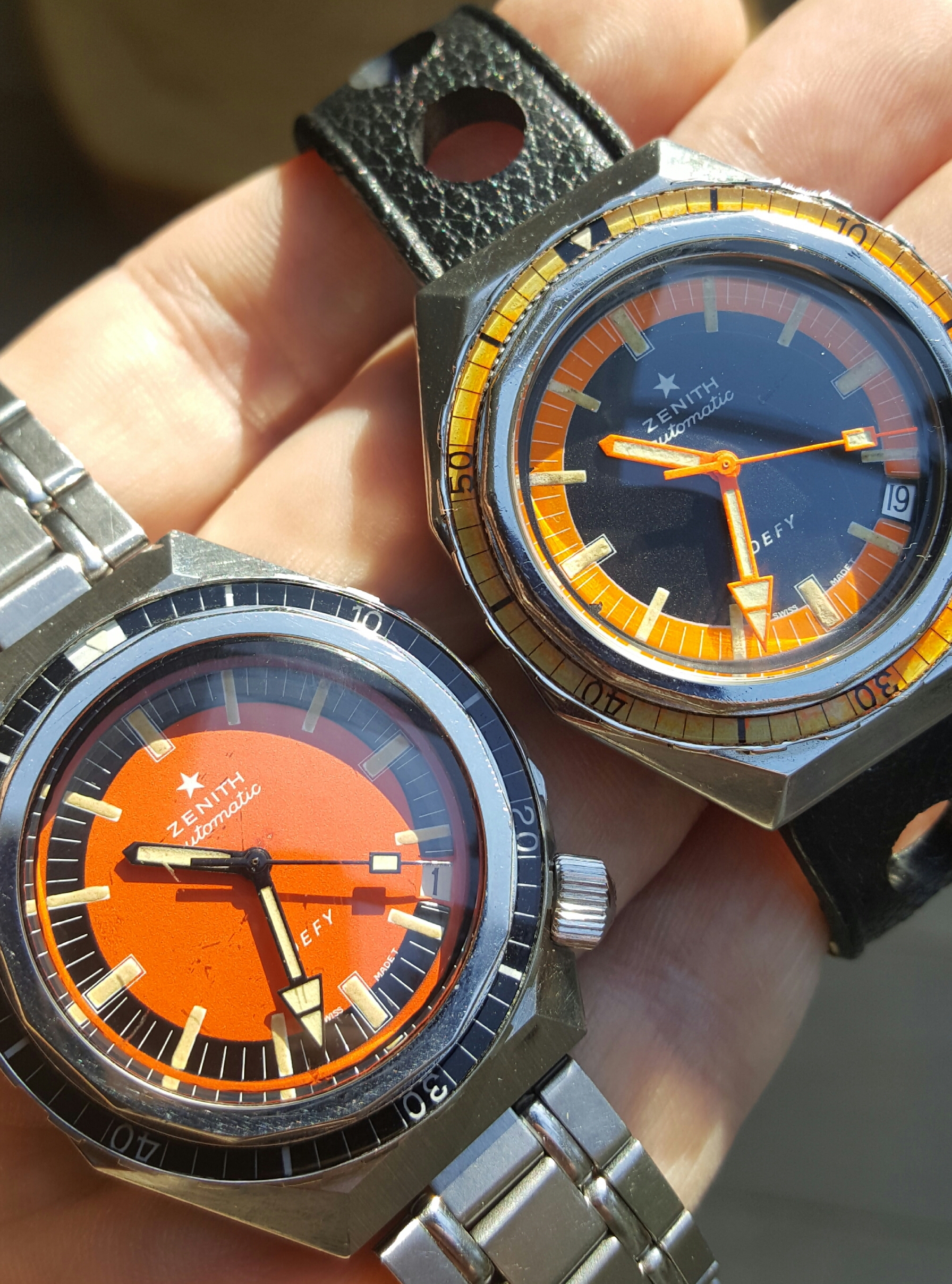

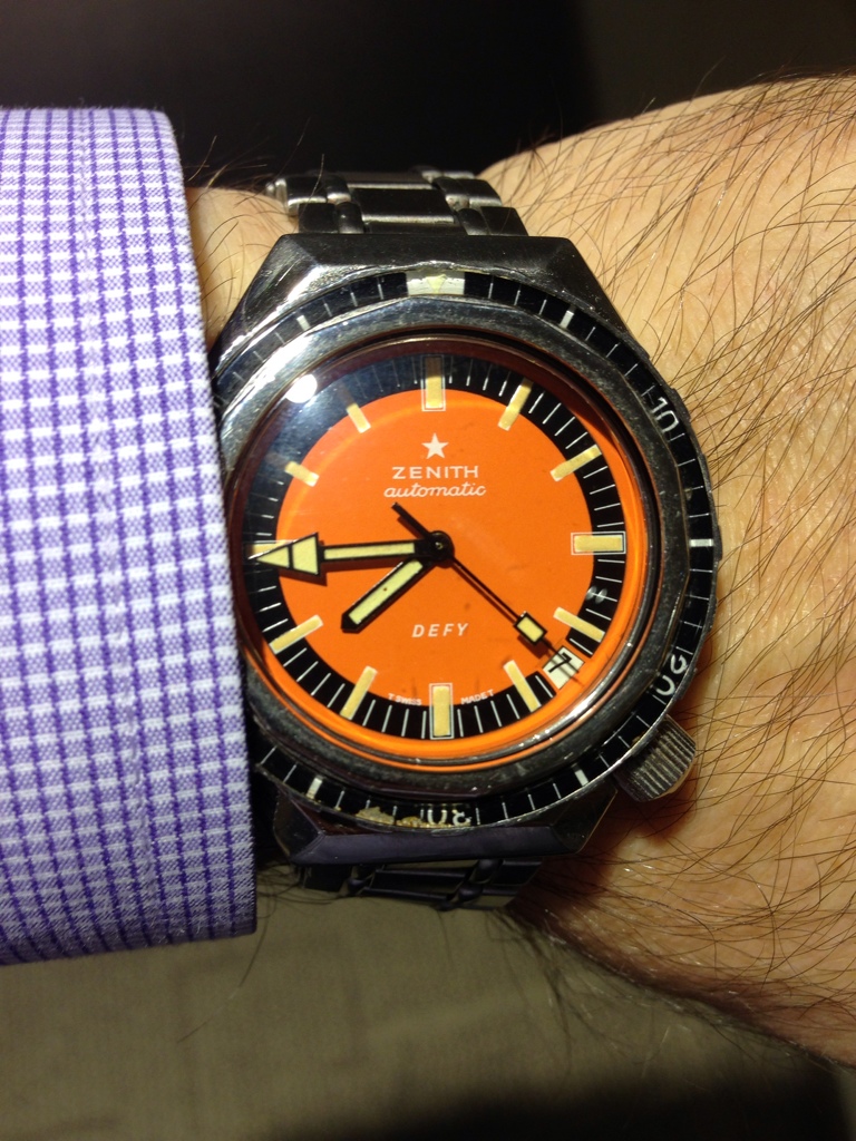

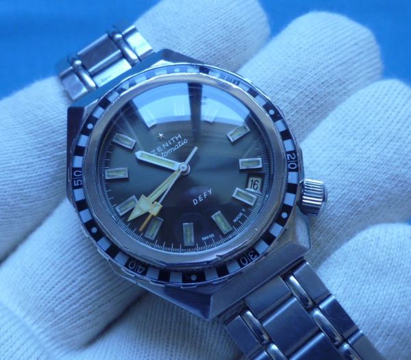

The Defy sub-sea line has the octagonal case but with the crown at 4:30. It also has different style hands and bakelite bezels. There are four different dials: white and black with the roulette bezel, and orange and black that are mirror images of each other.
White (A 3646)
Black (A 3646, same as the white dial)
Orange (A 3648)
Black (A 3648, same as the orange dial)

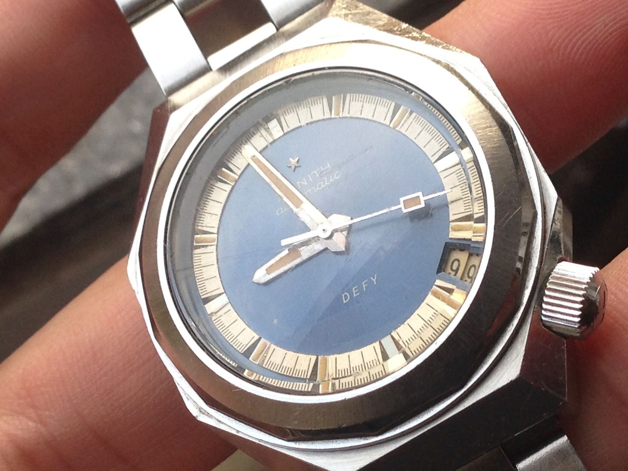

There also exists another Defy with the crown at 4:30 that isn't classified as a Sub-Sea. This single reference has a blue dial with a silver minute track. This reference comes with either the cal 2552 PC or the cal 2562 PC.
Blue (A 3651) w/ cal 2552 PC
Blue (A 3651) w/ cal 2562 PC

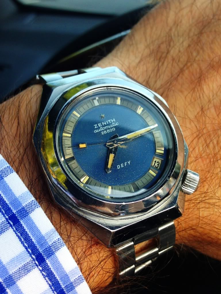

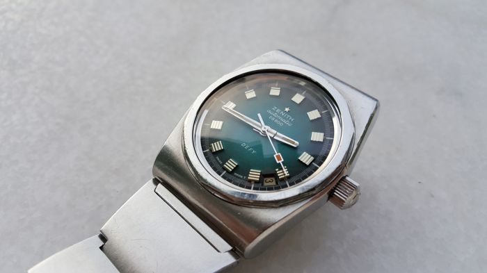

Are you sure the turquoise is original, and not just a transplant of the dial and movement from one of the slab case Defys? For example, have you located any factory literature on it? catalogs, brochures, etc?
Like 1
1,318
7,877
I haven't seen any factory literature or catalogs that show the A 3690. So not sure, but it is an educated guess.

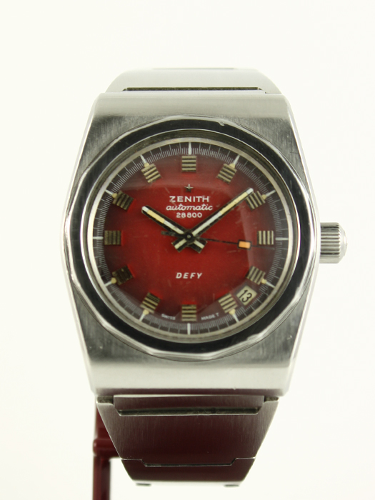

We know Zenith released both the burgundy and turquoise dial in the barrel (tonneau) case:
A7682
A7683

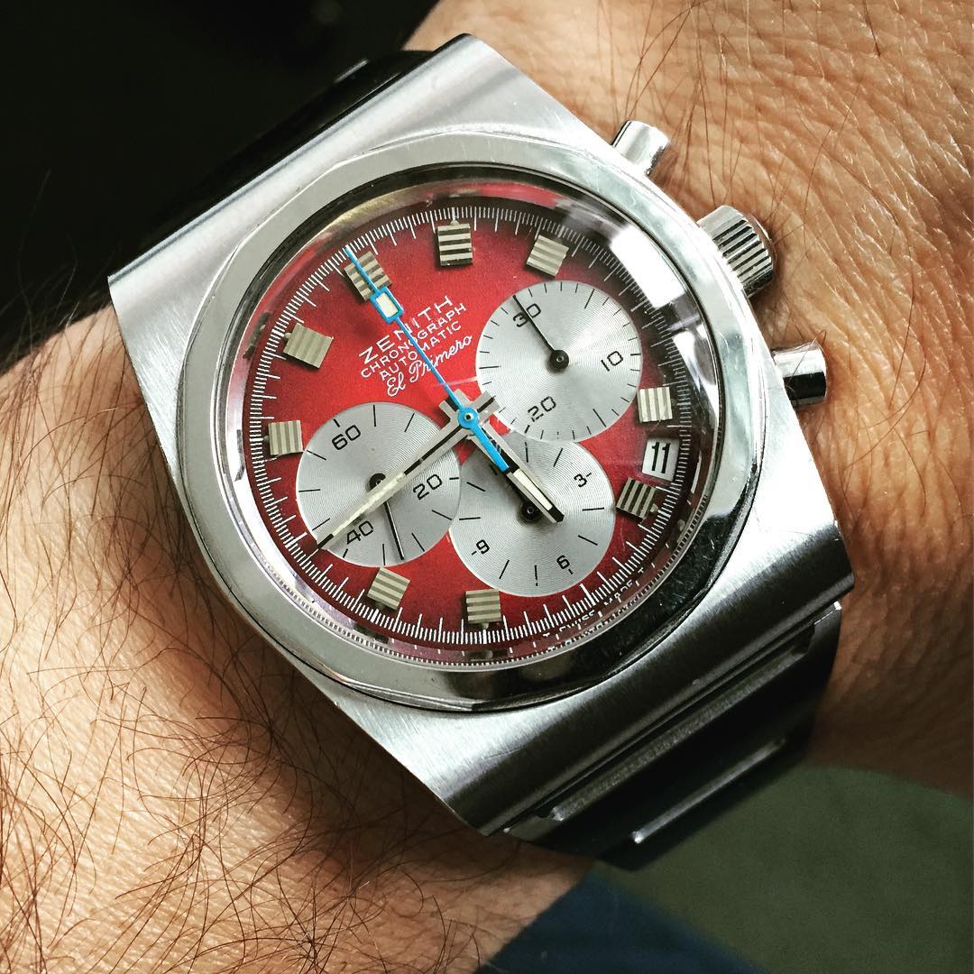

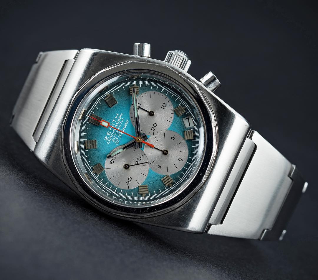

We also know that Zenith released the Defy as an El Primero automatic chronograph with both the burgundy and turquoise dial.
A781
A782

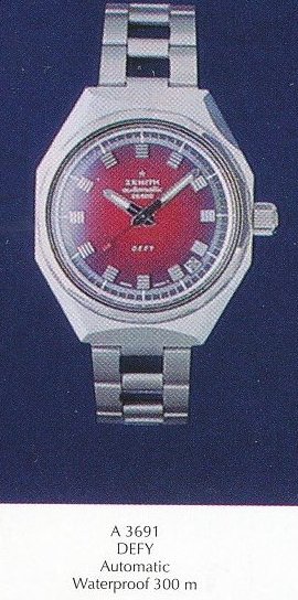

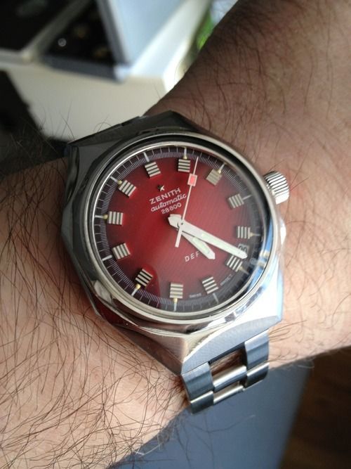

Now, for the octagonal cases Rossler shows an example of the burgundy dial.
A3691
This tells us that the A 3691 exists. I believe it is then a fair likelihood that Zenith also released this case type with the other dial - the turquoise dial A 3690. Thoughts?
What is, however, an obvious dial replacement is this example. Dial from A 7681 (barrel case) in an octagonal case.

A customer of mine has a turquoise dial hex Defy exactly as pictured and as I love the watch have asked him about it in the past, he said he bought it from new back in the 70's.

@slique12 Where are we getting the A 3690 reference number for the turquoise dial?
@LouS I see where you are coming from here. If there is no factory documentation found thus far for this reference, then:
1) How do we know this reference exists?
2) And if it does, how do we know if A 3690 is the reference number?
Regarding 1), in addition to my response above about Zenith releasing two other references with both burgundy and turquoise dials, the fact that there have been a fair number of turquoise dial octagonal examples seen over the years (vs say the brown with the red accents) also adds some weight to the originality argument. But, even taking both arguments together doesn't create a water tight case for originality. For that, we would need some factory documentation.
Regarding 2), I borrowed this reference number from readings on another watch forum. However, what is interesting to me is that the turquoise dial reference numbers for the other two models are 1 digit higher than the burgundy dials. Based on that numbering system, it makes me wonder if the octagonal cased turquoise dials would be 1 digit higher than the A 3691, so A 3692 instead of A 3690.
