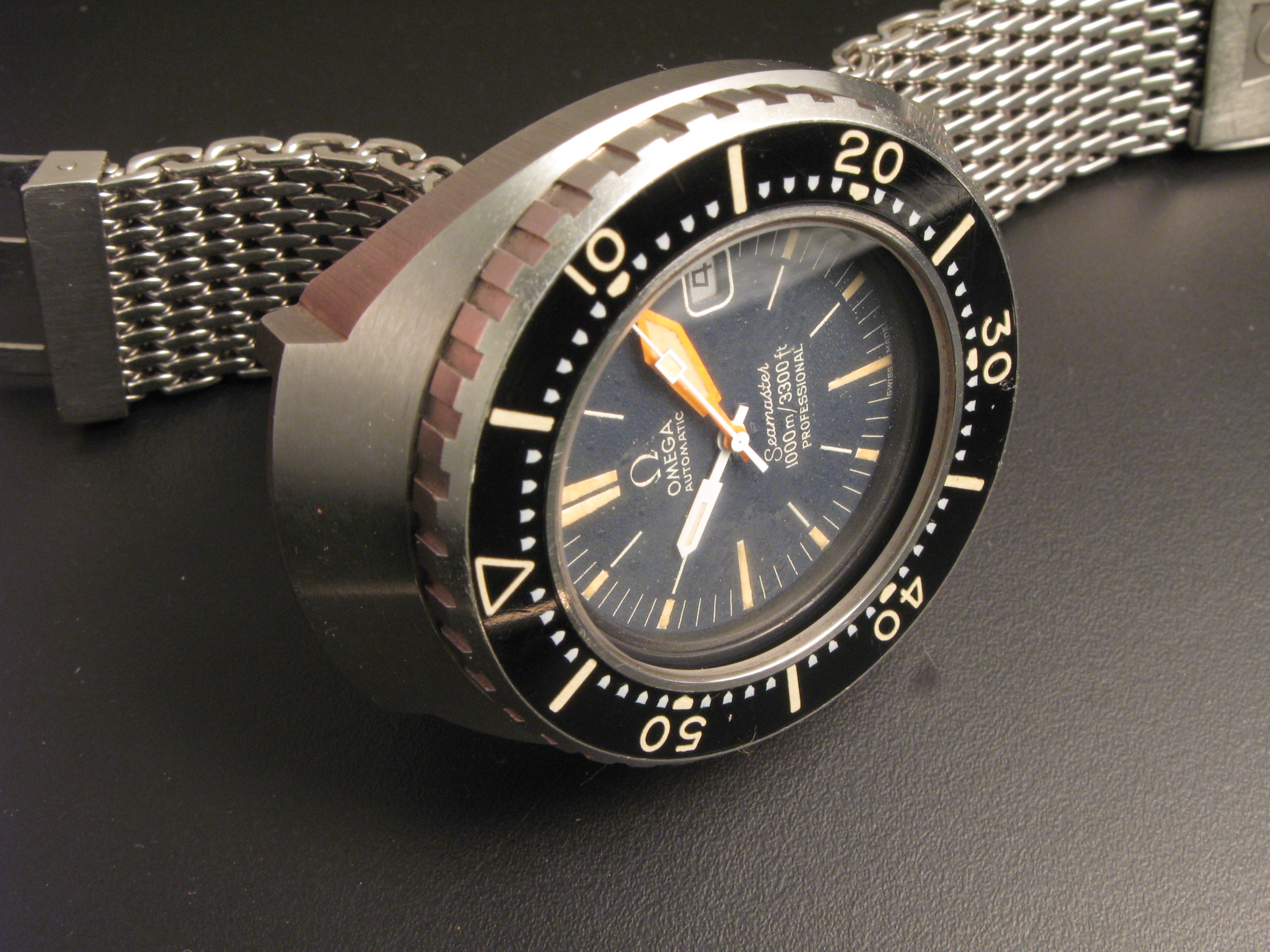

    An Original SM1000m ref166.093

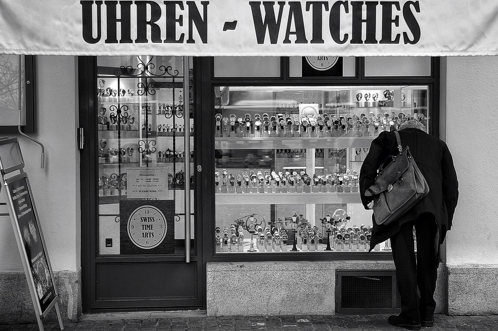

    Then around 2010 they started to appear on the market in excellent, almost New Old Stock condition. They continued to trickle on to the market at the rate of about one per month, mostly from the same supplier, Yvonne at SwissTimeArts in Winterthur, Switzerland. This lady was a notorius seller of Franken watches and fake Heuer boxes intermingled with some quite rare and desirable pieces. She also had a reputation of angry customer service typed in ALLCAPS!
    So if you have seen an SM1000 166.093 for sale, likely as not it will be one of these watches. They are made up of Omega service parts (bezel,dial,hands and bracelet), a doner 1012 movement and a case most likely from China. I am almost certain that they have never been anywhere near Omega.

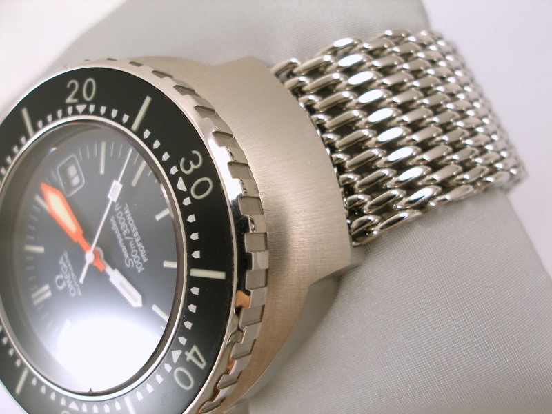

    A Replica SM1000m (note incorrect radial brush finish)

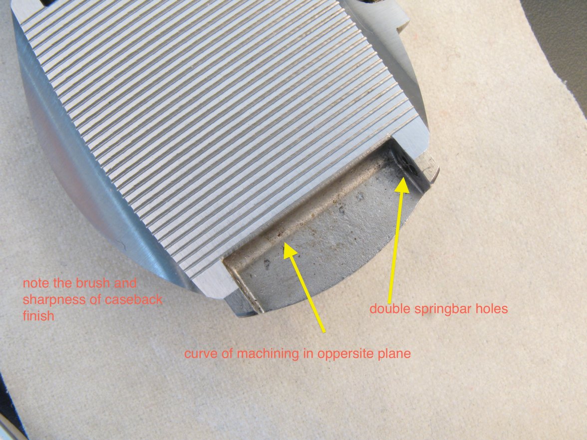

    The tell tale signs are easy to spot and I will attach some pictures now to illustrate the difference between original cases and the dubious replicas.

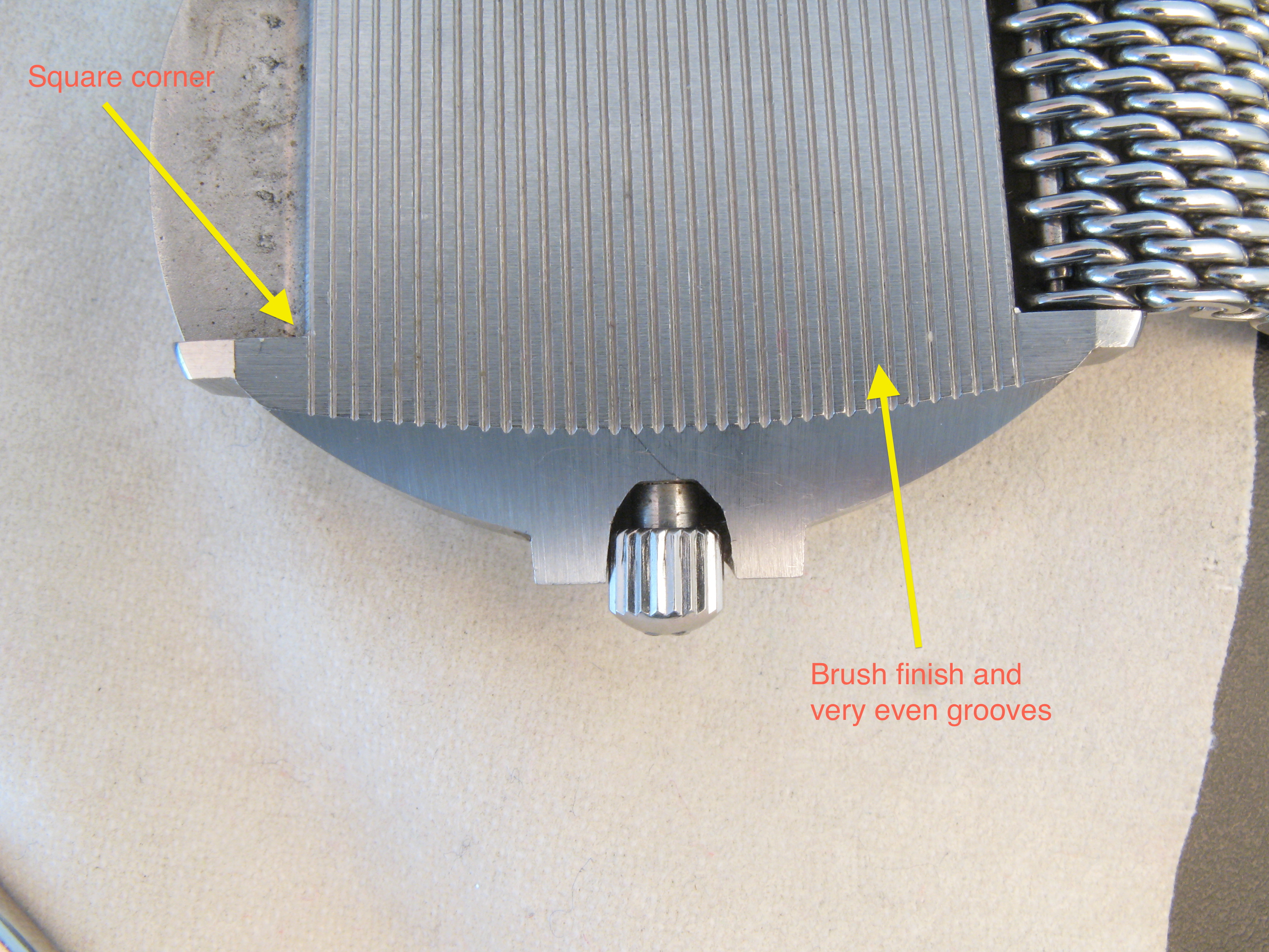

    The following pictures are of a genuine watch case and are annotated to highlight the genuine watchcases features

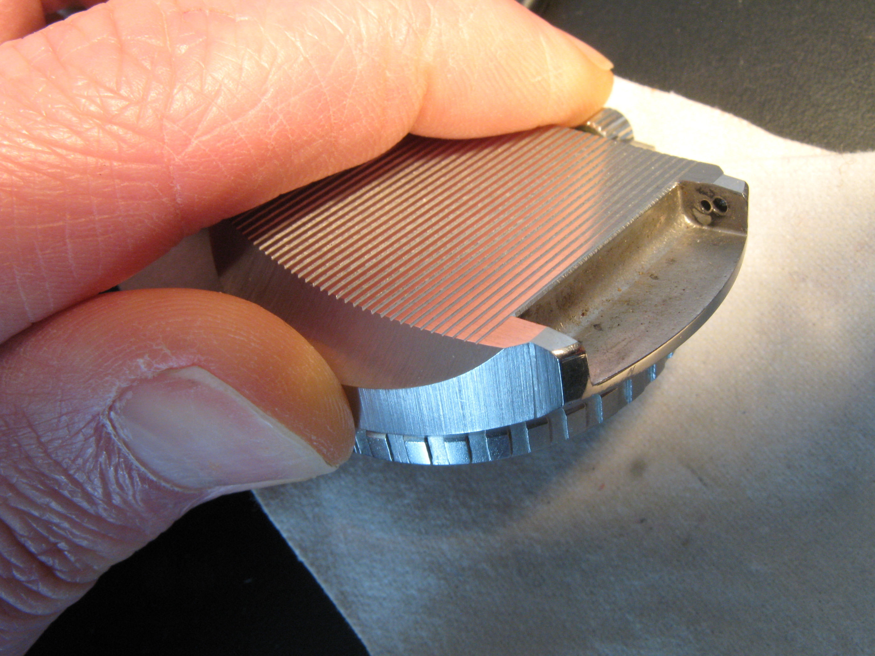

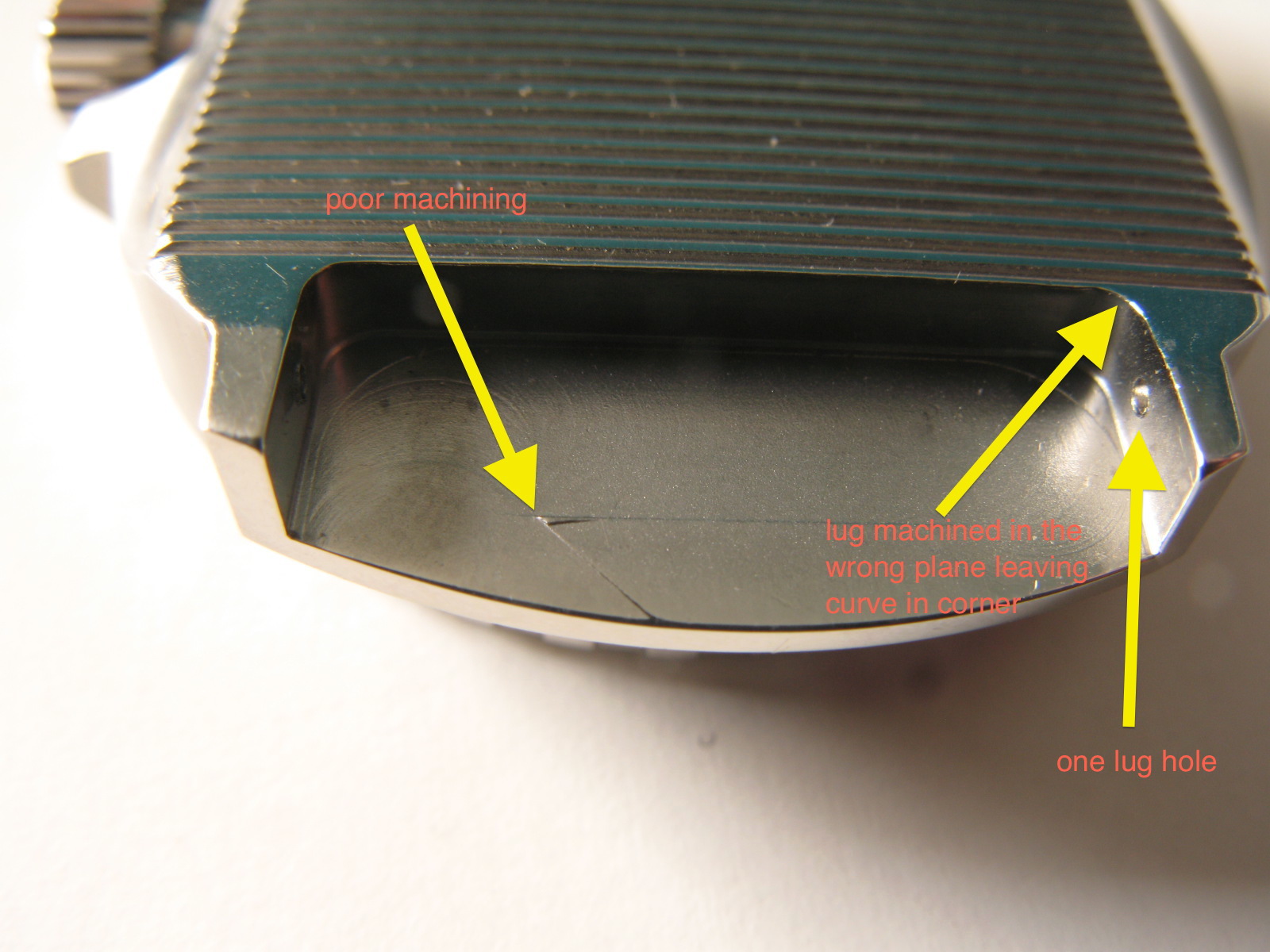

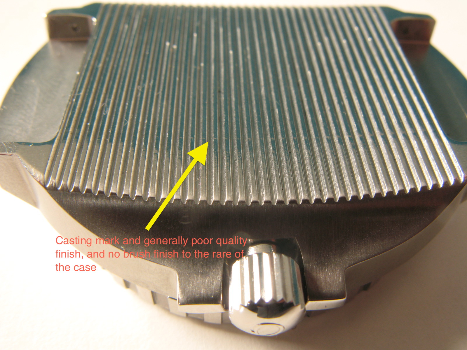

    The fake case as shown below is of a much lower quality of finish and has a few differences in manufacturing. The brush finish is Radial and not Circular as it is on the original watch.

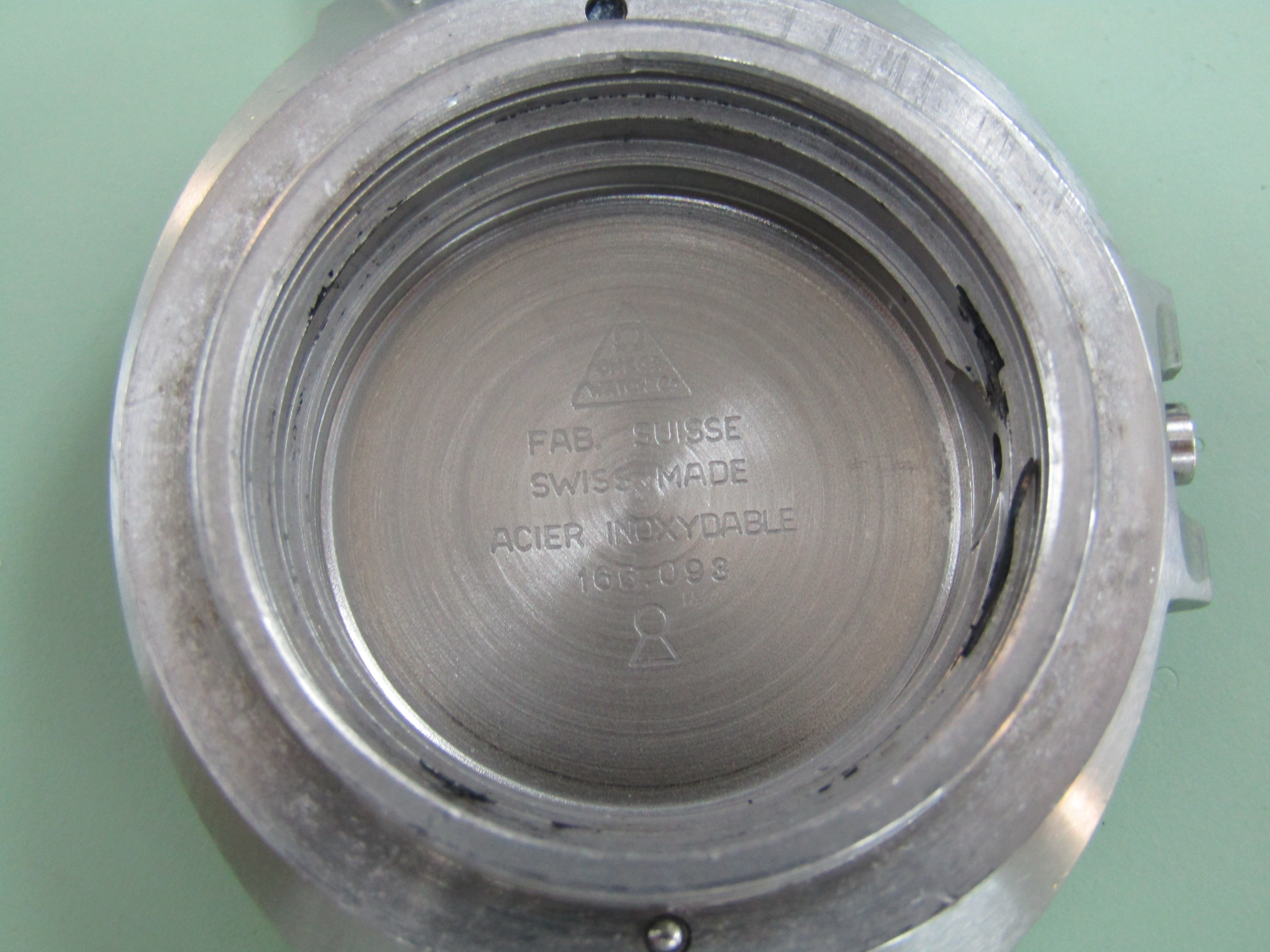

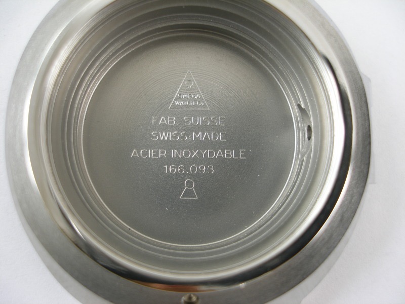

    What seals the case for these watches being fake for me, apart from the obvious quality issues, is the case manufacturing marks and the Omega symbol inside the case.
    The diving bell symbol for EPSA is used on both watches but on the fakes it is unlike any other example I have seen. The 'diving bell' has changed into something that looks closer to Bod, a favourite TV animation from my youth. The circle does not even join up! If the case maker cannot get its own logo stamped correctly, the writing is on the wall.
    The Omega symbol, always surrounded by a triangle with rounded corners is found in a triangle with sharp edges.
    An original case below
