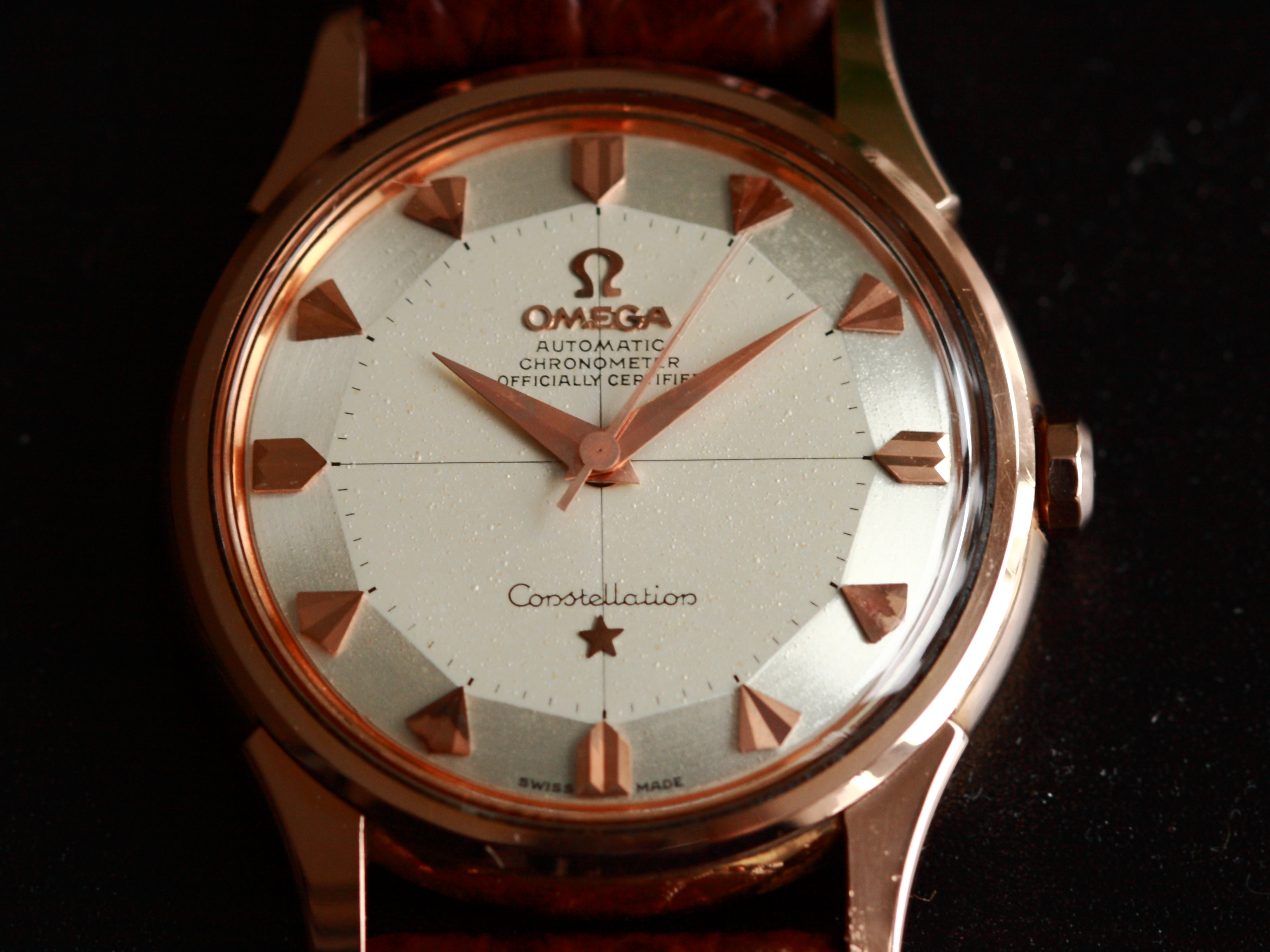

I'll bow to your greater knowledge of photography
But that C-case ad is a render
The shadows aren't correct
(Or at least the second hand was replaced with a shorter one after the photo was taken馃槈)
Not sure what you mean by render, but I'll stick with photograph and the shadows are correct for what can be seen on the dial resulted from a point light source (It can be seen that there are more than one light source).
There's another image of the same watch, even though it looks less natural, but it was due to printing and still is a photograph (that,s been "shopped" a bit)馃榾

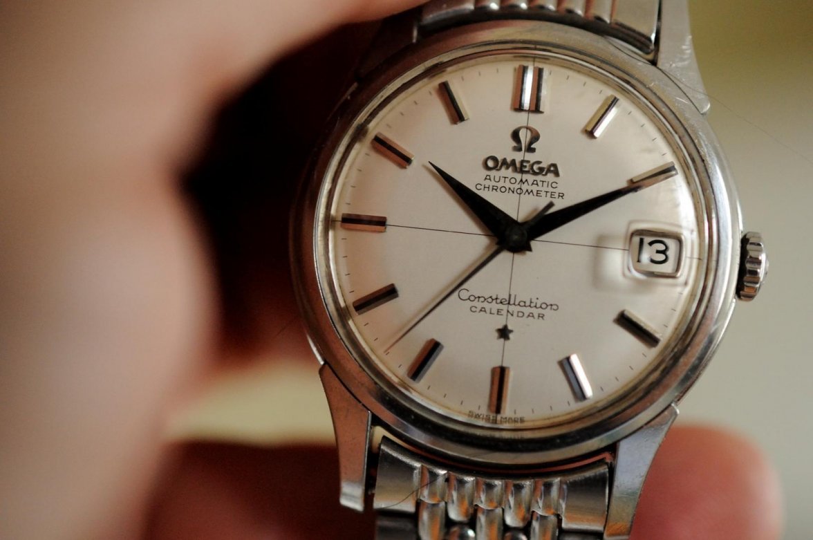

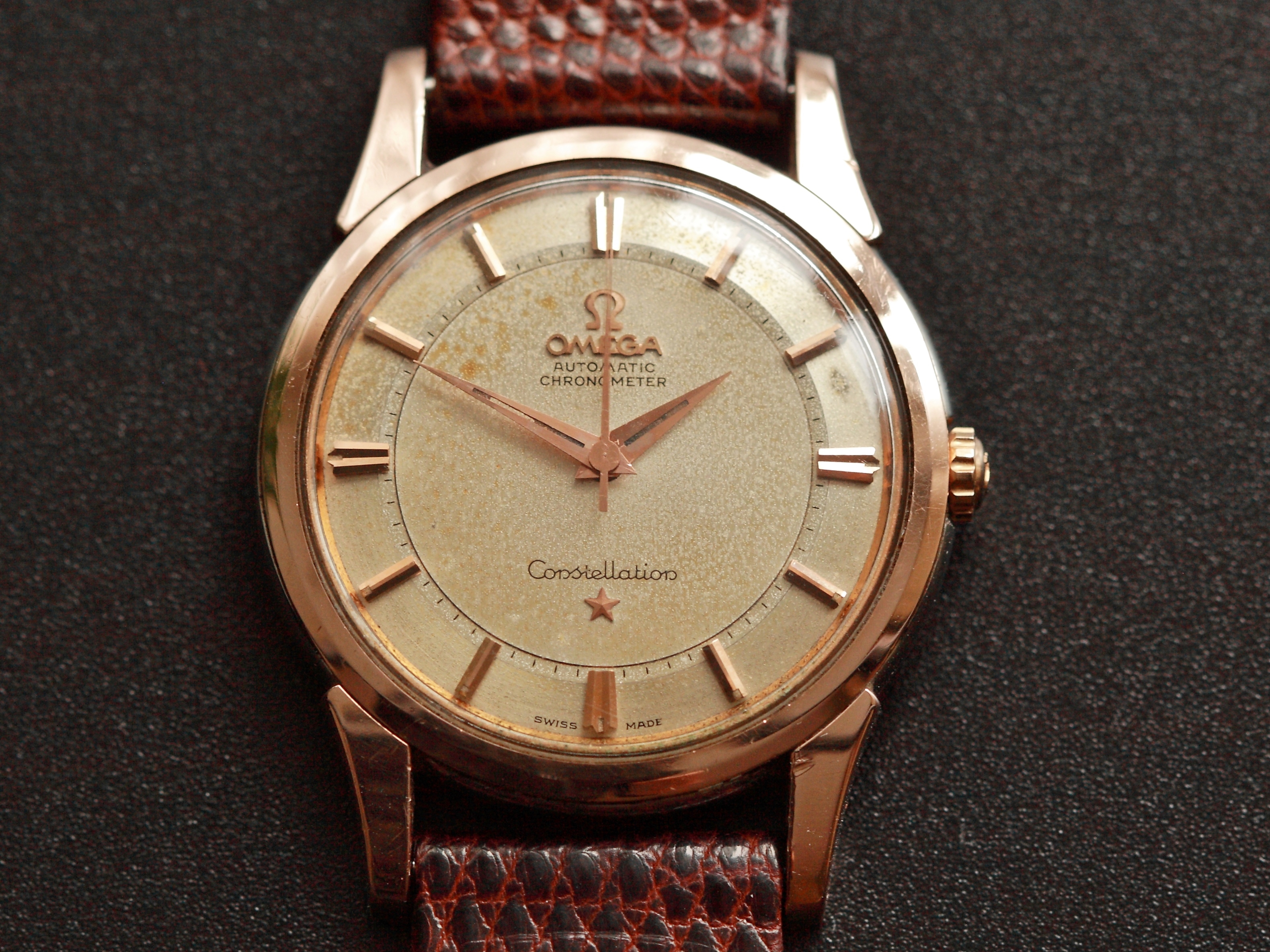

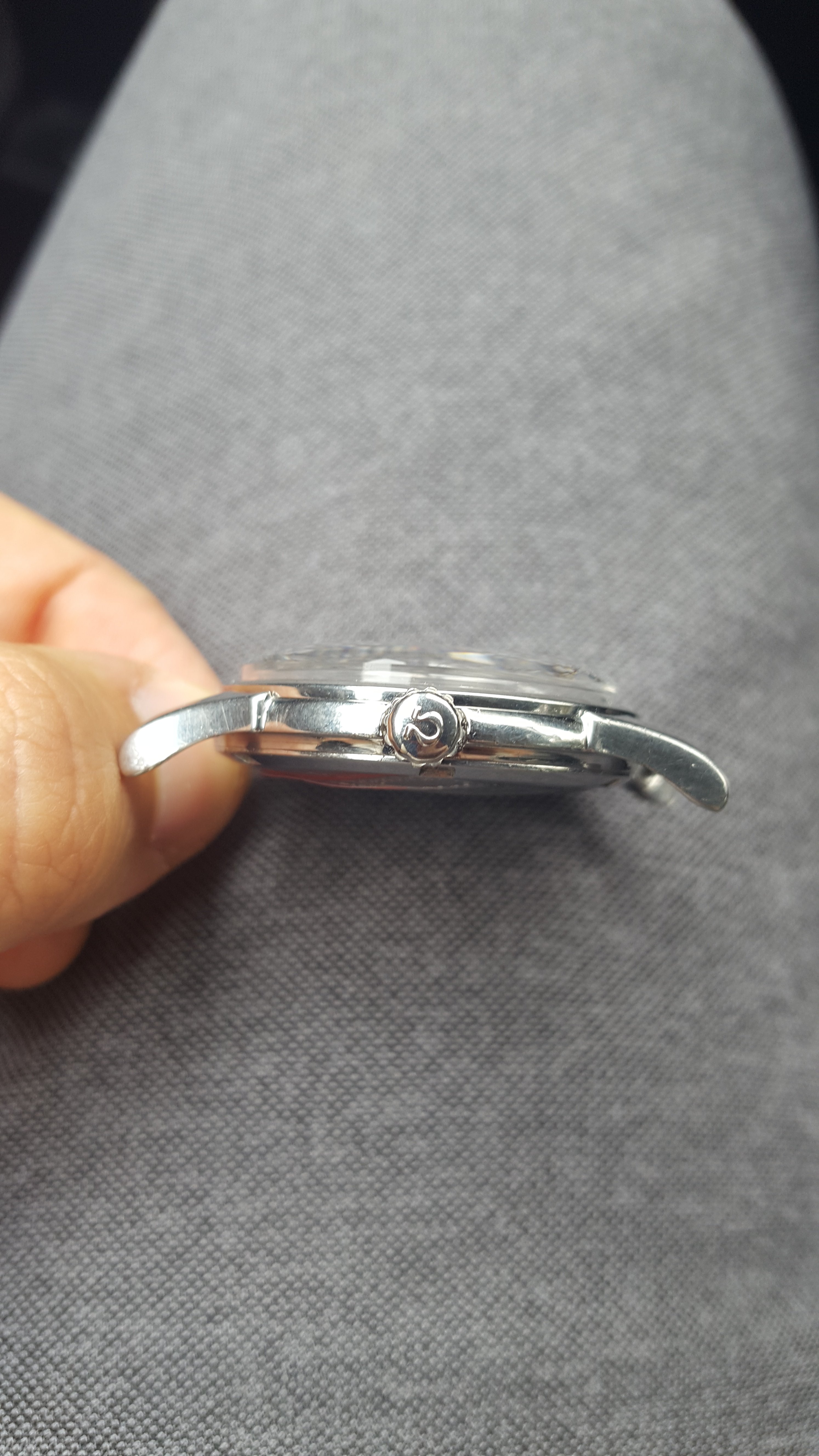

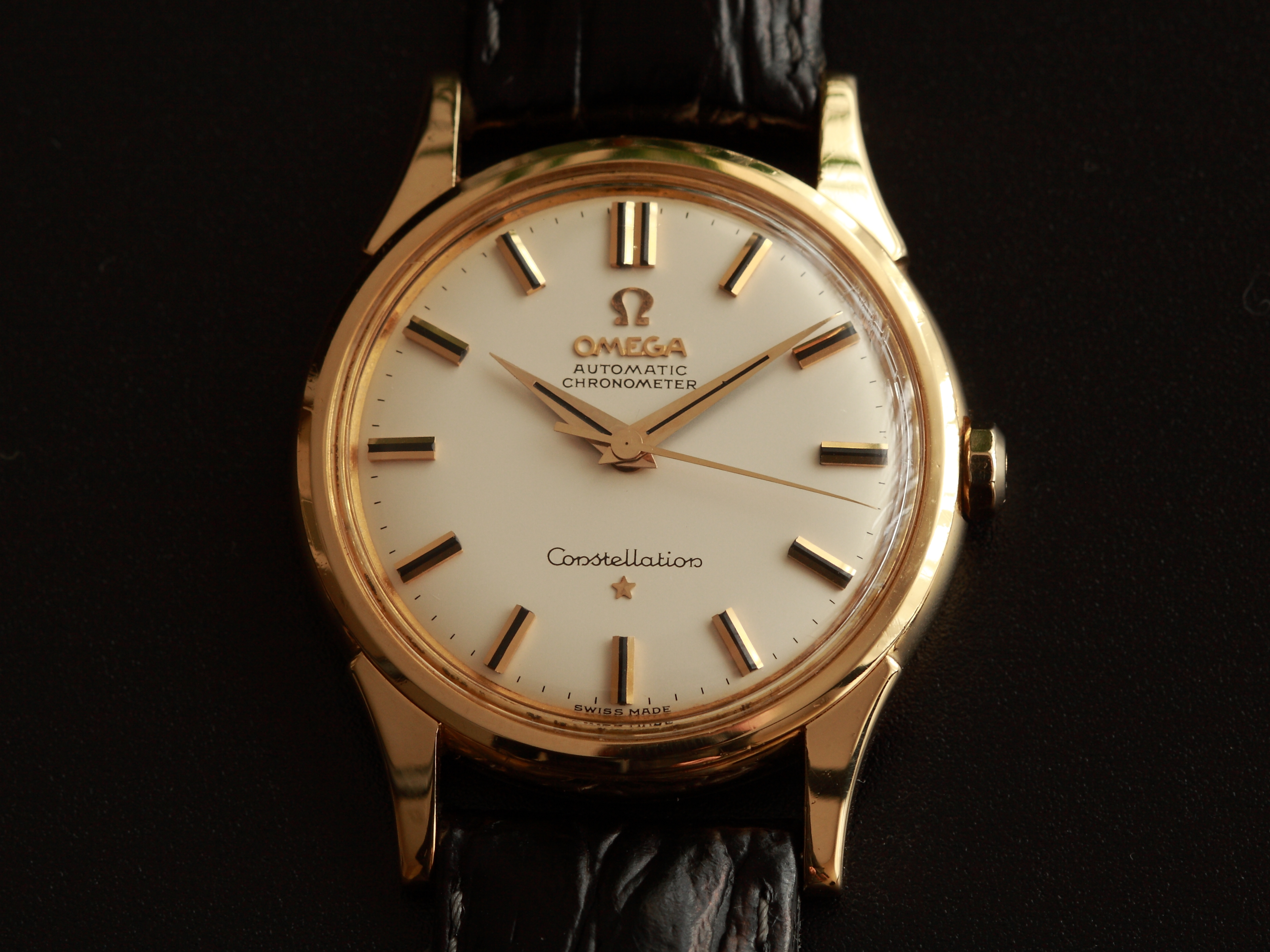

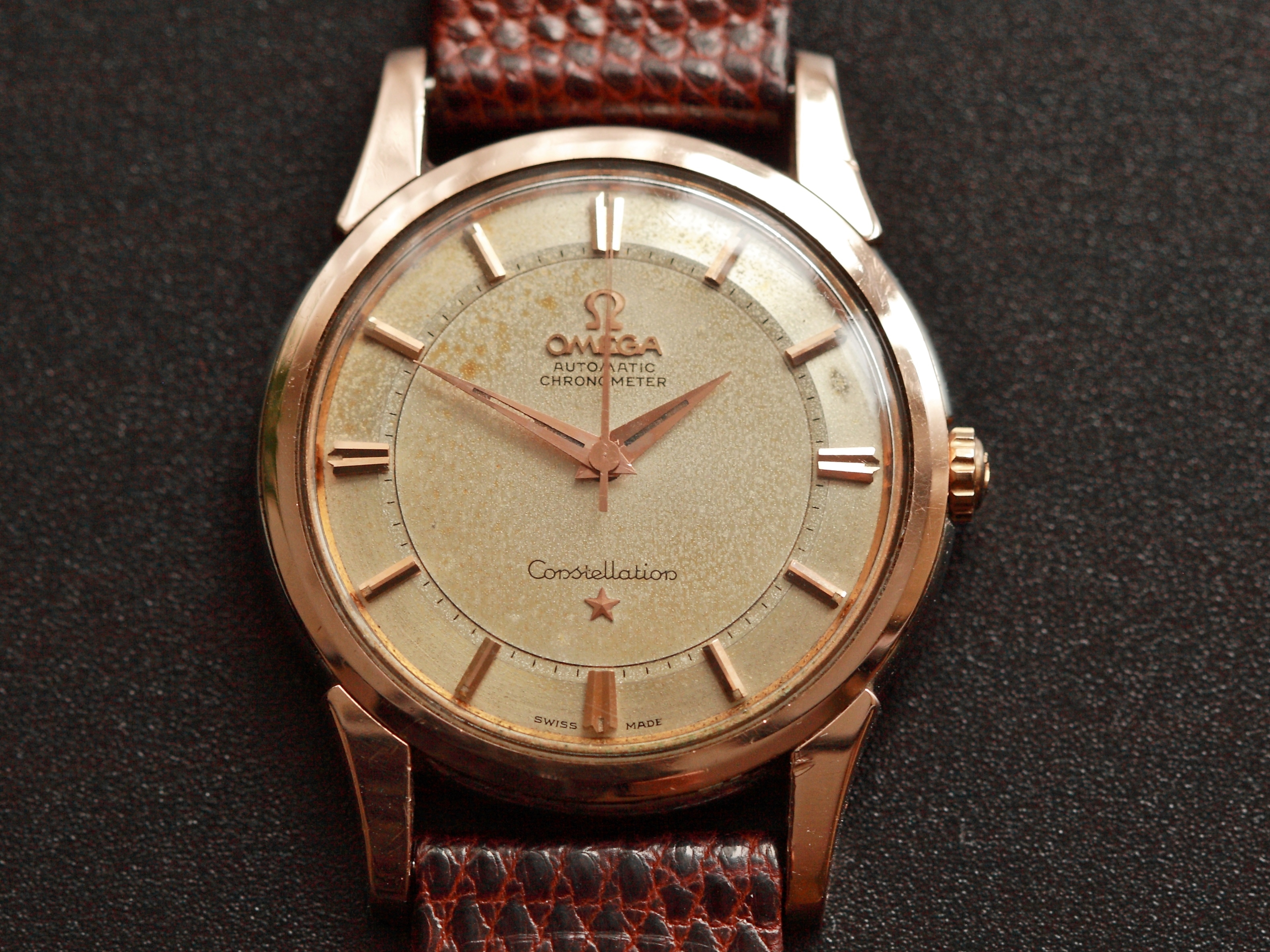

I've seen 14381's with what were IMHO original crowns of both types, so in my mind both the scalloped crown and the decagonal were meant for the 14xxx ref's.
The slim decagonal's that I've had on 14381's were well aged with wear to the plating and the old logo, which makes me think these were the original fitted crowns. I say that after comparing the wear to other late 1950's/early 1960's dress watch crowns which I feel are original and period correct.
I don't know where these 3 watches were originally sold but the two lowest I bought from family of the original owners here in Europe. All are long gone from my collection now. ( YG dome now resides with @dougiedude )

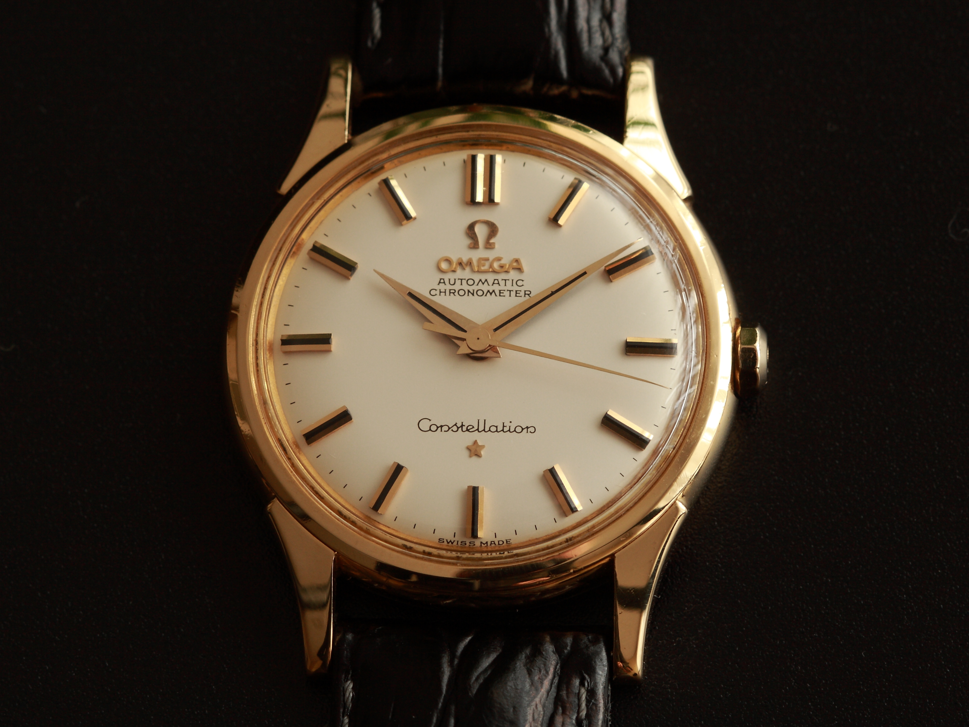

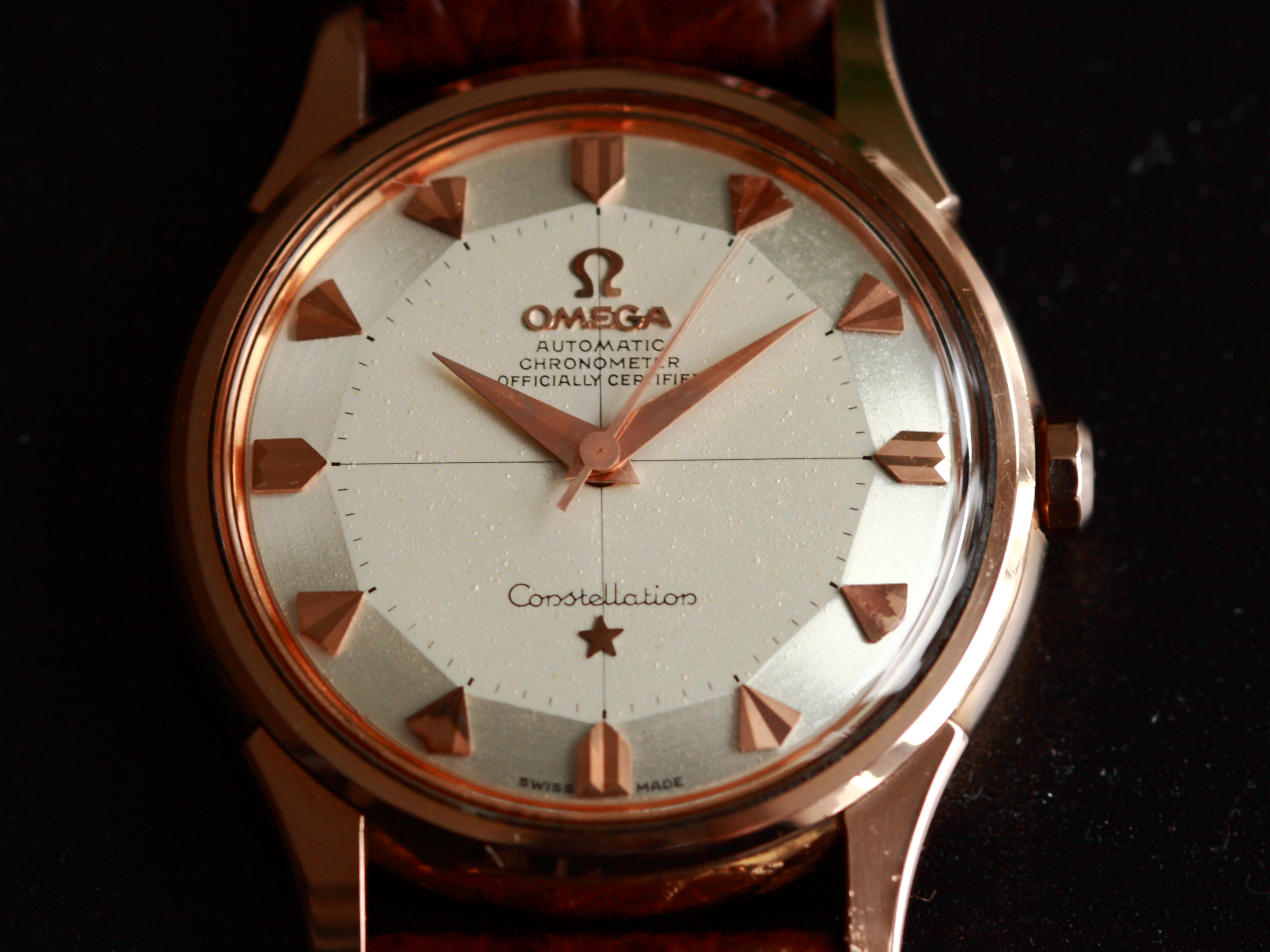

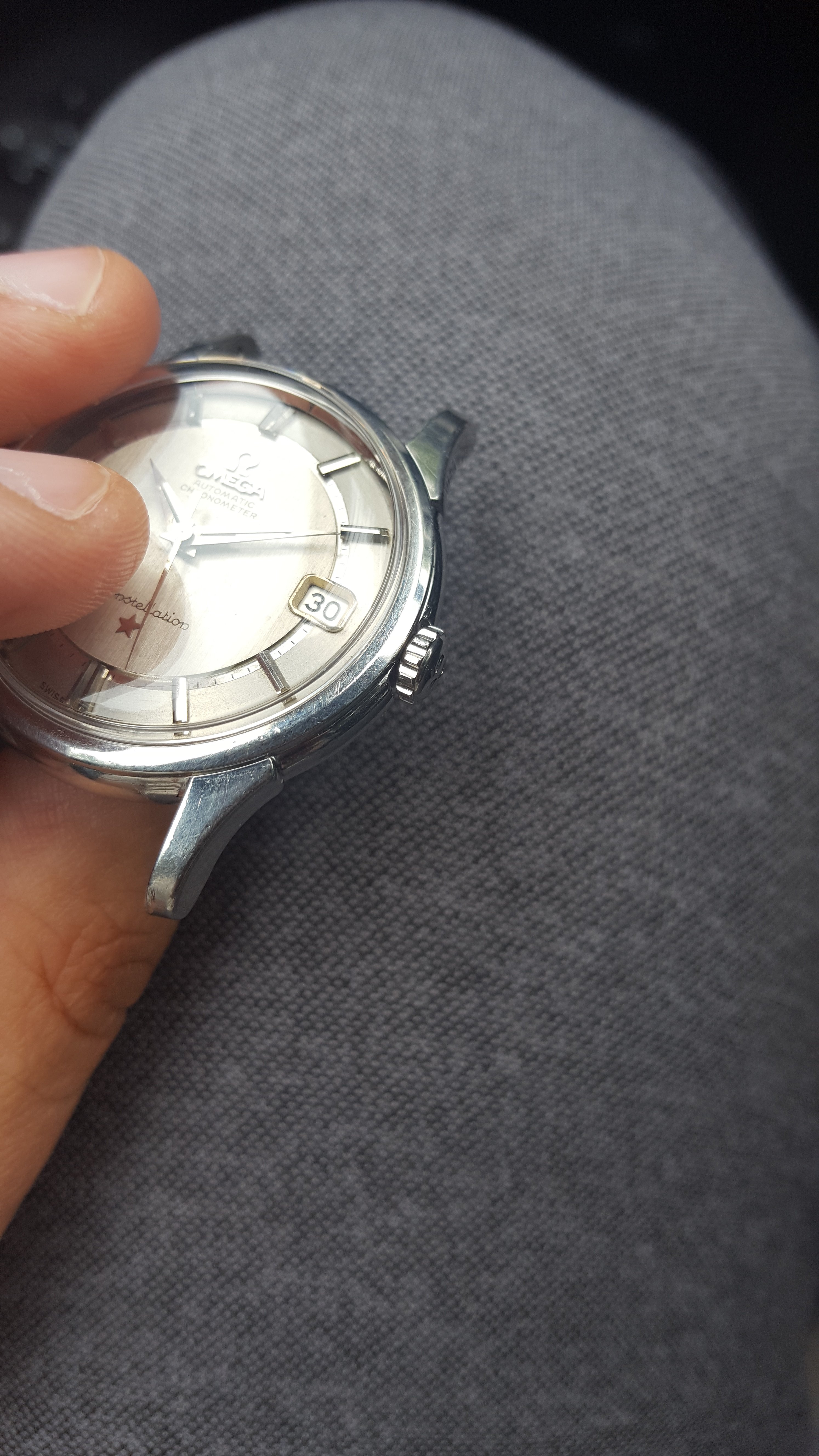

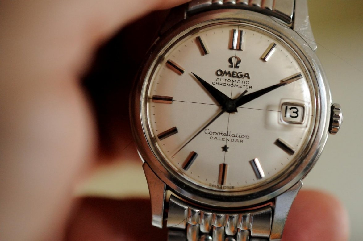

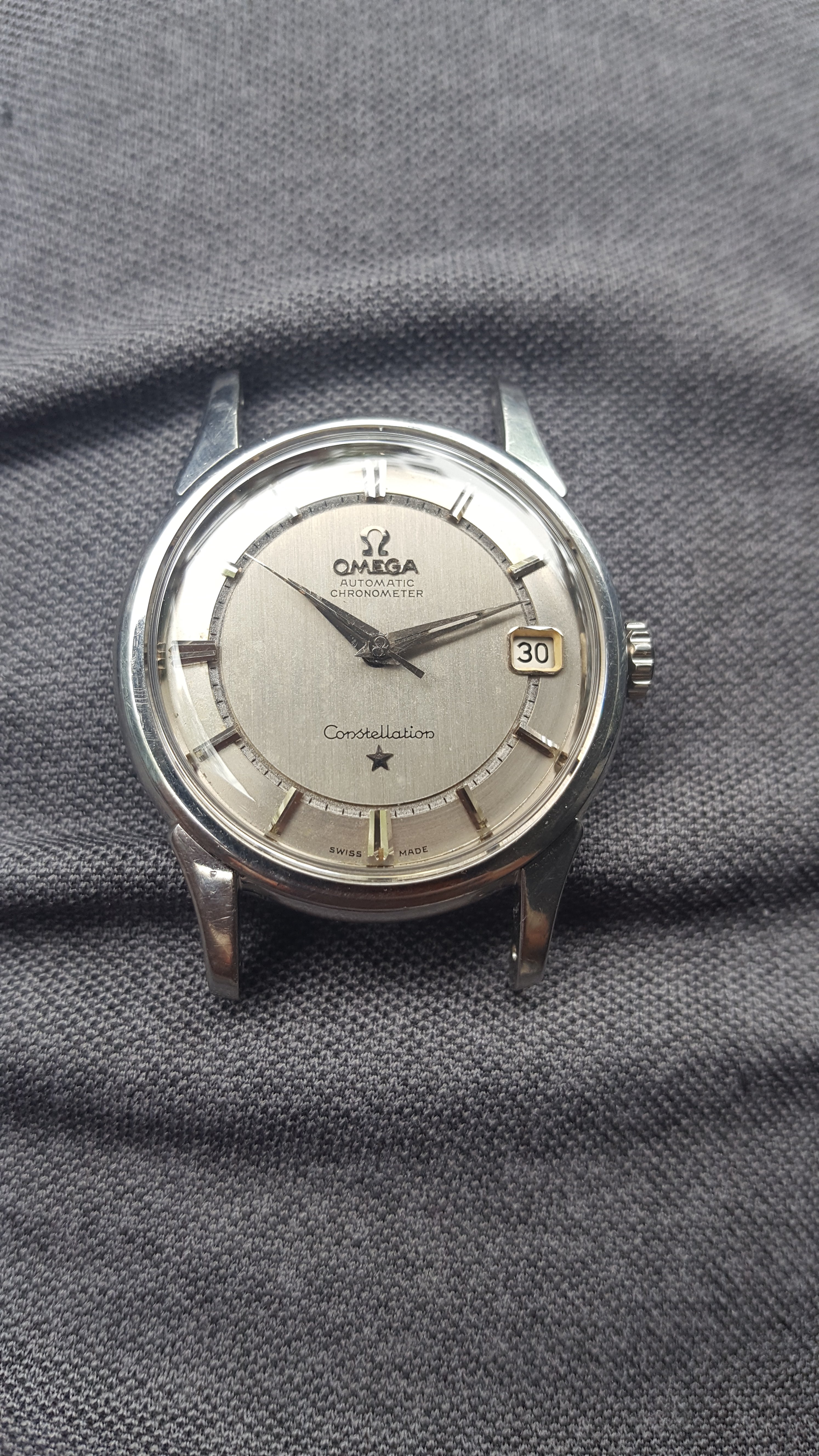

hello my first post here
just my 14381 with a scalloped crowns
Hello and welcome. Your Constellation looks great - love the rose gold dial furniture 馃榾
there will always someone who wants to dick around with perfection 馃榾

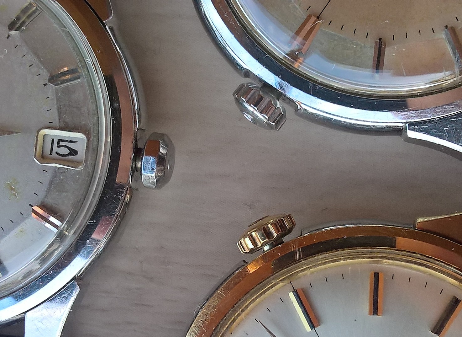

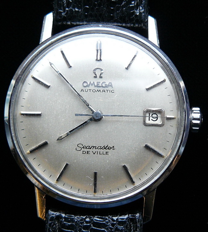

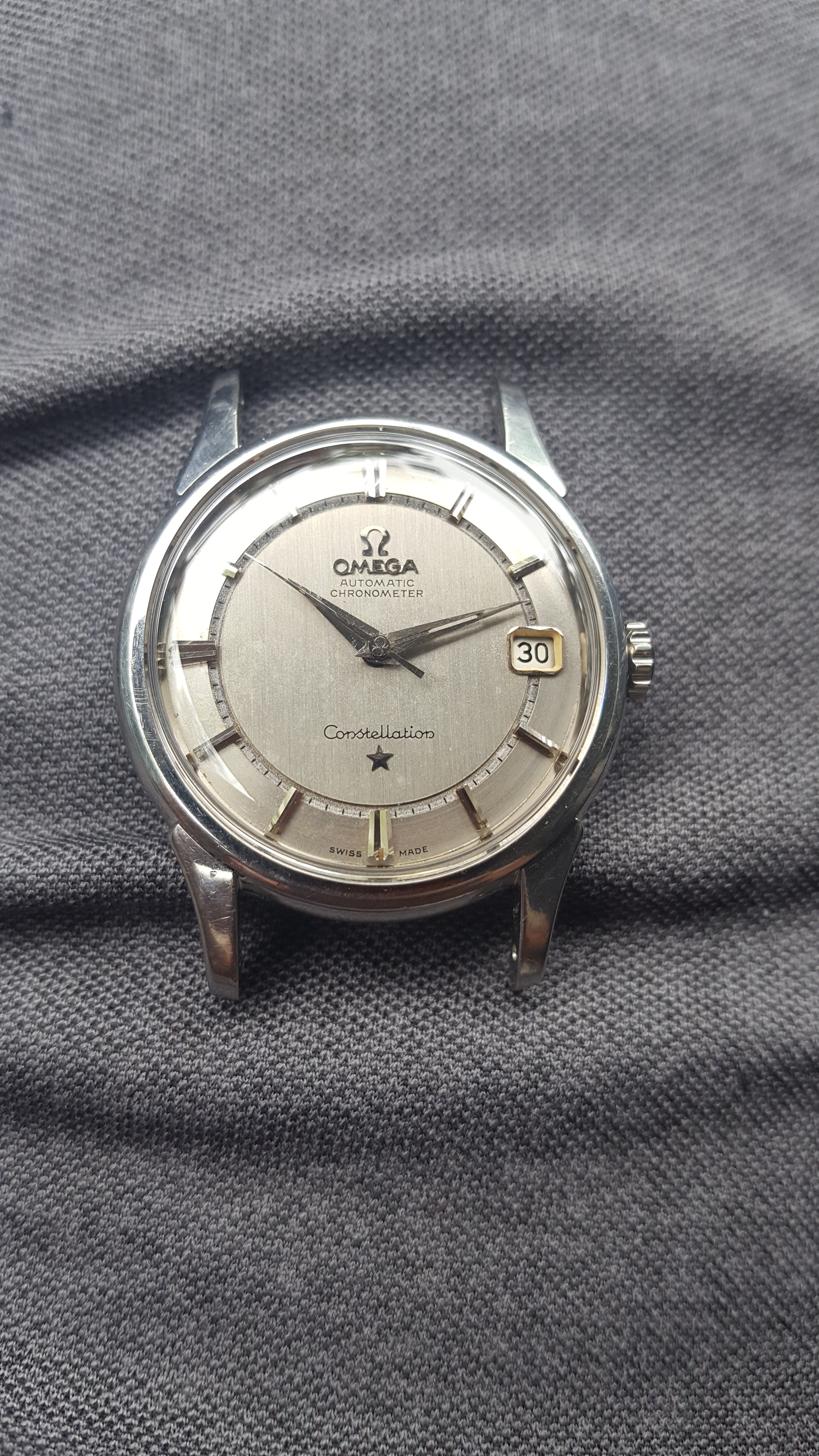

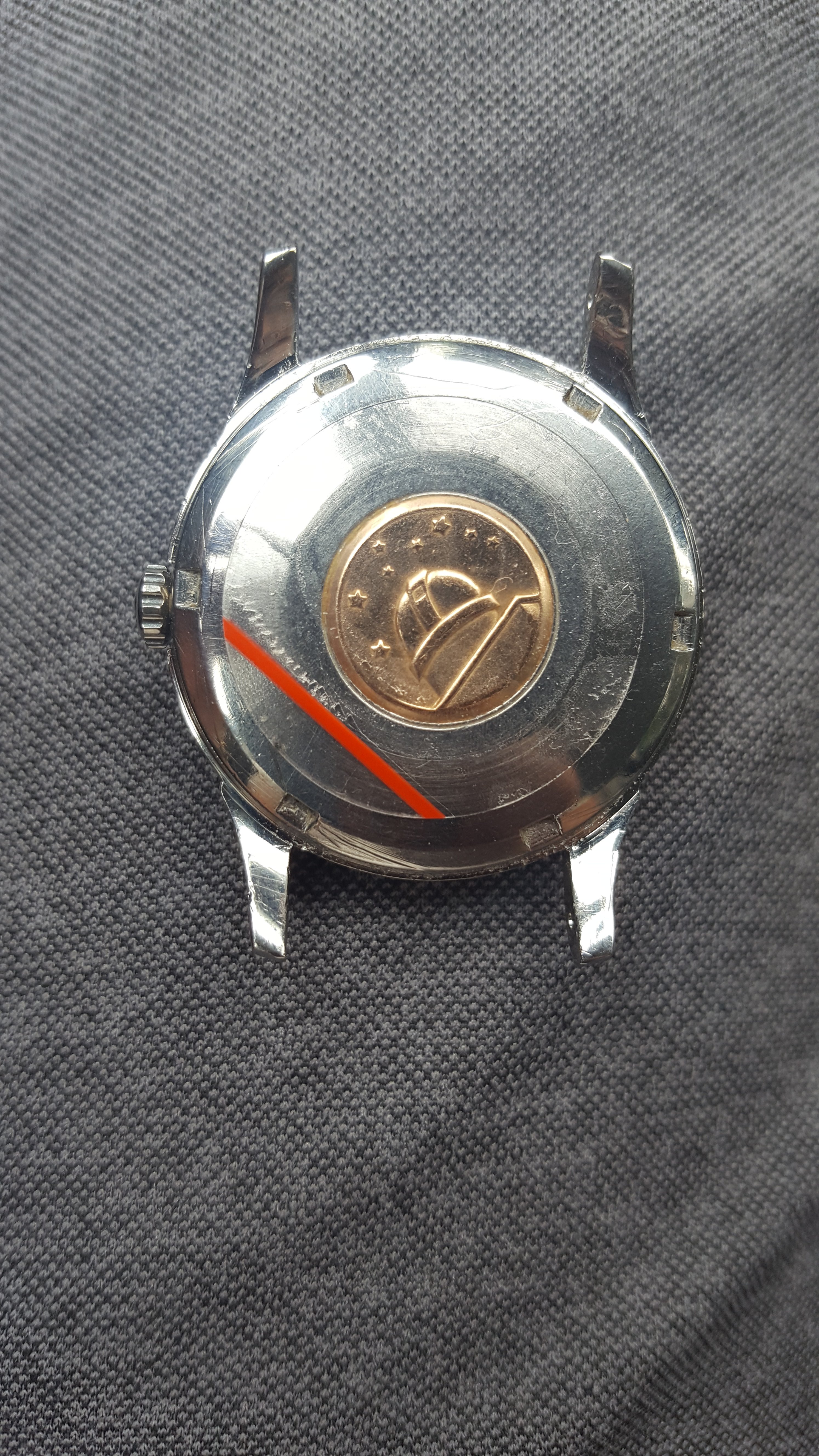

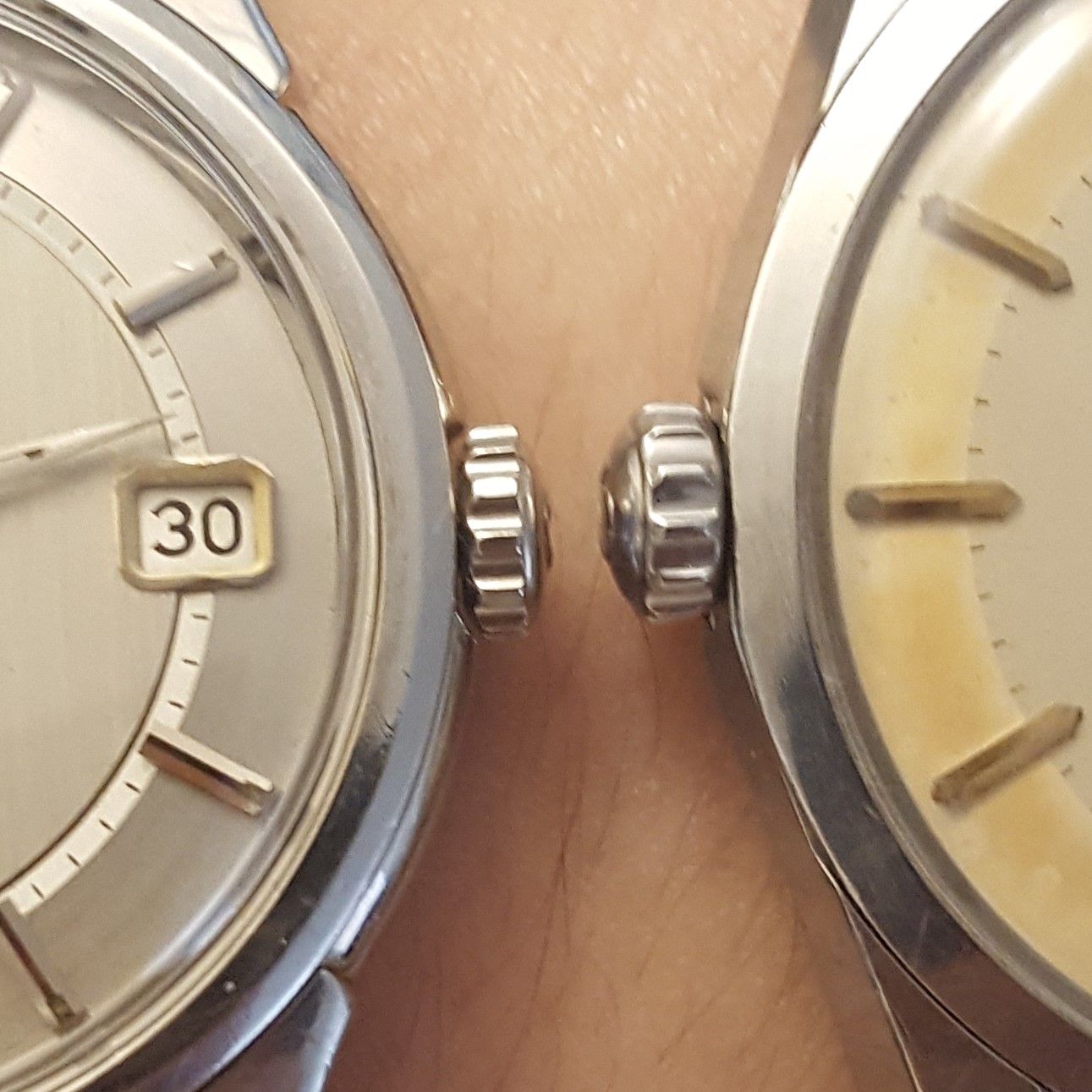

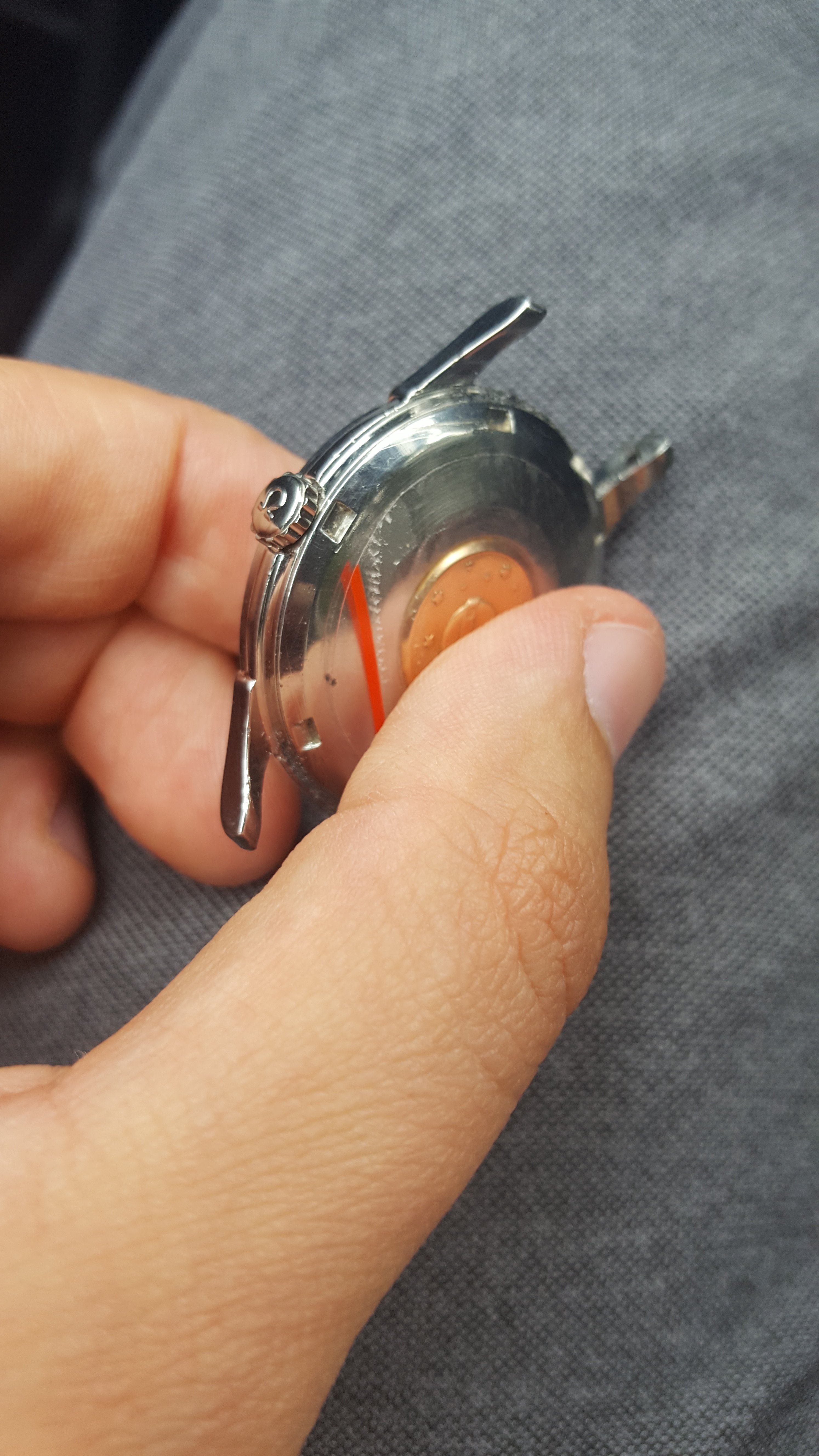

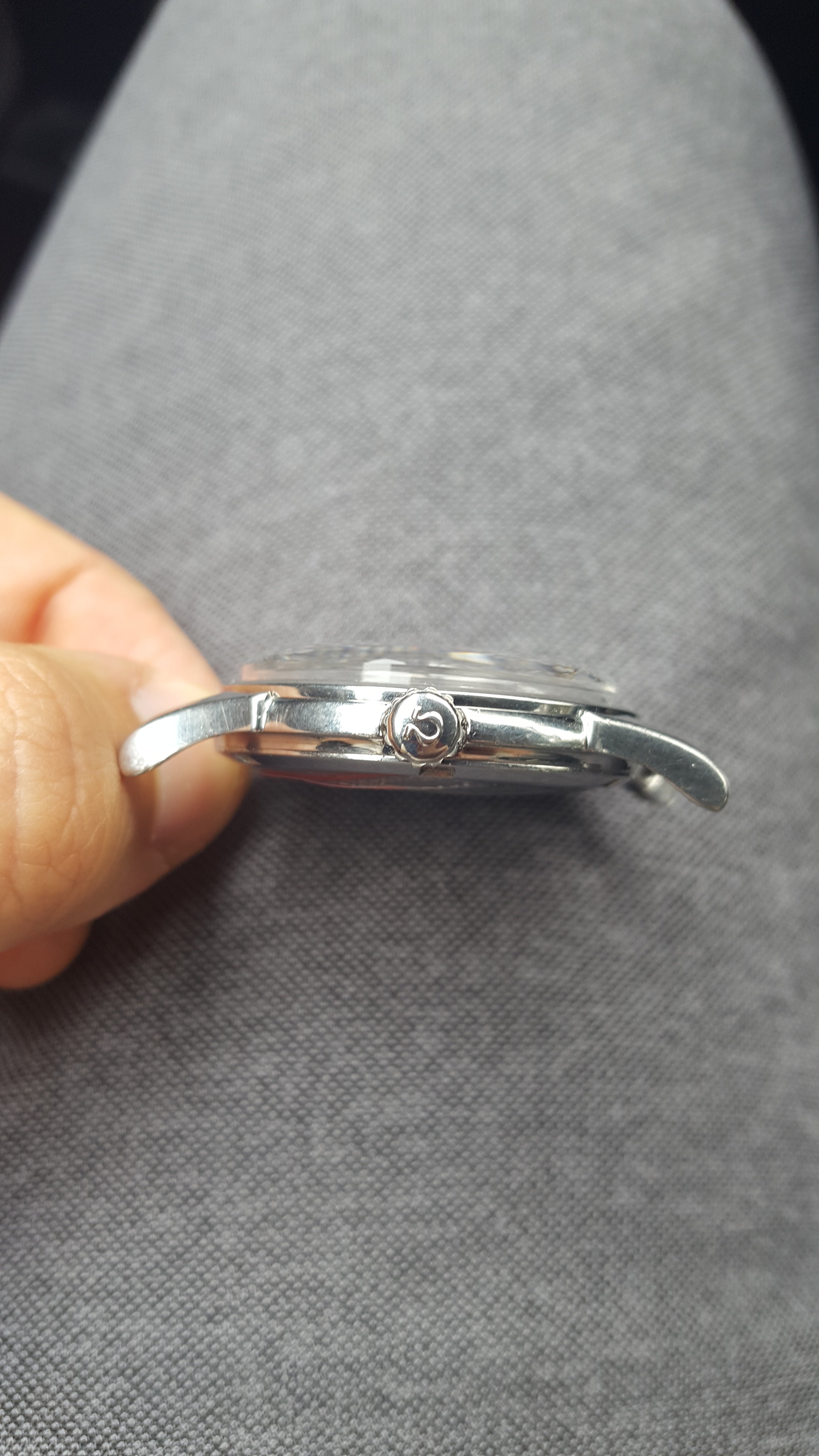

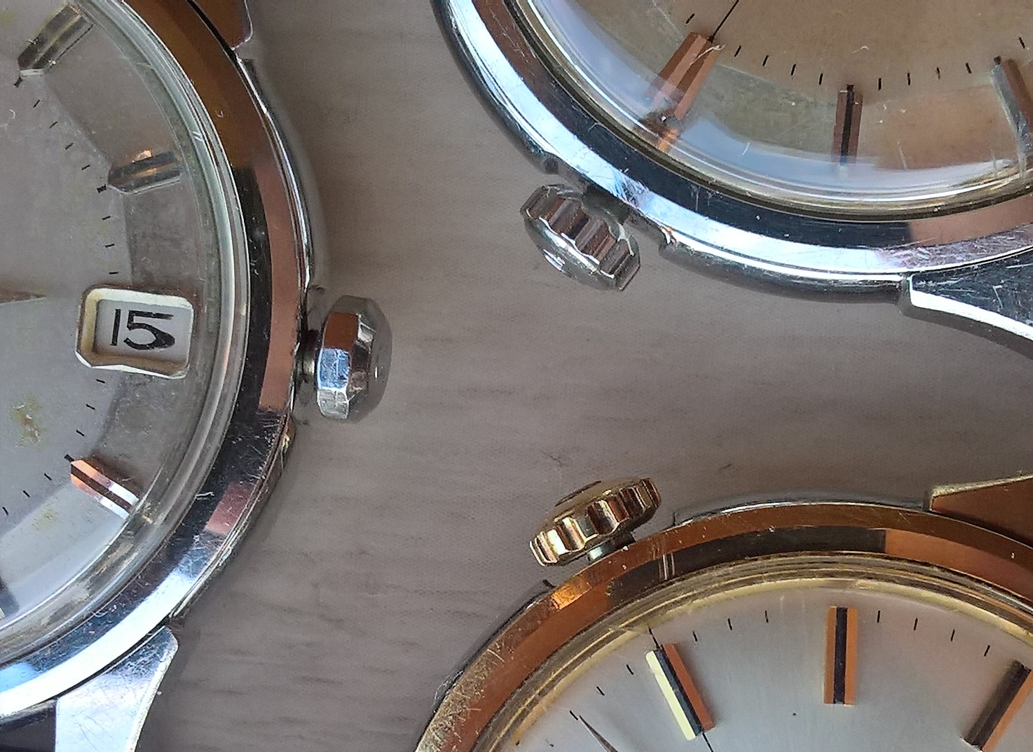

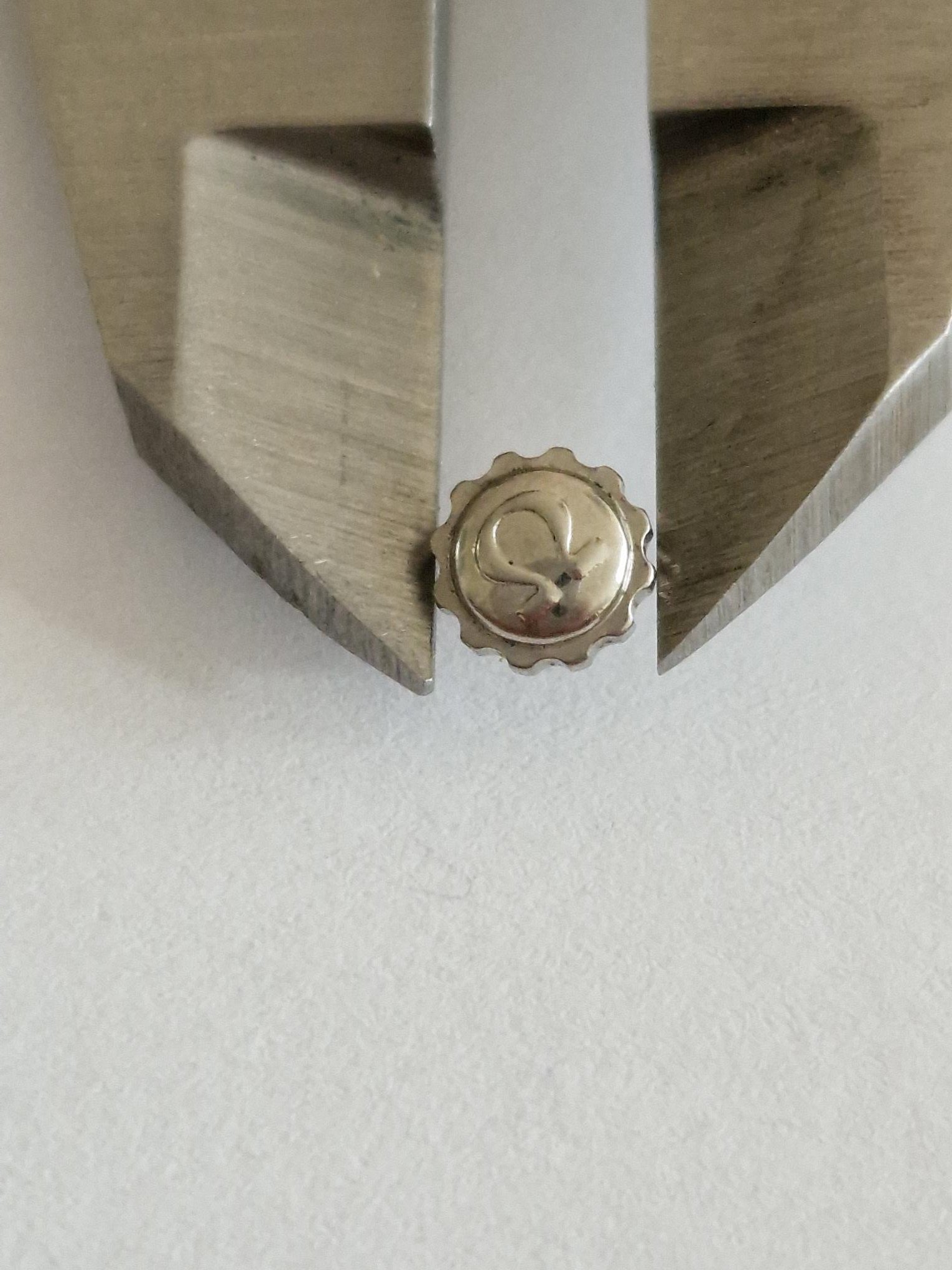

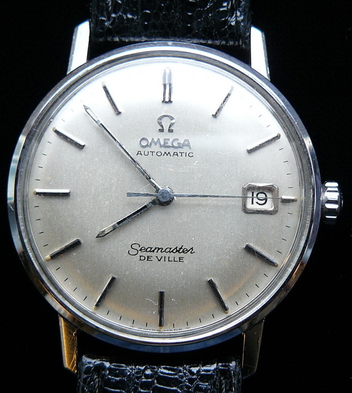

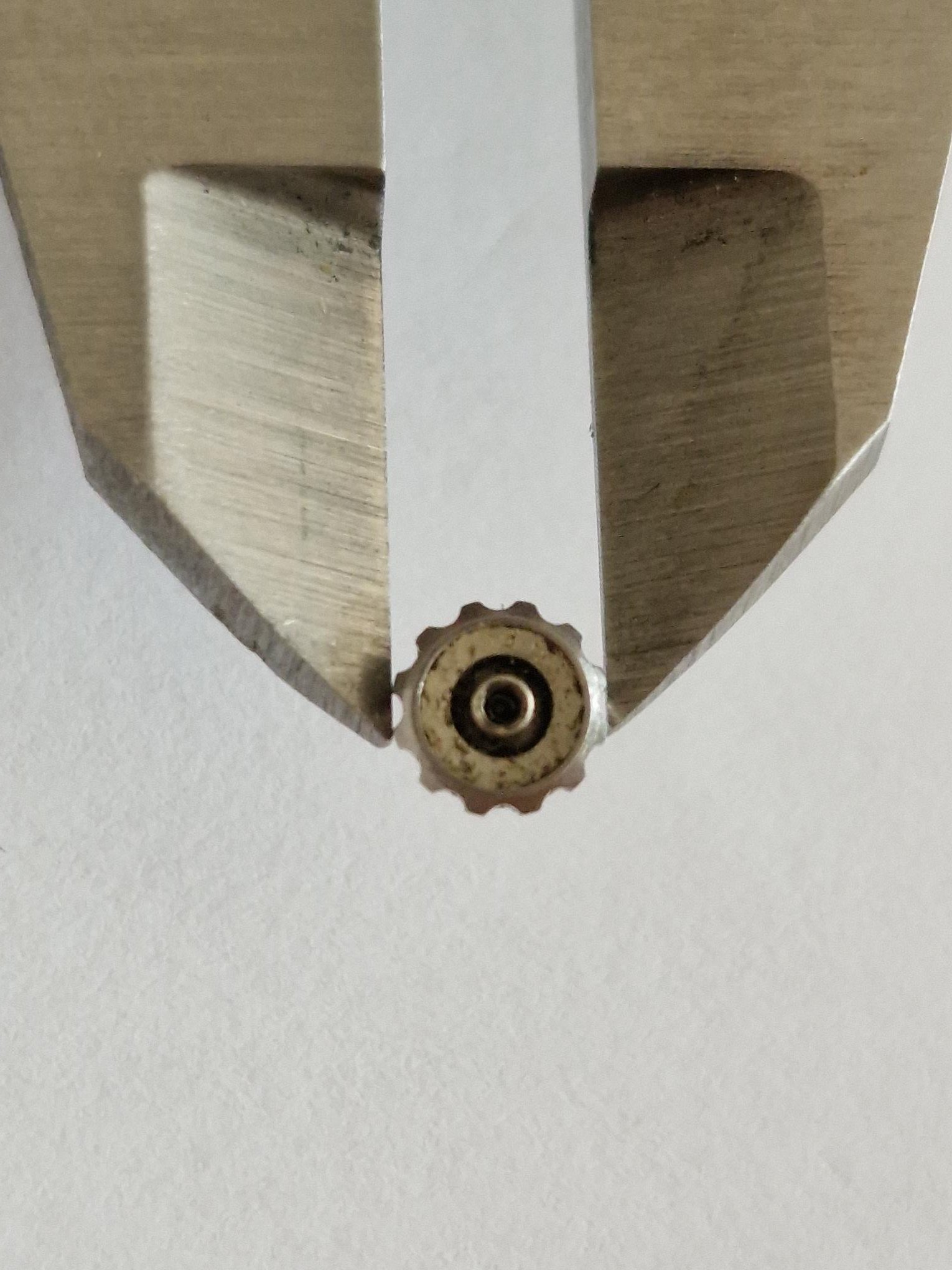

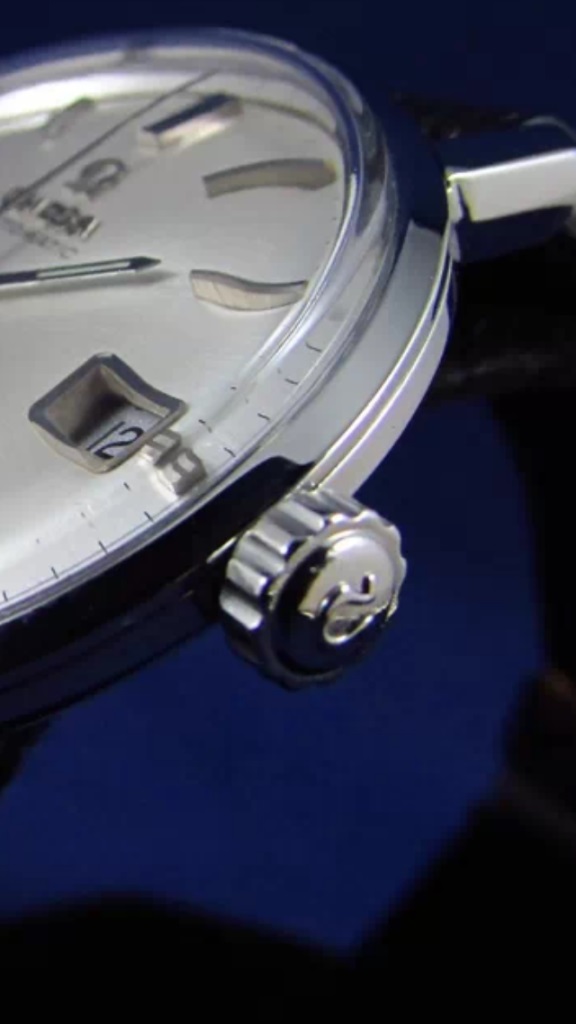

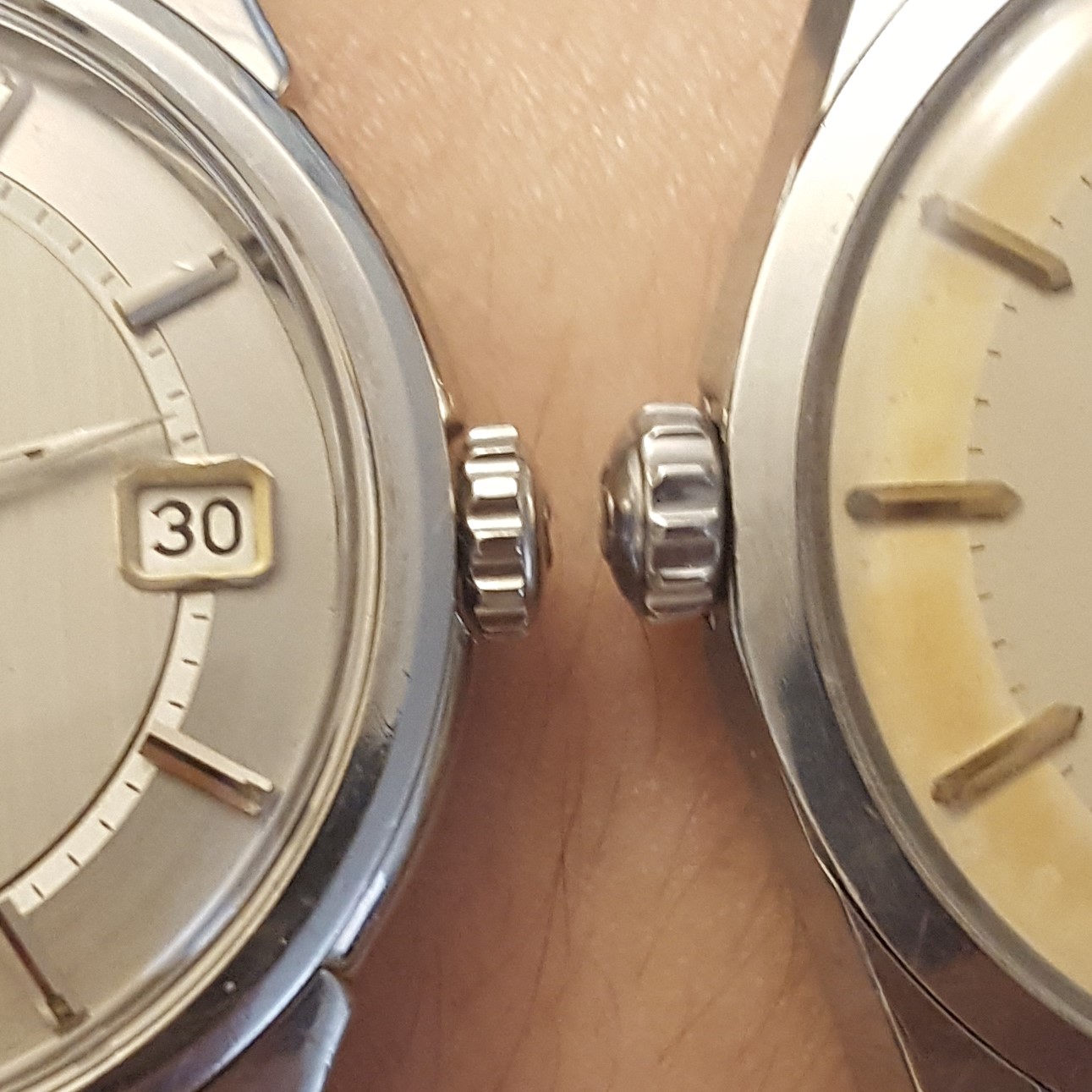

So I've been using this thread as a constant reference for a 14393 I just bought that had an incorrect and unsightly crown. Believe it or not, I've come in contact with three different 12 sided scalloped crowns (of course there may be more), and I think only one of them is correct for the 14.XXX watches. @ConElPueblo's work has been extremely helpful in navigating the process and I am really grateful to him for his research efforts.
The most noticeably incorrect of the scallops is from the 36mm manual wind watches. For reference, here is my 2639 with a scalloped crown that measures in at 5.33-5.5mm depending on how you catch the knurls (which makes a difference for measurement). It is also tall but I have not measured. Given that the tubes and tap size may not even line up with the 14XXX, you may not even be able to install it. Pictures:
The next (IMO incorrect) crown would be the scalloped crown more commonly seen on the 166.020 seamaster deville. Noticeably it has a more pronounced distinction between the middle part to the scallops (if that makes sense). It is only 4.85mm wide and a bit taller than the correct scalloped crown that the difference can be seen:

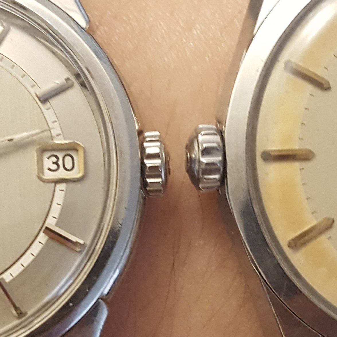

Finally, our correct crown, the thin profile and scalloped crown. I've found in my search that depending on where the calipers catch it can be between 5.22-5.3mm. It is flatter than the other 2 and can be seen in a comparison from @ConElPueblo's 3 watches as examples. I'm also showing a side by side with the 2639.
@ahsposo's 14XXX which he posted in this thread:
a profile shot from another watch:
The group shot from @ConElPueblo's post elsewhere:
and a comparison with the 2639:
Just trying to add to the body of research... I hope it's okay that I borrowed a lot of different pictures from here and the internet for my shots.

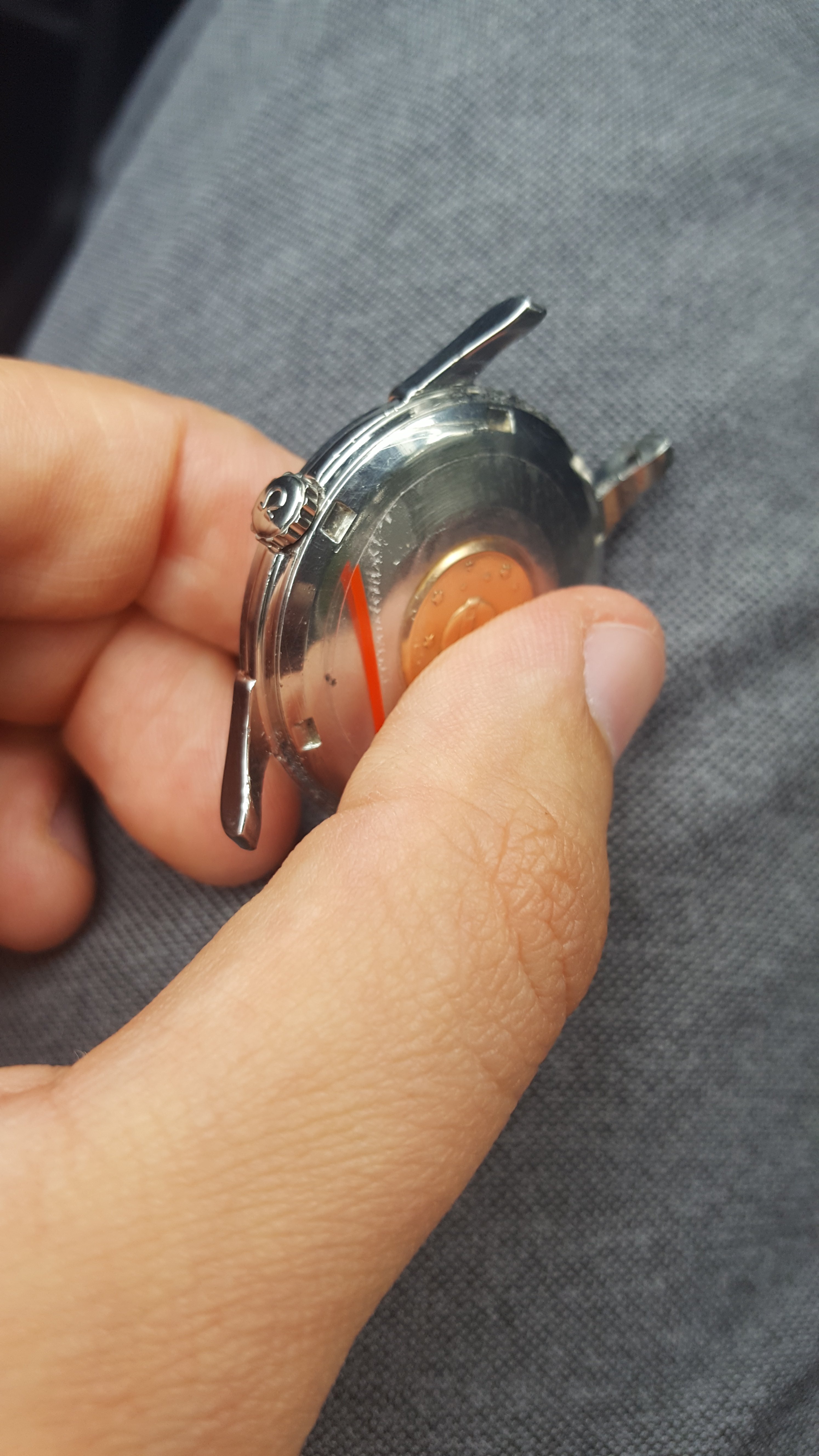

Here is my new-to-me 14393. It came with an unsightly crown. It had to go. I was able to source a correct replacement scalloped crown (miraculously) and in a rather short period of time (luckily). I also had a new OEM crystal fitted:
Again, much of this has been worked out by @ConElPueblo but I figured I could at least add the measurements and some closer pictures of incorrect ones. Of course this all assumes that you believe the scalloped crown could be original to the 14XXX series.

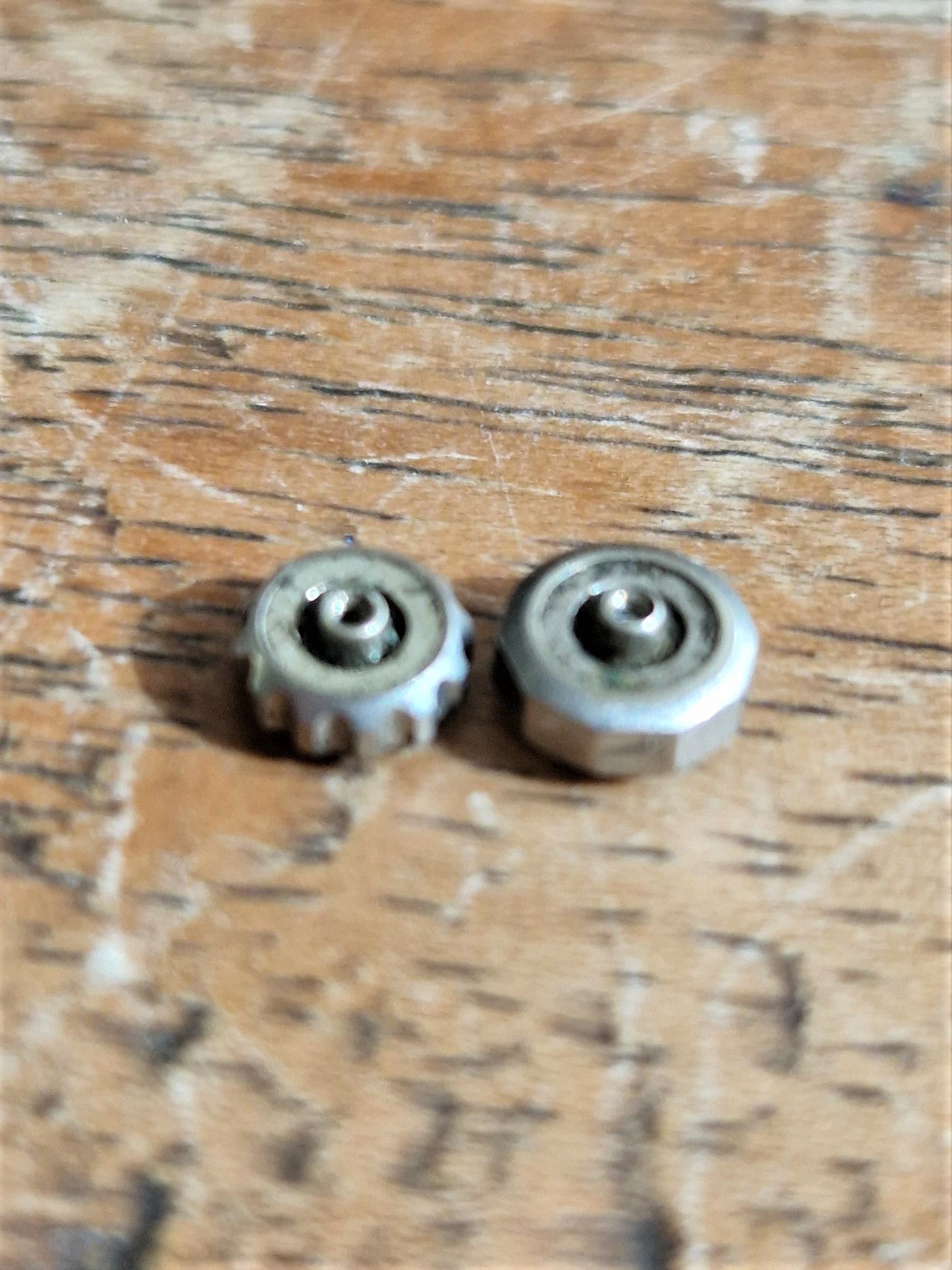

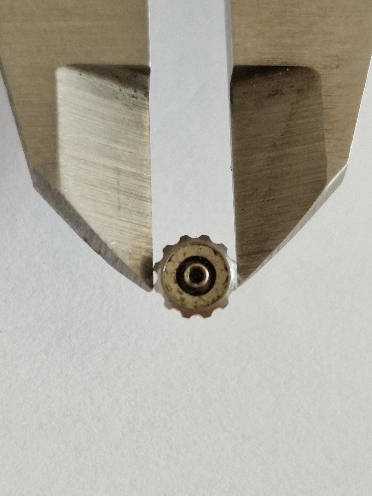

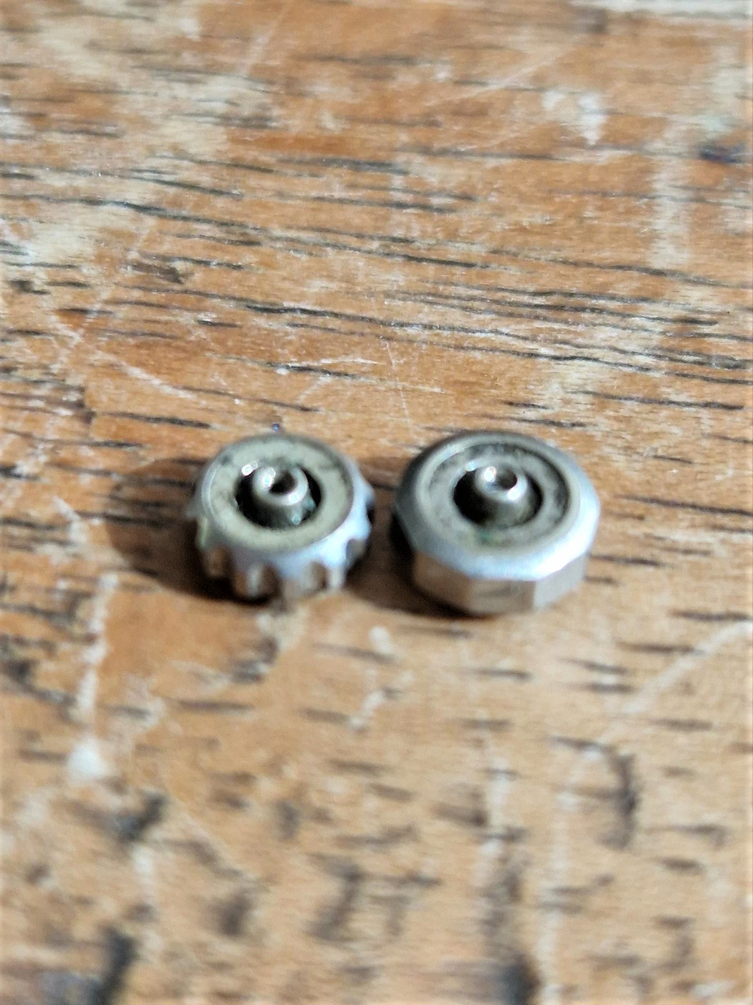

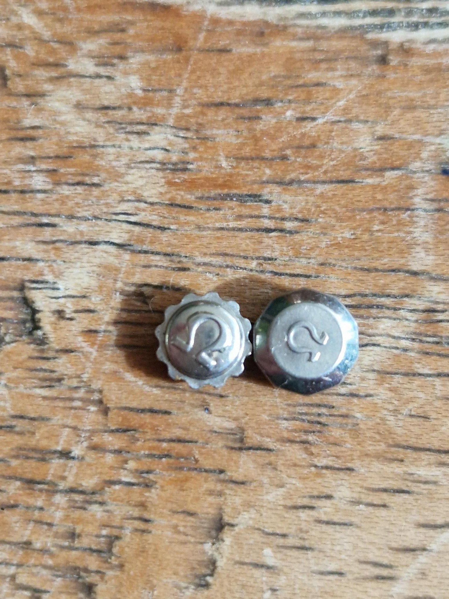

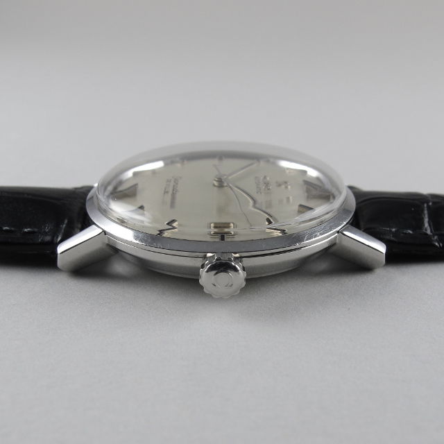

So I've just picked up some crowns and amongst them are these scallop crowns.
As some of the other crowns are the thin decagonal Constellation 4204's I was hopeful that these may be the scallop 4205's and also correct for the 143** series of Constellation references....but now I'm not so sure as after reading through this and a couple of other threads think they are too small.
Mine measure around 4.5mm diameter and 2.65 max height compared to the dimensions I find for the 4205 of 4.85mm diameter and 2,95mm height.
Does anybody have an idea what they are for?
