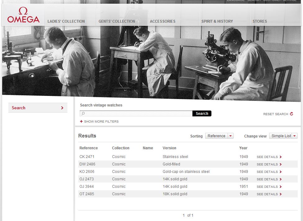

Any help with appropriate case and movement identifications? The catalogue just states Ref. 590 and 595.
Go here:
http://www.omegawatches.com/spirit/history/vintage-omegas/vintage-watches-database
Open up "Show more filters". Under Collection, choose "Cosmic" and under Functions, choose "Moonphase" (one word, not two). You should see something like this:
The reference numbers in the 1950 catalog I posted seem to be only for the Swiss market, or the specific retailer that produced that catalog. The ones above are what you will find on the inside of the casebacks, once you find one.
Good luck in your search, you're going to need it unless you're able to convince MSN to part with one of his.

I think your best bet is to find either a nice stainless steel ref. 2471 or a 14k/18k version of ref. 2473 if your budget allows it. For a nice 2471 you're talking about $2500 or so and add another $1k or more for a nice 2473. Of course if it is a very nice example with really clean dial and movement then expect to pay a premium for that.
