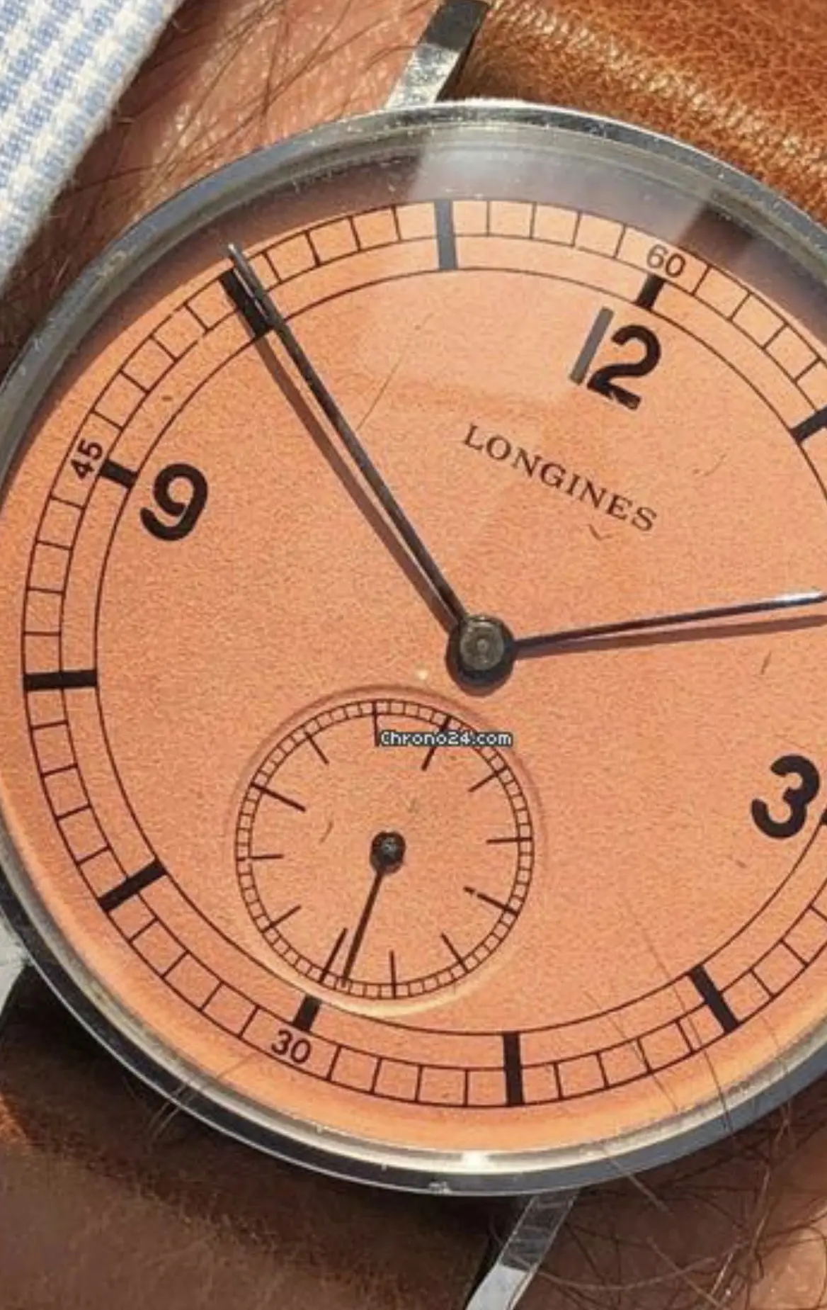

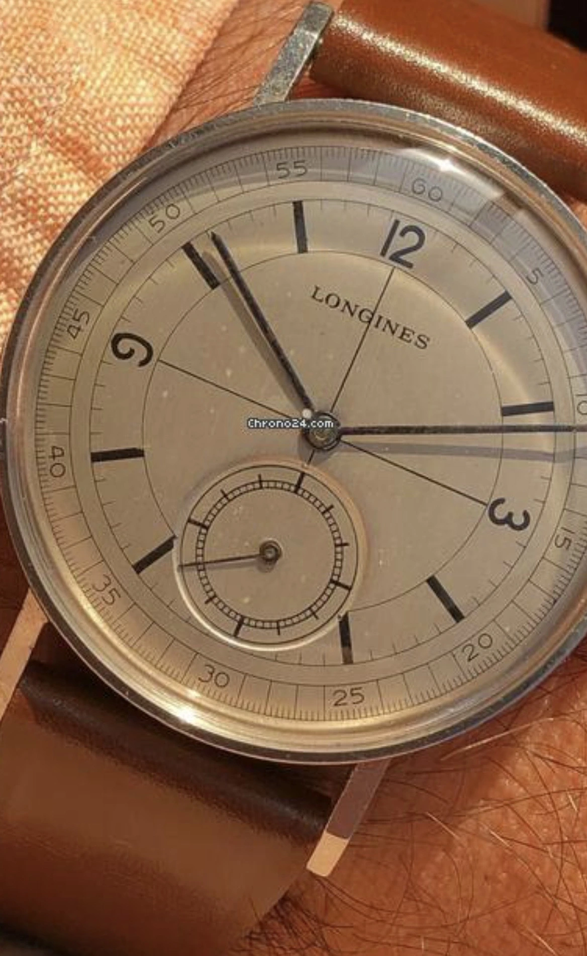

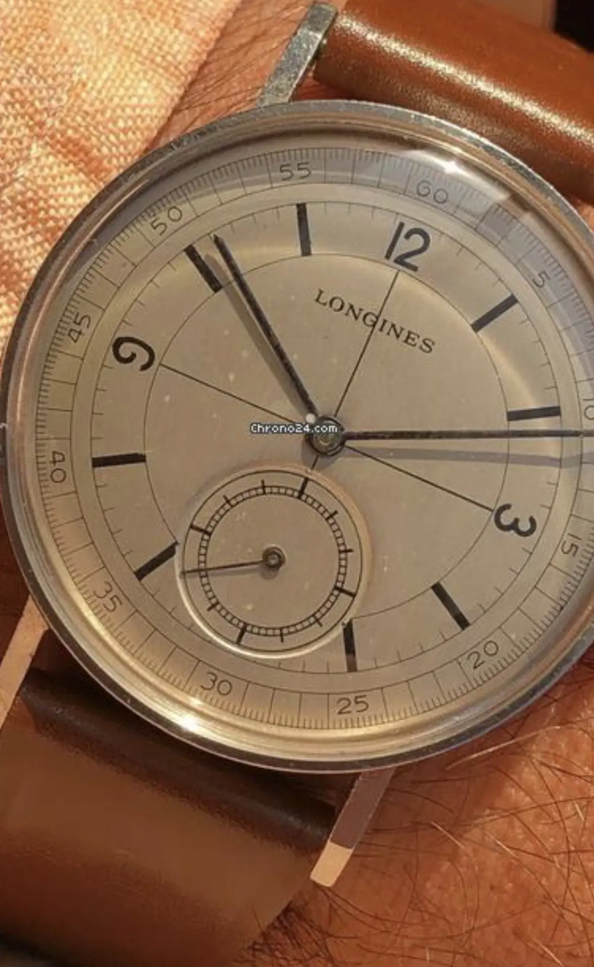

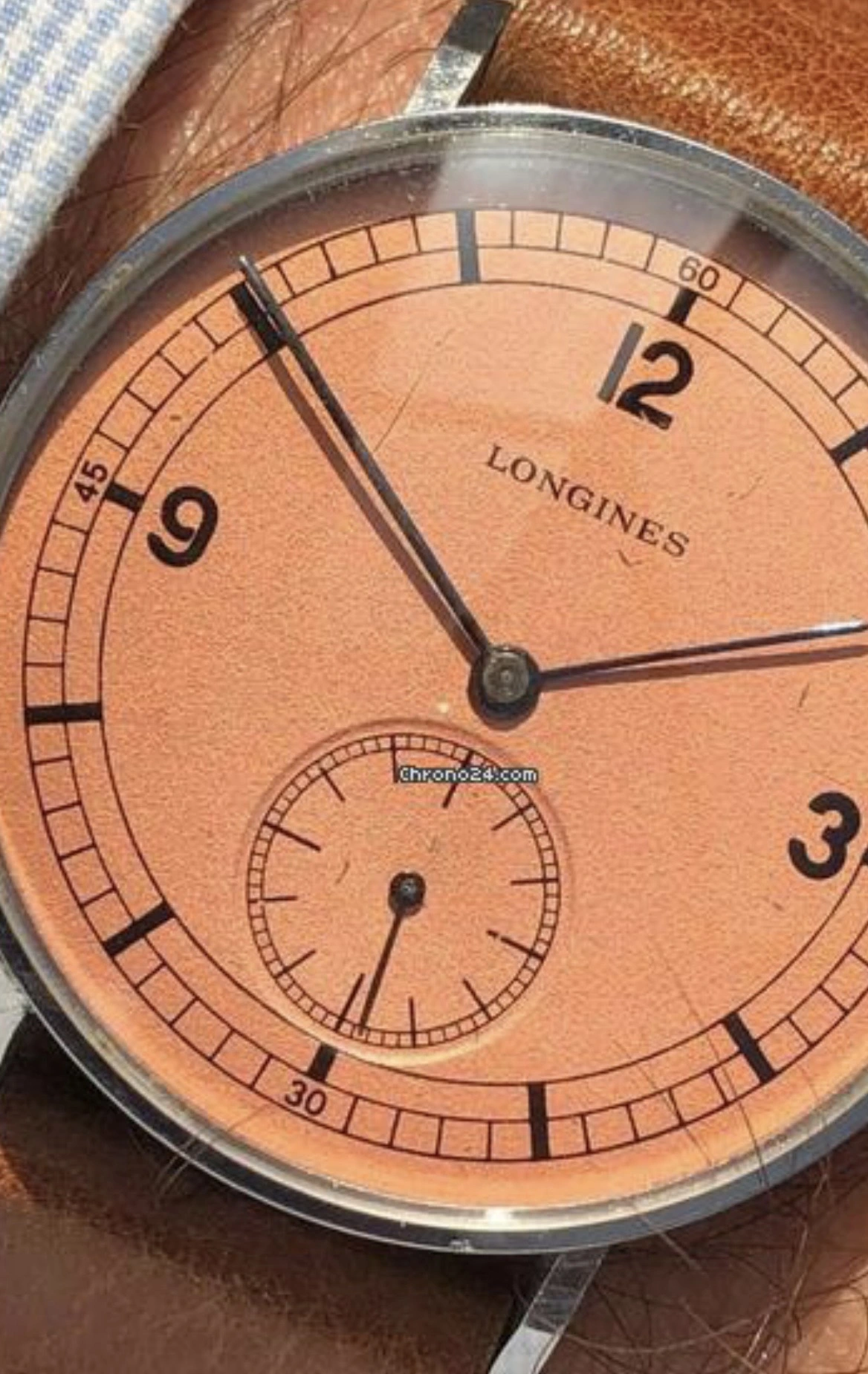

Browsing some Deco-era Longines on chrono24 and noticed that, in addition to these two watches having rather pristine dials, they also lack "Swiss, Swiss made....etc" at the bottom of the dial.
Just trying to learn. Am I looking at redialed watches here?
266
324
Yes; both of these are redials in my opinion.
Man. Can't trust anyone! Nowhere does it say they are redialed.
Thank you!

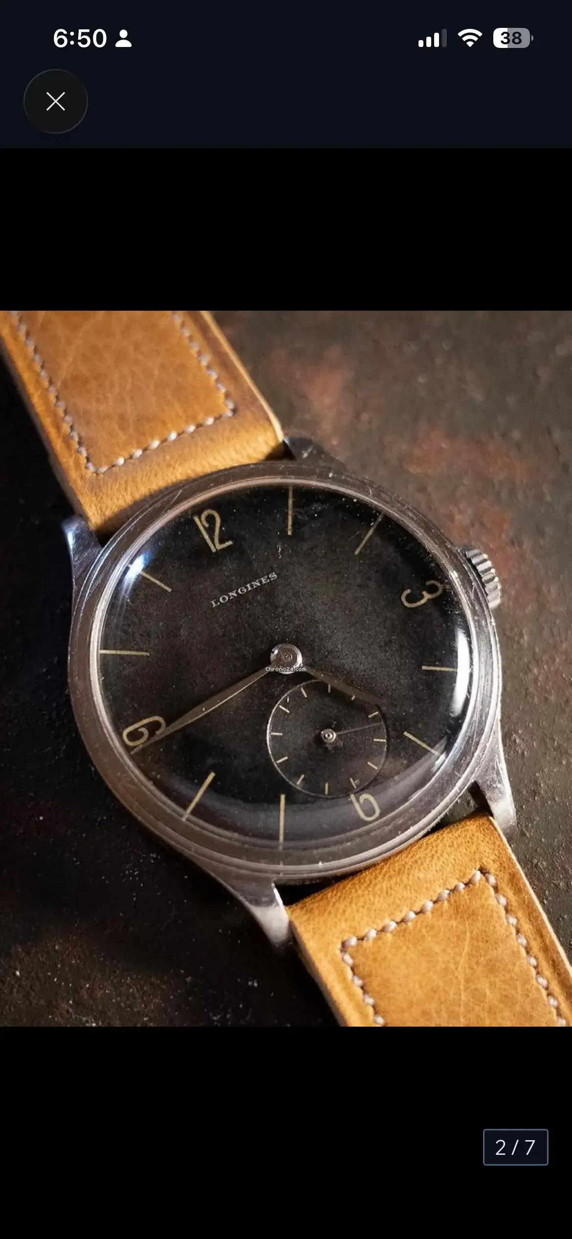

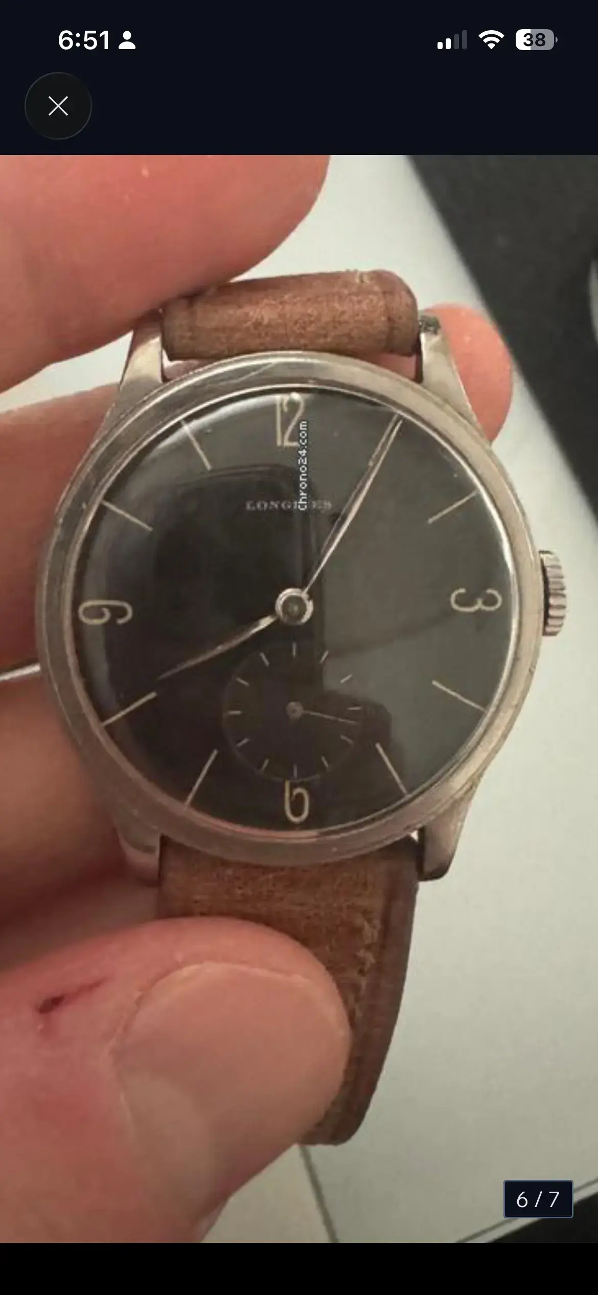

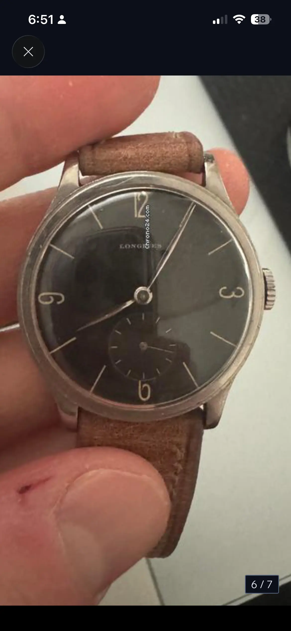

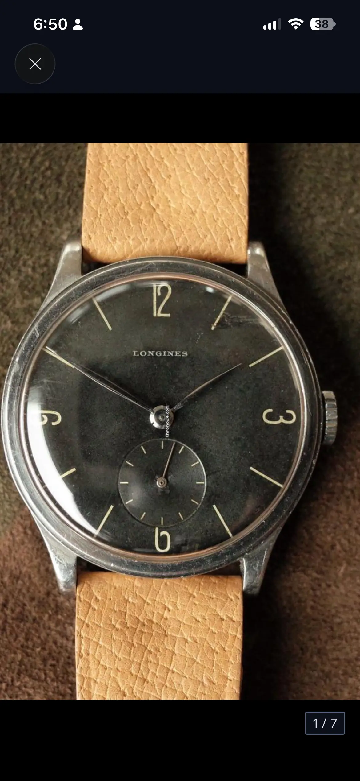

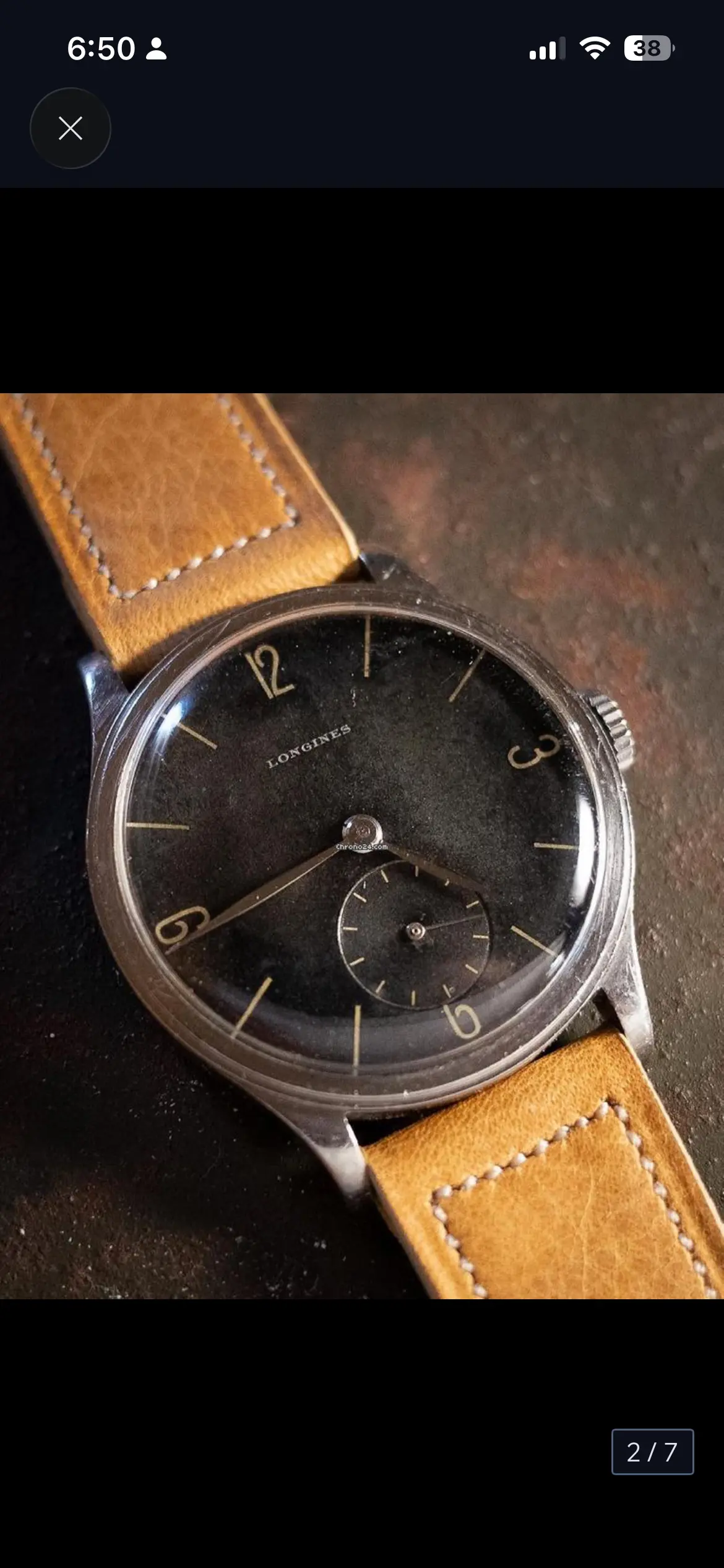

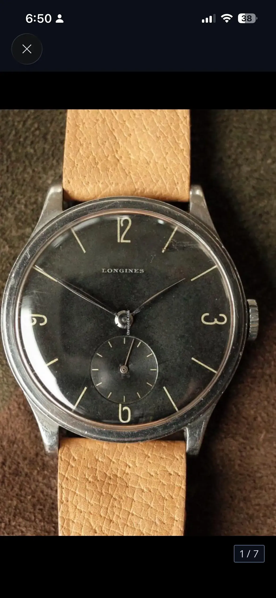

While I'm at it, what about this one?
Seems original to me, but it also doesn't have a Swiss made at the bottom.
2,824
4,933
The black dial looks original, to me. The lack of "Swiss" at 6 o'clock is not indicative of a redial.
266
324
Thanks for the opinion and expertise. This one is a possible purchase for me. I love the dial layout on these.
