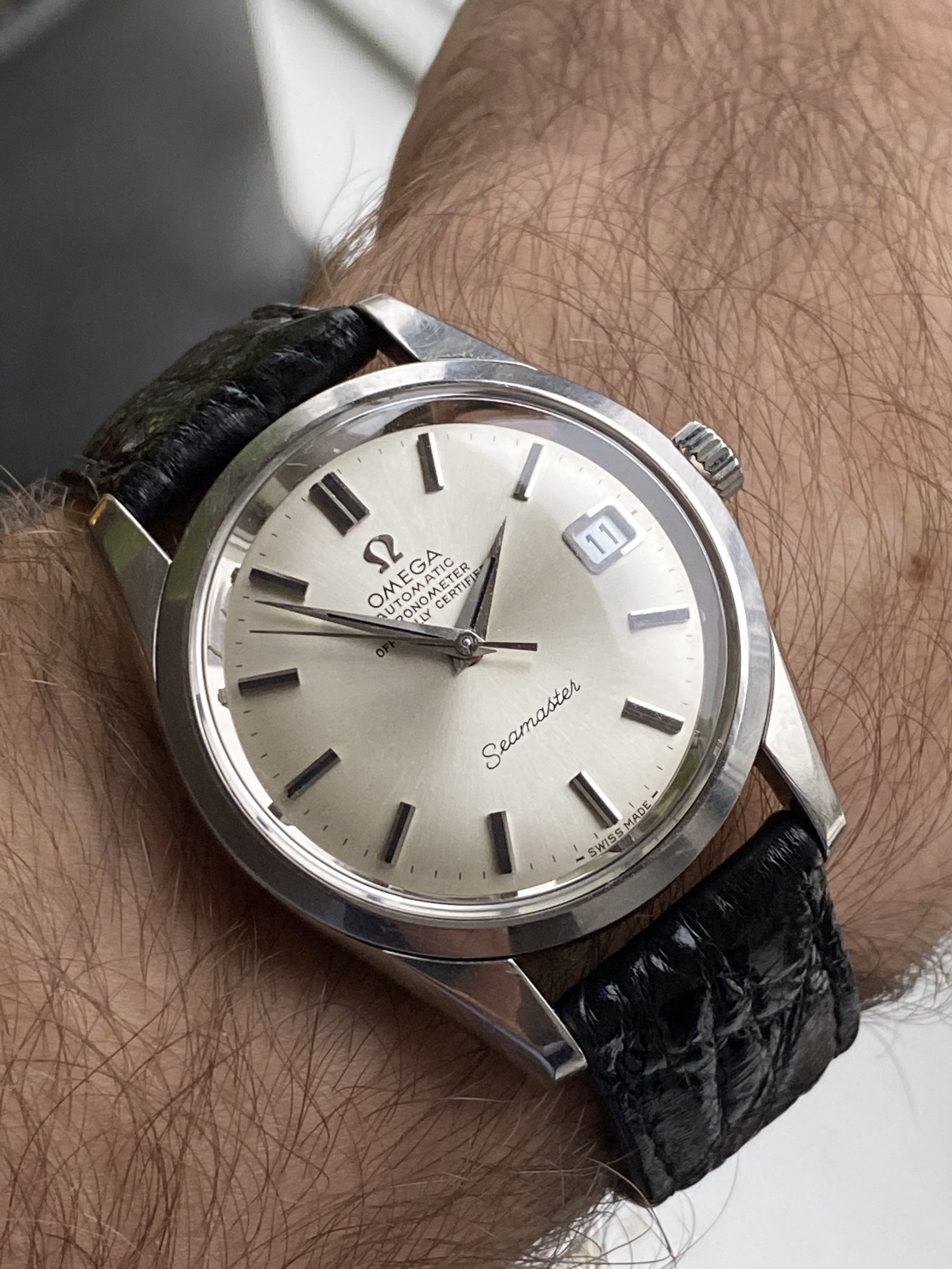

" -SWISS MADE- " dial?
986
3,013
I know vintage dials can be a combination of "swiss", "swiss made" and various "T's", but that one ?
dash swiss made dash? Have such dials actually existed or it is simply a redial?
Thanks

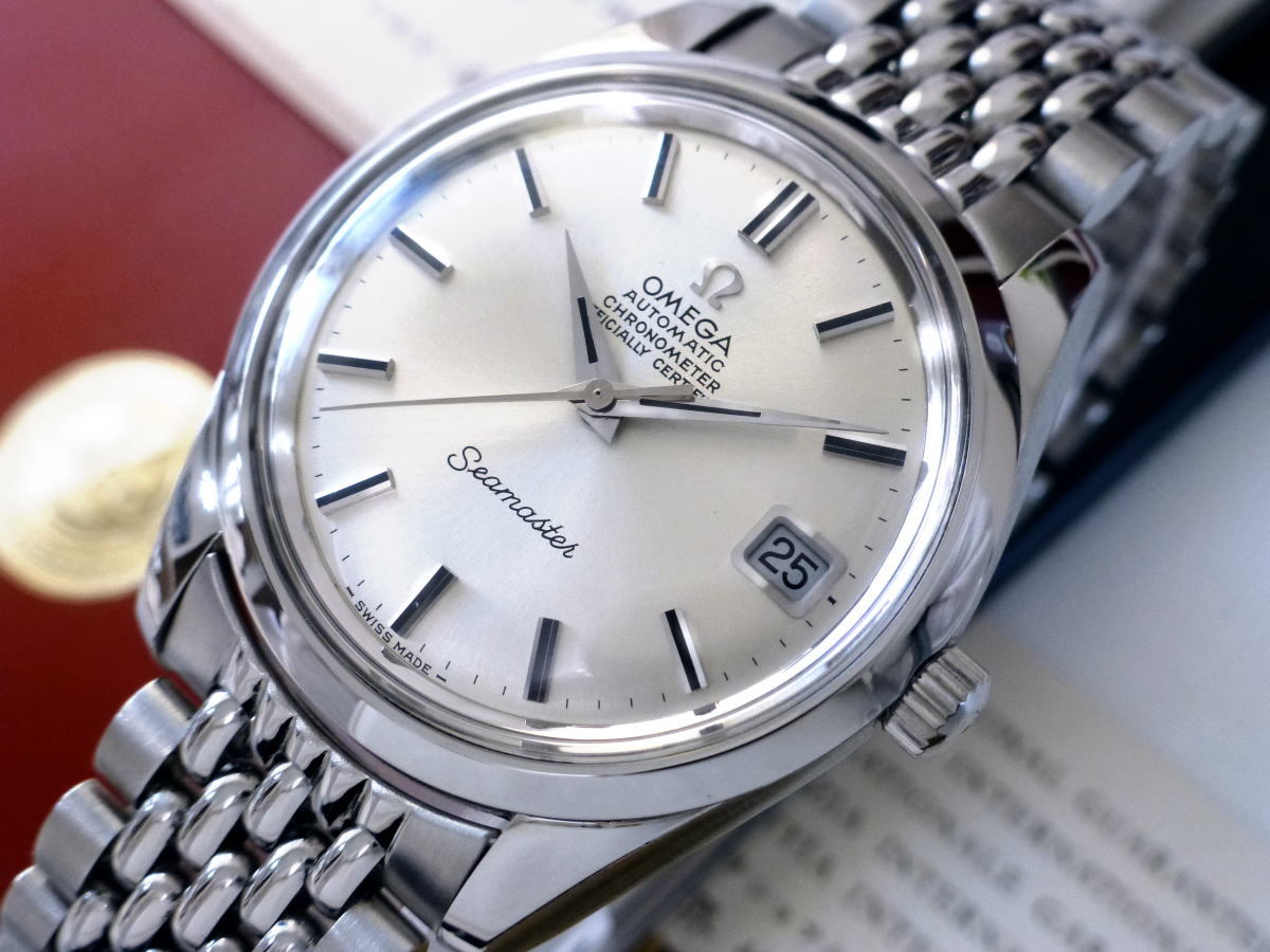

1,534
3,248
This case reference with the BOR is one of the nicest combinations from this era. The chronometer version makes it even more desirable.

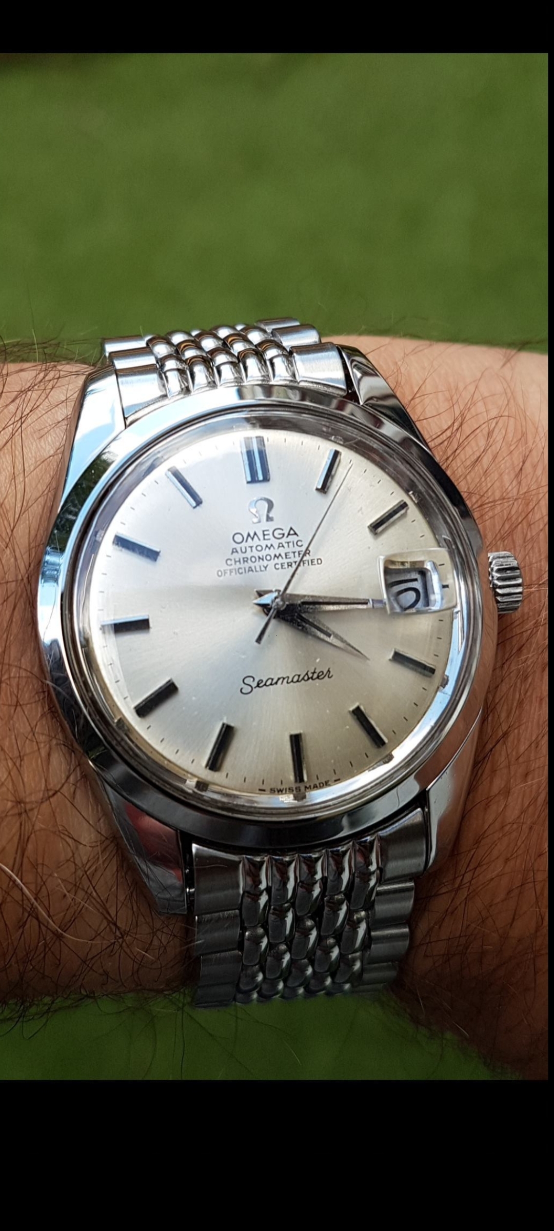

495
1,210
Thanks
To be clear, too: those are (I believe) onyx markers; that seems the most common way the chronometer-grade 166.010s came, from what I've seen (though I'm happy to be corrected).
1,534
3,248
Even most of the non-chronometer had these markers. I had a gold capped version that I wore regularly for almost 10 years. They really are beautiful.
986
3,013
Interesting, the watch in OP is Omega 168.024 (564 cal, 31mil serial) is it safe to assume it has onyx markers too?
495
1,210
It means late productions of 024. Black painted hour markers.

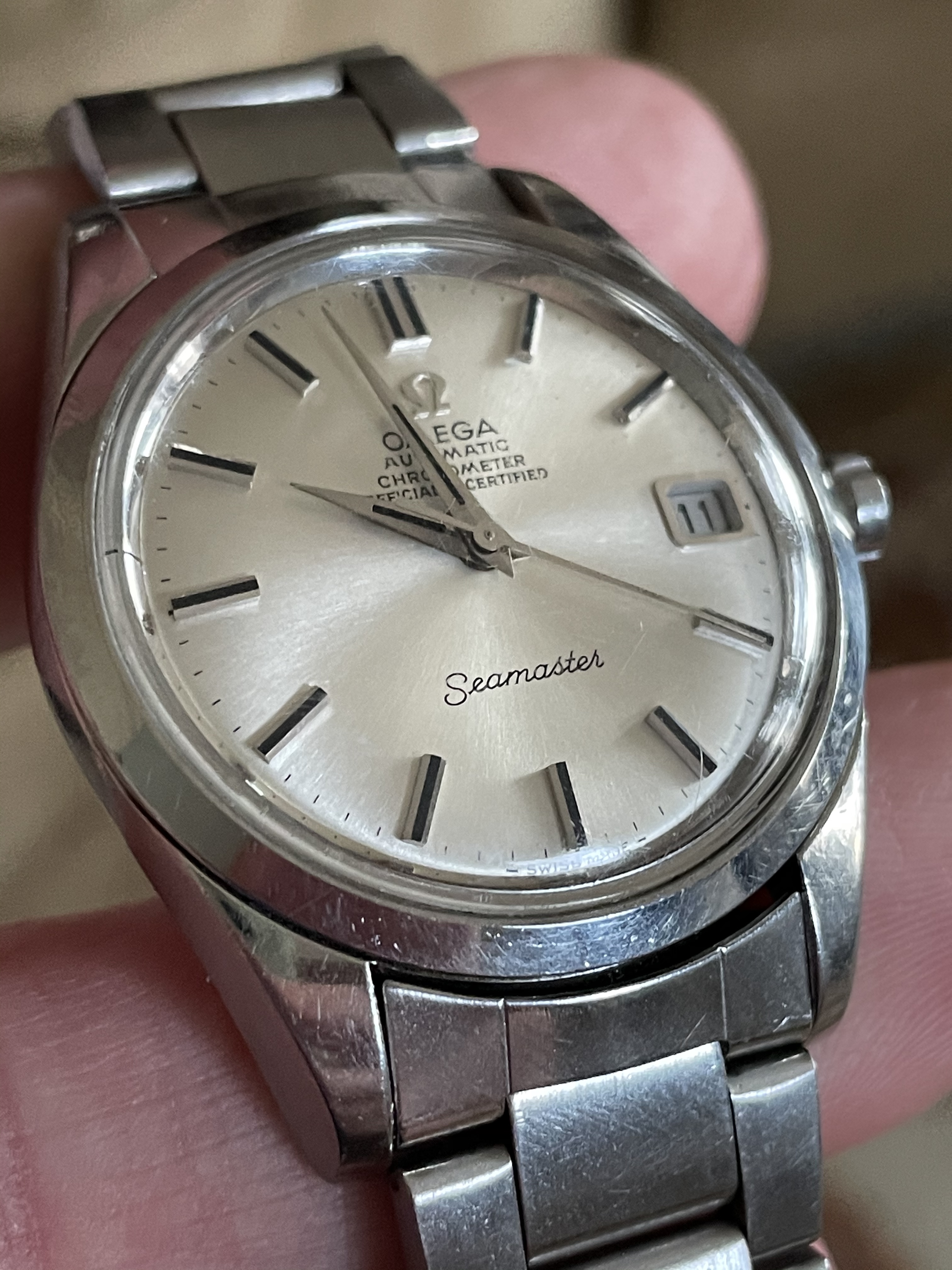

Fascinating--thanks for the clarification @hoipolloi. Hadn't realized these were paint--makes better sense with a closer look. Mine says hi.
