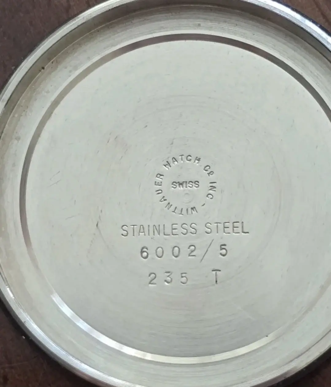

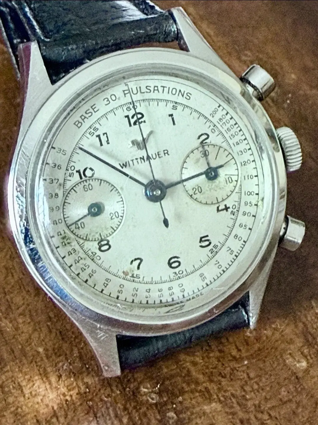

·Looking at a Wittnauer two-register chronograph and I've run into a mismatch I can't resolve. Photos attached (dial, caseback, movement, crown). I would appreciate input from anyone who knows Wittnauer chronographs.

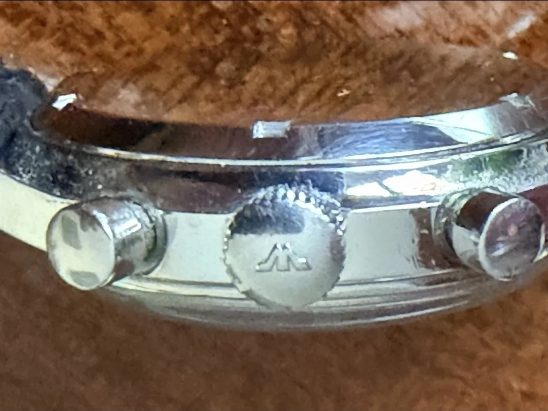

1. Did Wittnauer ever use the 6002 case family or the 235T designation for a two-register Valjoux 23 model? Or is this definitely a marriage? Or perhaps only a replacement caseback (and crown)?

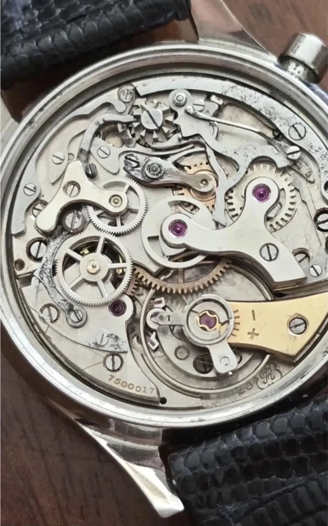

3. The balance bridge looks slightly different in tone from the surrounding bridges. Handling patina, or a replacement from another movement? I'd guess replacement.

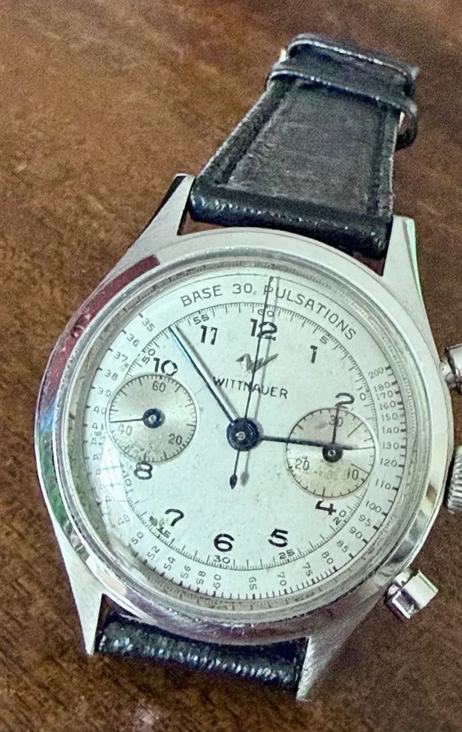

4. The applied "W" emblem above the WITTNAUER text doesn't match the logo I know from '60s Wittnauers that is on the crown. Is this shape correct for a late-'40s piece? Given it's applied rather than printed, I'm inclined to think the dial is original, but I'd like a second opinion - pulsation dials seem like a natural redial target.

- Silvered/white two-register dial, "BASE 30 PULSATIONS" scale, running seconds at 9, 30-min counter at 3. Aesthetically reads late '40s / early '50s to me.
- Movement: Valjoux 23. I can make out "23" under the balance. Column wheel, no Wittnauer signature on the bridges. Only other marking is 7500017 on the mainplate.
- Caseback (screw-down): WITTNAUER WATCH CO INC / SWISS / STAINLESS STEEL / 6002/5 / 235 T. Seller says 36mm.
The problem: everything I can find has 6002/5 + 235T as the three-register Valjoux 72 Professional from the mid-'60s, with tachy/telemeter scales. Nothing like this dial.
Questions:
2. On 7500017 - the first four digits are struck noticeably heavier than the last three. Two separate stampings? Batch plus serial, or something added later?
