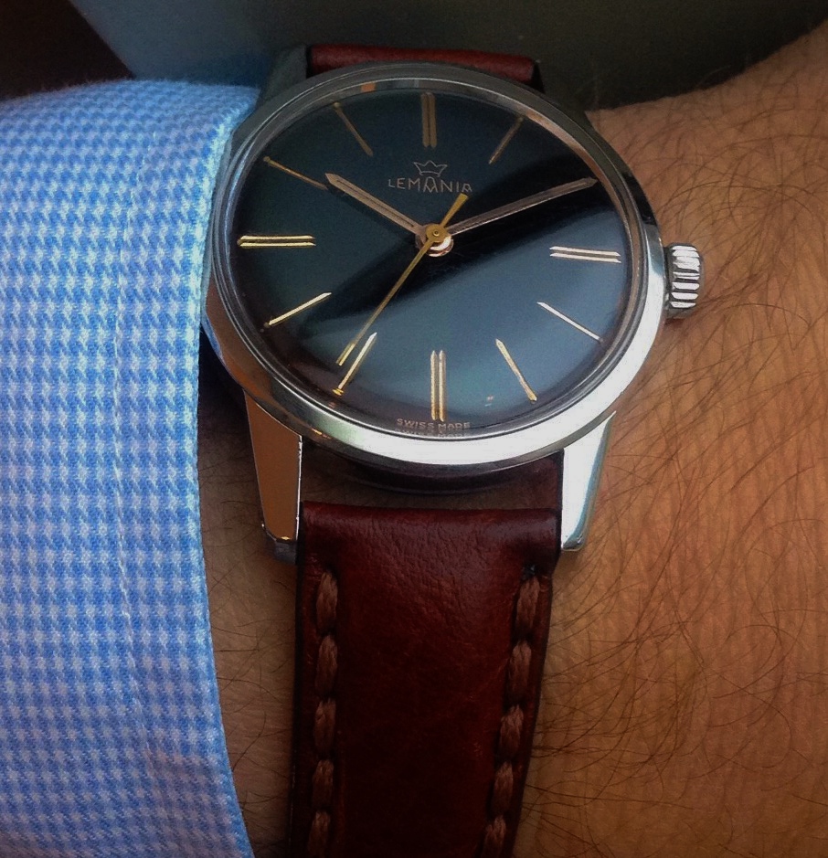

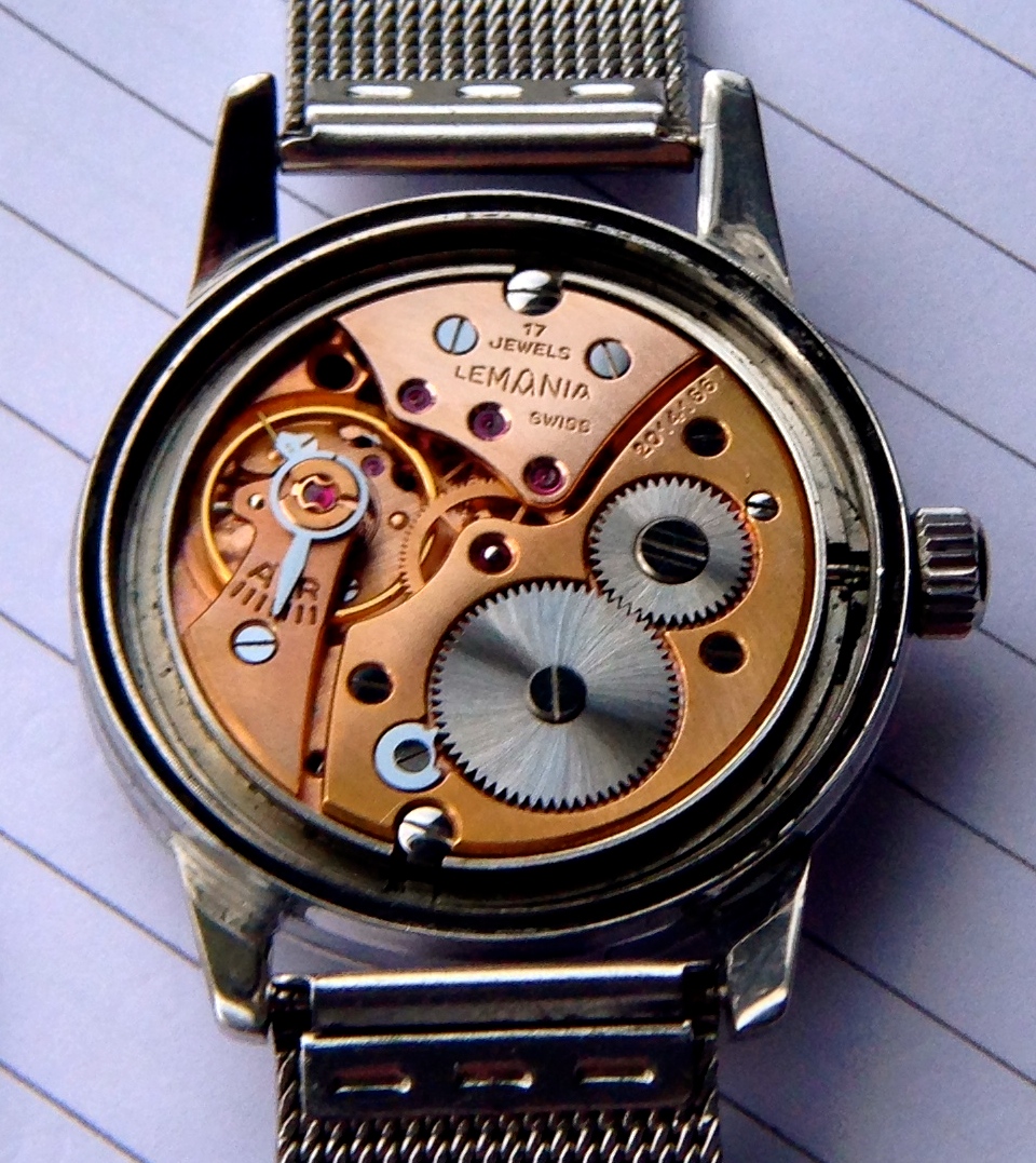

Lemania 3000
Have a look at Omega cal 381 and see if you can spot the similarities (also made by Lemania - cal 3300).
Lemania cal 3000 was developed from the Lemania S27. The S27 was again also used as basis for the chronograph movements CHRO27 (Omega 320/321). They also made automatic versions of the same caliber (cal 36xx)
I have tried to piece together an overview on these fantastic movements:
  • Lemania S27 17 jewels, Breguet spiral - Listed by Ranfft as “base calibre for the 27mm chronographs from Lemania and Omega”
  • Lemania S27T1 17 jewels, Breguet spiral - Prepared for date feature.
  • Lemania DS27 17 jewels, Breguet spiral - With date feature.
  • Lemania 2990 17 jewels, Breguet spiral - Same as DS27
  • Lemania CH27 17 jewels (caliber 2310, Breguet spiral - Same as Omega 320)
  • Lemania CH27 C12 17 jewels, (caliber 2320, Breguet spiral - Same as Omega 321)
  • Omega 27 Chro T1 PC AM 17 jewels (caliber 320: 2 register chronograph, Breguet spiral)
  • Omega 27 Chro C12 T2 PC AM 17 jewels (caliber 321: 3 register chronograph, Breguet spiral)
  • Omega 27 D PC AM 17 jewels, Breguet spiral (caliber 380 - never in serial production)
  • Omega 27 DL PC AM 17 jewels (caliber 381 - Cosmic Moon Phase, Breguet spiral)
  • Lemania D27 17 jewels - Equivalent to Omega 380, Breguet spiral (See Lemania 3300).
  • Lemania 3000: sub second, 17 jewels, Breguet spiral.
  • Lemania 3010: sub second, 21 jewels, Breguet spiral.
  • Lemania 3015: sub second, date, 17 jewels, Breguet spiral.
  • Lemania 3040: sub second, 21 jewels, Breguet spiral, glucydur balance.
  • Lemania 3050: sweep second, 15/17 jewels, Breguet spiral.
  • Lemania 3060: sweep second, bridge over center second drive, 17 jewels, Breguet spiral.
  • Lemania 3065: sweep second, bridge over center second drive, date, 17 jewels, Breguet spiral.
  • Lemania 3100, 3110: sub second, 17 jewels flat hairspring
  • Lemania 3150: sweep second, 15/17 jewels flat hairspring
  • Lemania 3160: sweep second, bridge over center second drive, 15/17 jewels flat hairspring
  • Lemania 3170: sweep second, bridge over center second drive, 15/17 jewels flat hairspring
  • Lemania 3300: sub second, calendar: day, date, month, 17 jewels flat hairspring (Same as Omega cal 380).
  • Lemania 3535: sweep second, 15/17 jewels flat hairspring
  • Lemania 3540: sweep second, bridge over center second drive, 15/17 jewels flat hairspring
  • Lemania 3600: Automatic version of caliber 3000, sub second. 17/21 jewels, Breguet spiral
  • Lemania 3610: Automatic version of caliber 3000, sub seconds. 17/21 jewels, Breguet spiral
  • Lemania 3615: Automatic version of caliber 3015, sub seconds. 17/21 jewels, Breguet spiral, Date function.

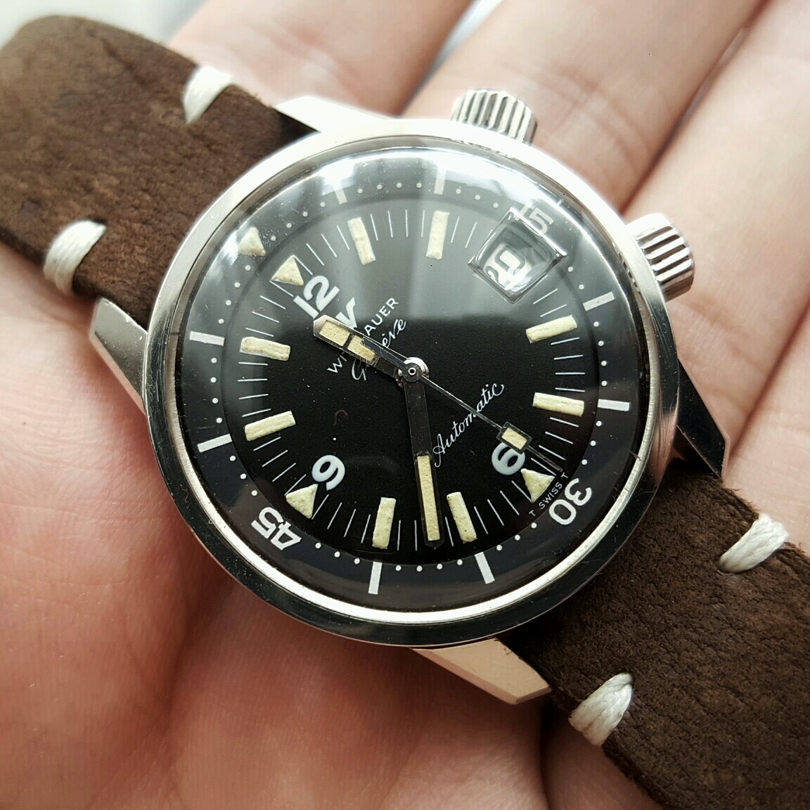

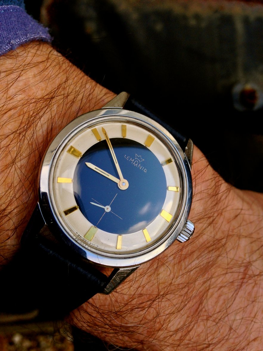

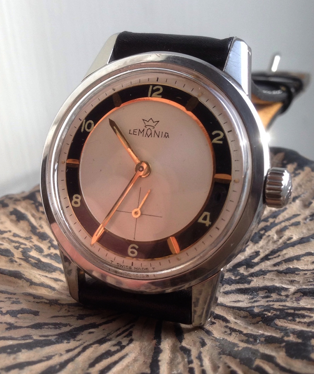

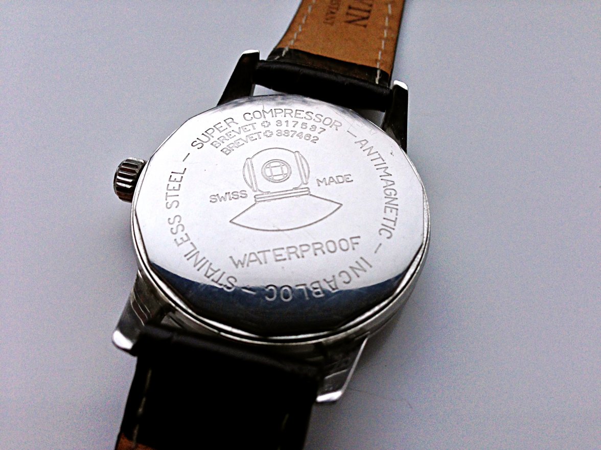

Here are some of my Lemania EPSA Super Compressors:

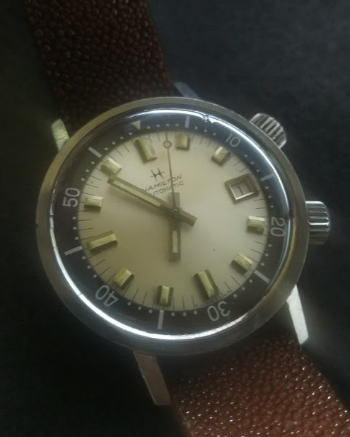

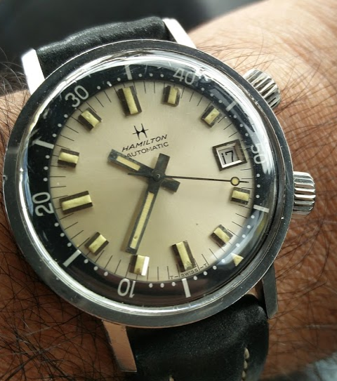

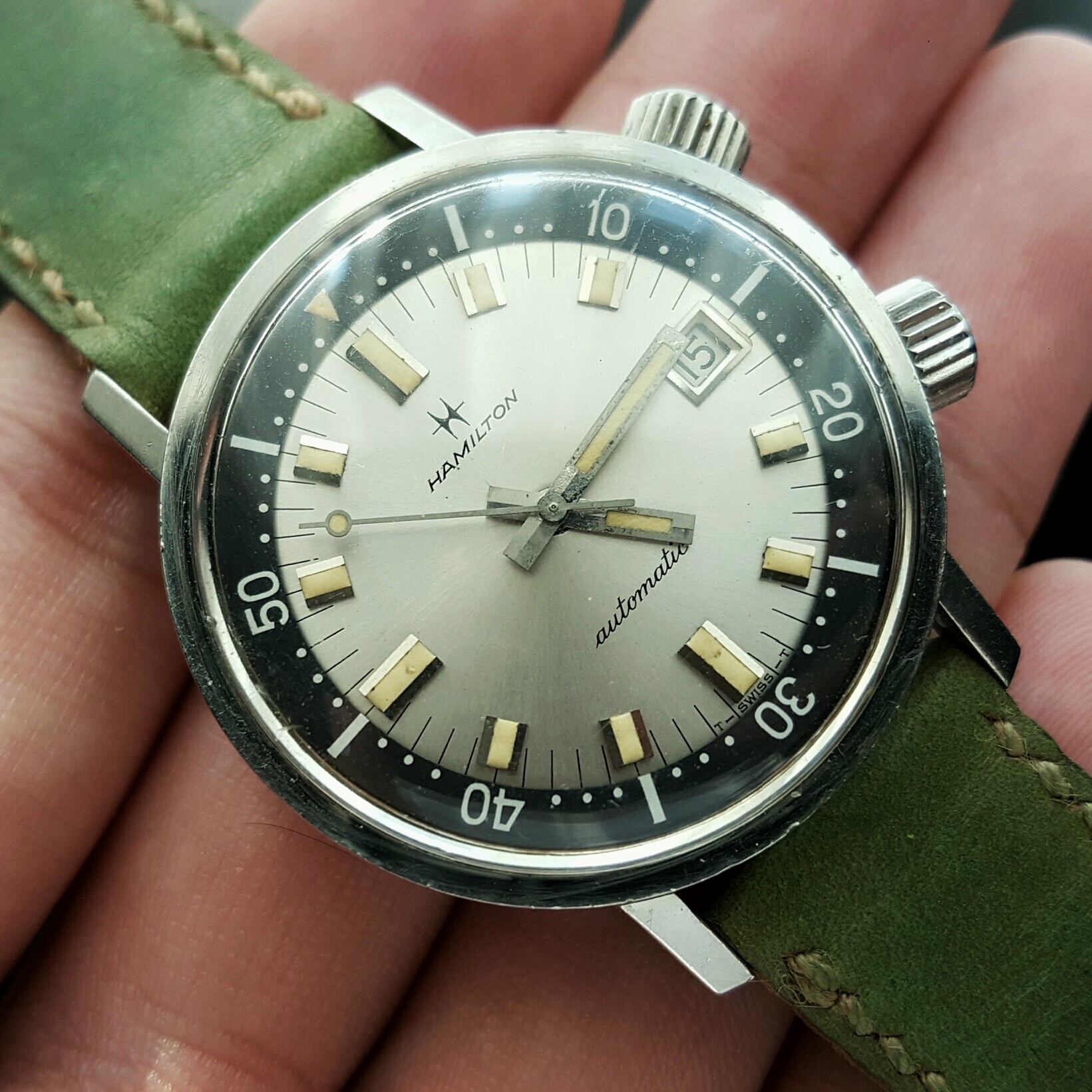

Was going to create a Super Compressor Roll Call thread, but found this thread. Not as active as is should be given all the watches you all own, so thought this one should be revived.

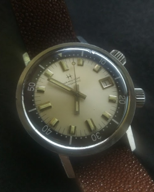

I picked this one up earlier this week at a shop in downtown Palm Springs, CA. I was out there a few weeks back and ran across it as I was out for lunch.
It is a Hamilton 600 Super Compressor.
I am not sure what year this is from. It could be the late 1960s or early 1970s. From what I can gather there were two different movements used in these watches, so I would need to get a look inside to see the movement number to get a better sense when it was produced.
I found a watchmaker that will swap out the crystal. And contacted a Hamilton enthusiast for a lead on a crystal (apparently hard to find a crystal, but have yet to confirm this).
I believe all parts to be original, so any feedback would be appreciated.

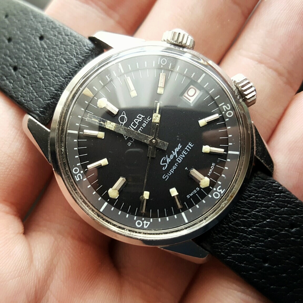

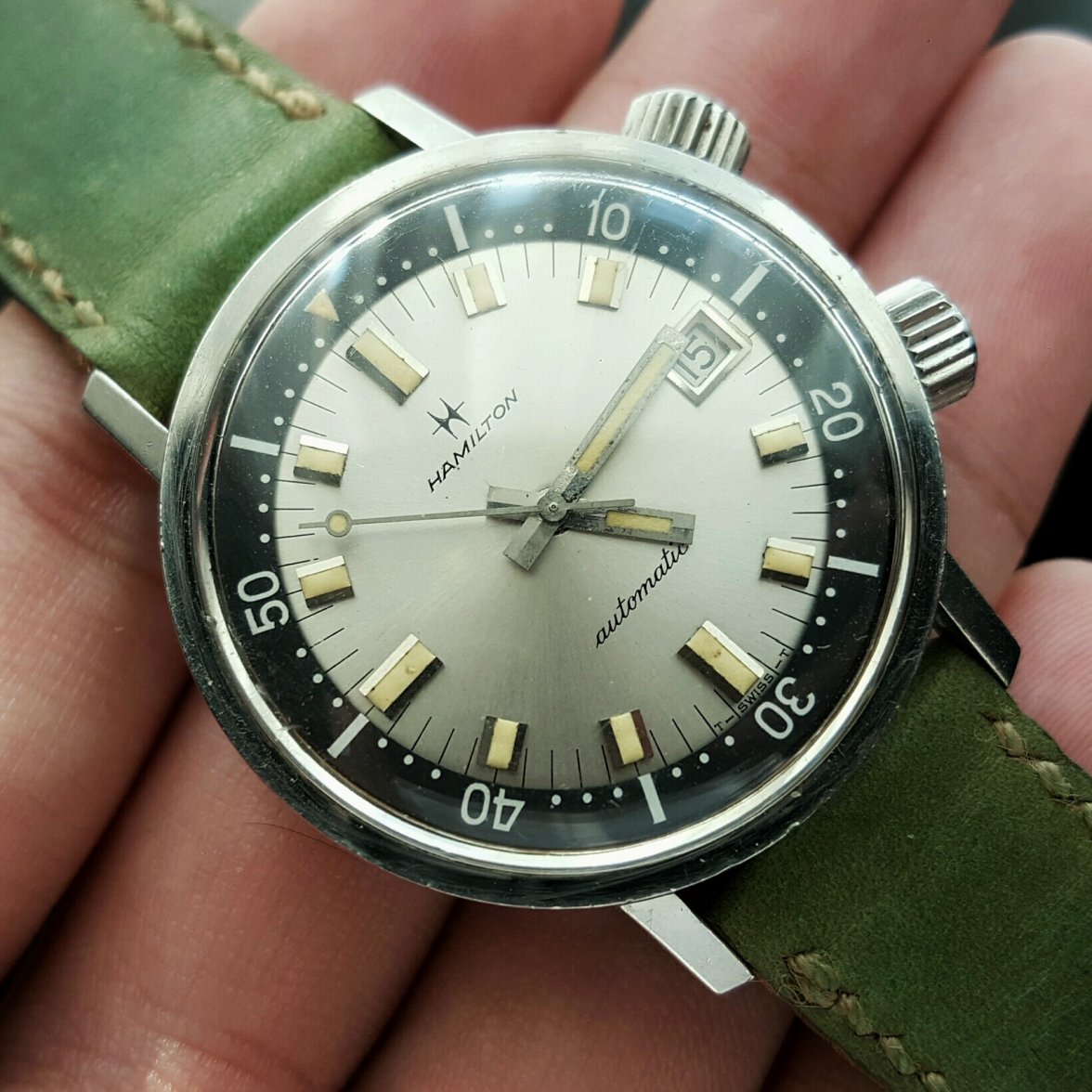

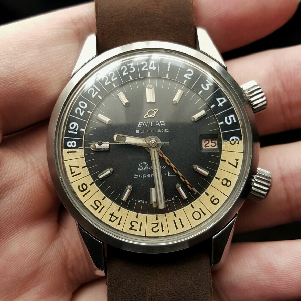

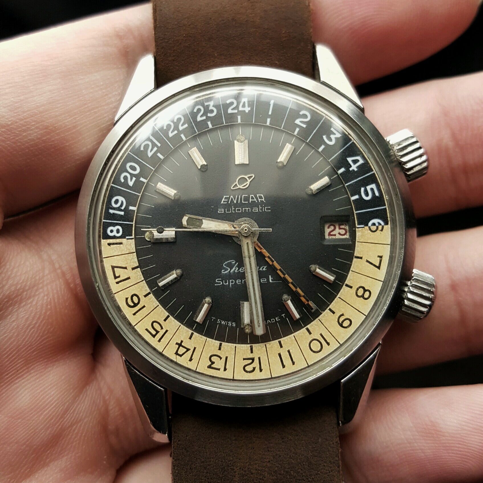

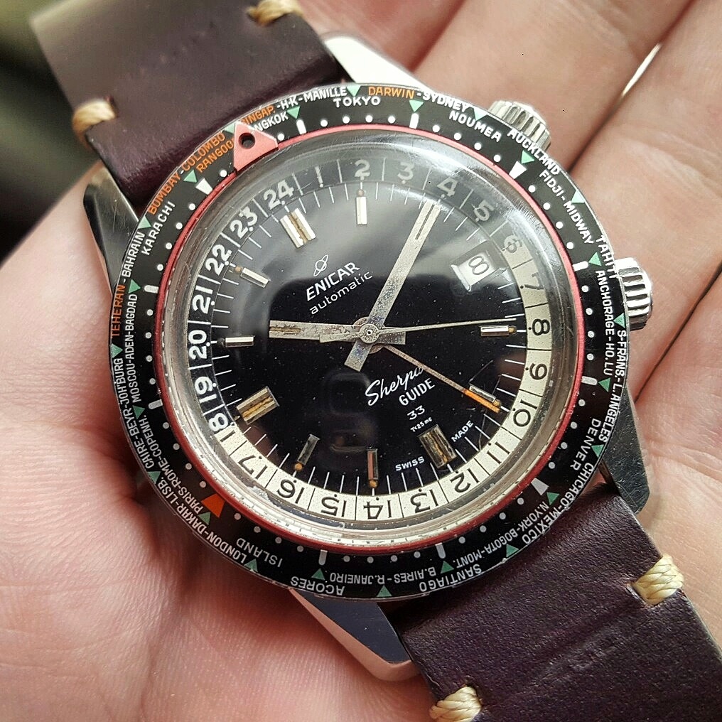

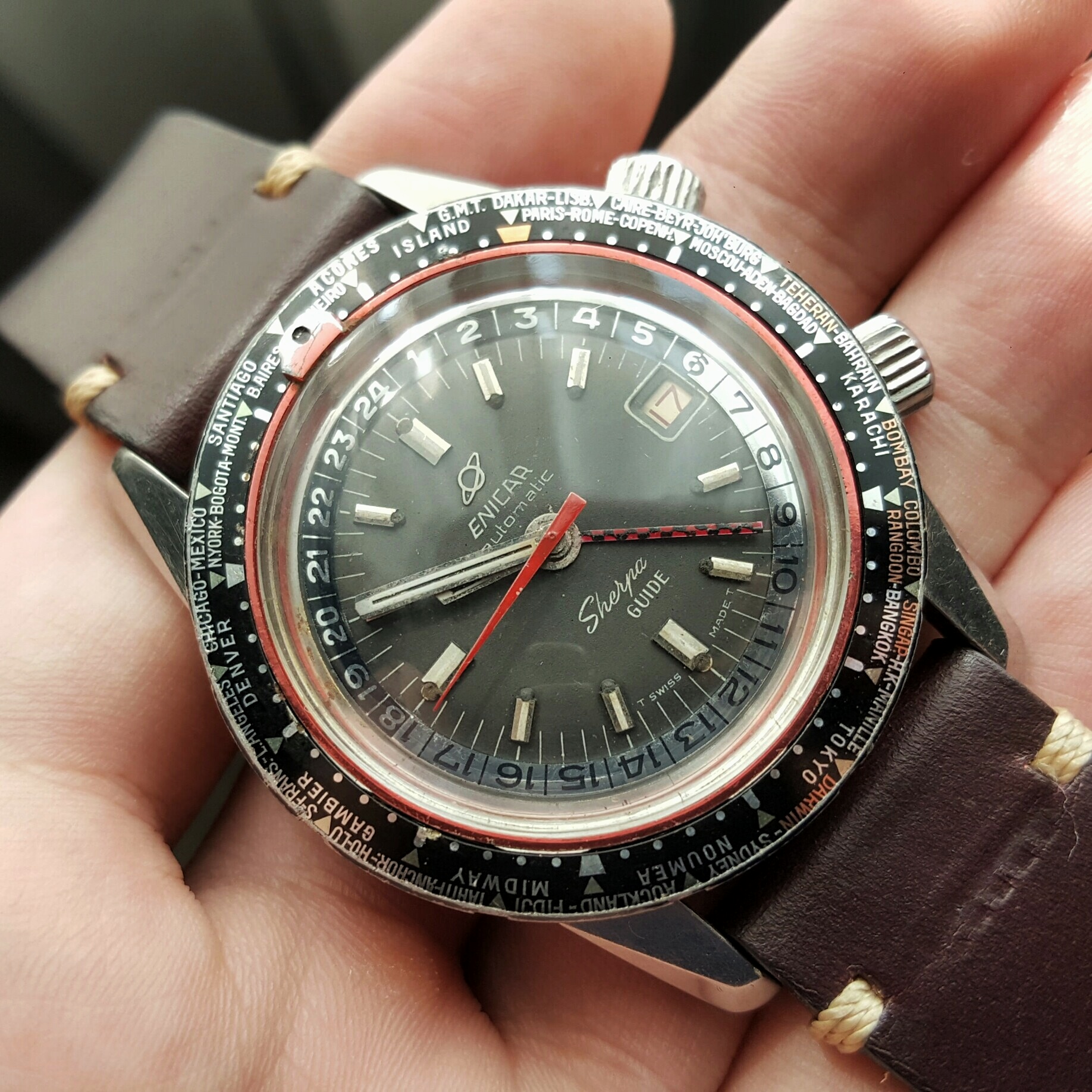

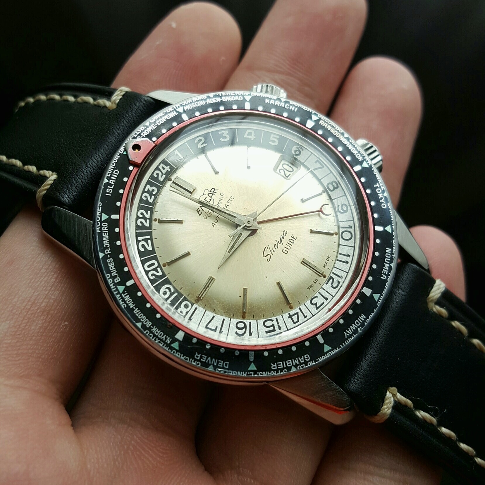

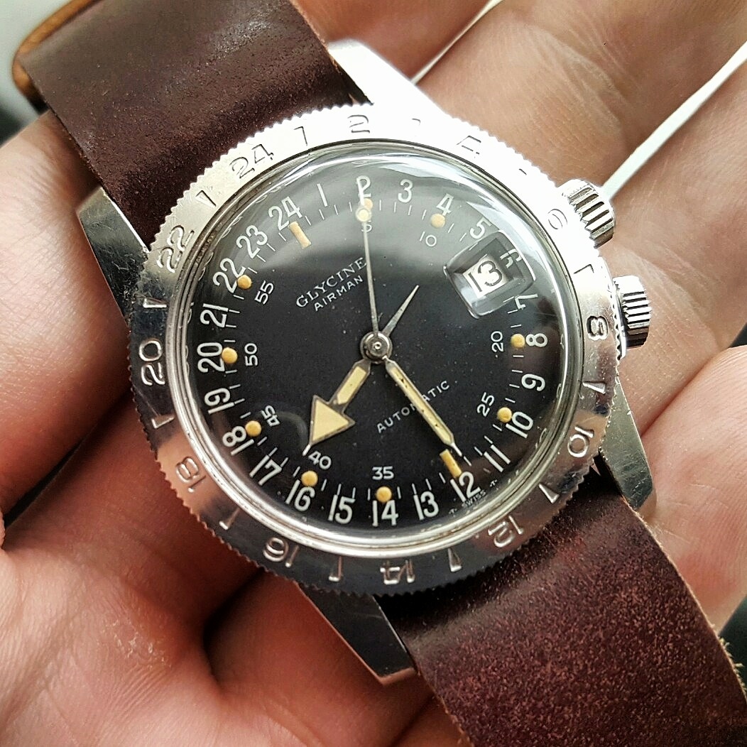

I have quite a few compressors, and actually prefer the less common single crown versions. Here are a couple of rarely seen model...
Dibs on the Ebel.....

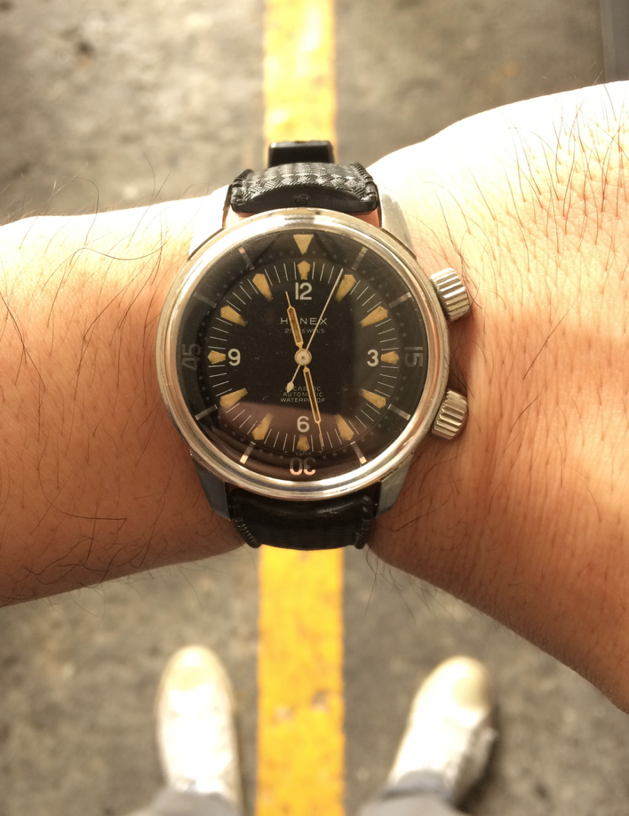

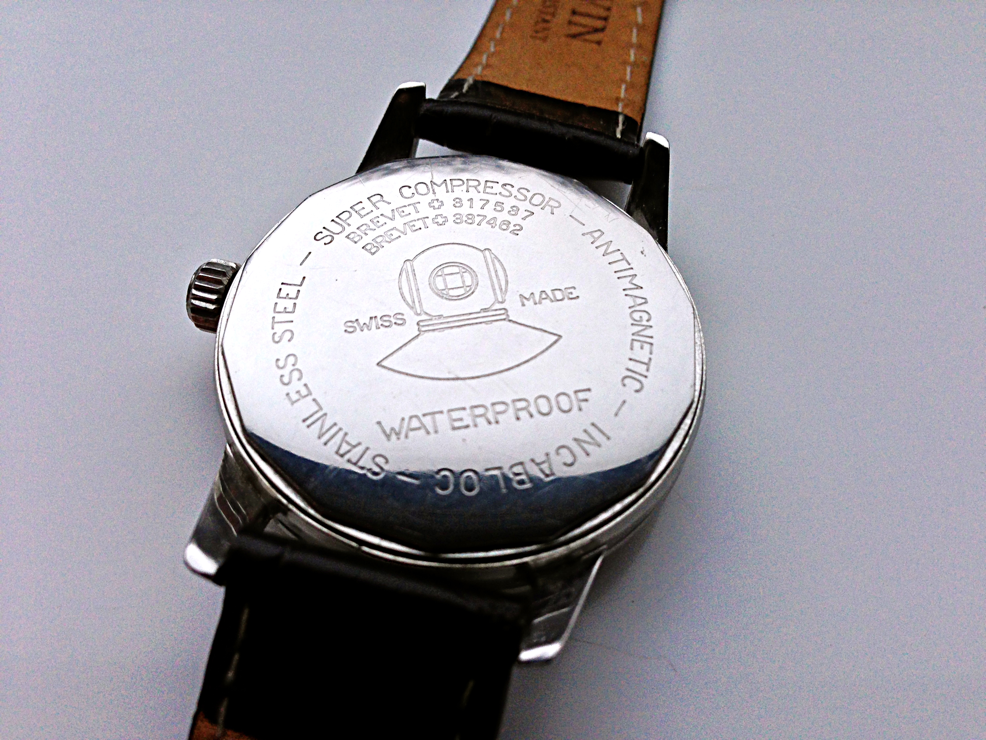

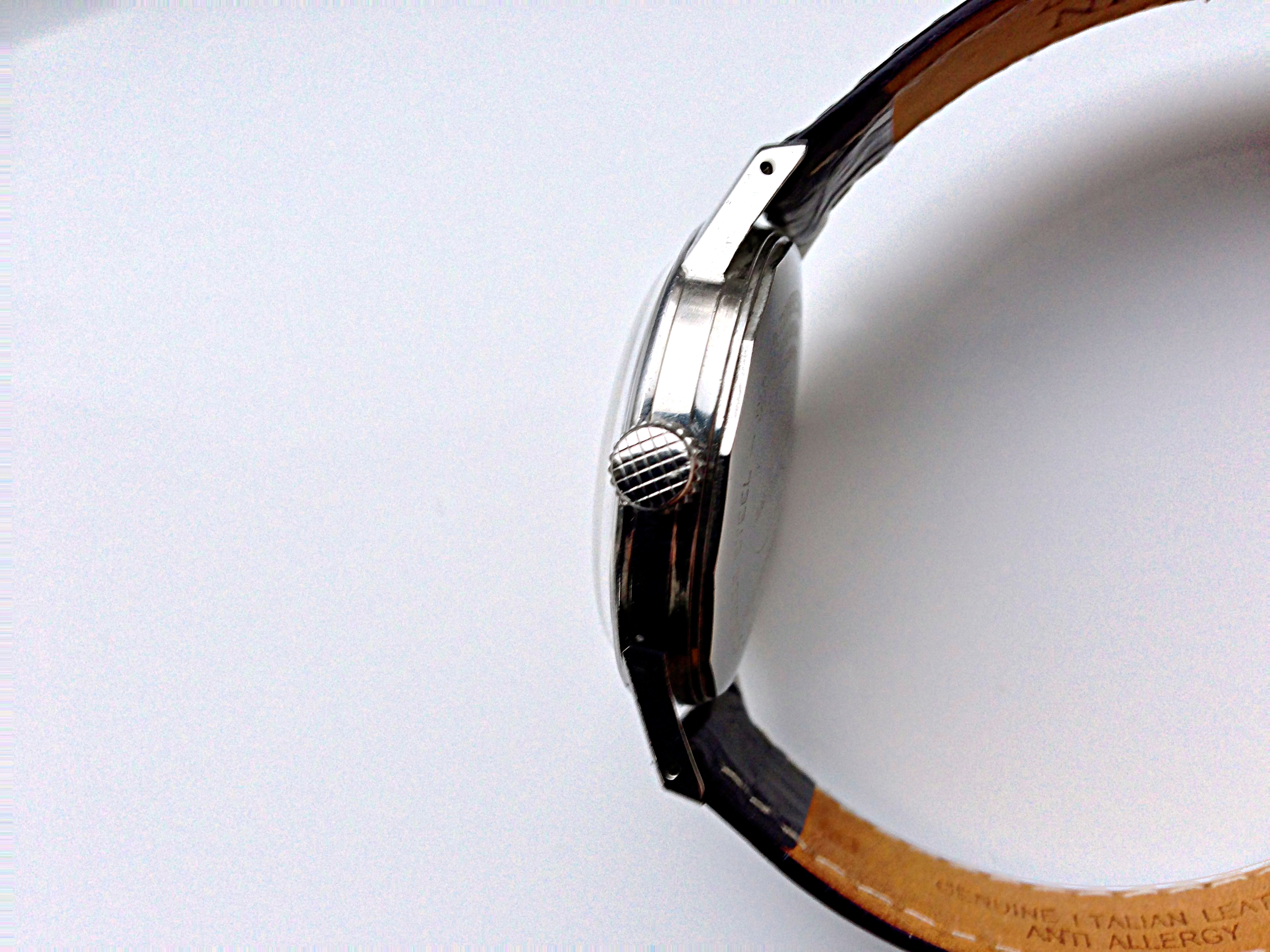

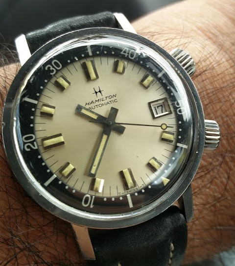

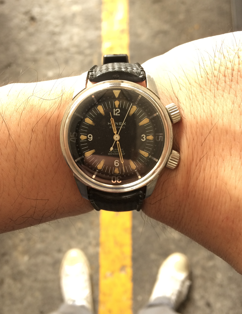

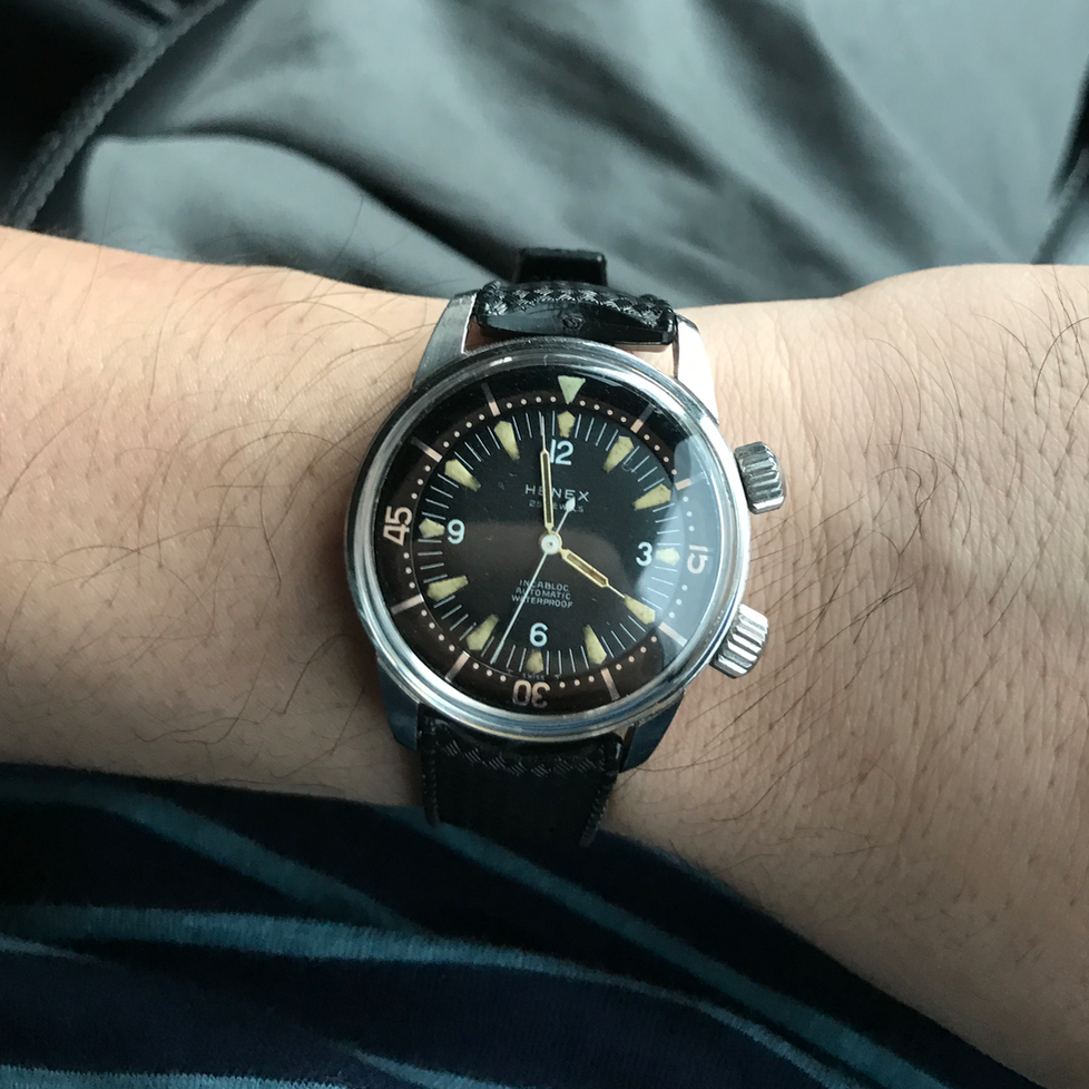

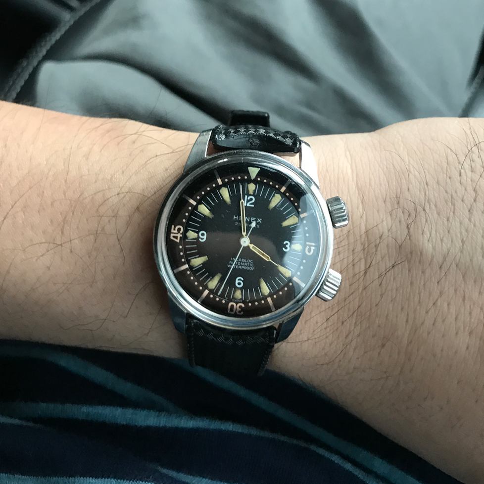

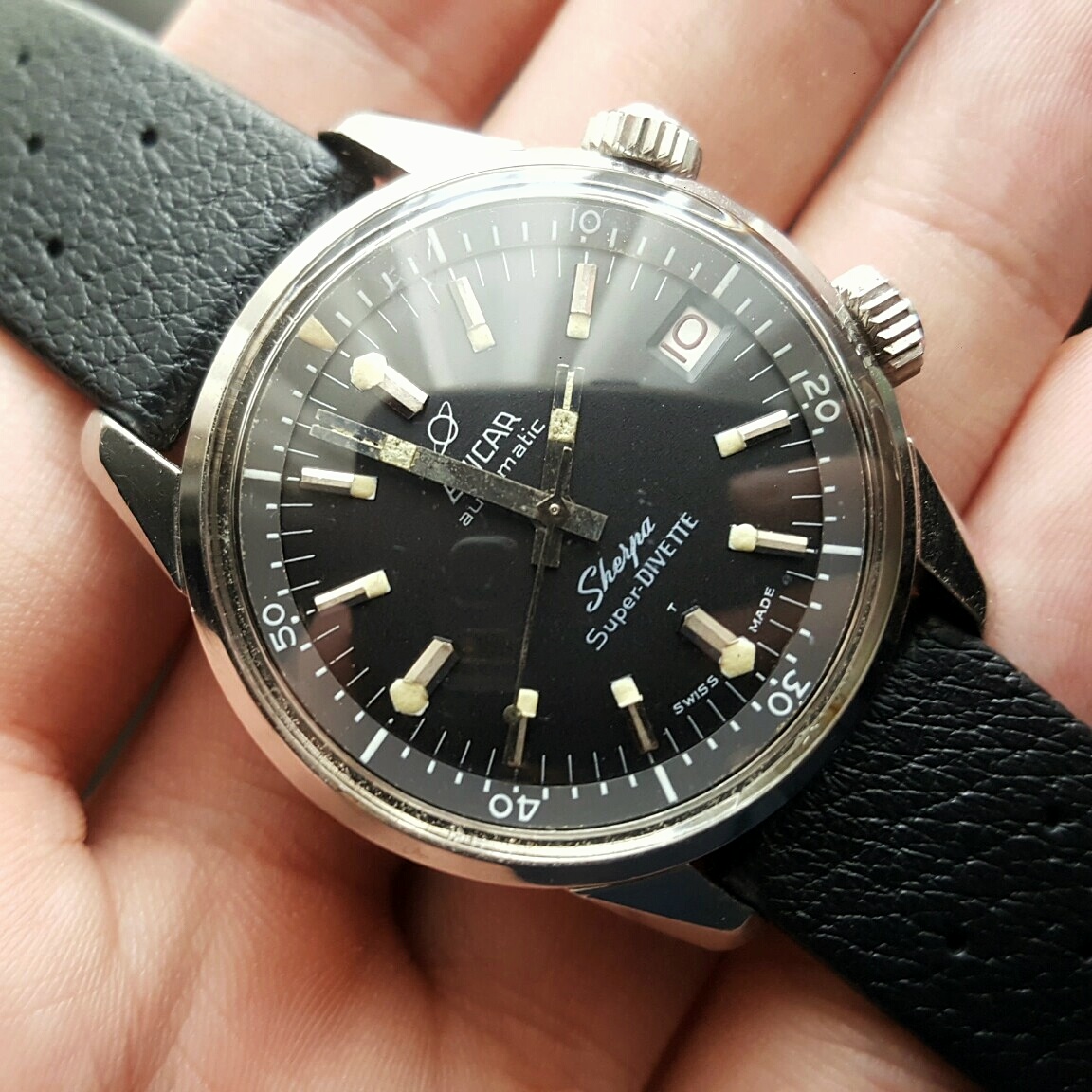

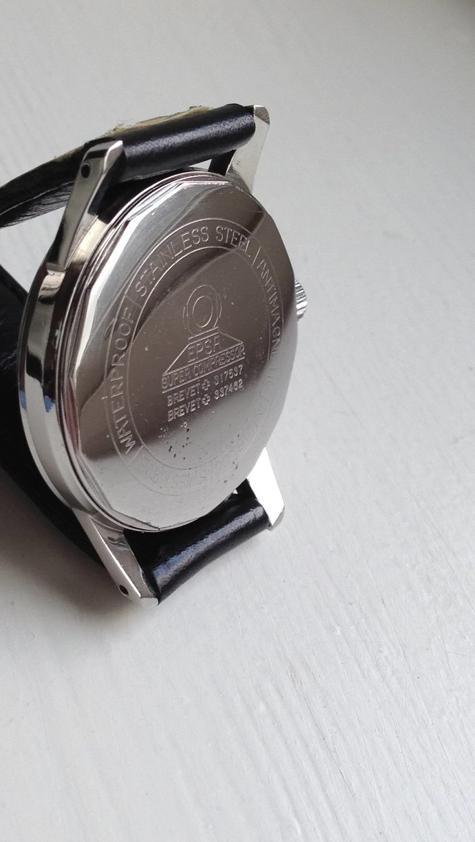

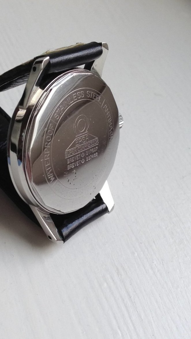

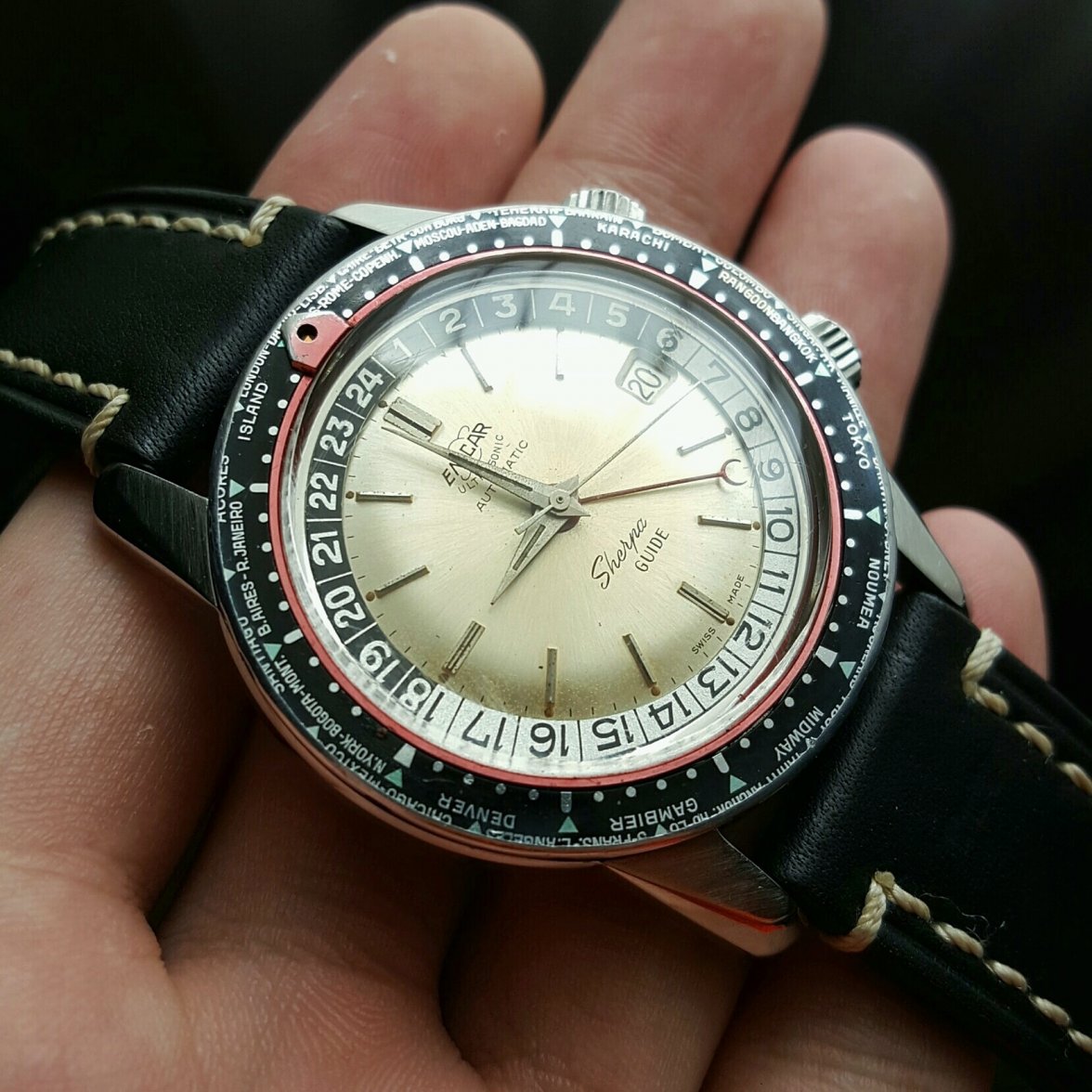

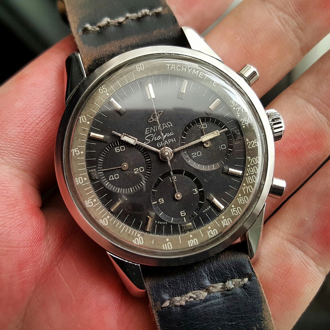

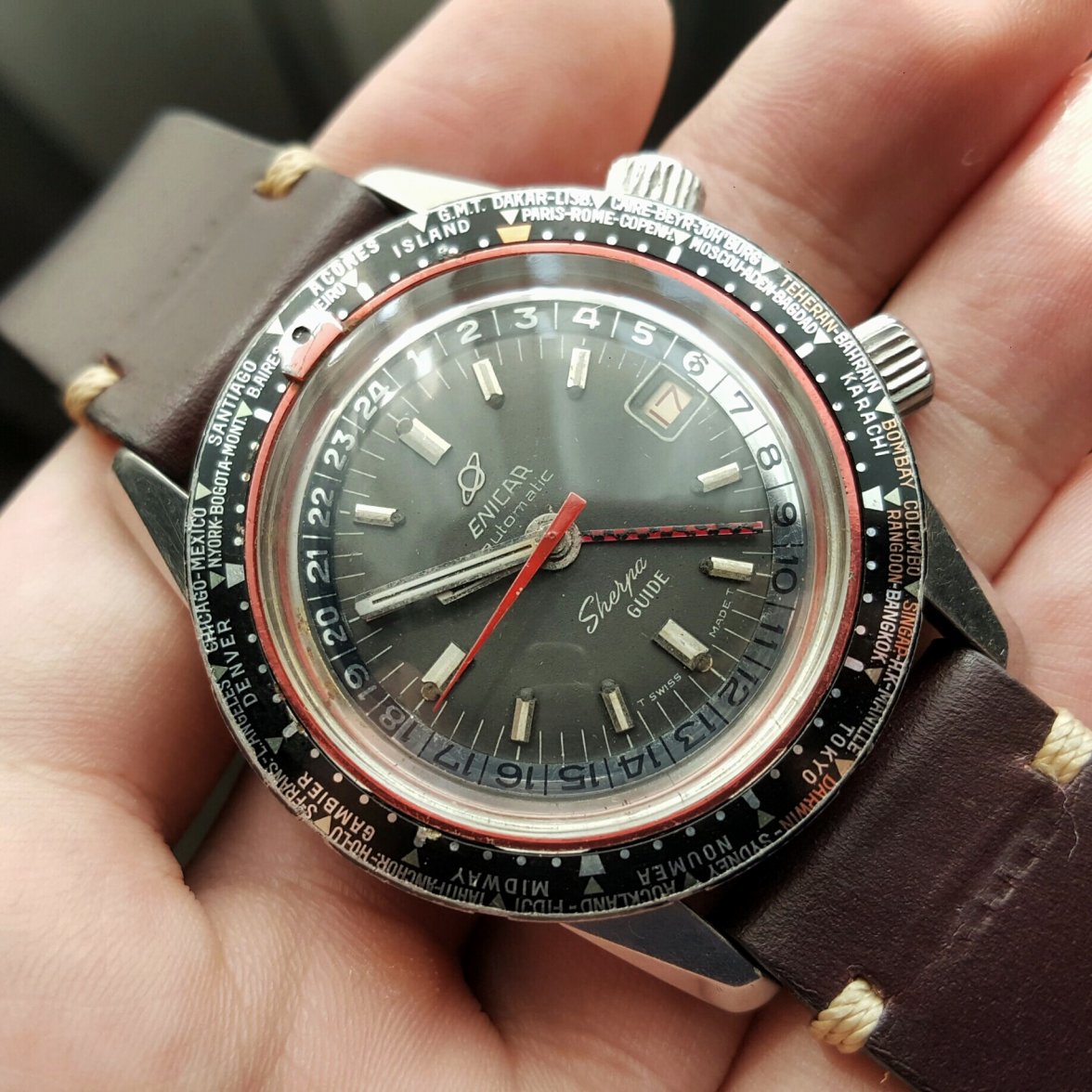

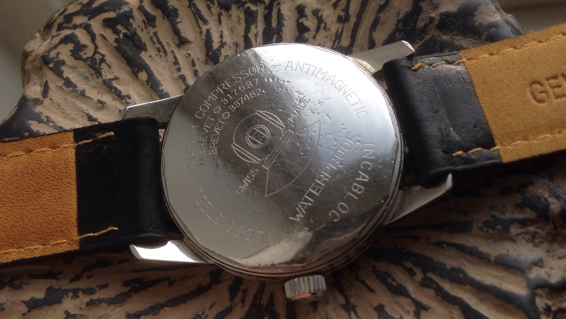

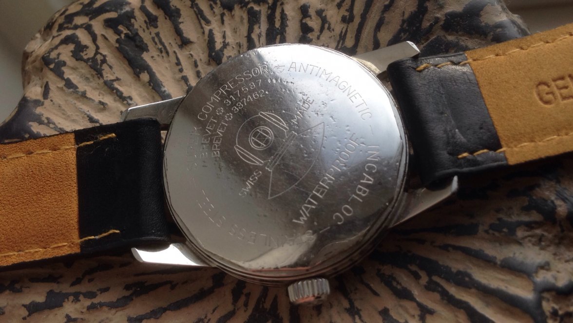

Here are a couple of pics of my Henex Super Compressor:
