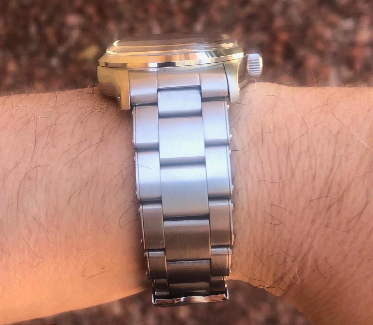

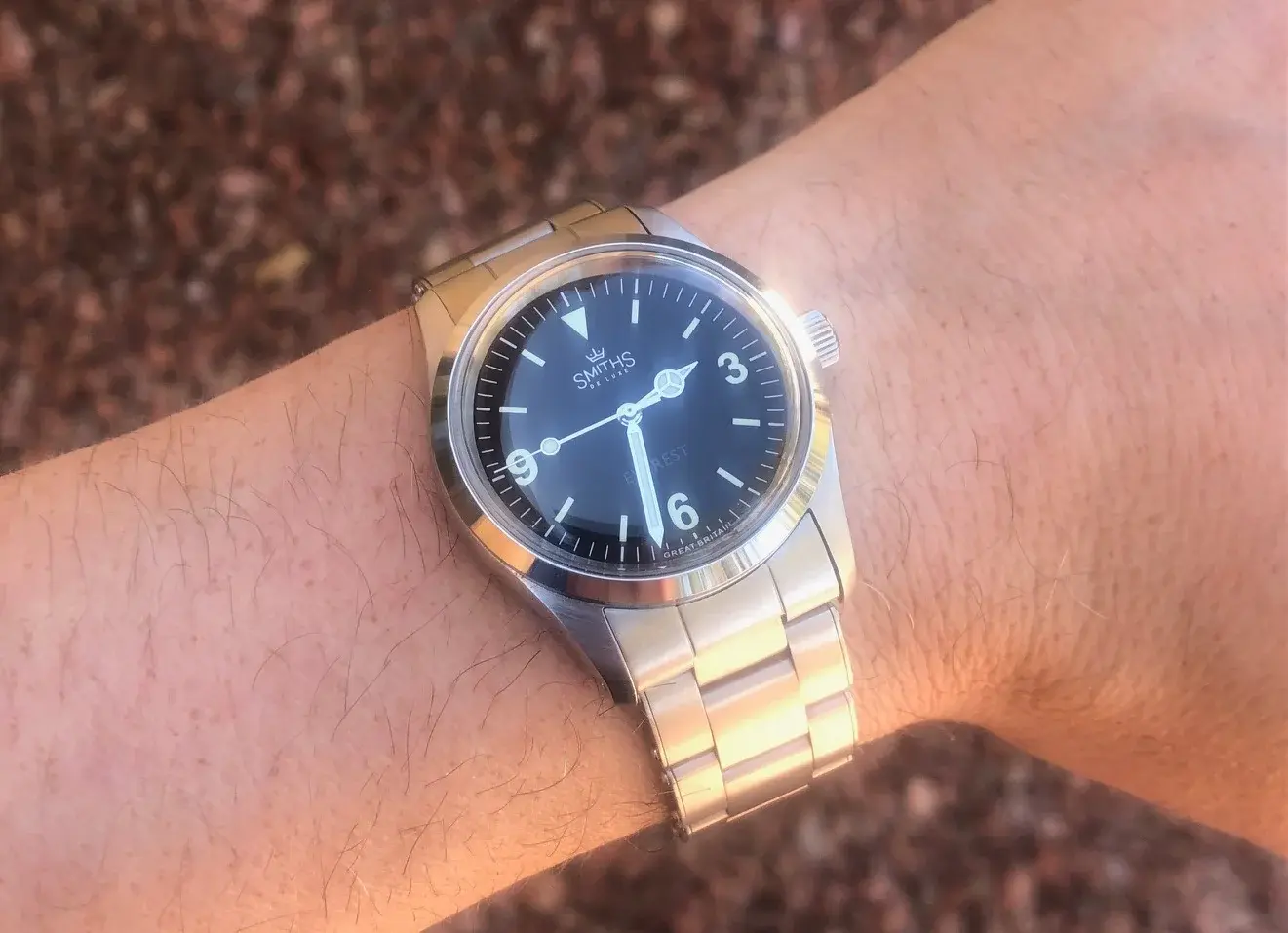

I've owned a Smiths Everest for a few years now but never liked the sapphire crystal due to the milky ring. I'd much rather have an acrylic crystal--both for clarity and to match the vintage look of the design.

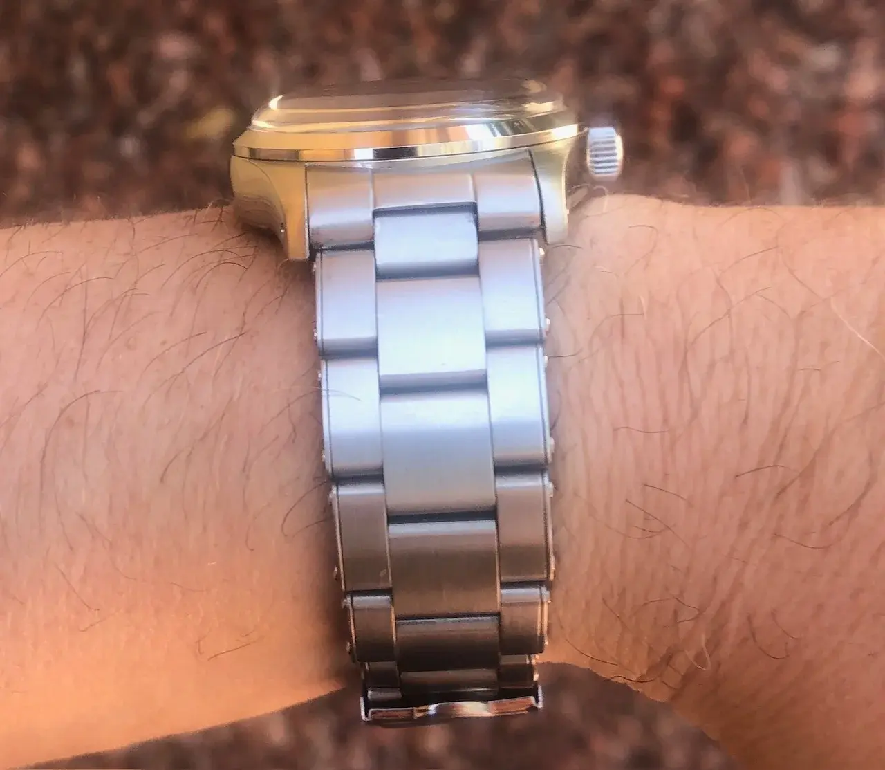

I recently ordered a GS hi-dome from Esslinger (I'm in the USA) and while I like it, and much prefer it to the sapphire crystal, I'd prefer a crystal with a lower profile, and preferably, with a tension ring. The one I currently have installed does not have a tension ring--although I was able to get a very tight fit that at least passes 30m water resistance. I don't plan to use the watch in the water, but I'd like to get as much water resistance as I can. With a sapphire crystal the watch is rated for 100m water resistance.
I've searched online but most sellers don't show an image of crystal side profile. Just a description of the crystal characteristics and the diameter.
Does anyone have advice on how to locate what I'm looking for? To be specific, I'm looking for an acrylic crystal with a lower profile, a stainless/chrome/silver tension ring, with a diameter of 31.6mm.

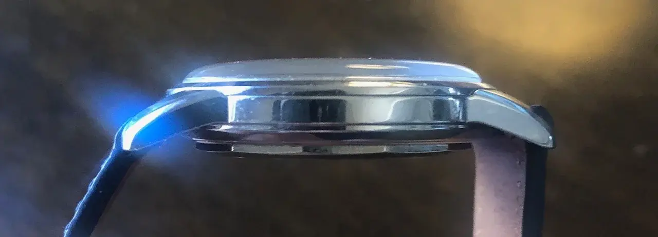

I'm looking for a profile more like my Longines Conquest Heritage:

I think the crystal you would NOT prefer is a PHD, or plastic high dome. A lower profile crystal is called a PK, by Germanow-Simon (GS). I don’t know if the PK designation is used by other makers, but any supplier of GS crystals should have the PK type. Now, whether the PK crystal is available with the reflector ring, I dunno. A crystal with a reflector is called a WRA (with ring adaptor) type by some suppliers. Best of luck.

Good to know. The crystal I bought is in fact labeled as PHD.
Edit - As I look now Esslinger sells the PK series. That fixes the dome problem, and it's an improvement over my hi-dome. Now if I can find ones with that profile that have a tension ring.

I posed this question on WUS and was told what I'm looking for is the GS TT (Thin-Tite). It's low profile with a tension ring. I'm going to order some PK's as well as they are very inexpensive. Then I know I'll be good to go.
