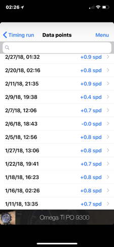

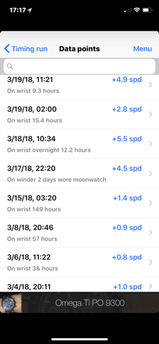

    Here are some screen shots of the rates in the past vs now:

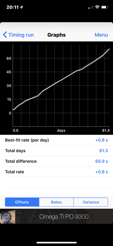

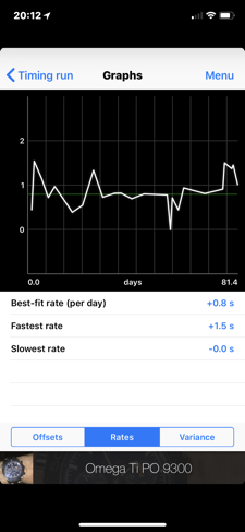

    This first ones are screenshots of my timekeeping app that I took at 81 days of continuous running and timekeeping, where you can see it it averaged 0.8 sec/day and never strayed beyond running +0 to +1.5 sec/day. I also have shots at 15 days, 33 days, and 75 days of running straight, which looked very similar so I'm not going to waste space with them:

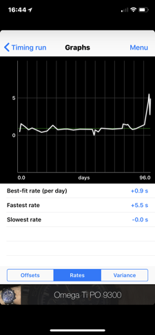

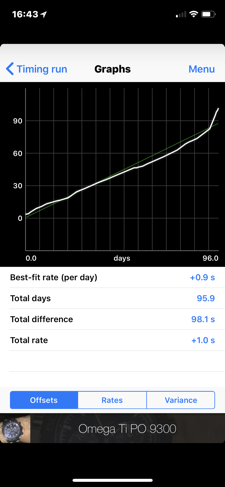

    It continued like that for the first 90+ days (I didn't do another screenshot until today), but for the past 4 days it has jumped up to running several times faster. See where the rates shifted up suddenly between March 15-17 while on the winder, which haven't returned to normal after wearing it again:
