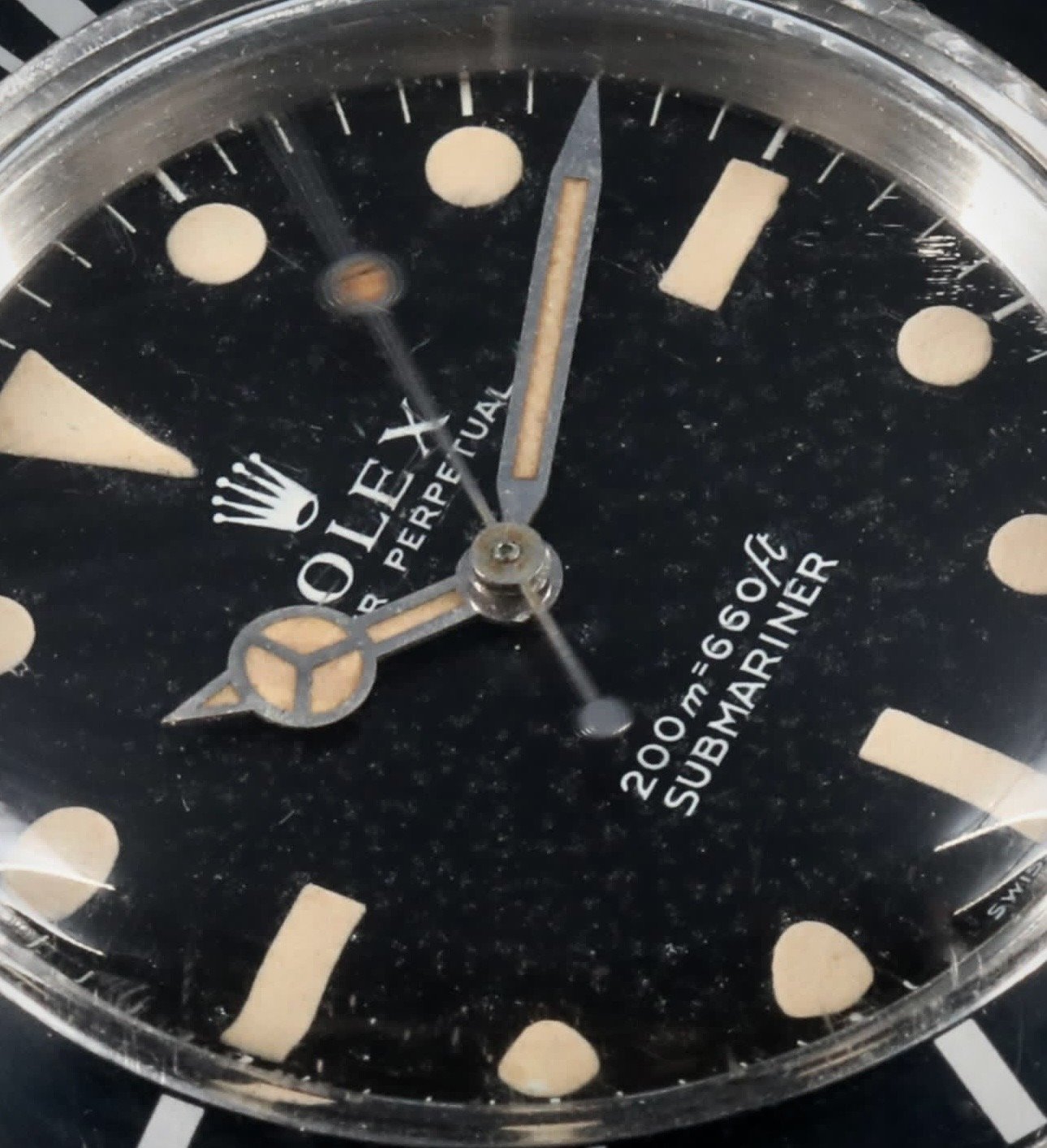

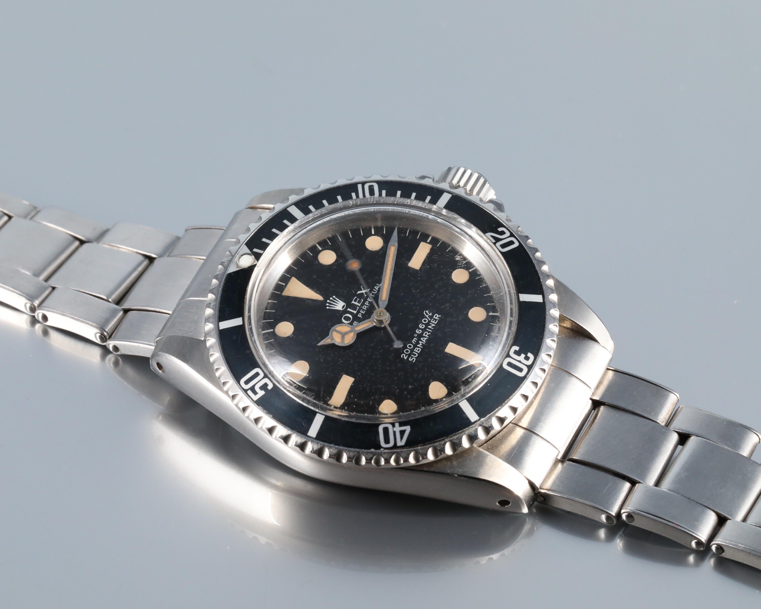

Hello everyone.
I am considering purchasing this Submeruiner 5513 meter first no glitter dial. The dealer (trusted person) assures me of the correctness of all its parts and perfect functioning.
He also states the slight oxidation of the dial.
Having seen the photo, I wonder whether the watch was flooded in the past and above all how much this would affect the assessment of the watch even in the event of my future sale of the watch.
Thanks for your thoughts on this.

That is not common for a MF 5513, in my experience. And judging by the lug-holes, the case is also badly polished. It appears that someone has jammed a later luminova pearl with metal surround into that bezel. Unless it's very cheap, I would look for a better one.

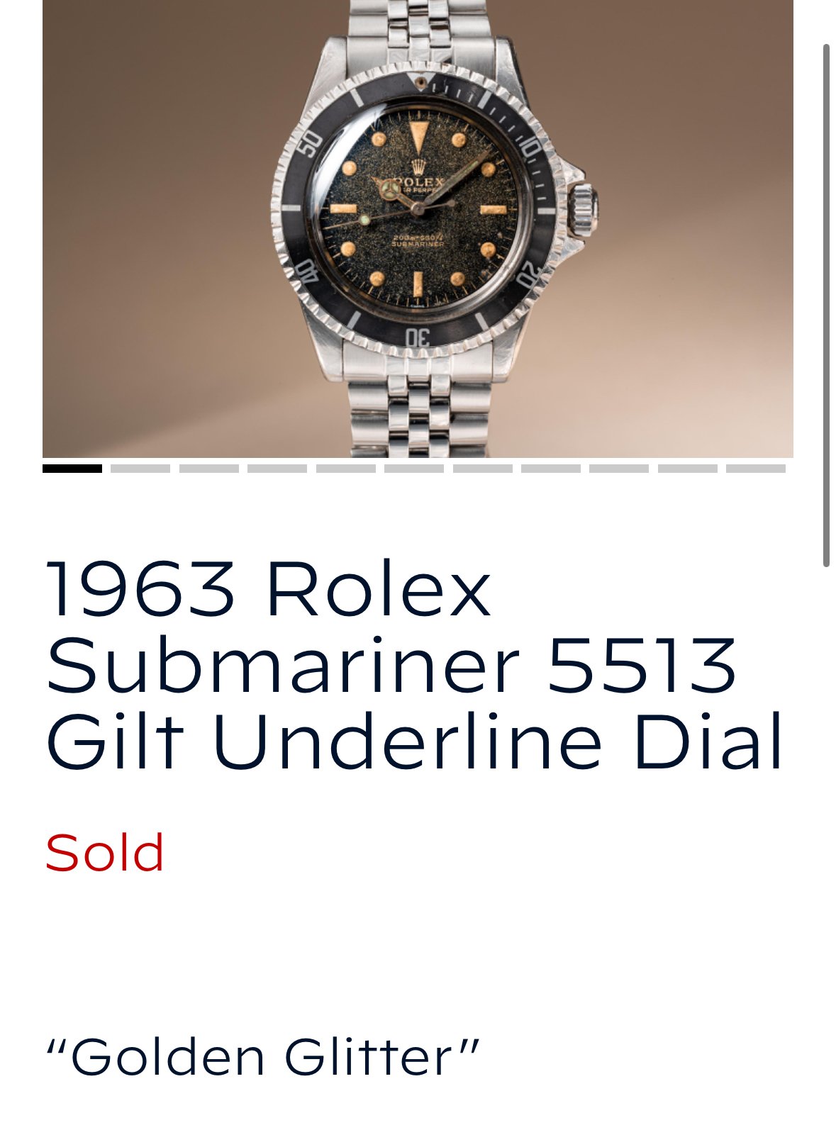

What is a "no glitter" dial? I've never heard of that.

Flooded no. Moist maybe.
My question too. Though, I suspect it’s a dealer hype word/nickname.

Actually … Lets do this right. If you want an assessment, let’s see the watch in its entirety. Bracelet, full view, all angles, SN (remove bracelet), movement shot. If your dealer is not willing to provide this … walk away.

Glitter dial = GILT DIAL.

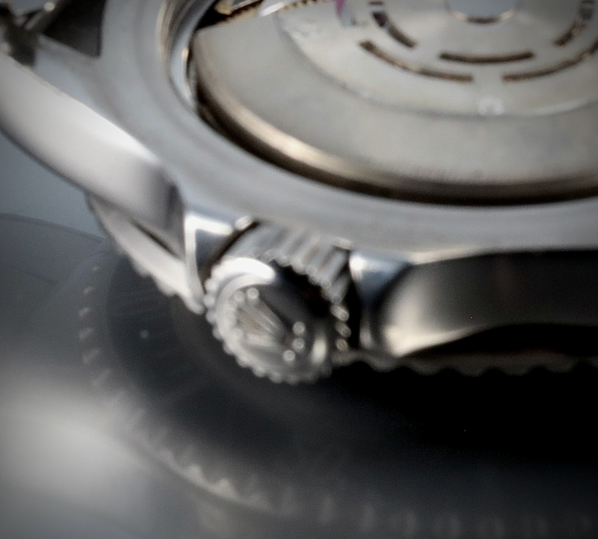

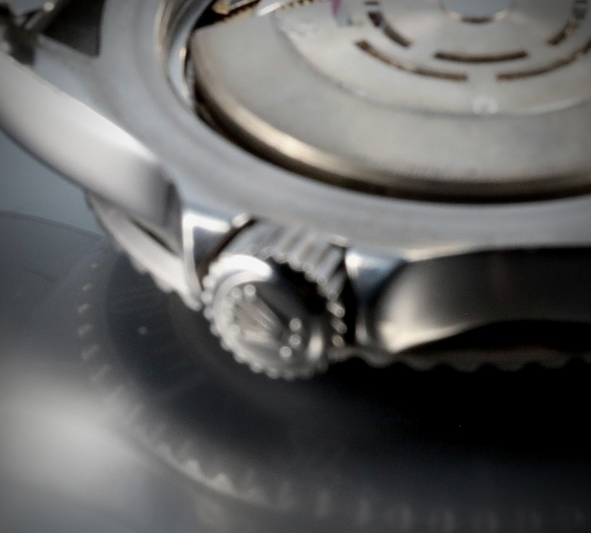

Do you mean the three dots on the winding crown? Shouldn't there be? Because from the photo I see that they are.
519
972
Yes.
As a condition affecting the valuation of a wristwatch, the state of the watch is important, right? Additionally, the presence of original parts from the time of purchase also affects the valuation, correct?
Therefore, if there are three dots on the crown, it's likely that the crown and tube were replaced during servicing.
A crown without dots represents an early model, while a crown with dots indicates a later model. It's said that around 1972, there was a switch to the later type of crown. Therefore, the original crown of the 5513 Meter First is of the type without dots.
