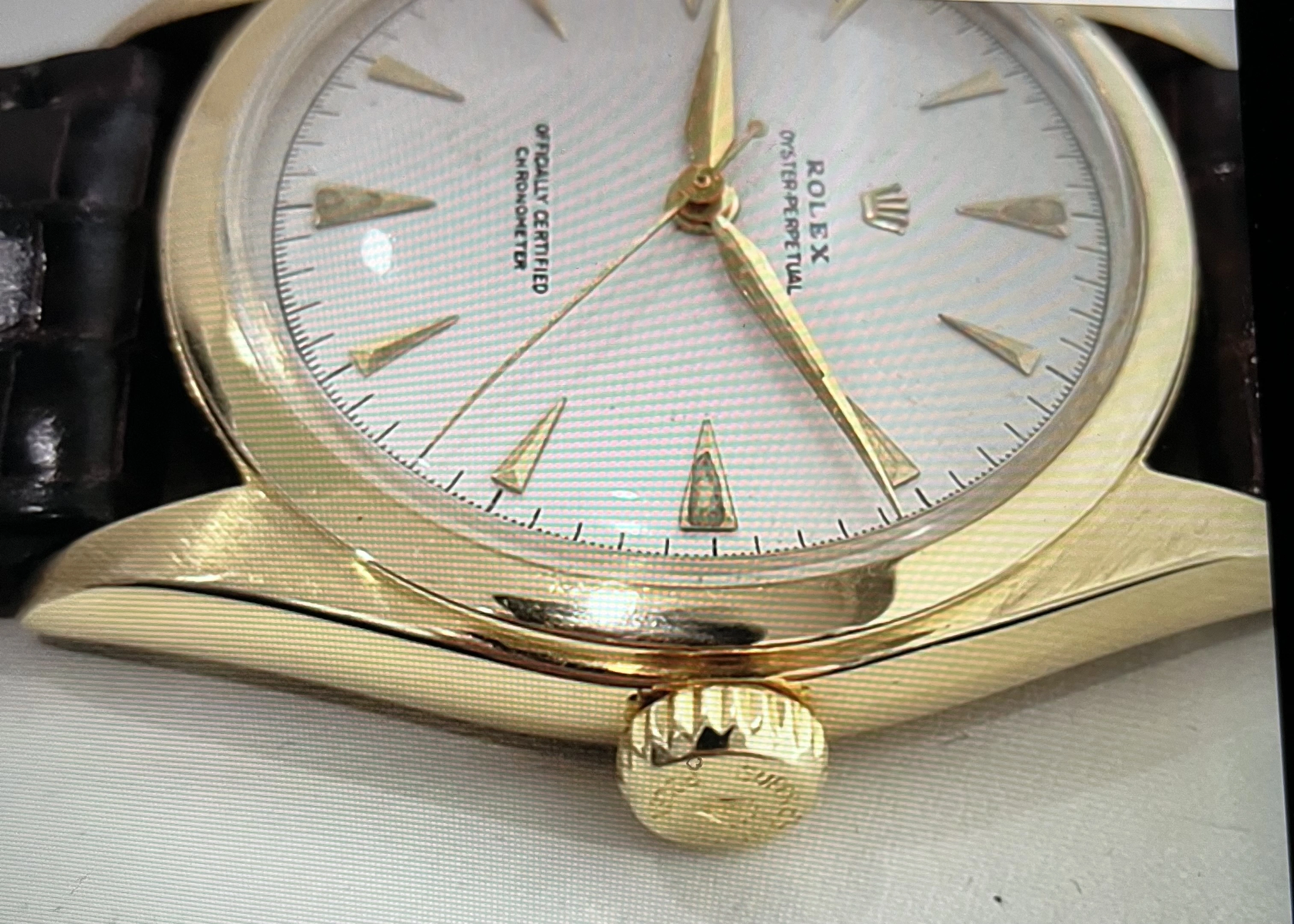

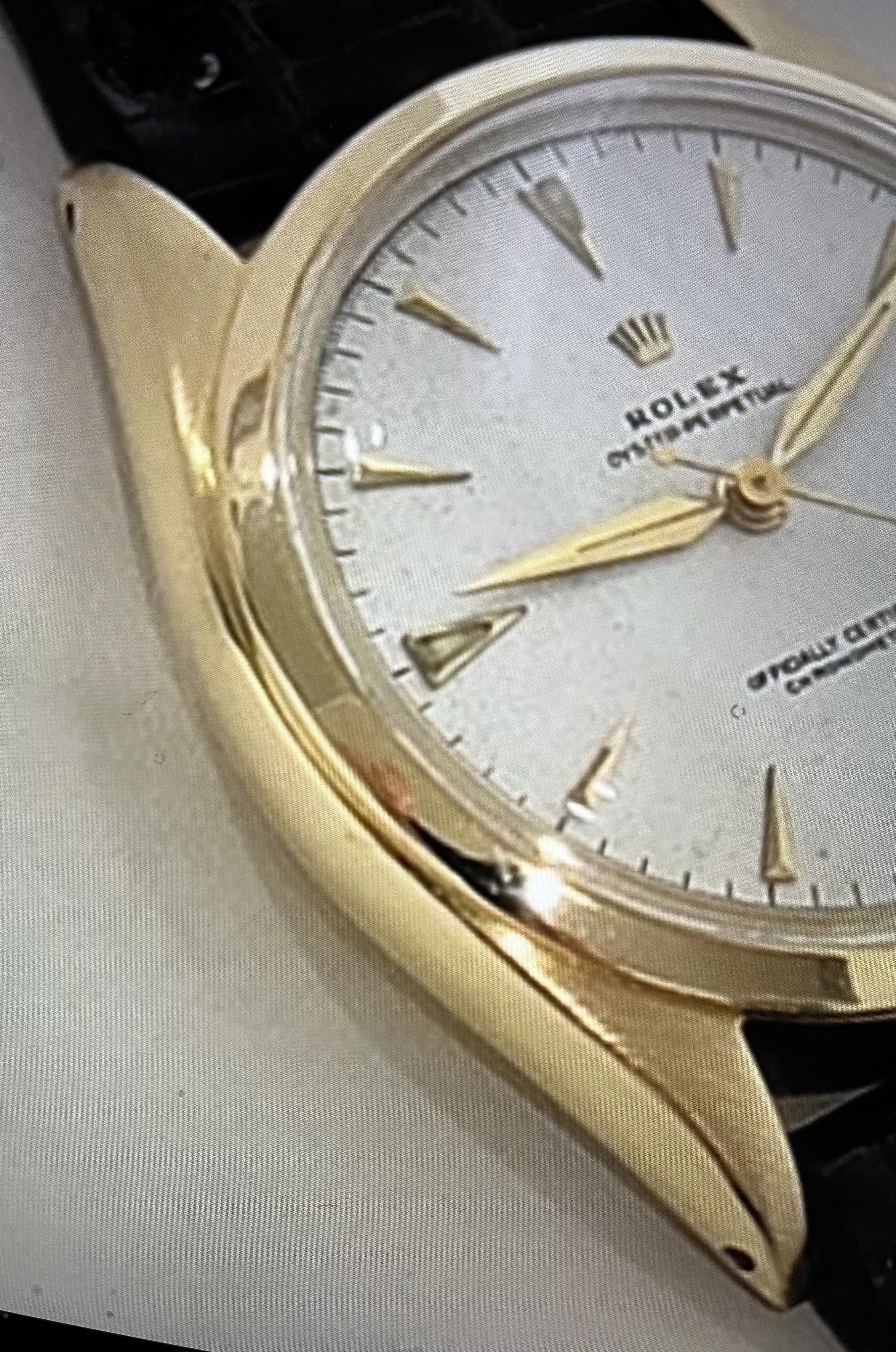

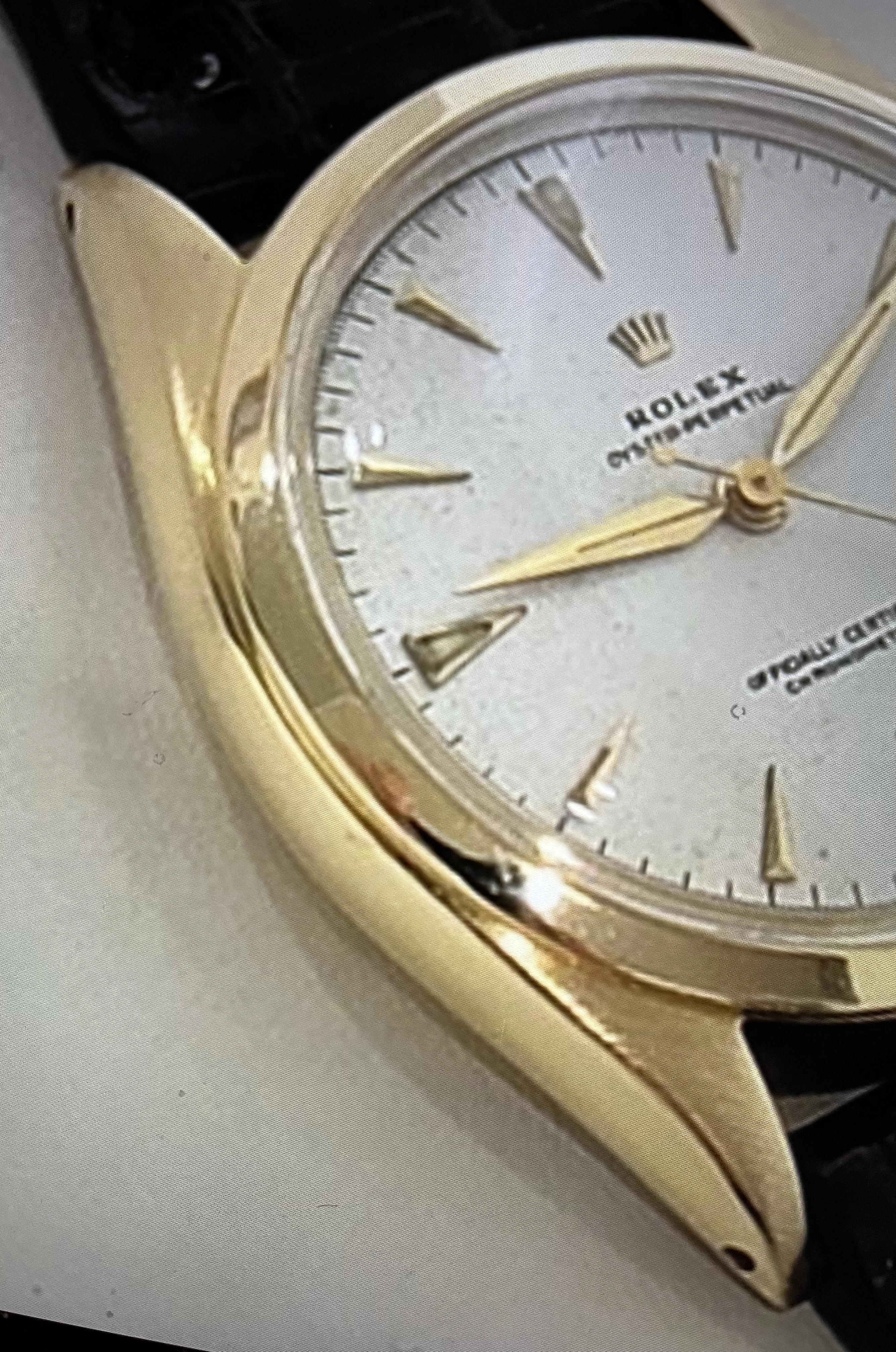

You can see in the pics below that one side of this watch has pierced lugs, the other closed:
What would be the correct spring bar for this set-up? And, with removal, would you undo the pierced side first, and the same for installation? Or the reverse? Thanks for any insights

Shoulderless spingbars will work, for drilled lugs like yours. You only need to push in one side, from the outside, with a standard pin tool and pull on the strap to release it.
Putting it back in ; first place the springbar in on the closed side, and then scratch the hell out of the open side when pushing the other side in....
better use protective film or tape on the inside lug. Uncle US or forstner sells those.

Thanks, much appreciated.

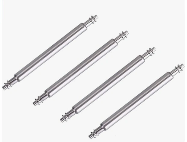

I’d use these. Eliminates any doubt about which side to use when removing the spring bar.
7,202
23,356
Many thanks.

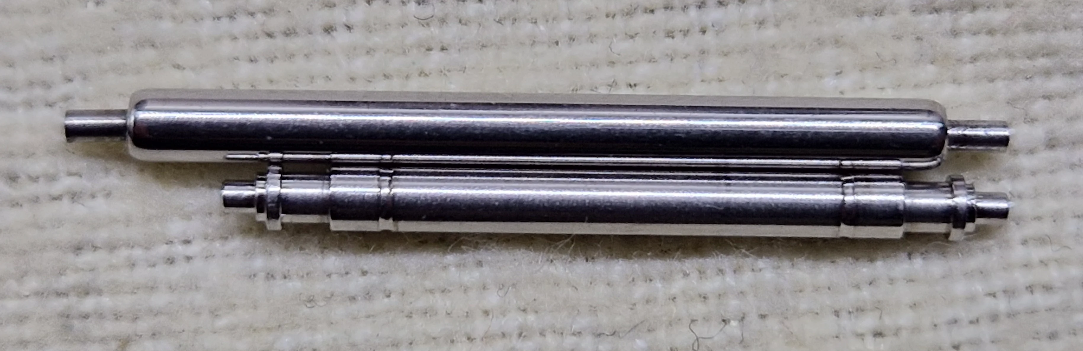

I was thinking about that. In other words, even though the drilled hole side has the capacity to accommodate a longer spring bar tip, how much is necessary for a stable fit? I haven’t measured it, but what would be the guess on the typical depth of a non through lug hole? If most shoulderless bars have a 2mm tip, I’m seeing that bars designed for closed lugs have a typical tip of about 1.0mm, and thus the depth of the hole must be just beyond that on the closed lugs?

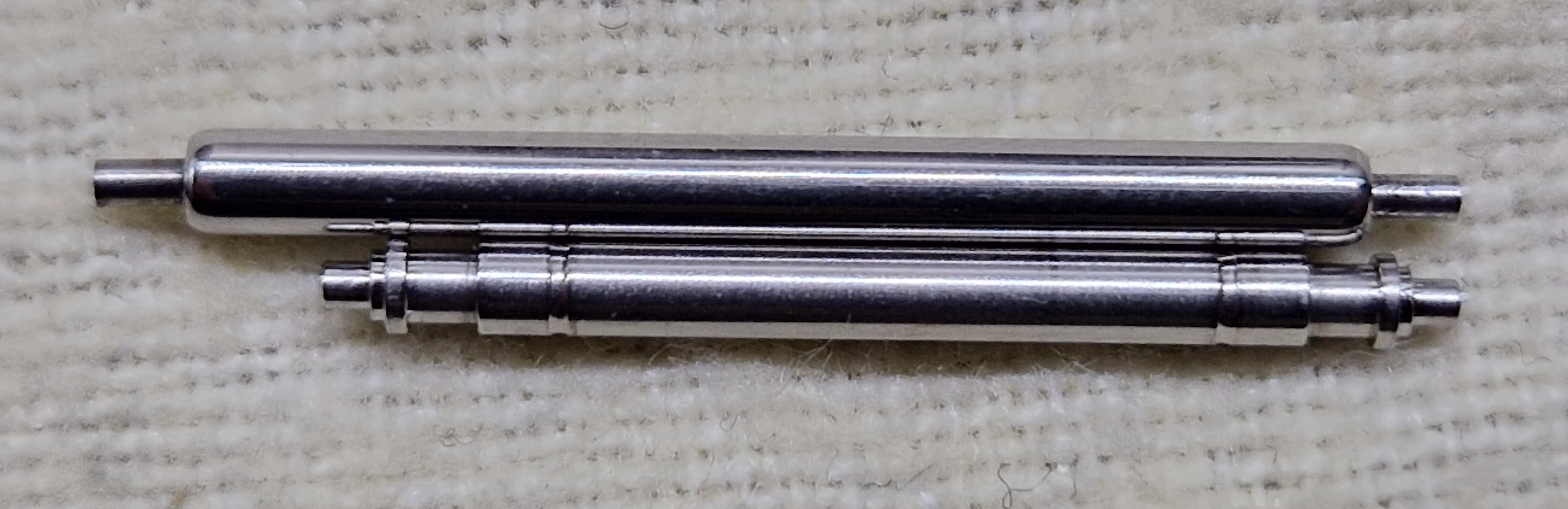

For comparison 22mm schoulderless (Panerai) vs Omega 19mm 068ST2206;
1,603
3,288
Correct , and @YY77 picture is a great example.

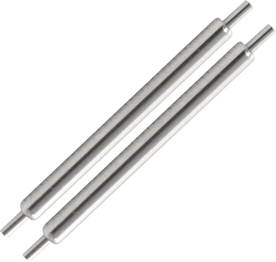

Curious thought experiment:
If I installed a strap on a watch without drilled lugs using these. How would I remove them?
Drilling out the bar.
