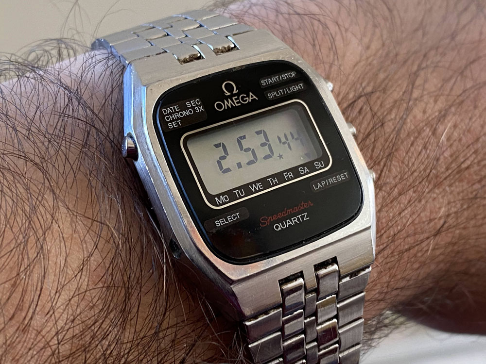

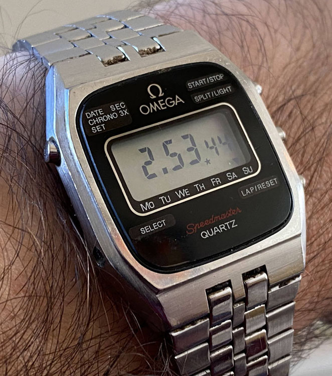

An old dream came true when I finally got hold of a lovely little digital Speedmaster.
A must have for someone who's grown up in the 80's I'd say.
As it was extremely dirty, so after a quick disgusted wristshot I disassembled it straight away and the bracelet parts went straight into the ultrasonic cleaner.
I thought it'd be a wise move to exclude the case though. as it might damage the pusher gaskets and/or the crystal glue (if it's glued on at all?).

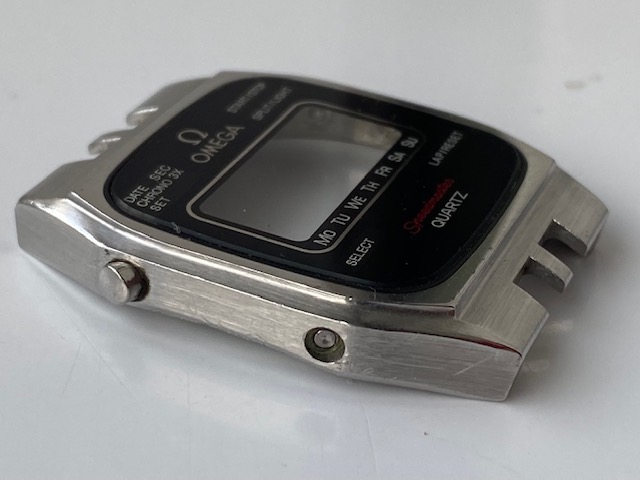

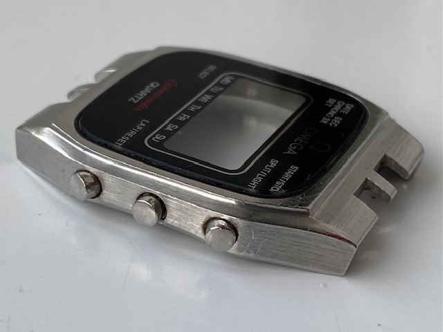

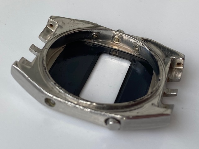

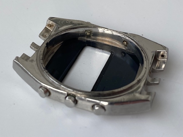

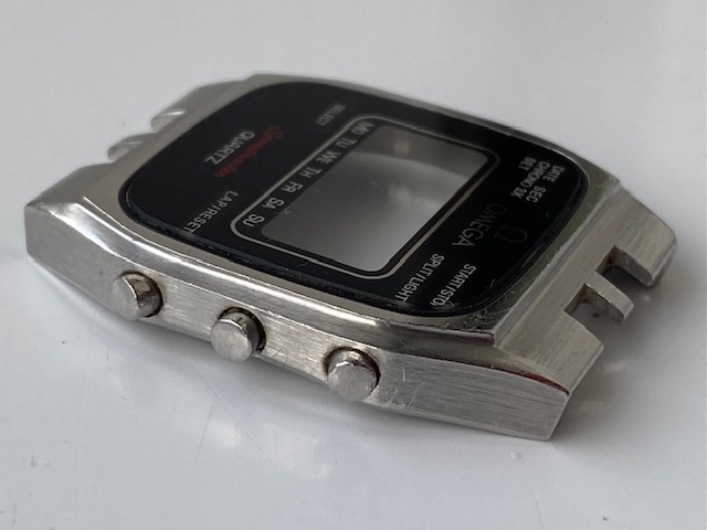

The only thing now is that, with one exception, all the pushers are stuck, no movement at all.
Could that be the grime there too? Or corrosion? Any ideas how to clean them, or get them to move?

It may be something you trust to a watchmaker, but to clean up the pushers, you rice the little c-clips on the inside and they come out from the outside of the case. There will be a shaft with a spring and gaskets (o-rings).
Likely they are seized up with crud. They would not likely be corroded, they are stainless.
It's easy to lose the c-clips, so be careful.

My recollection is that these are units that are pressed in and out in their entirety. They are not meant to be disassembled, and there are no c-clips. The crystal could be removed and the whole case put in an ultrasonic bath to see if the pushers will loosen up - it can work but new pushers is the best way to handle this.

Well if these aren't the c-clips style pushers, then I think you are in to a watchmaker's trip, I'm afraid. Unless you home how to press out and reseat that crystal without damaging it.

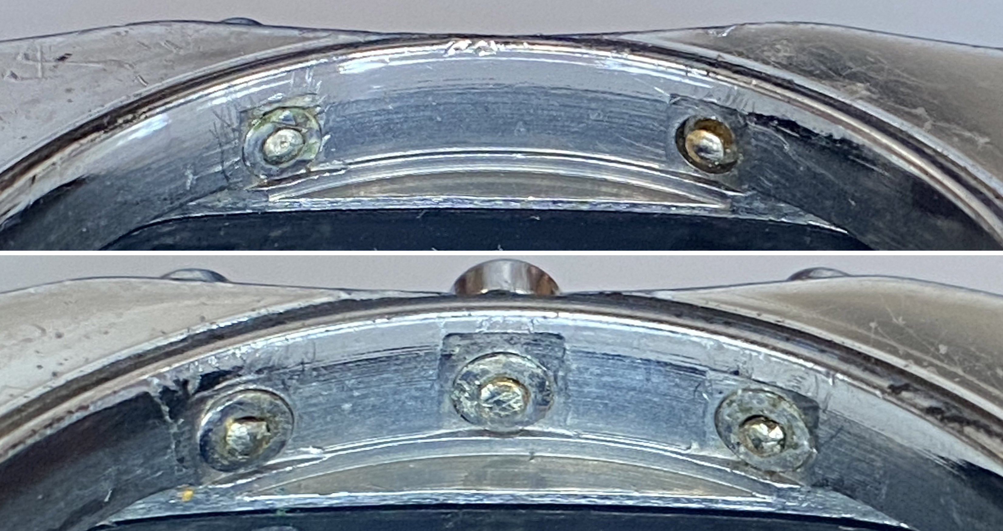

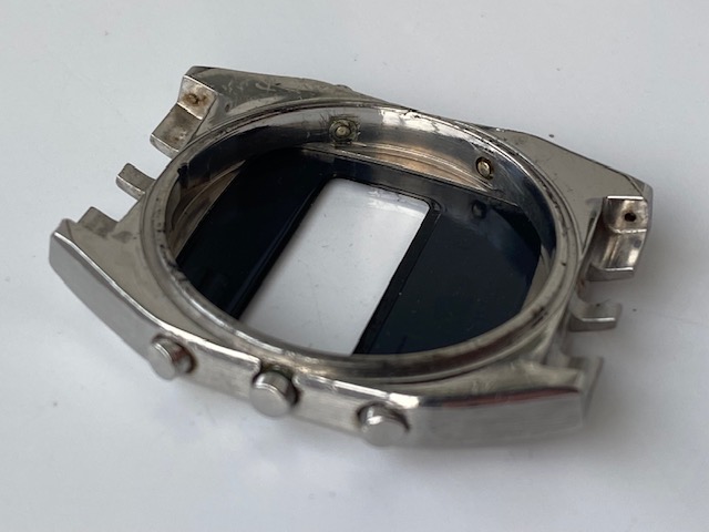

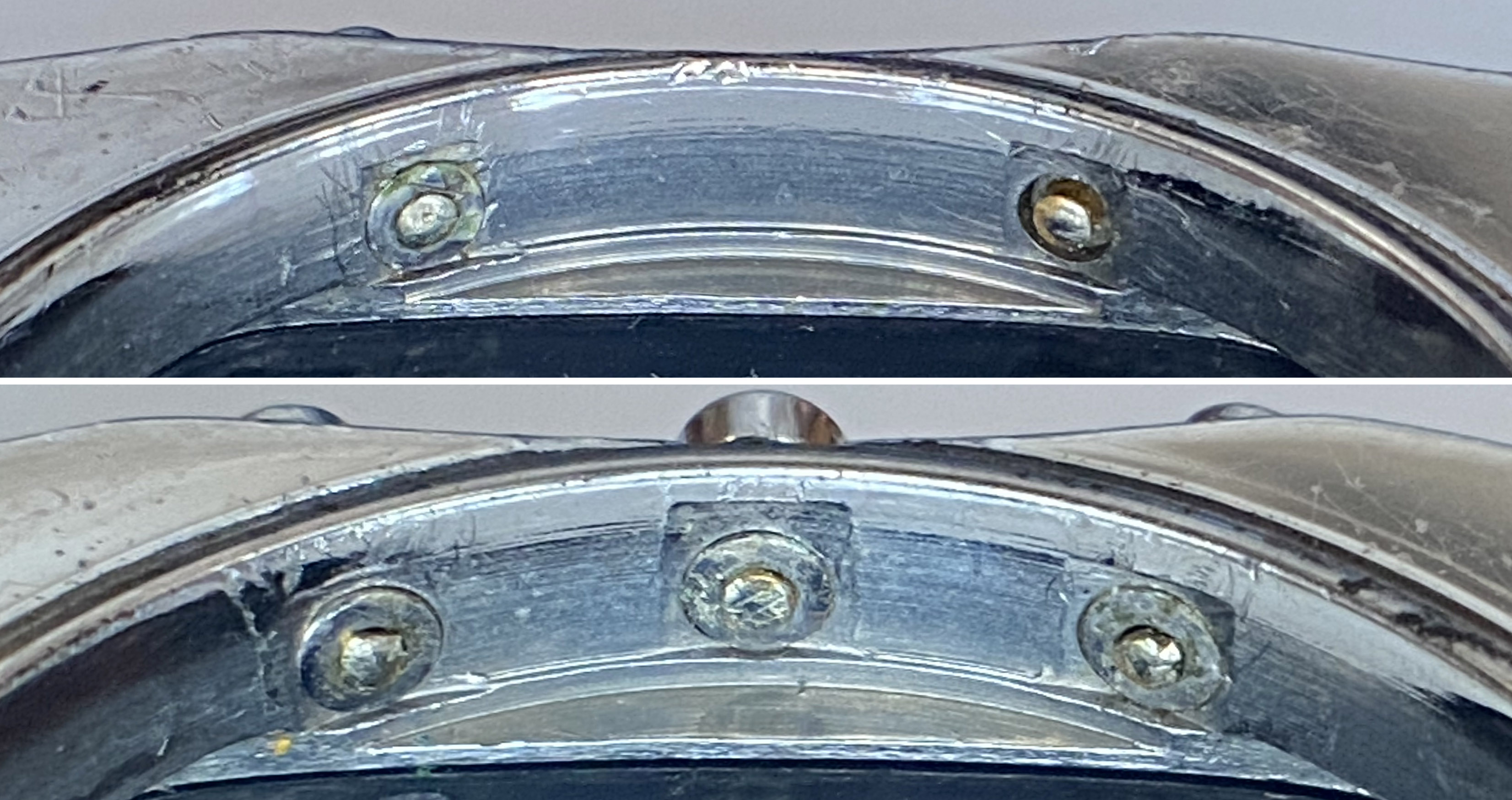

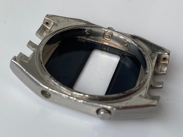

I don't think it's the C clip type, at least can't see any C clips:
So I take it they must be the "disposable" kind?

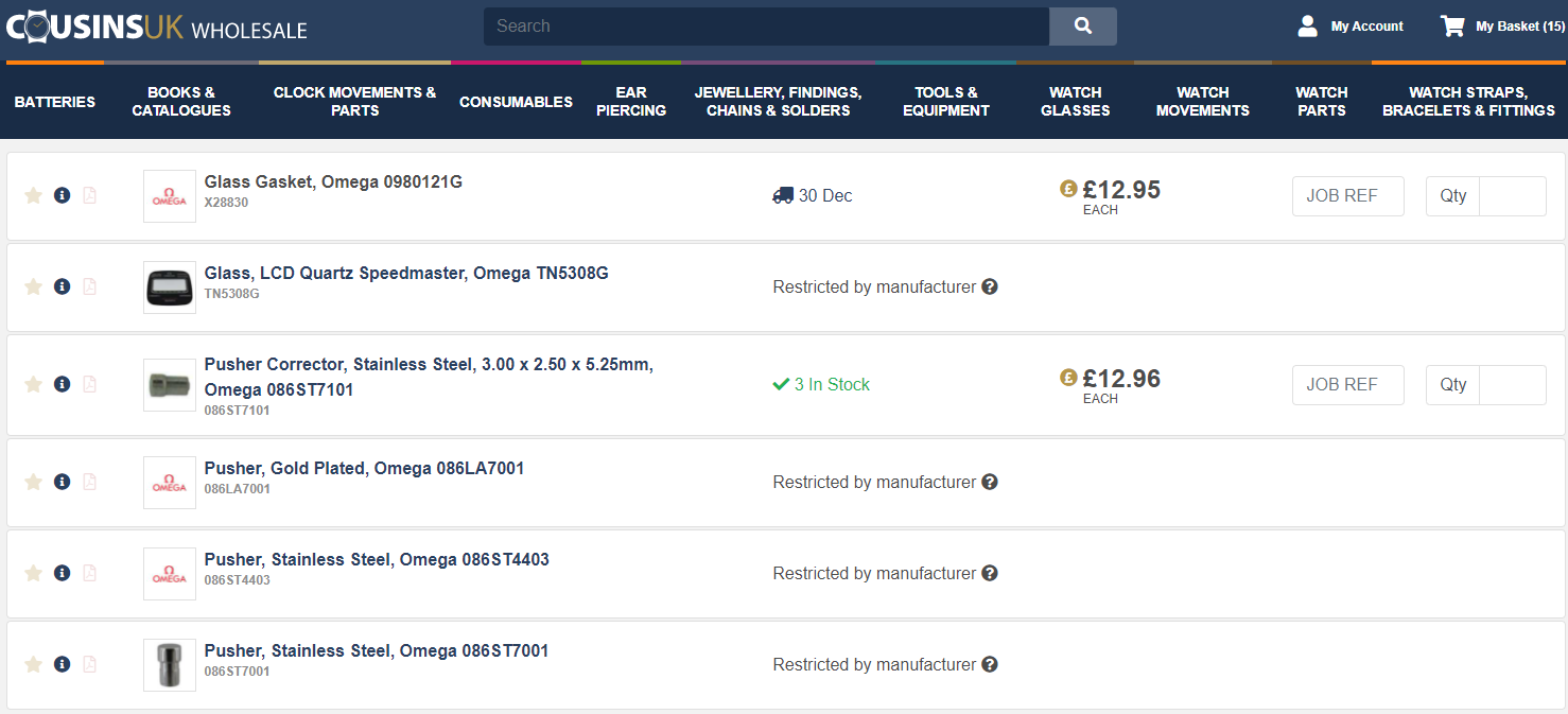

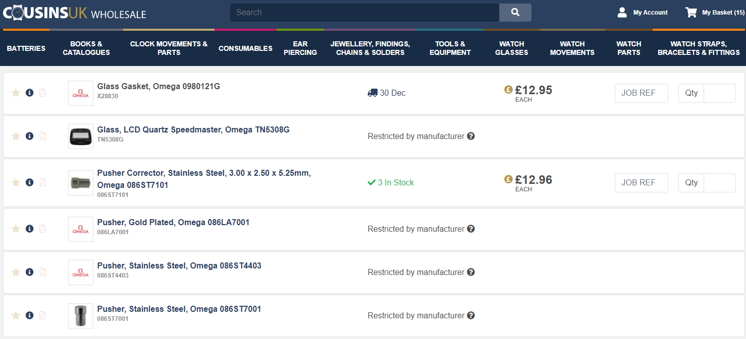

3. Weirdly, Cousins seem to sell the corrector, but the pusher is restricted. I suppose that means i'd need to find a (preferably) UK watchmaker with an Omega account, that right?

I would be extremely careful removing the crystal.
Unless you already know how and have done tricky shaped crystals, I'd refer it to a watchmaker.
I have done one on the Seamaster version (early 1 or 2 pusher model), that crystal came out with the use of a soft towel under the die and a lot of praying.
The pushers aren't really easily removed in a home DIY kind of setup. Real letdown on these models that they can't be serviced by an amateur watchmaker easily.

The crystal is held in by use of a crystal gasket (that is shown in the list of parts from Cousins). It's a hard plastic style that will deform when you press the crystal in. That should really be replaced if you remove the crystal, because once it is deformed, it never has the same holding power keeping the crystal in place if used again.
The crystal would be pushed out from the inside. Once you are done cleaning, then the new gasket is placed into the case, and the crystal is pressed back in. Not uncommon for people who are not familiar with doing this to crush the gasket, so ordering more than 1 gasket is always a good idea. Gasket part number is 0980121G.
