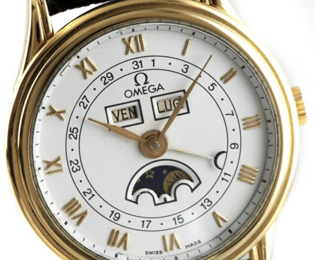

I just took delivery of a beautiful ladies Omega 18k Triple Date Moonphase.
The watch has three pushers:
Top right pusher: adjusts month
Bottom right pusher: adjusts date pointer
Bottom left: meant to adjust moonphase but it can't get it to budge, I can see it rock but not tick over. I did get it to do it but then couldn't again. Does the time need to be in a certain place. (I'm aware of note setting these things between 9-3).
My first question is how do I set the day of the week. None of the pushers change it and manually moving the time past midnight just moves the date pointer and not the date of week.
My second question is, are there any tips on adjusting the moonphase as the pusher doesn't seem to tick it over.
Thanks in advance, Tom

The only way to adjust the day of the week is to move the hands forward, this is standard procedure on these older movements. If the day doesn't change at midnight and if you can't move the moon dial via pusher the movement needs service. It's probably not been serviced in many years.

I've found that letting the watch run itself to the next day without manually winding, the day of week begins to work and continues to work perfectly.
If I went to set the day of week by manually moving the hands and then go to set the date pointer with the gold pusher, and then tried to set the day of week once again it would stop working and it would no longer move when manually moving the hands to the next day.
So it seems there is an order these complications should be set. If you do it out of order you have to let the watch naturally 'reset' itself by letting the clock run over to the next day.
Is this normal or 1. Have I just gone mad. 2. Watch still isn't right.
It really doesn't appear something is broke as when I've set the complications like this
1. Month
2. Day of week
3. Date pointer
4. Time
it works perfectly.
I haven't tried the moonphase again as it seemed right already.
