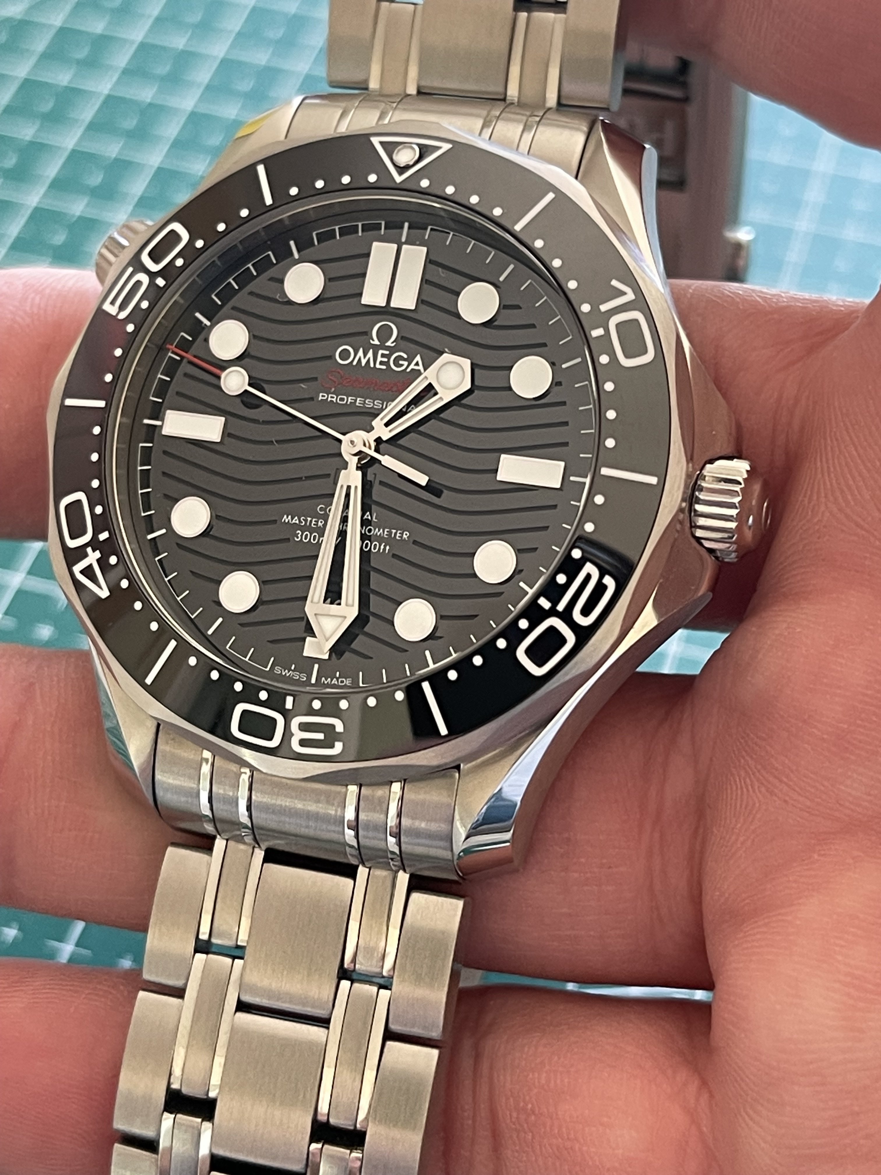

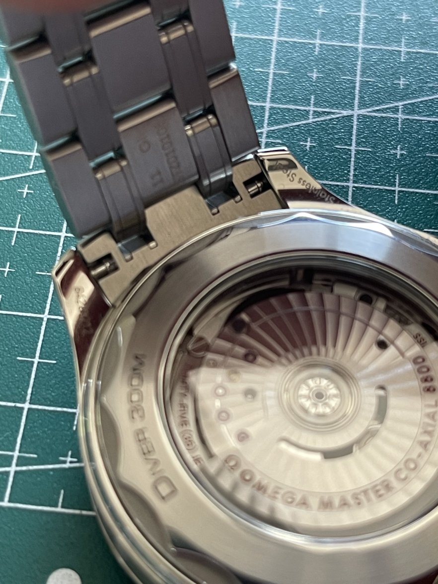

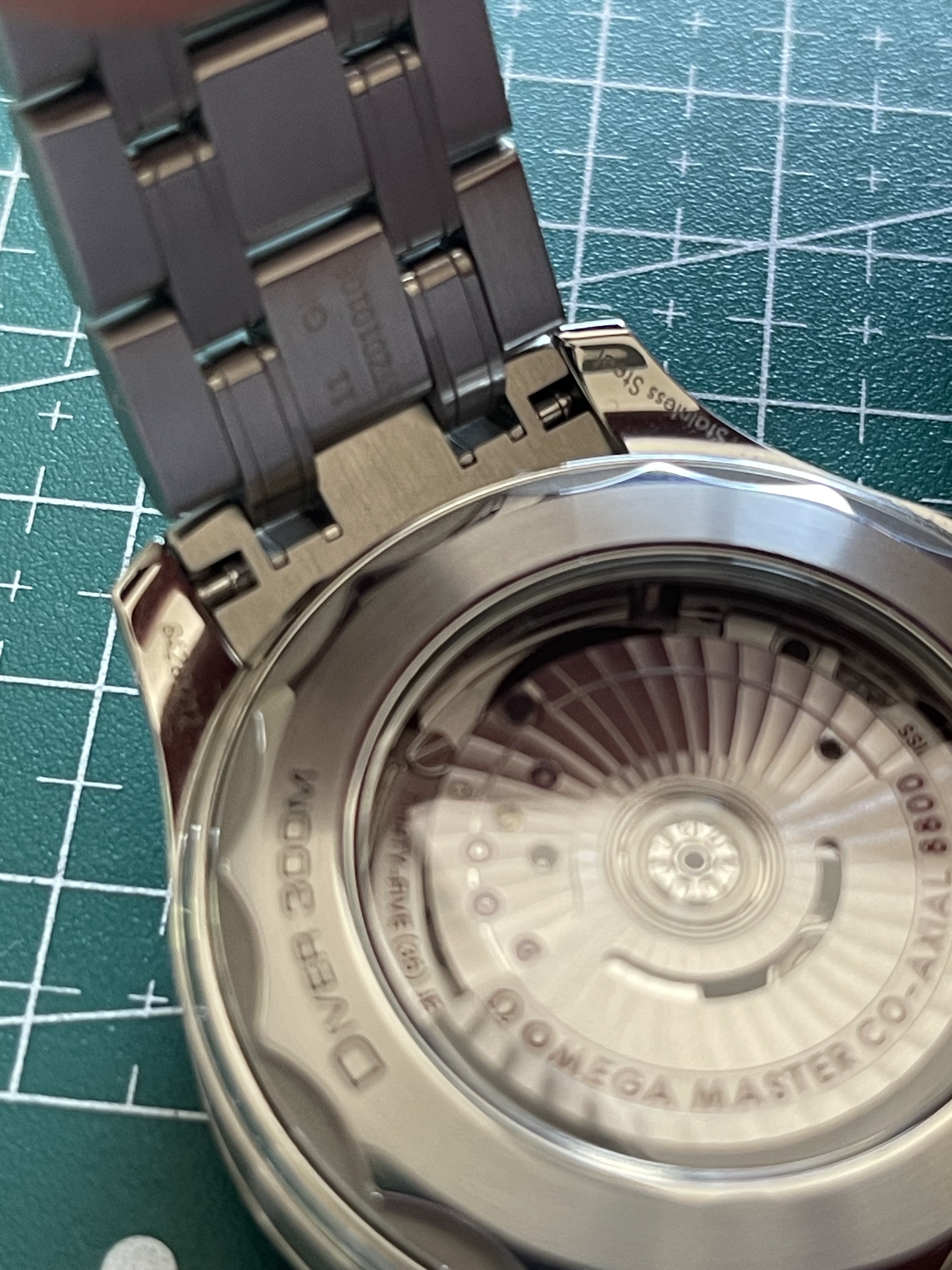

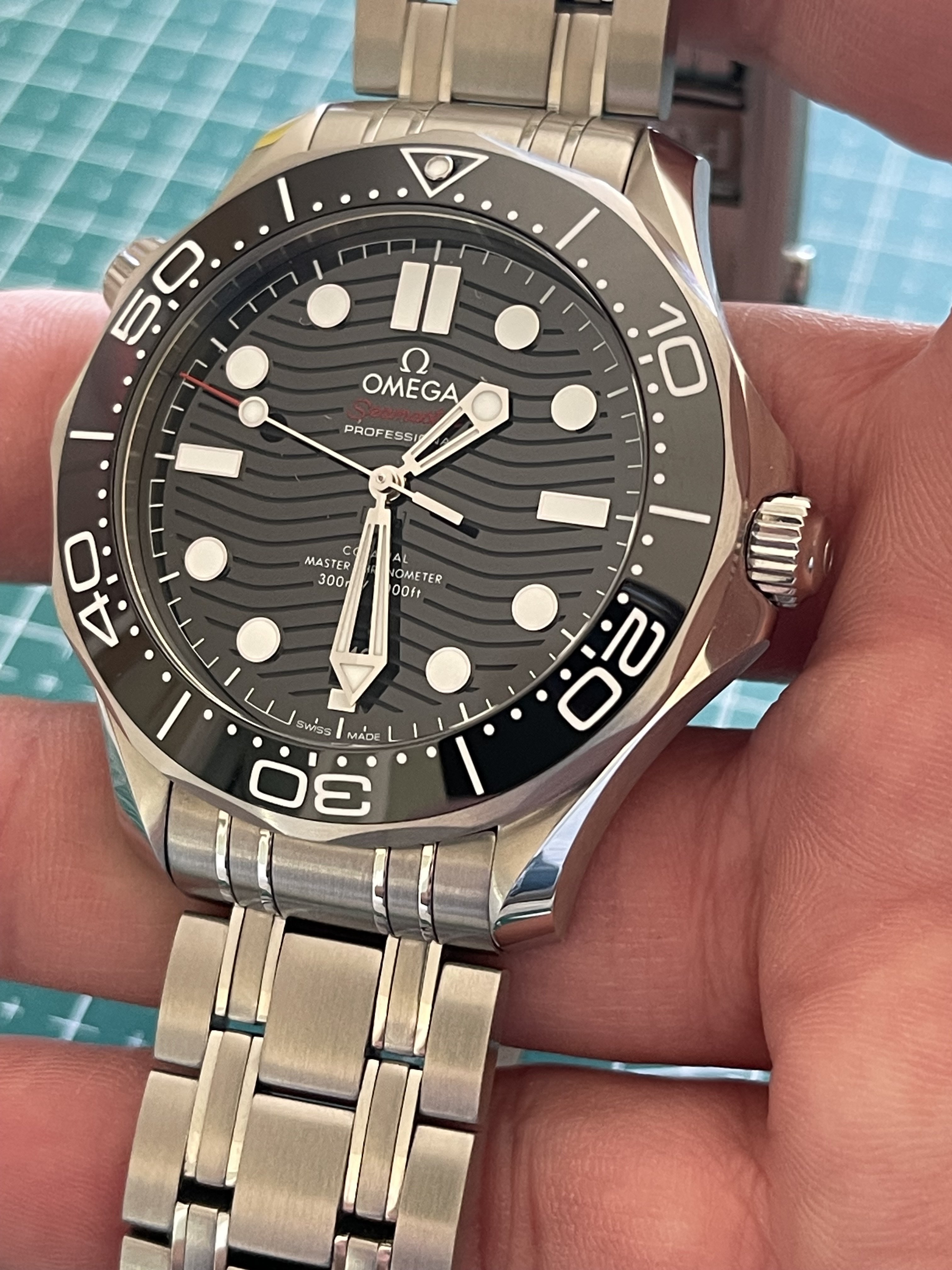

Afternoon OF, is there anyone able to shed a little light on some questions I have, I have tried searching some & found a little of the answers confusing so apologies if it’s already been answered before.

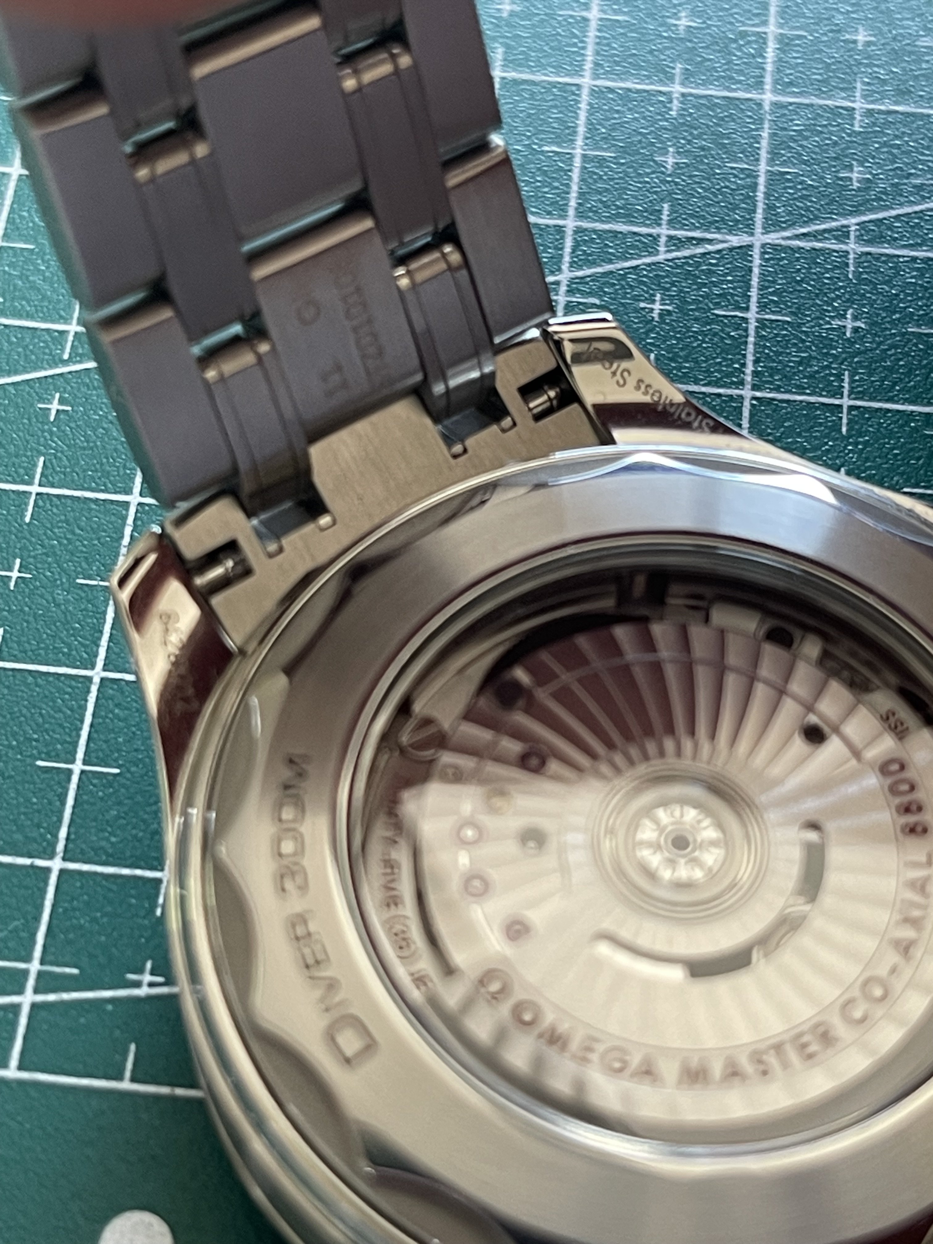

I have recently purchased a Seamaster pro 300m with the s/s bracelet on, however I’m looking at taking this off partially to preserve & wear on dress occasions. I am on the market for either a rubber strap & a nato one, some mention that I might need to additionally purchase curved pins? Can I not use my existing pins in the s/s one? Also any advise where to purchase them from as I have heard of crap ones that come out. Also what size would I need? 20mm pins? I’m assuming this is a fairly easy straightforward job, I have Bergeon spring bar tool & a set of Loupe’s to help.

Springbars (068ST2207) for the SS are shorter too make them fit between the lugs in the endlinks, you would want to check with your AD/OB to get the 068ST2208's ($£€4 a piece).
