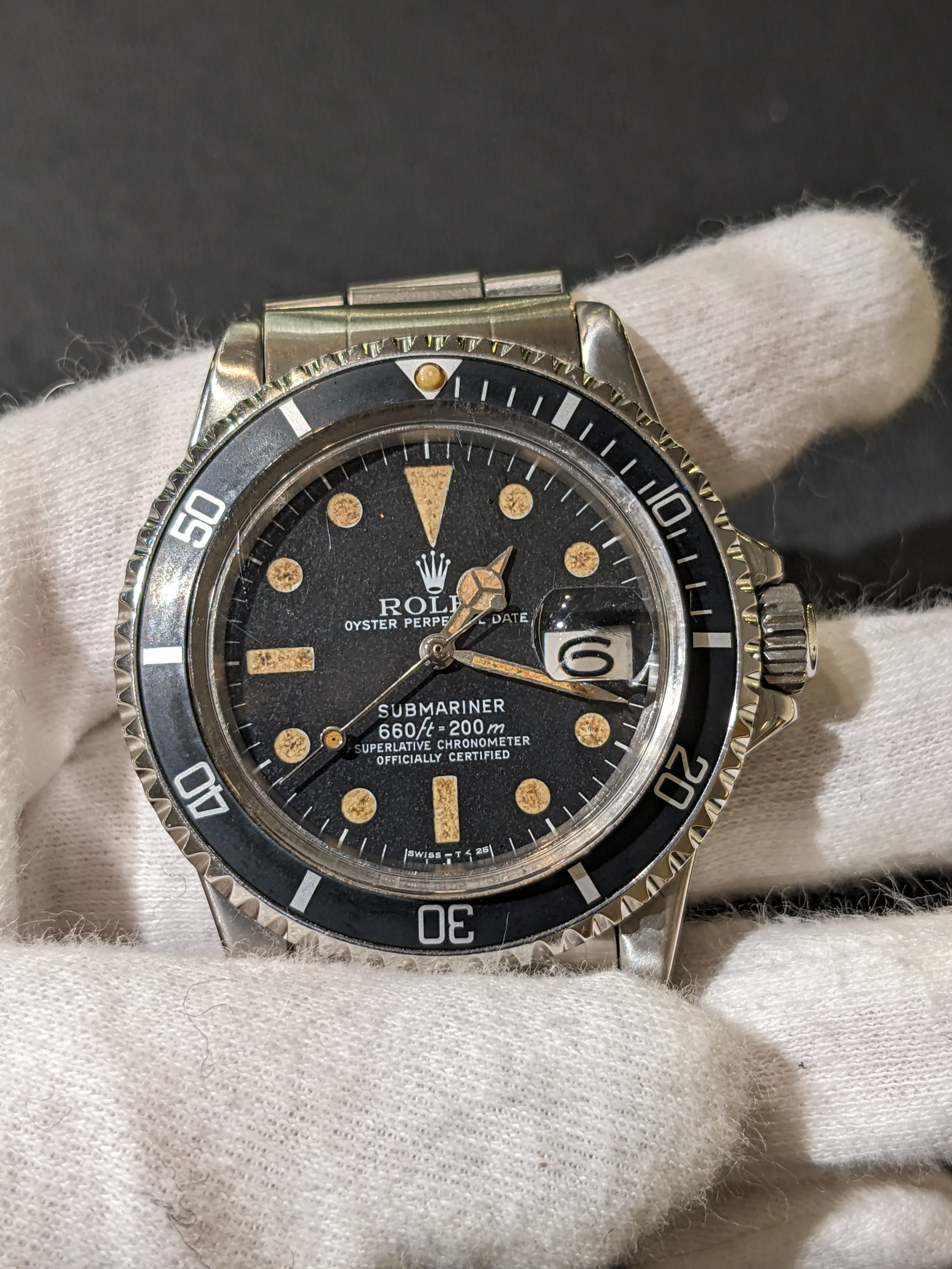

I have bought today this Sub (1972) from a reputable Auction House . However, when I look at the photos of the dial, it seems very granular. The watch specialist at the auction house assured me that the dial was never repainted, but why is the black so odd ? Any ideas / siggestions , please ?

Most likely the dial had contact with water / moisture at one point of history, which can end in that „grainy“ look on the dial.
Can you provide a closer picture of the dial?

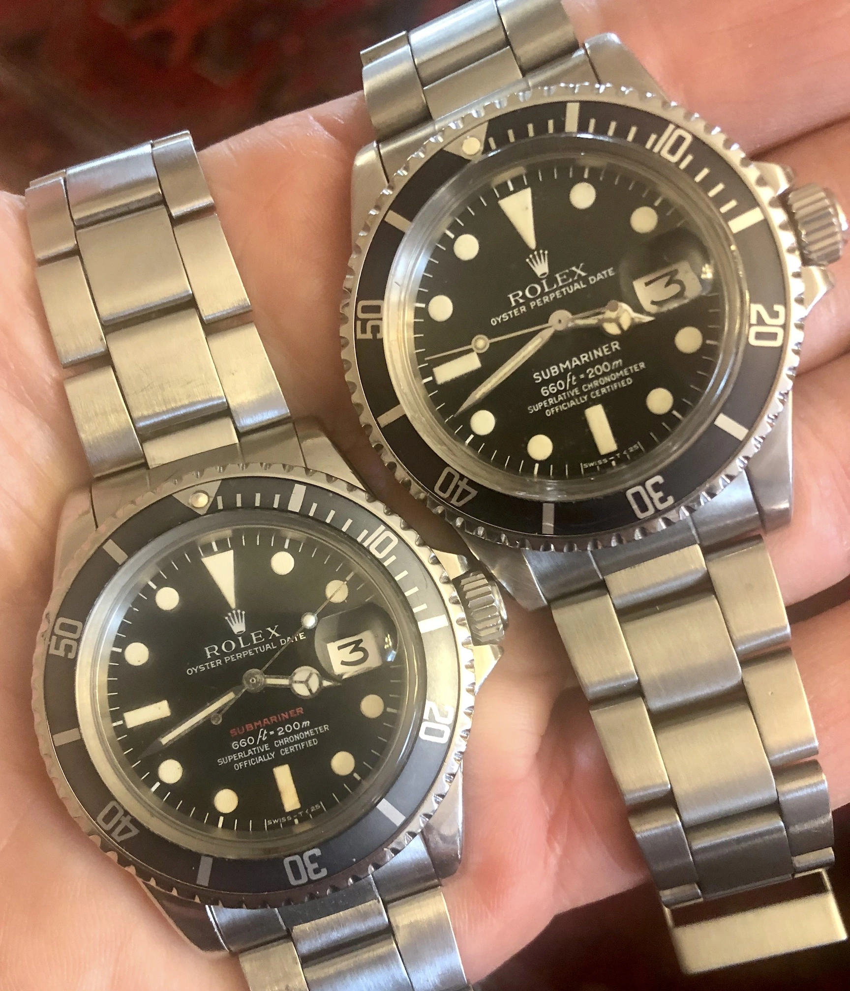

It should be red anyway isn’t it? But indeed water damage

thanks very much . These are the best images i have . Obviously harder to see thruogh the glas . I am relieved , my nightmare would be if it had been repainted. It's a death sentence !

You are right, the white Sub was introduced in 1975, before that it was the red sub.
So most likely the dial has been replaced.

The first white sub was the Mark VII dial and began around the 4M serial range, so 1975, it won’t be a ‘72 for sure

ok , so the consensus is that it is alater dial . What a shock. And the hands too ? because they they have the same patina. Any idea how old this dial could be ?

OK, thanks Littlemej ! So it is MK 3 dial , if my eyes are correct?

It is a later dial, added during a service most likely, with damage to the lacquer layer. At first glance, the bezel insert also looks substantially later, and probably a service insert.
