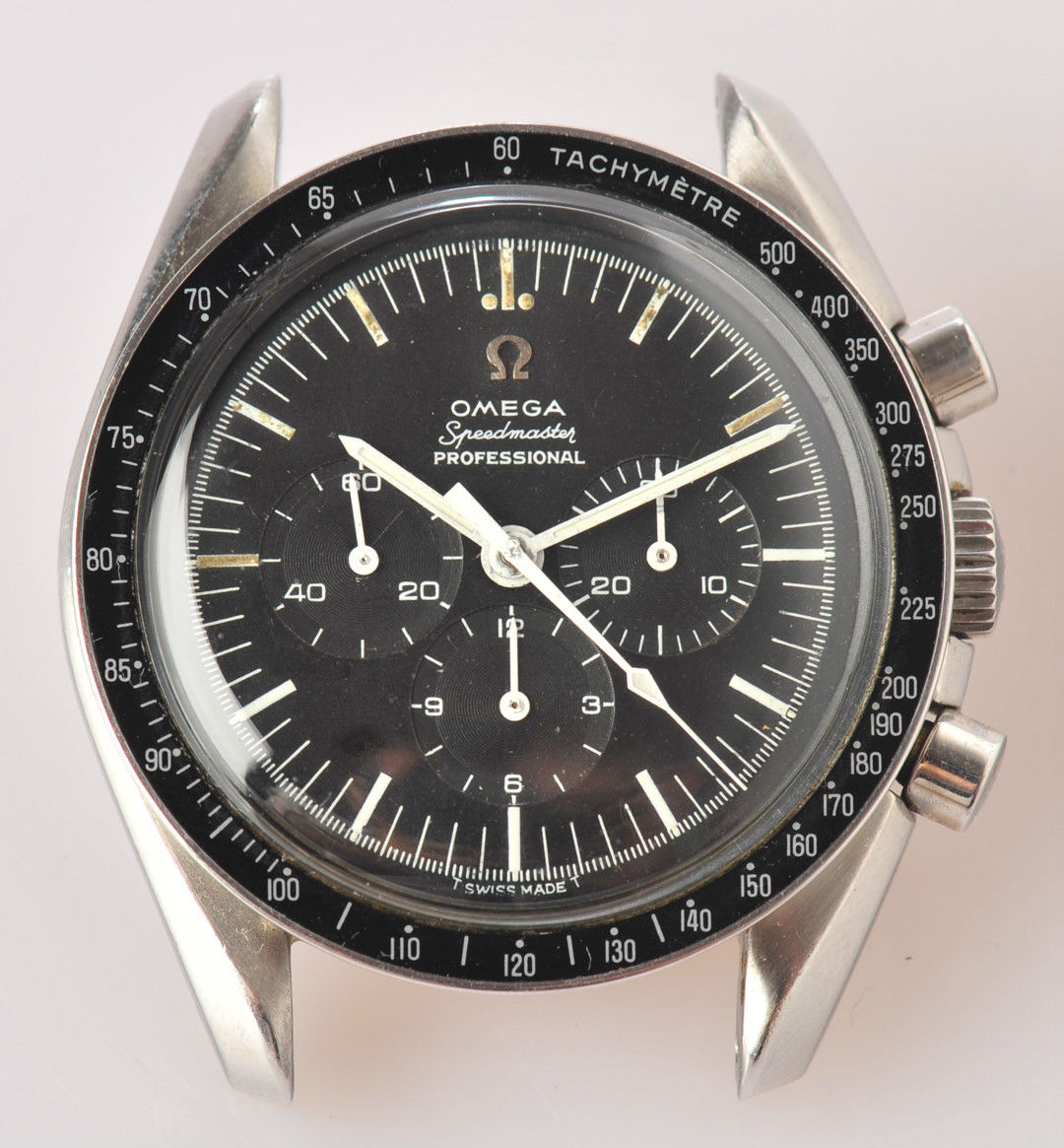

    just found this on ebay.....look at the T's ::confused2::
  2. Banner Roar Jun 26, 2016
    1,011
    2,580
    Loads looking wrong here to me......walk away. Dial looks much younger. Speedmaster 'S' is a much newer version. Wonky "T"s looked added. The applied omega symbol is not straight .......etc etc..
    plexyforever likes this.
  3. plexyforever Jun 26, 2016
    238
    683
    ... it is not a step dial ...
  4. gemini4 Hoarder Of Speed et alia Jun 26, 2016
    5,855
    16,579
    The T Swiss Made T looks very strange but often times the curved edge of the crystal distorts this inscription. Need to see it from other angles or dial removed from the case. The step is also difficult to see at some picture angles. It's also possible that the dial is a old service replacement and has no step.
  5. plexyforever Jun 26, 2016
    238
    683
    ... short indices, not long. Not wide t swiss made t, Omega and Speedmaster writing is not right: I woudn't want that dial for my -68 transitional (the insert too):)
