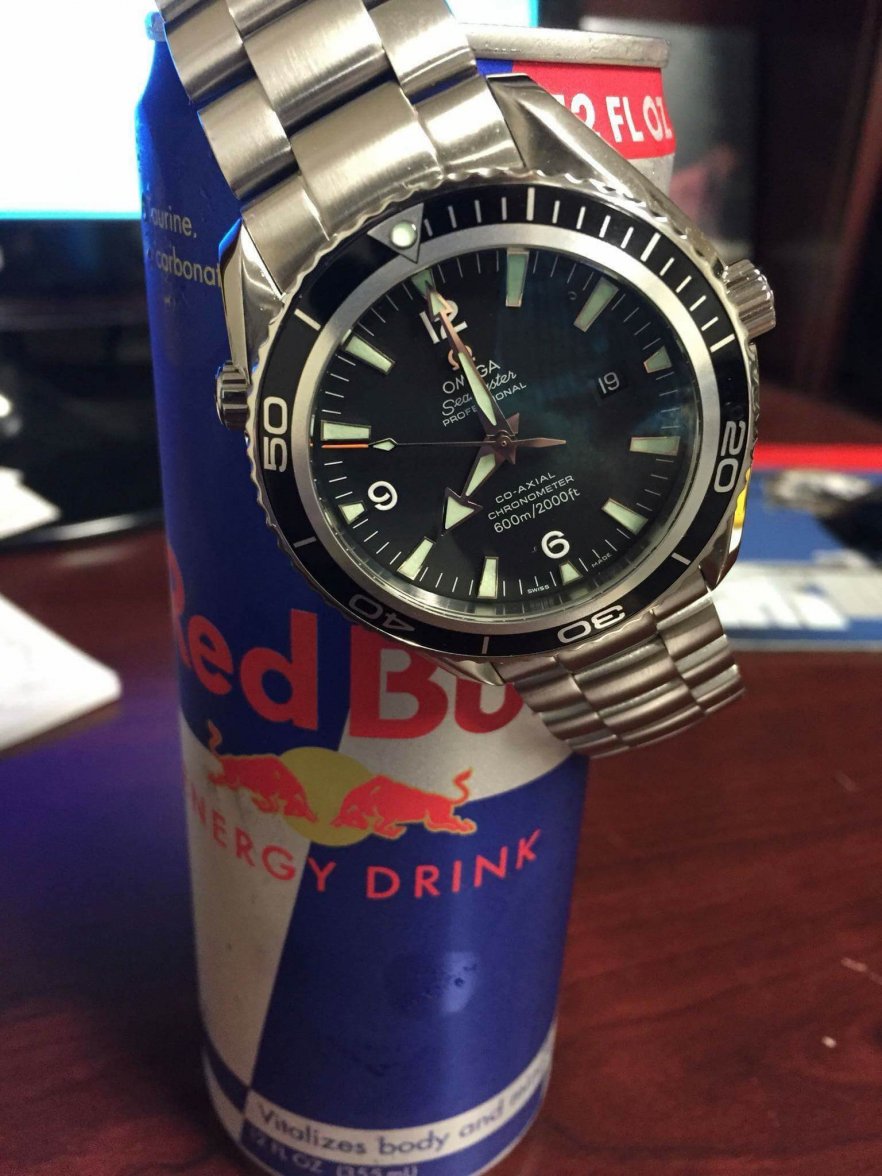

    Attached photo is of the Planet Ocean my friend just acquired.
