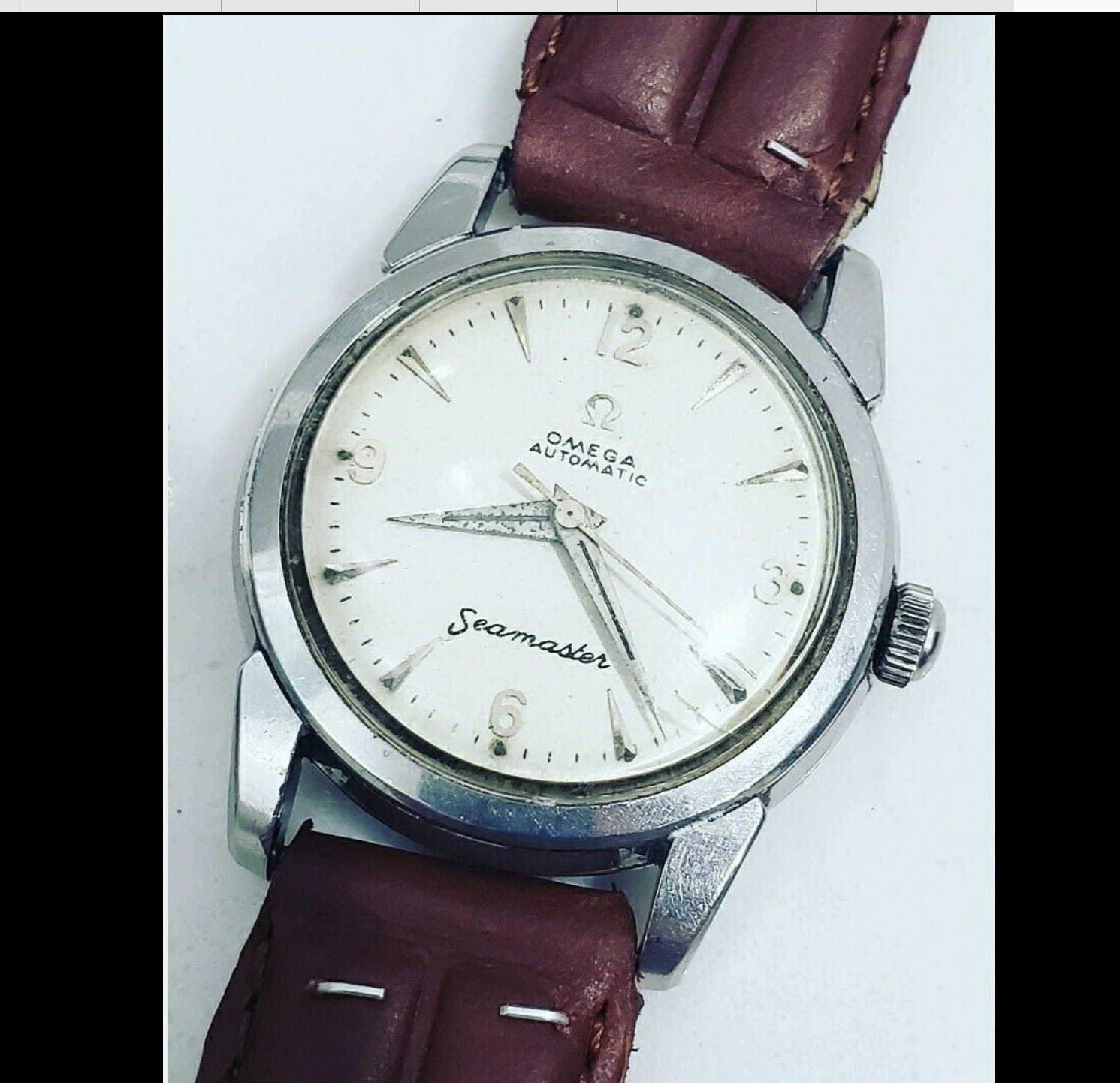

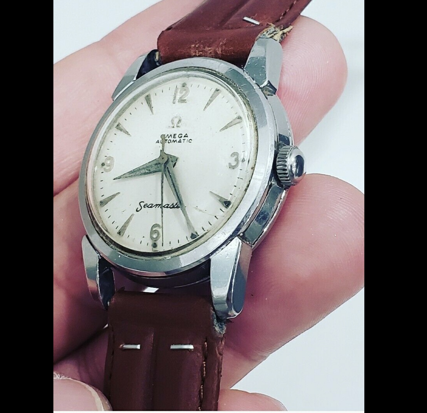

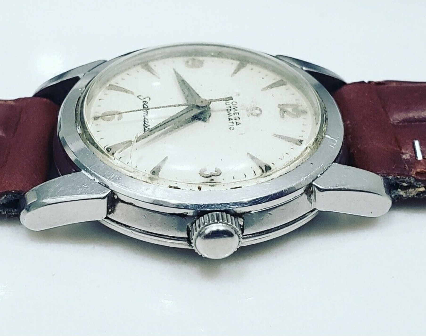

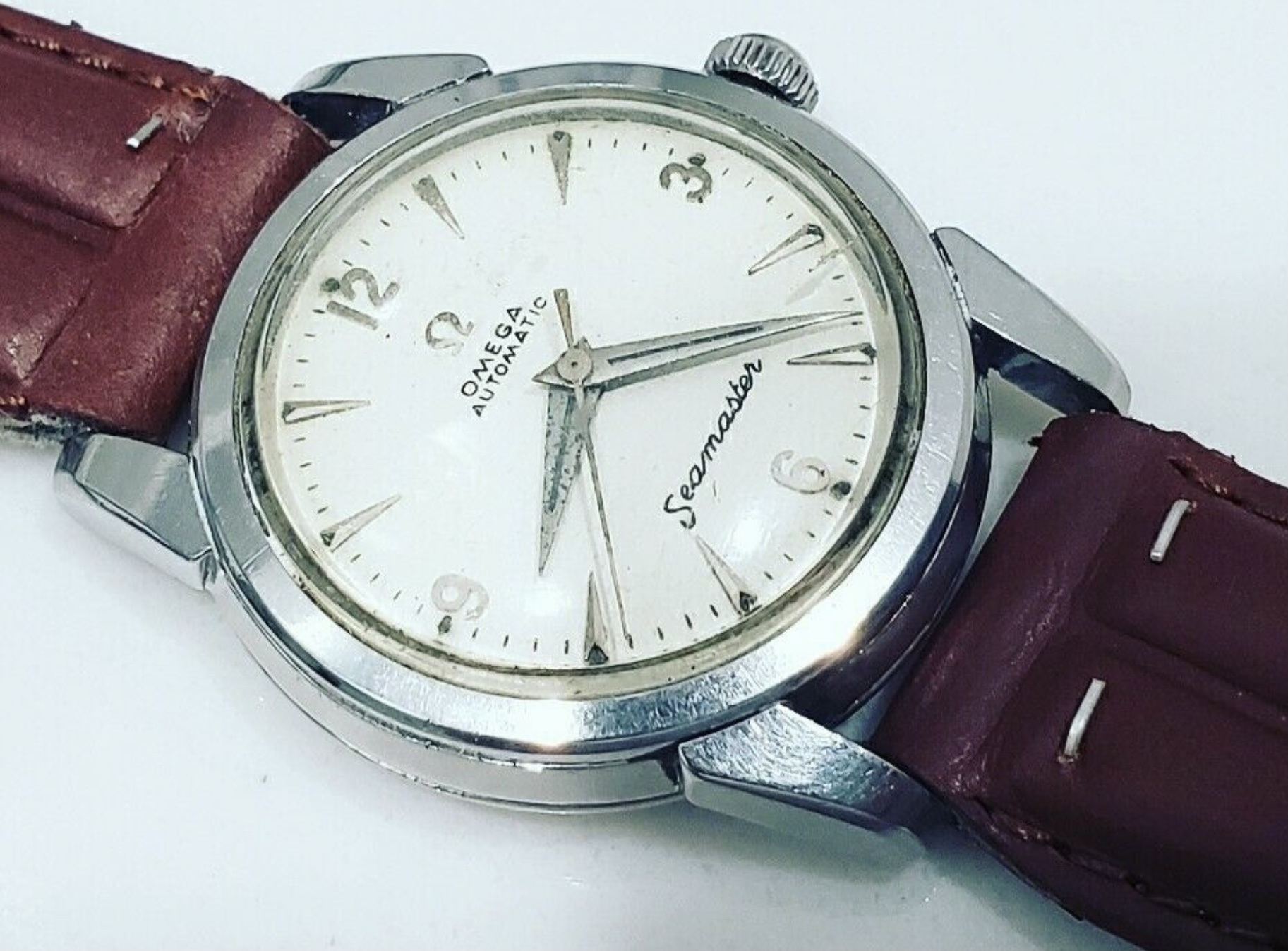

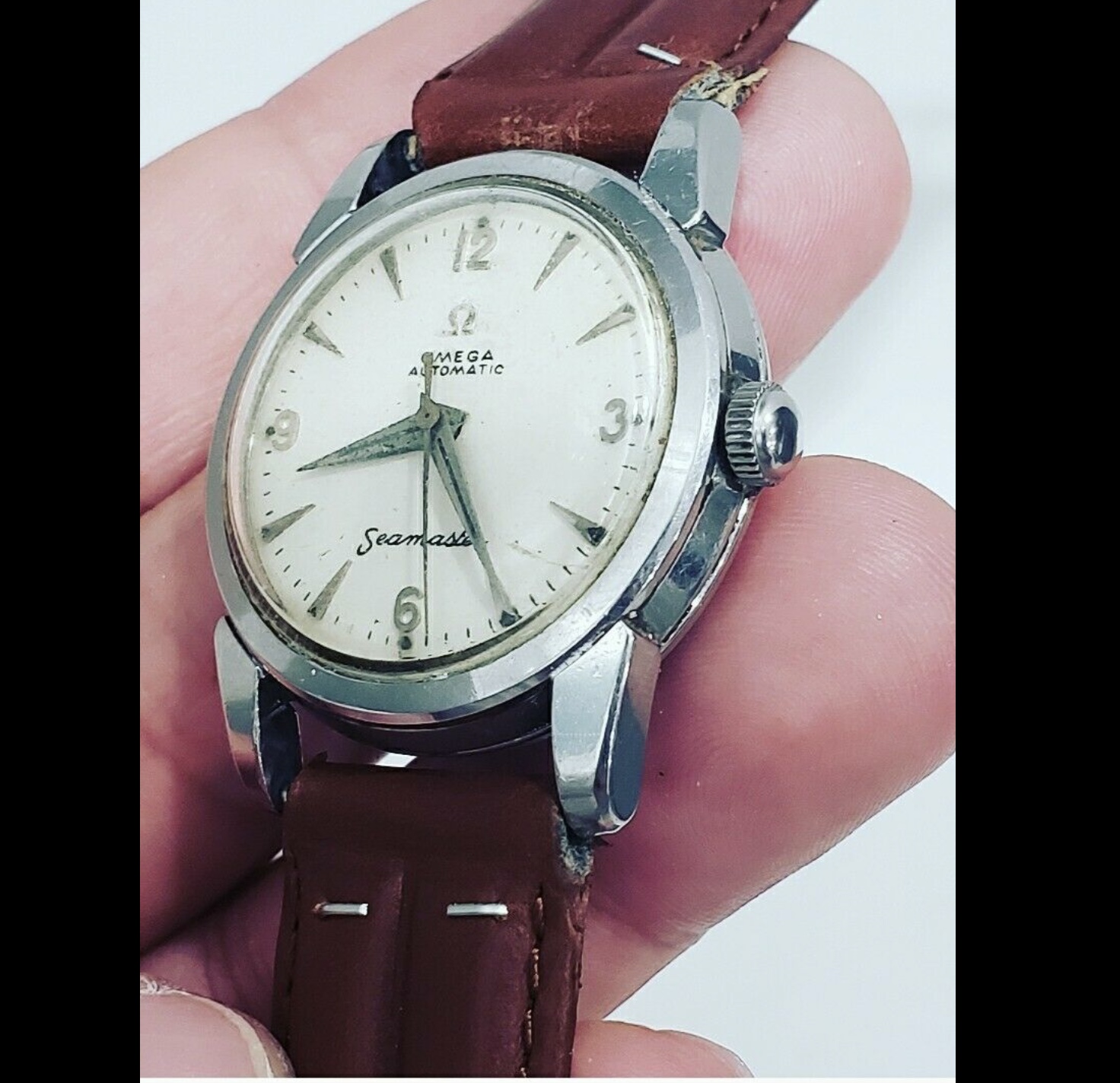

Hey guys here is my review of this watch.
Please feel free to correct me or point out things that I have stated wrong or things I missed. Thanks
Year 1954

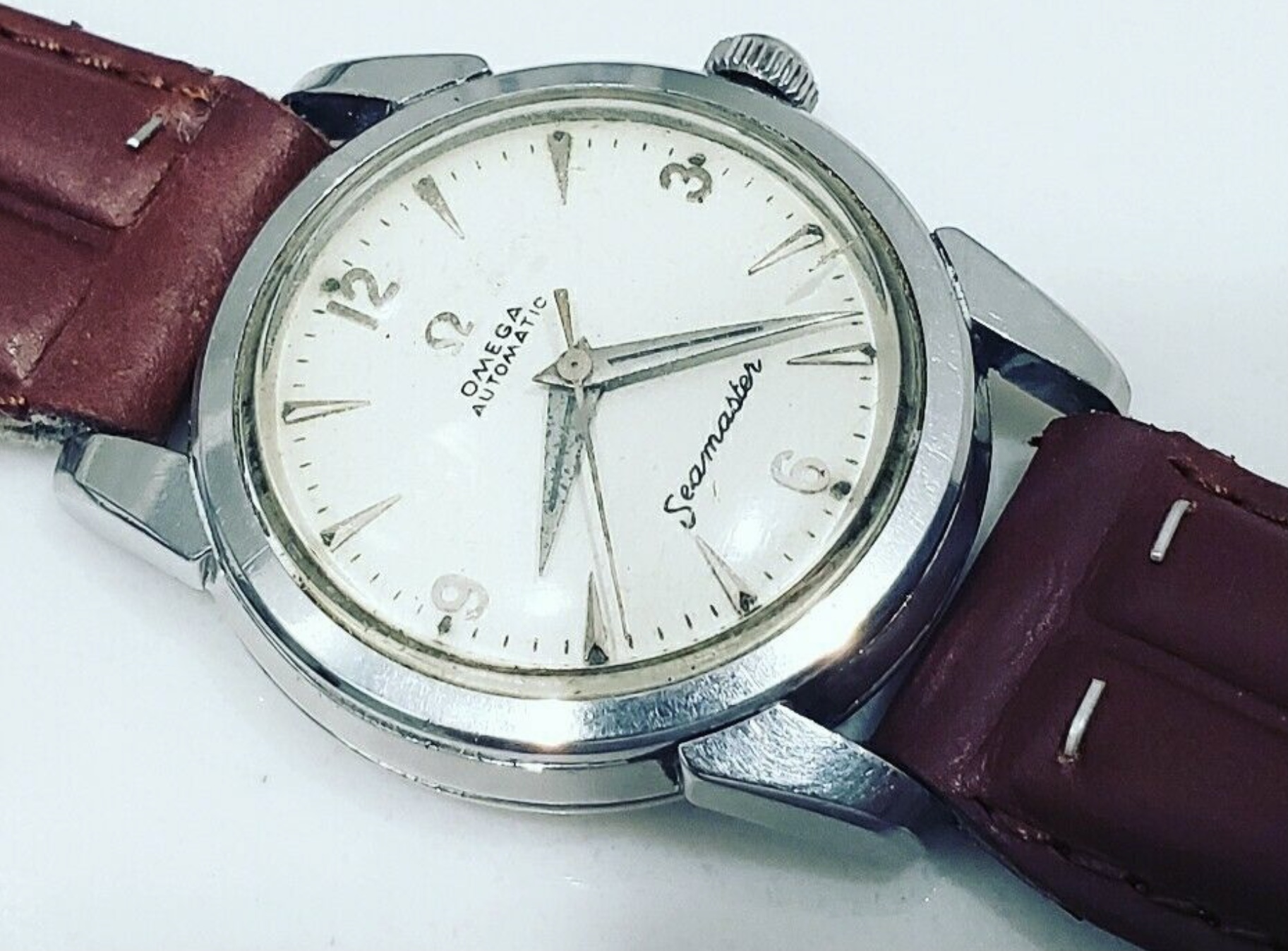

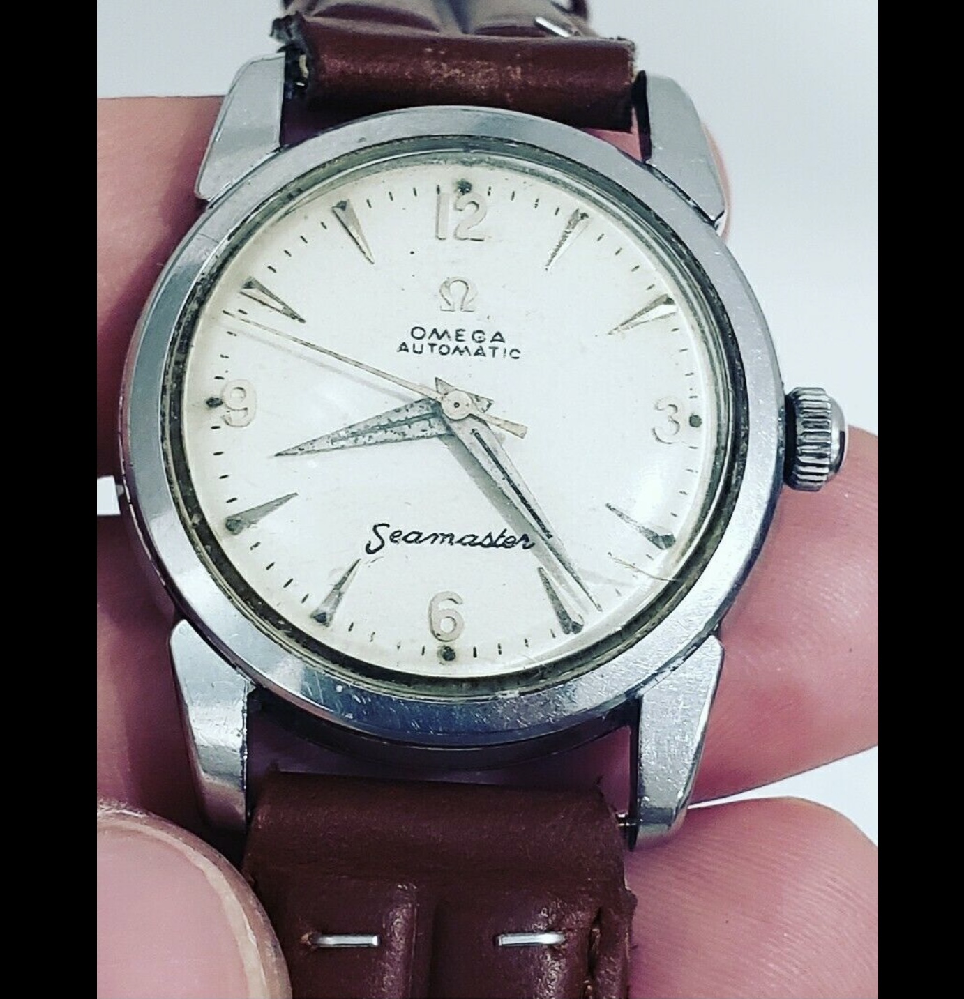

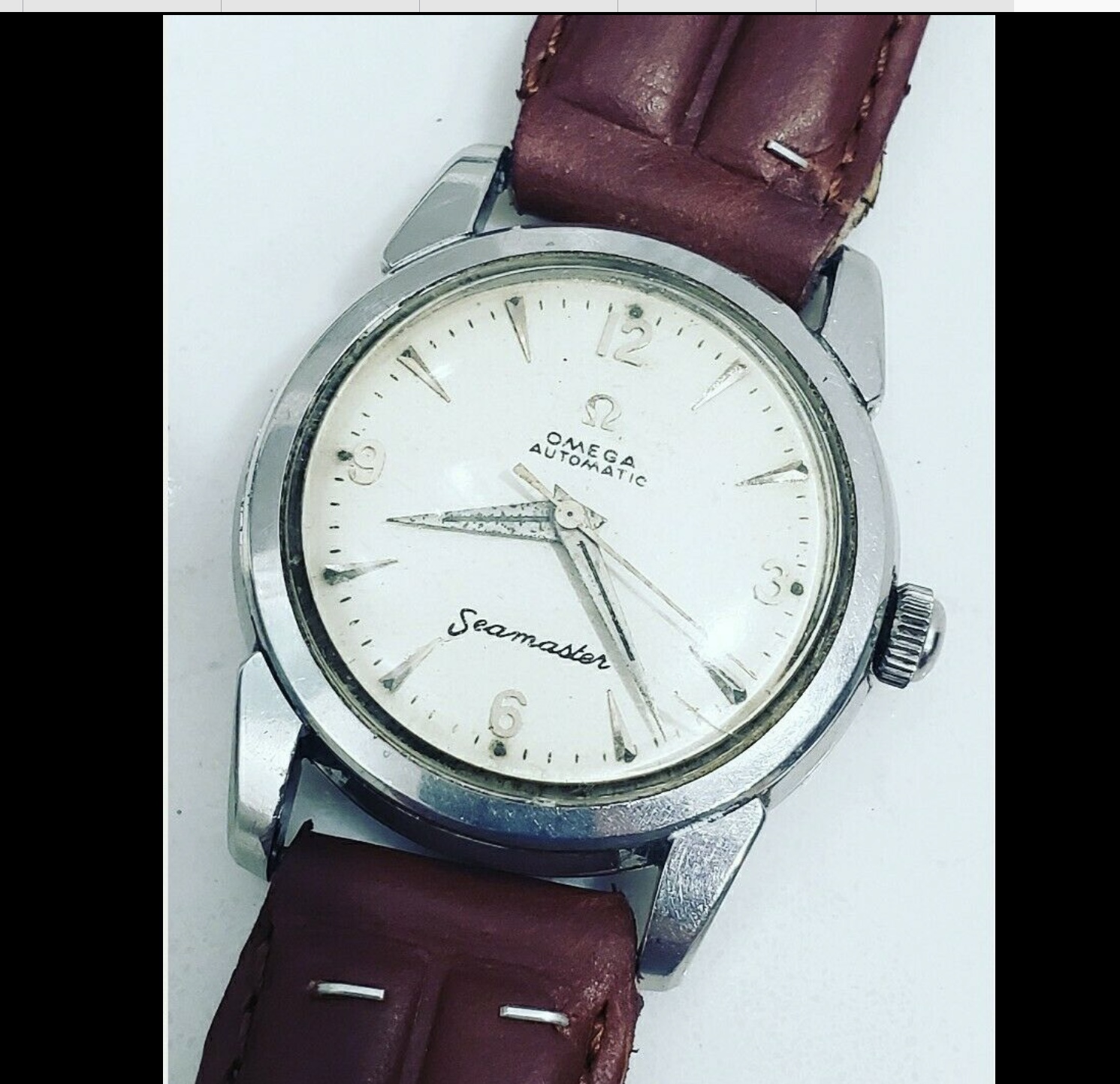

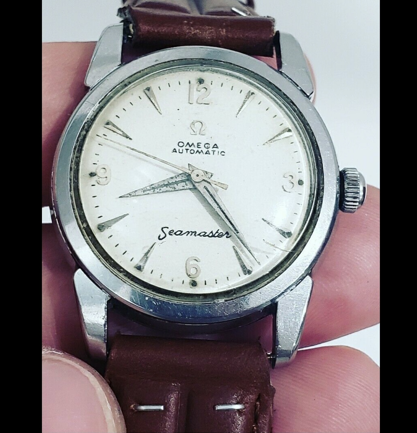

Dial - original markers, paint maybe original but hard to tell, missing lum on markers, writing has been redone
Hands- look like original omega hands but wrong watch? Lum on dial no lum on hands?

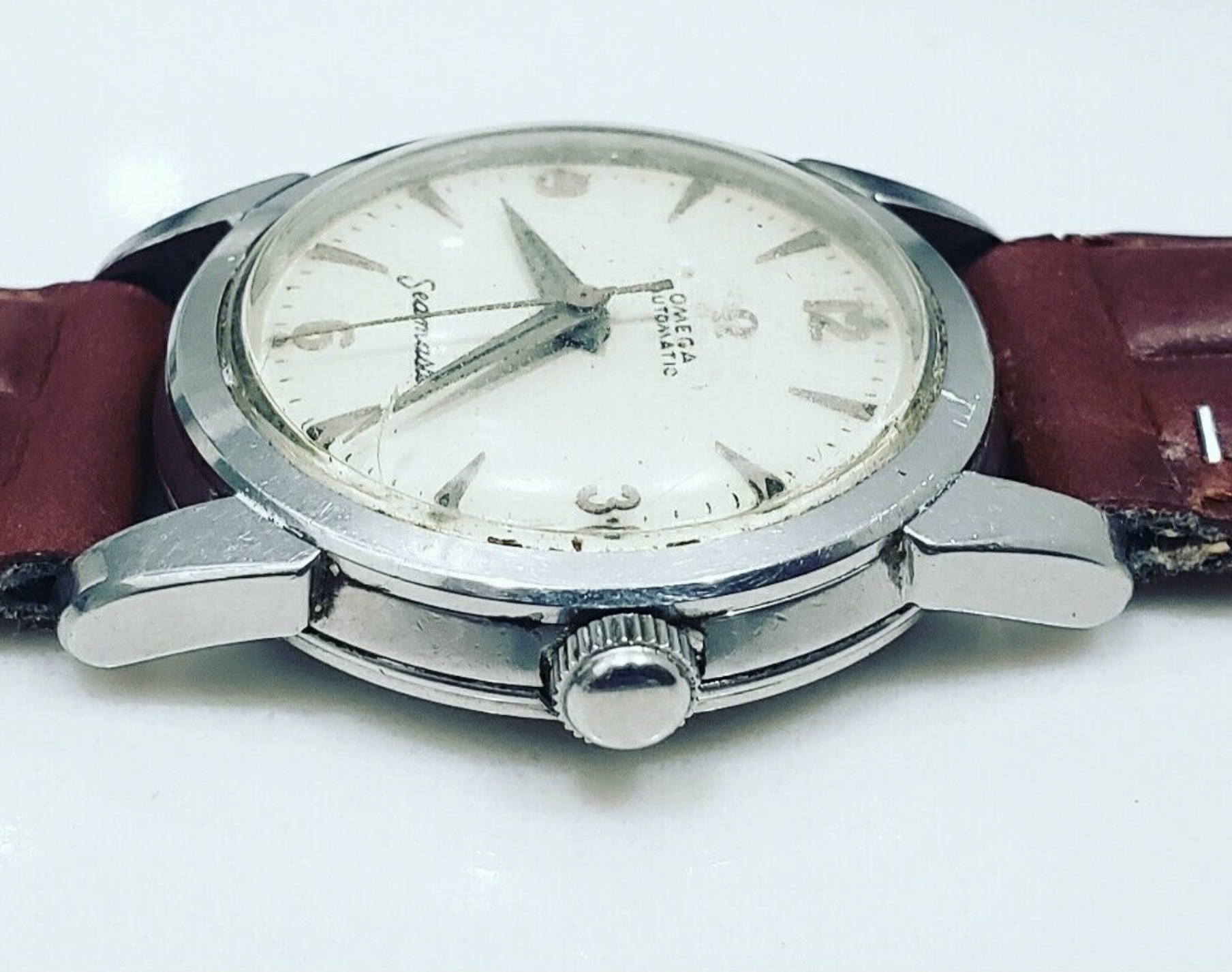

Case - looks slightly over polished on lugs not bad but they are a little rounded
Crown - non omega, aftermarket?

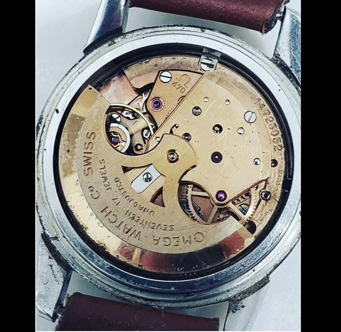

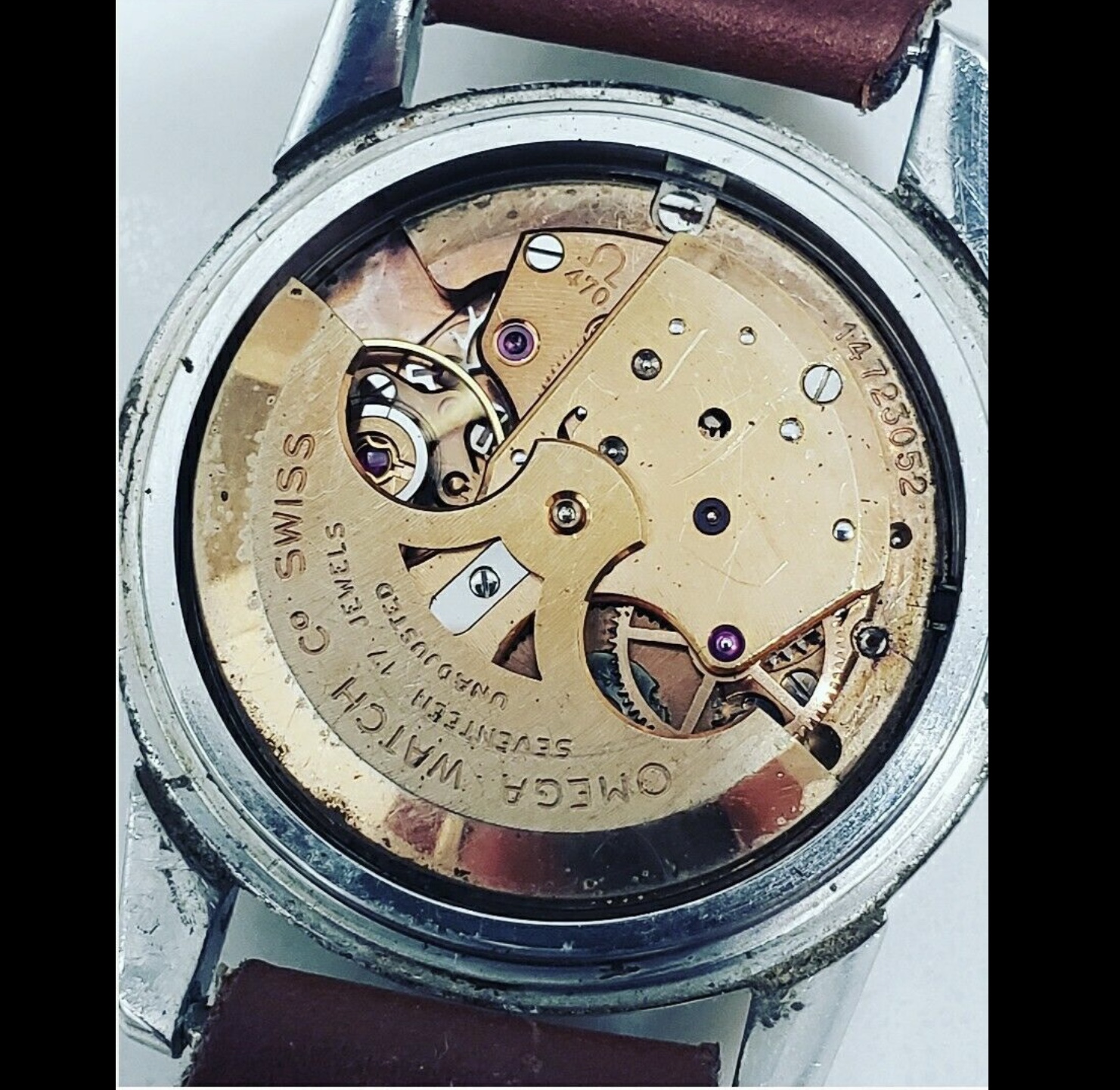

Movement - looks ok has not been serviced in awhile, looks like might be rubbing on rotor weight hard to tell however case back does not show signs of rubbing?
Movement year 1955

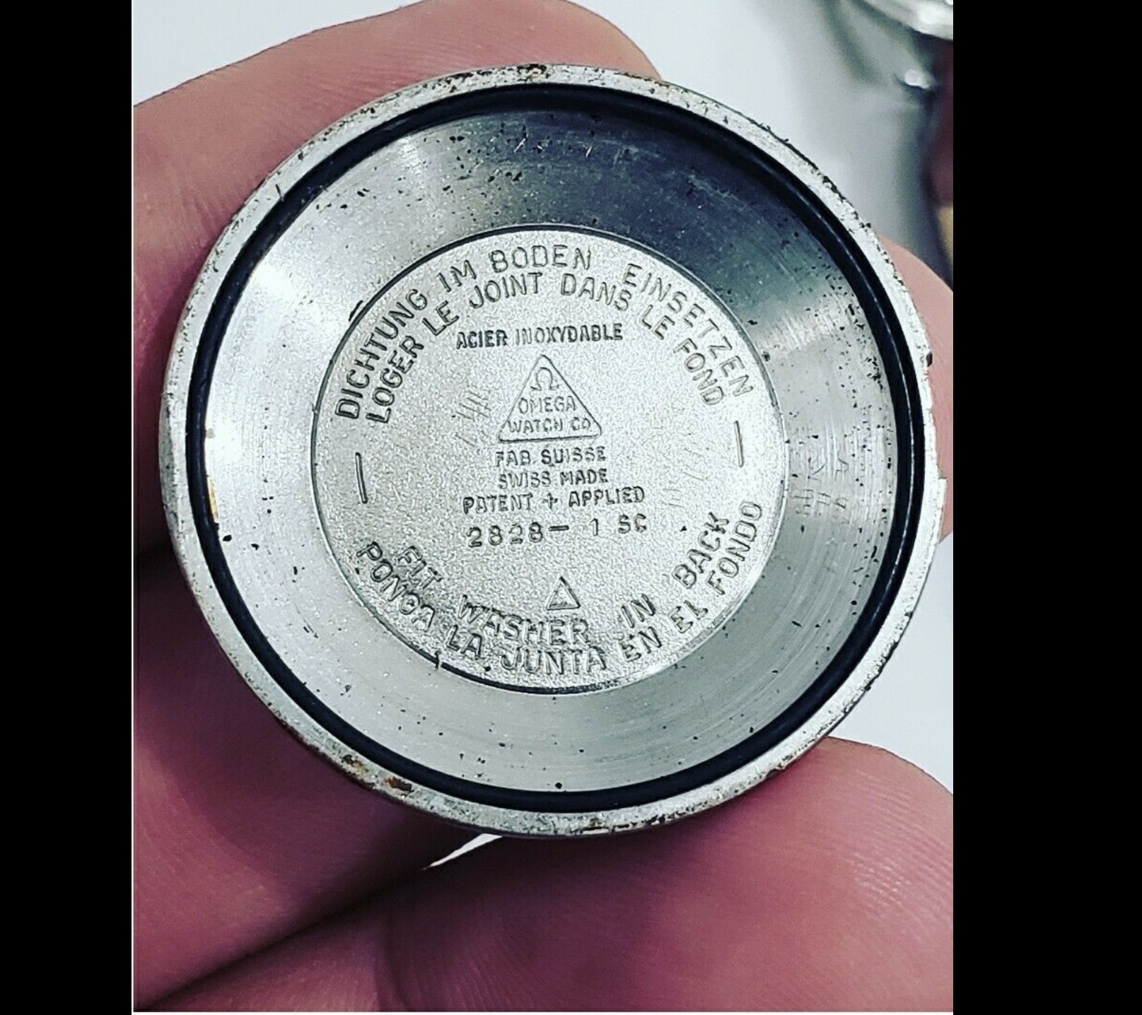

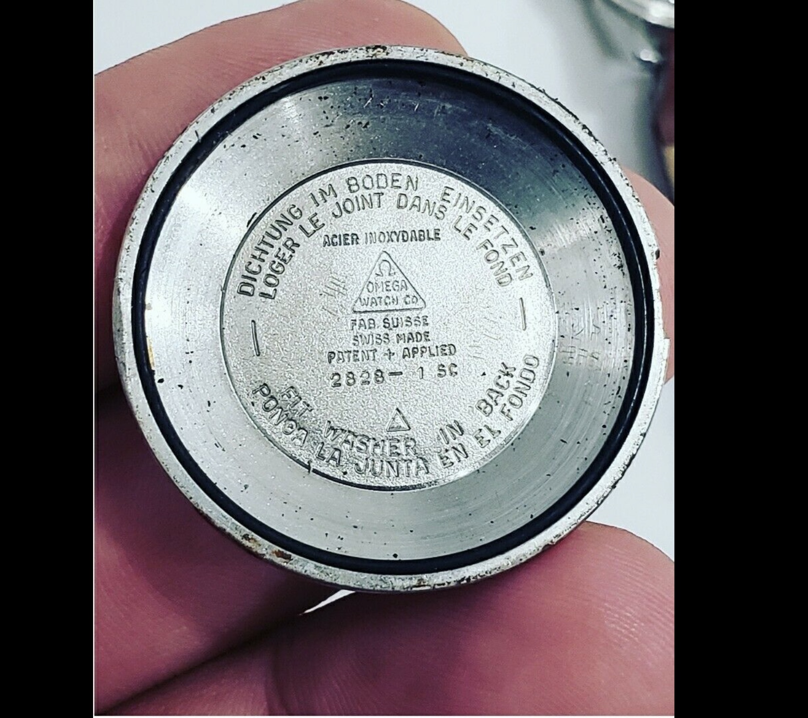

Confused by the case back as there is no model number 2828-1 does not turn anything up?
Not a great watch, pretty worn.
Thanks guys

I’m going to go that’s a horrible redial. All of the printing is redone, and redone poorly.
233
137
Agree the printing it terrible.
In the earlier years was Seamaster spelled with 3 humps. I have seen a lot of redials with 3 humps wondering if that is an oversight on the redial or something they did is the early years?

Variations in Seamaster scripts is probably something you should familiarize yourself with. It varies over the years. Also, I suspect the hands on your posted watch are original and contained radium lume. You caught the redial and well done there, but the case and movement look quite tired as well. In short: correct watch, incorrect crown, redial, hard pass. 😀

I'd say that small variations in the printing is not your primary concern. You would have to learn to assess the overall condition of a watch first.
In this example, a pitted case, corroded hands, movement that suffered from obvious moisture exposure but a stark white/black dial with very low quality printing : what does that tell you? You really don't need to know the various kinds of Seamaster scripts to detect a redial here... some are tricky do detect but if you fall for this one, you still have some basics to learn.
