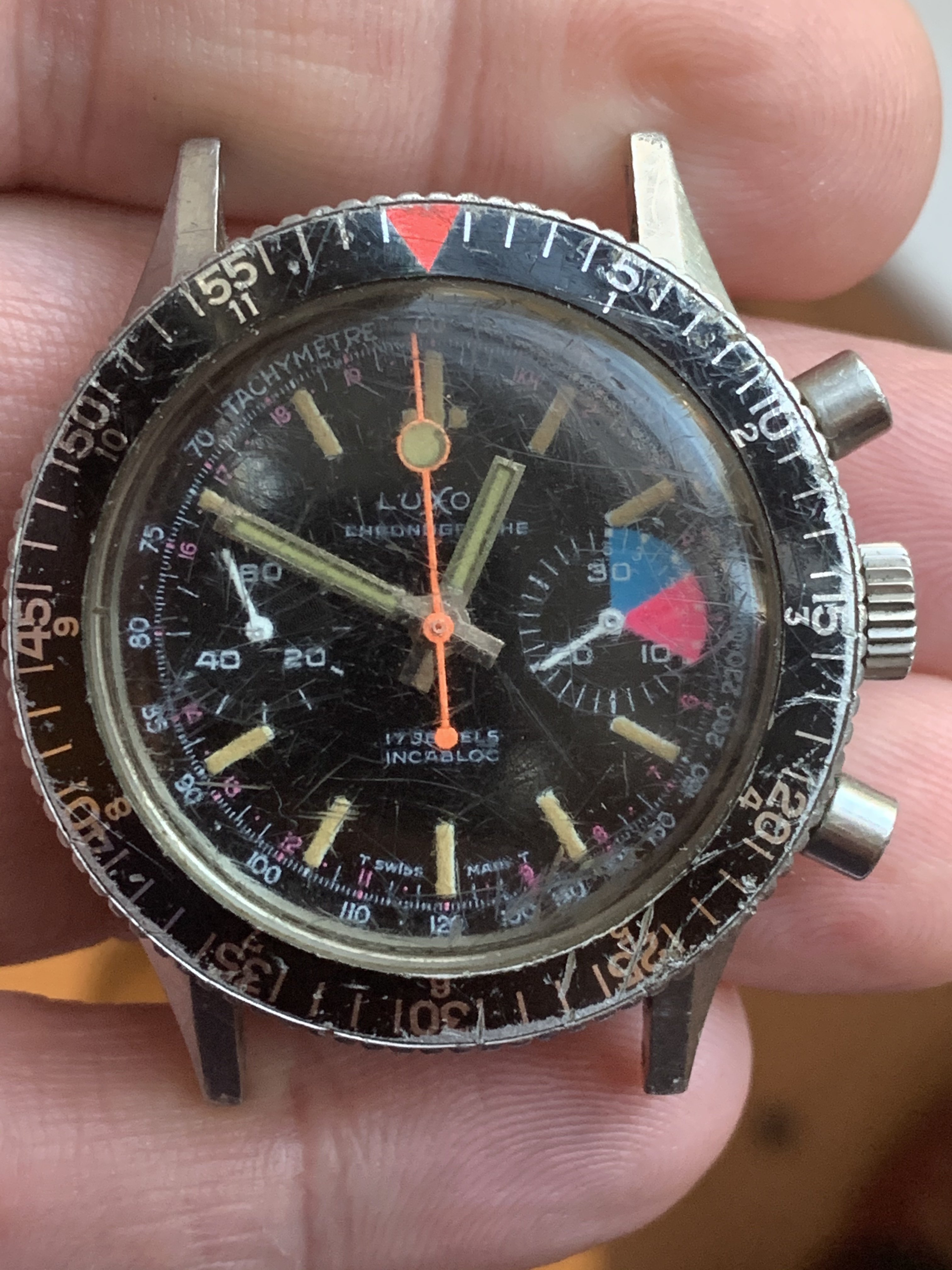

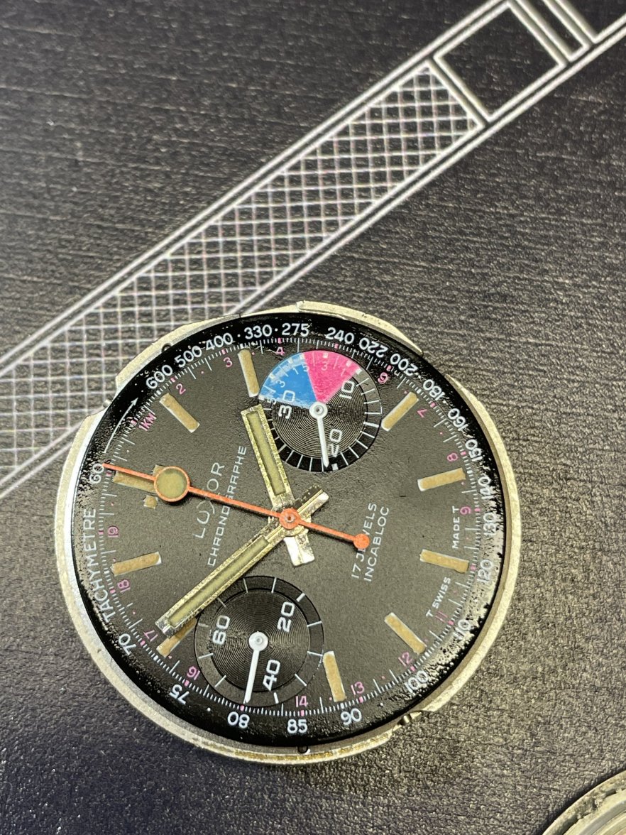

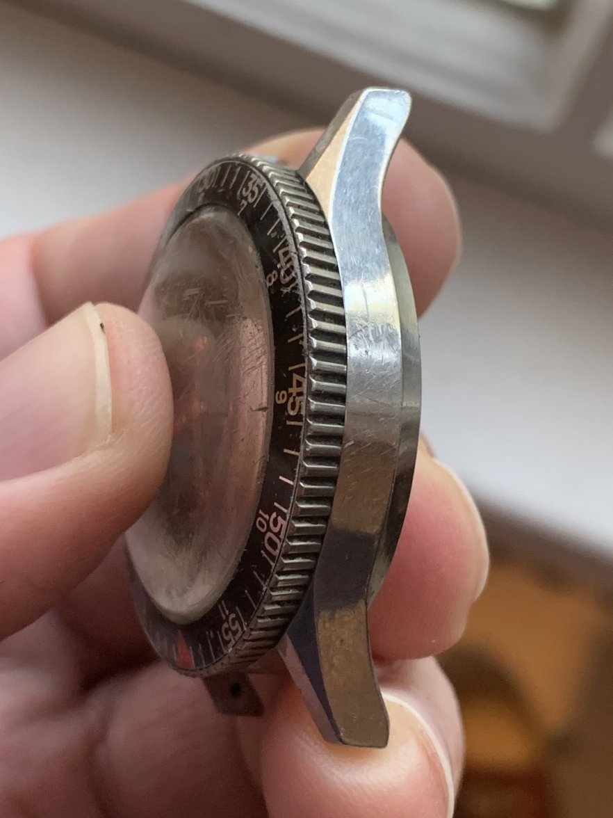

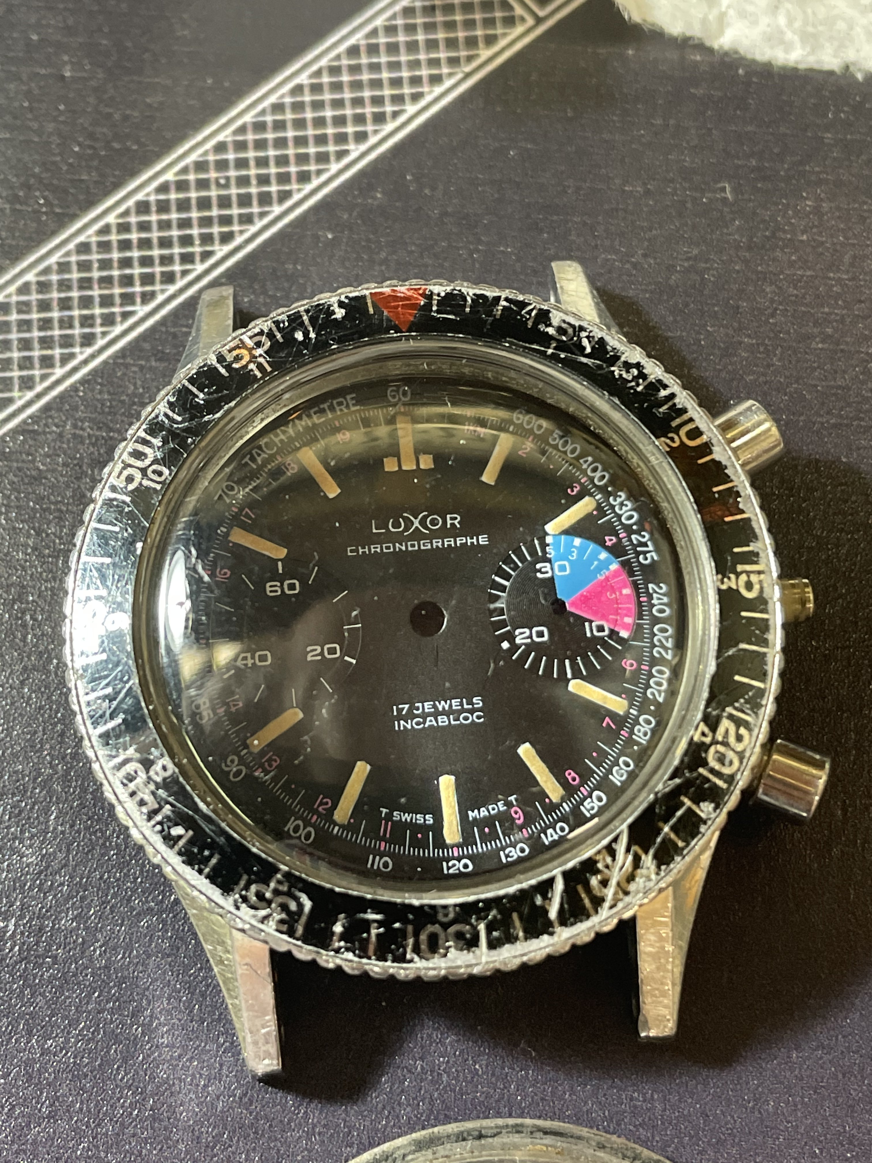

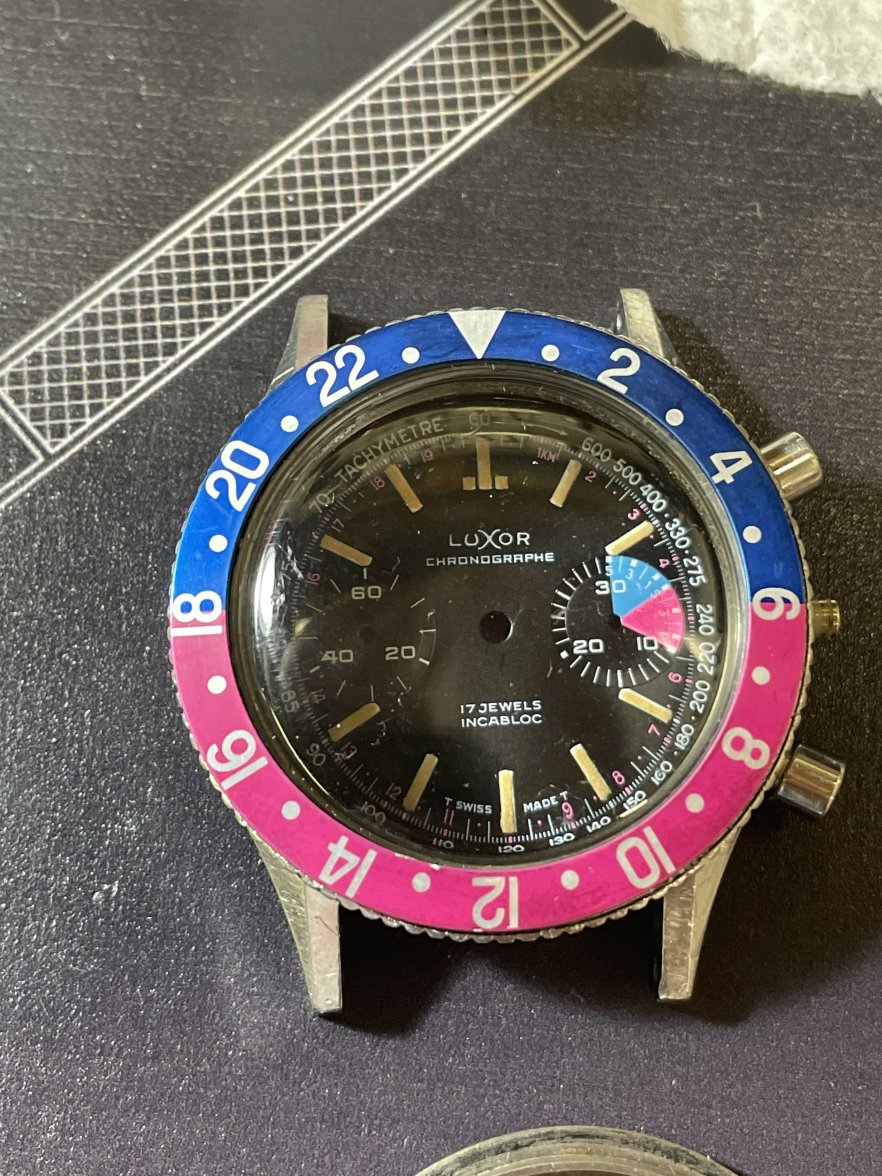

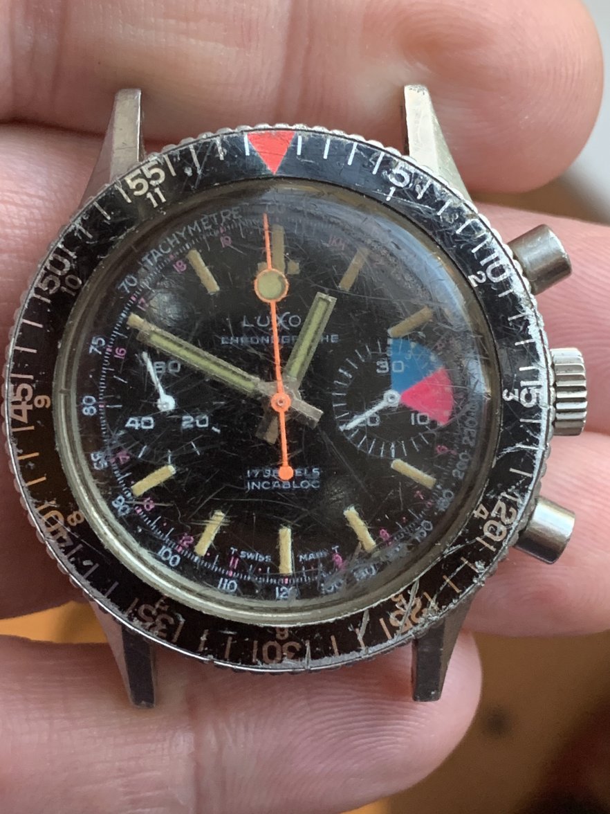

So I took a risk on eBay a few months ago, a lovely yachting style Luxor popped up as non-running but looked like it had promise. Price wasn’t bad but I made a low offer and the dude accepted quickly.
I got it and although I couldn’t really see through the crystal, it looked like it could be a nice watch- I was excited.
I gave it to my watch handy friend to put in queue to see if the issue was something easily resolved by a CLA or if it needed to go to my watchmaker.

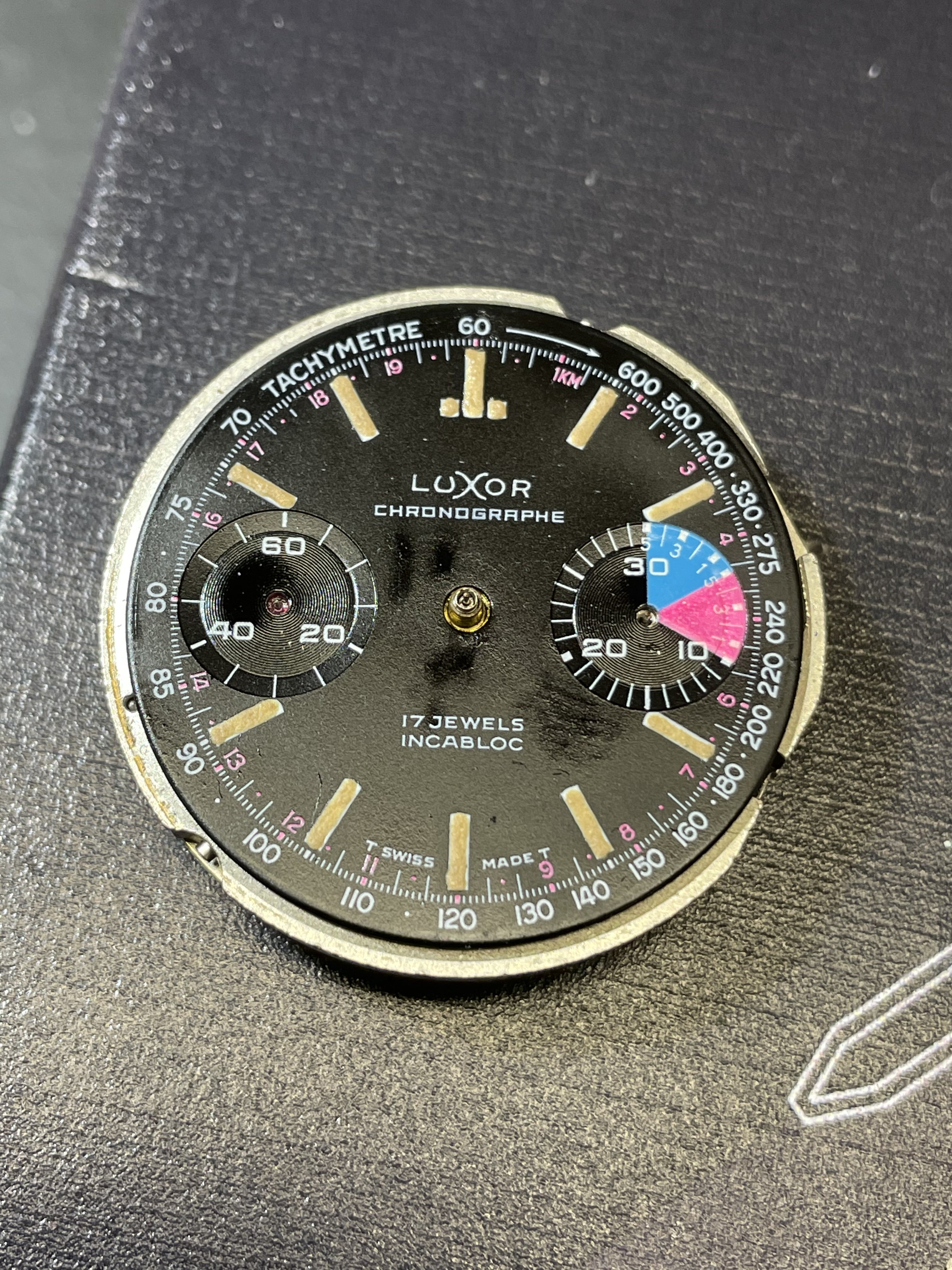

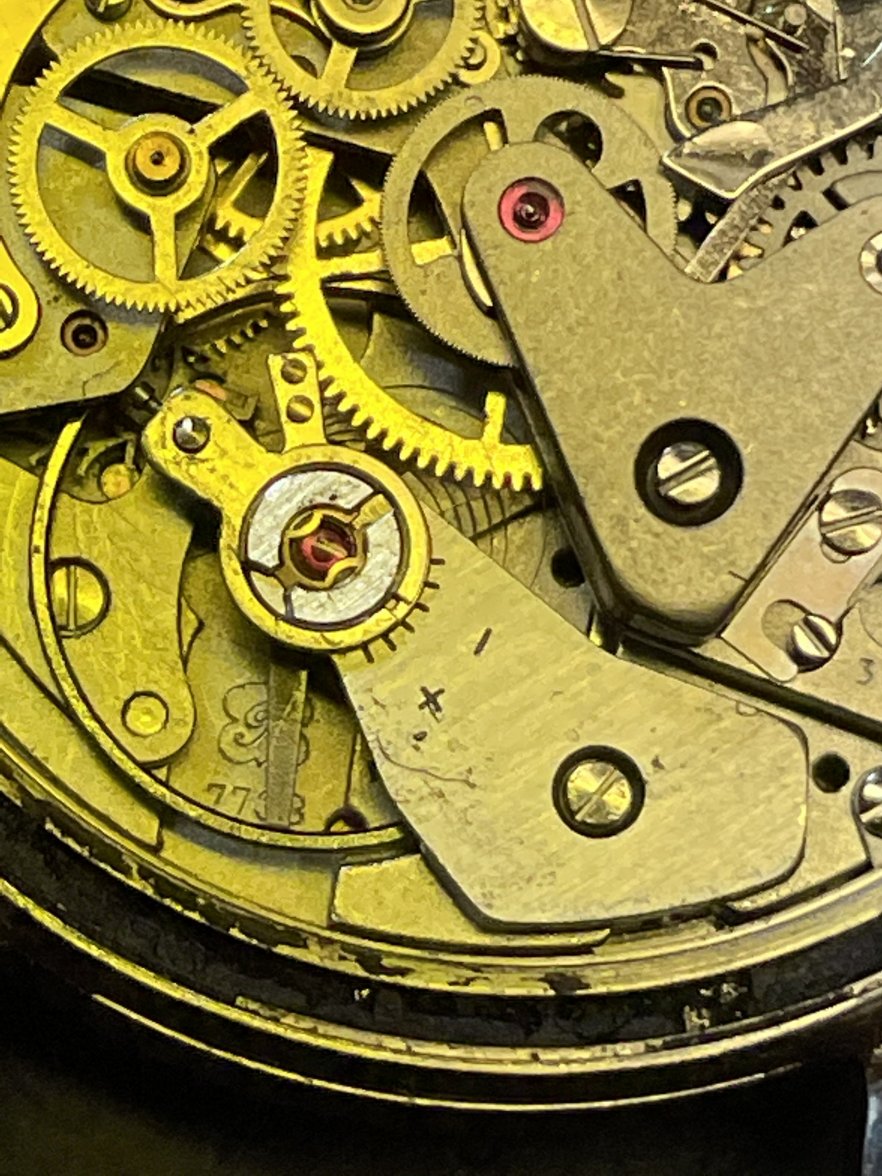

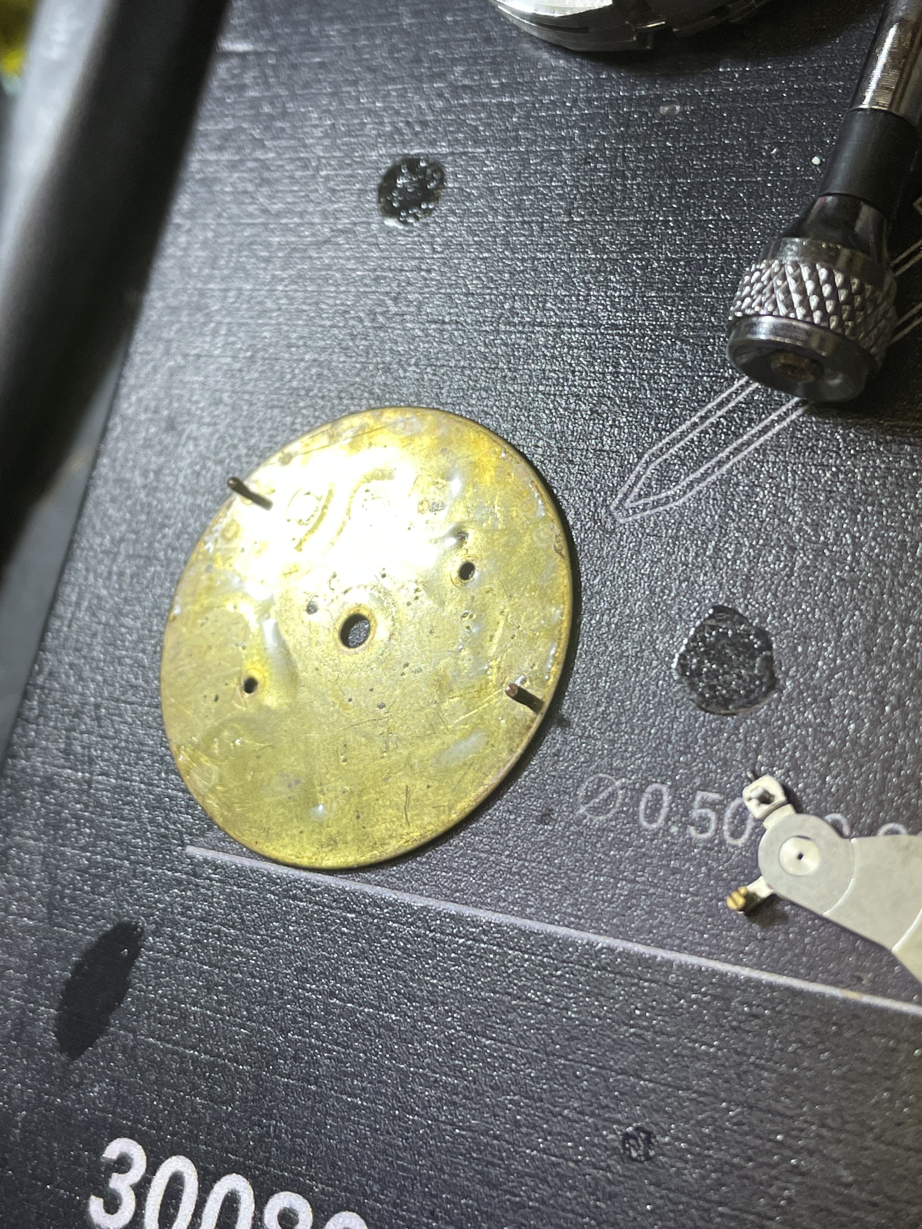

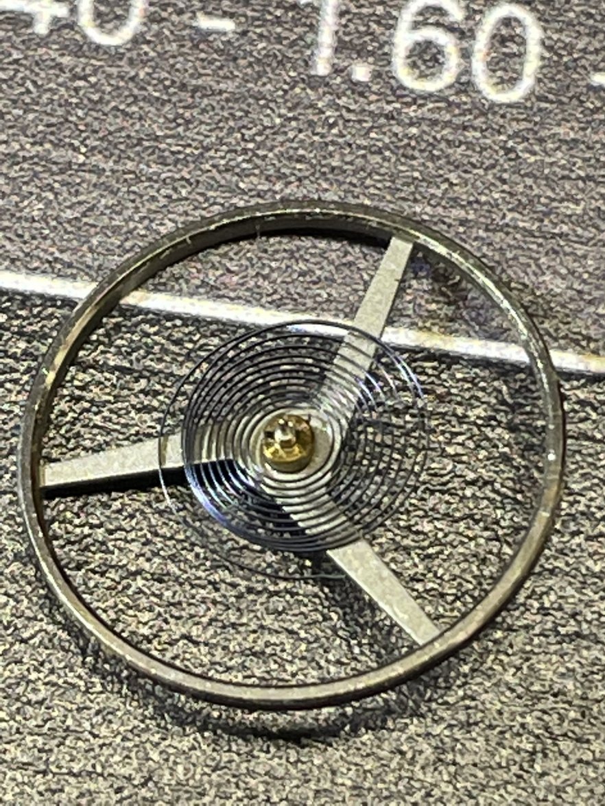

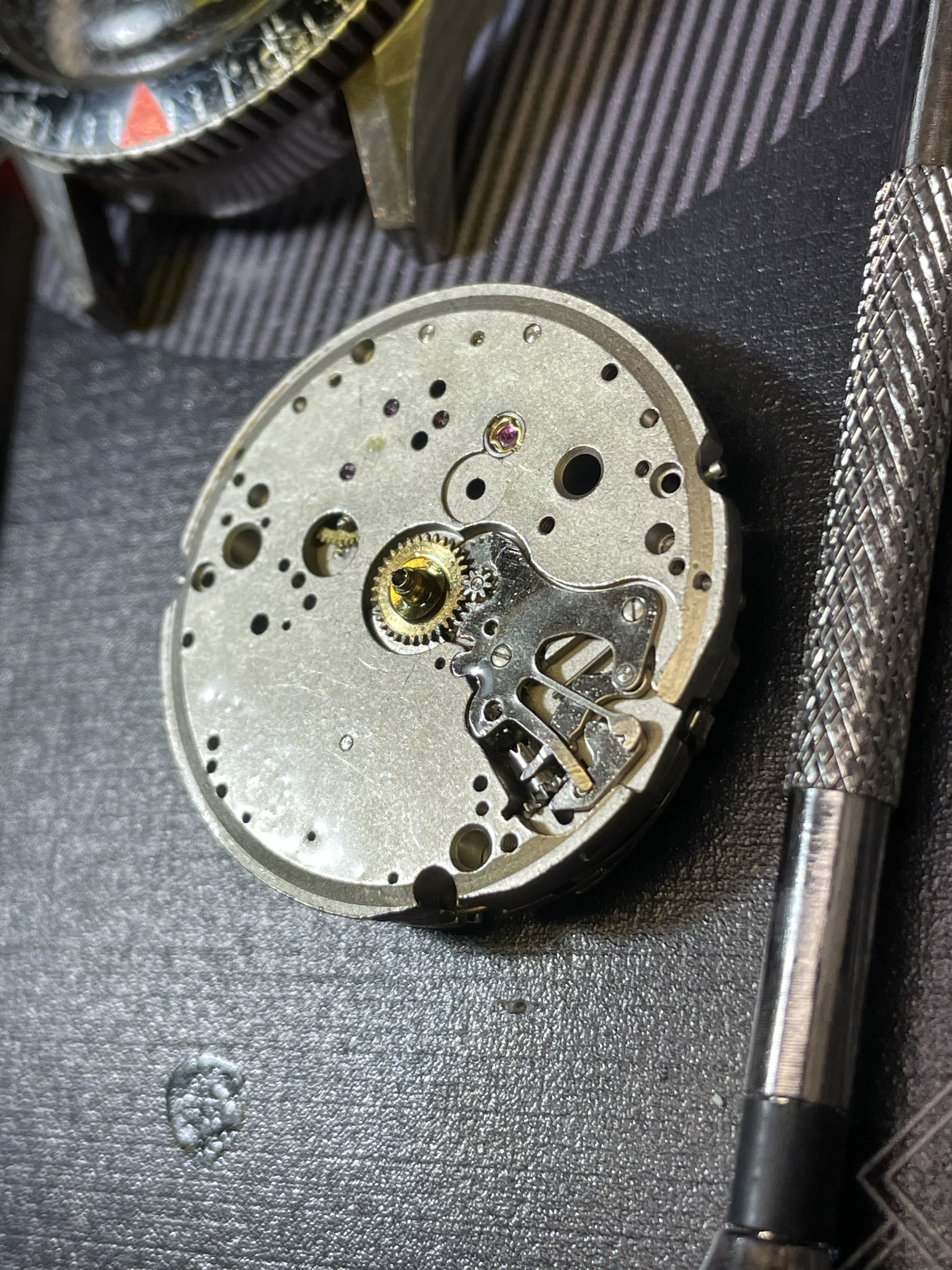

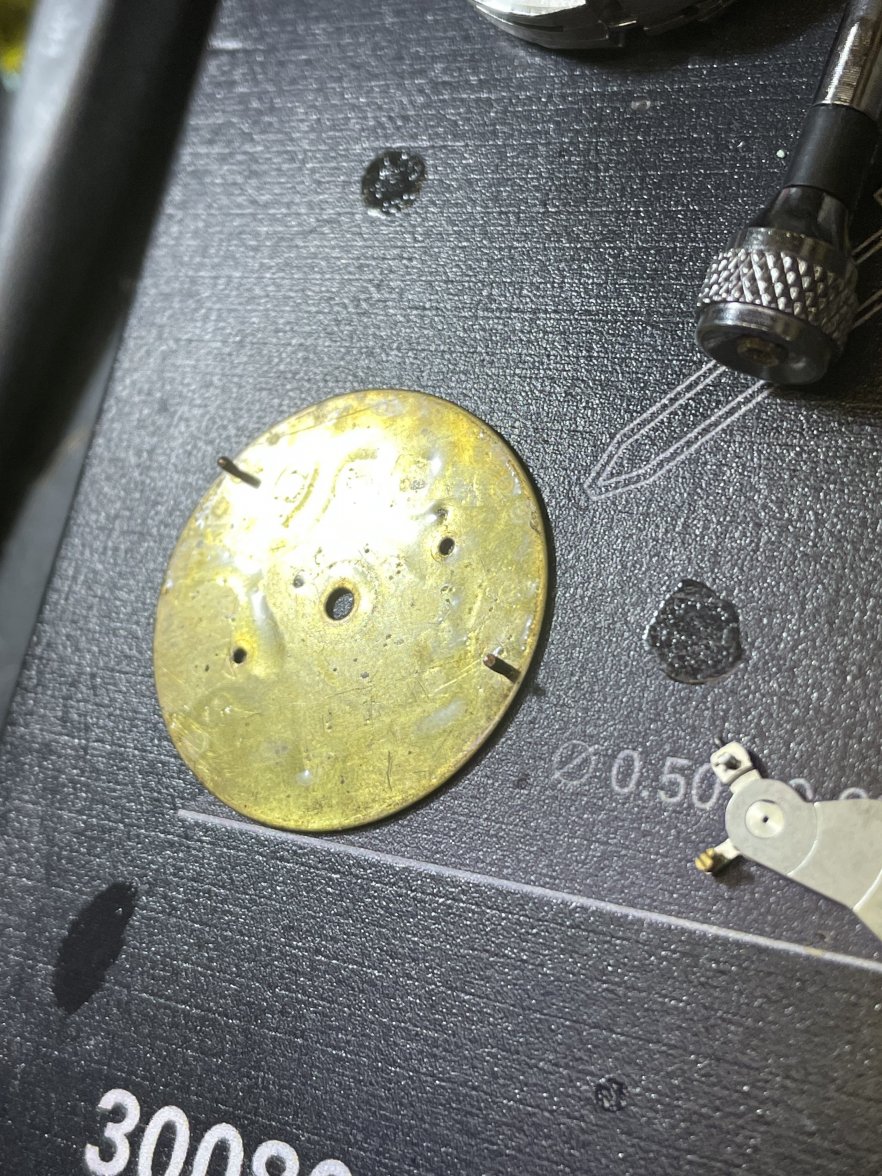

Well, he got around to it tonight and immediately saw the problem

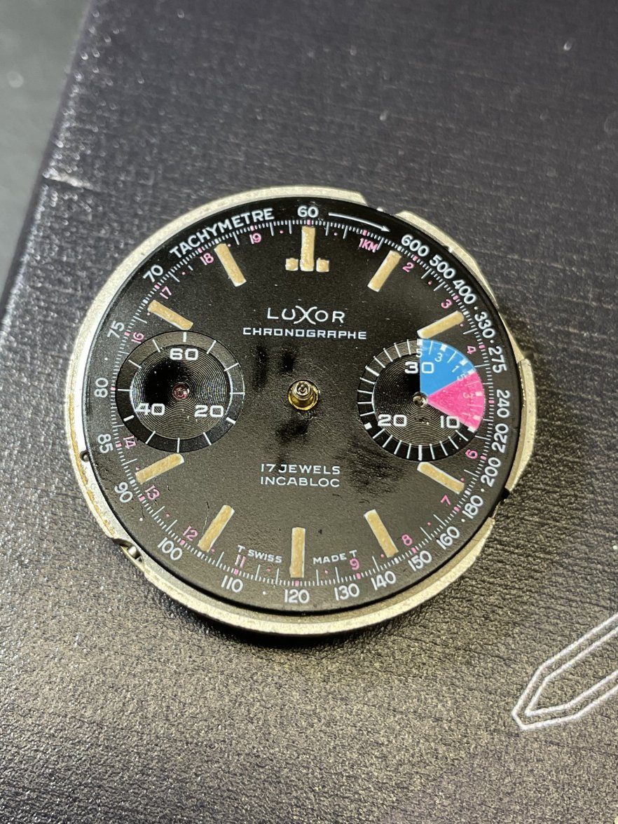

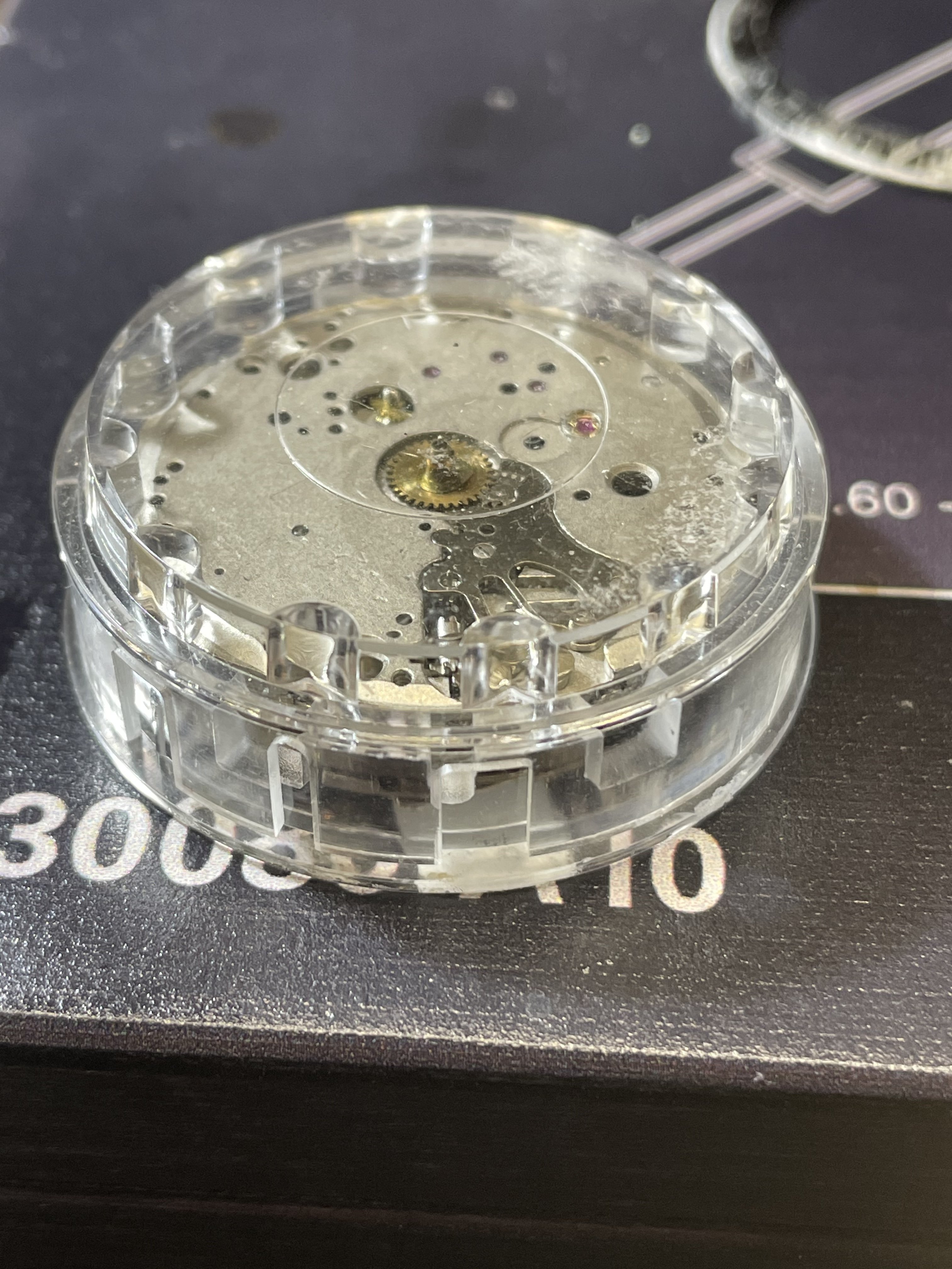

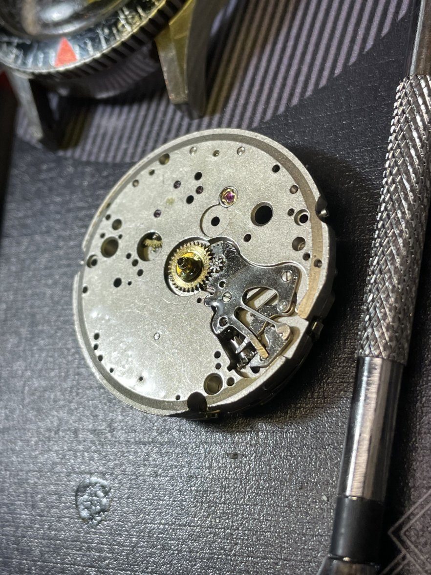

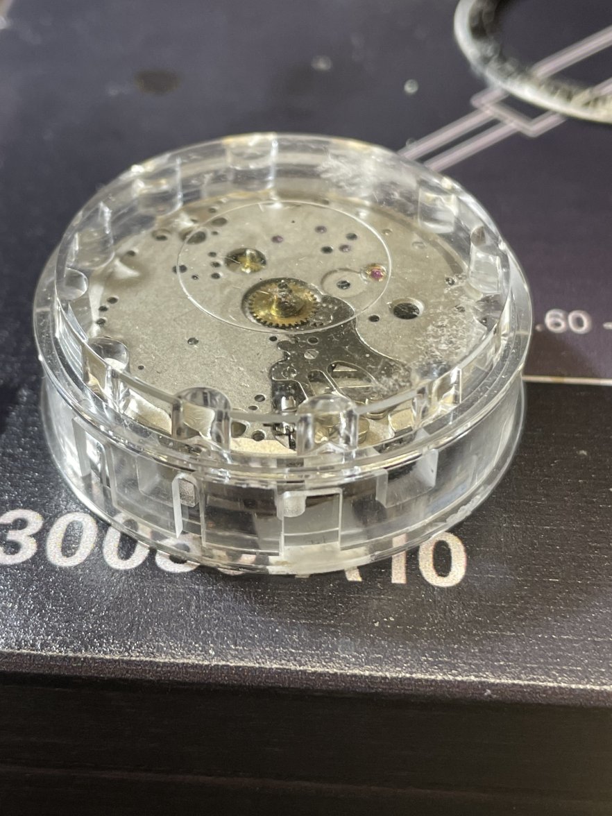

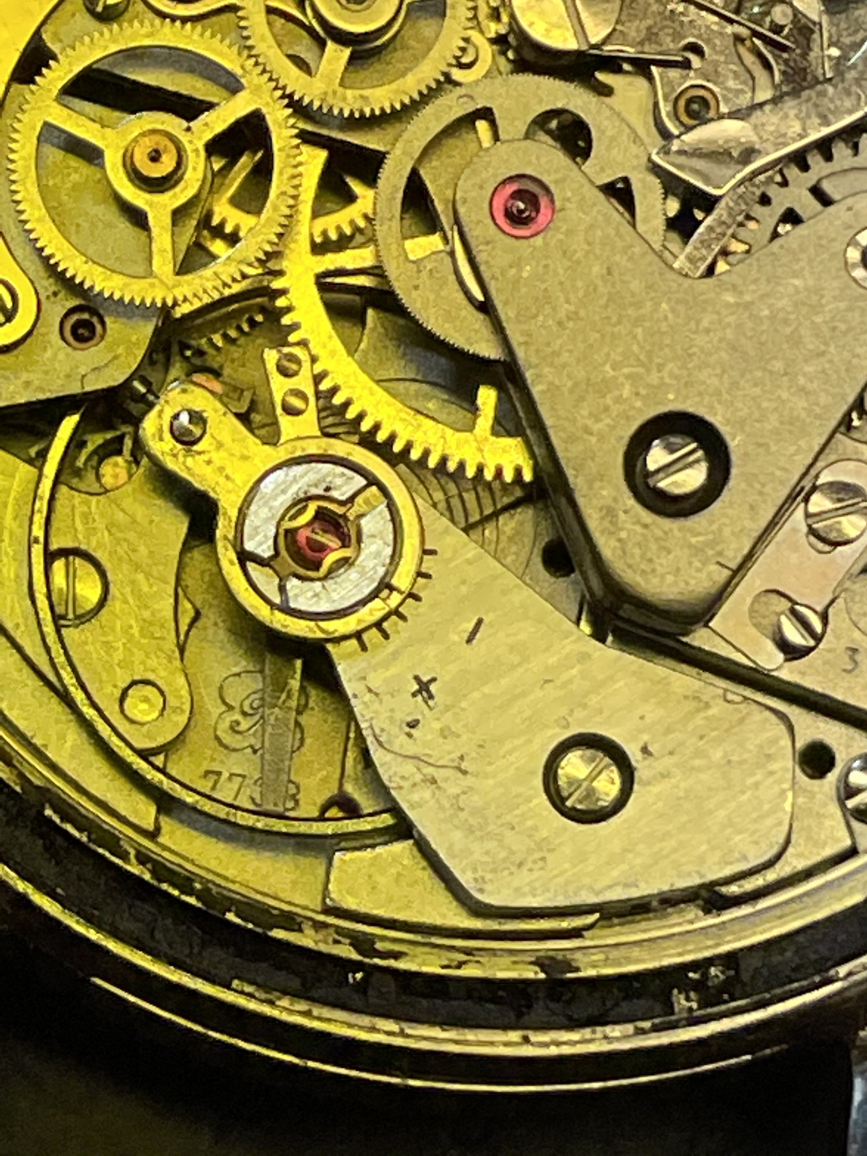

But upon further investigation, he found himself swimming in a slick mess of a very familiar smelling oil
Look around the tacky ring
Shiiiiny
Anyone want to go swimming?
I think BP wants their oil back
Needless to say- the previous owner probably tried to get this thing running by spraying half a can of WD40 into it...ugh.

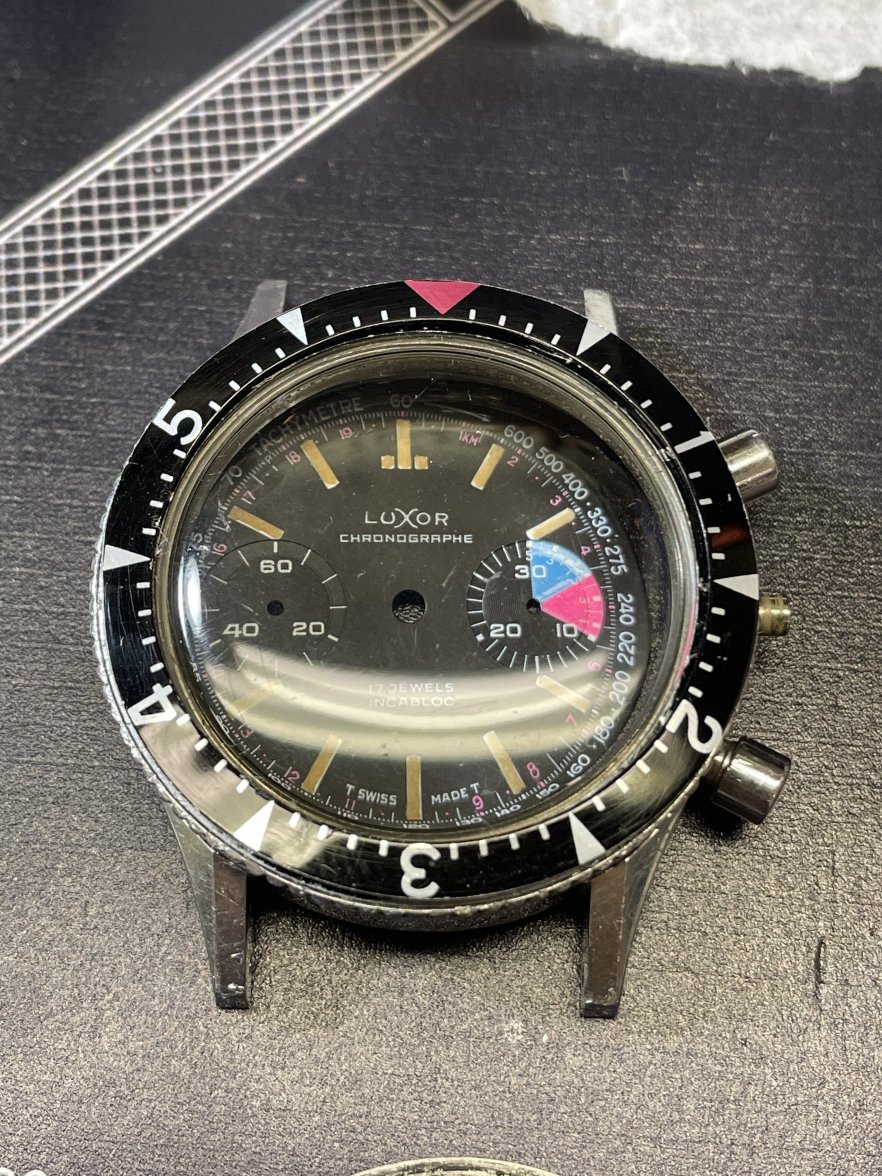

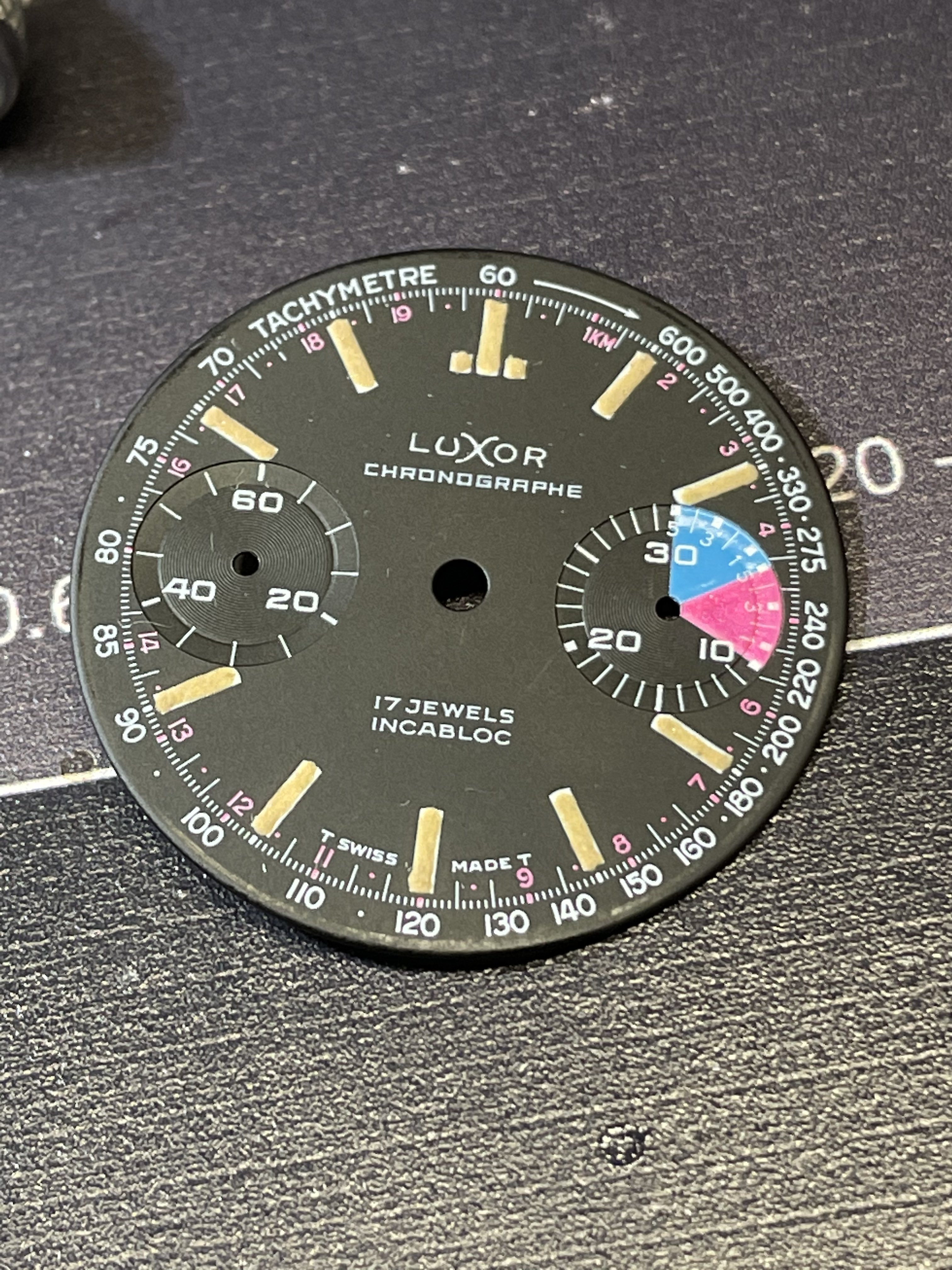

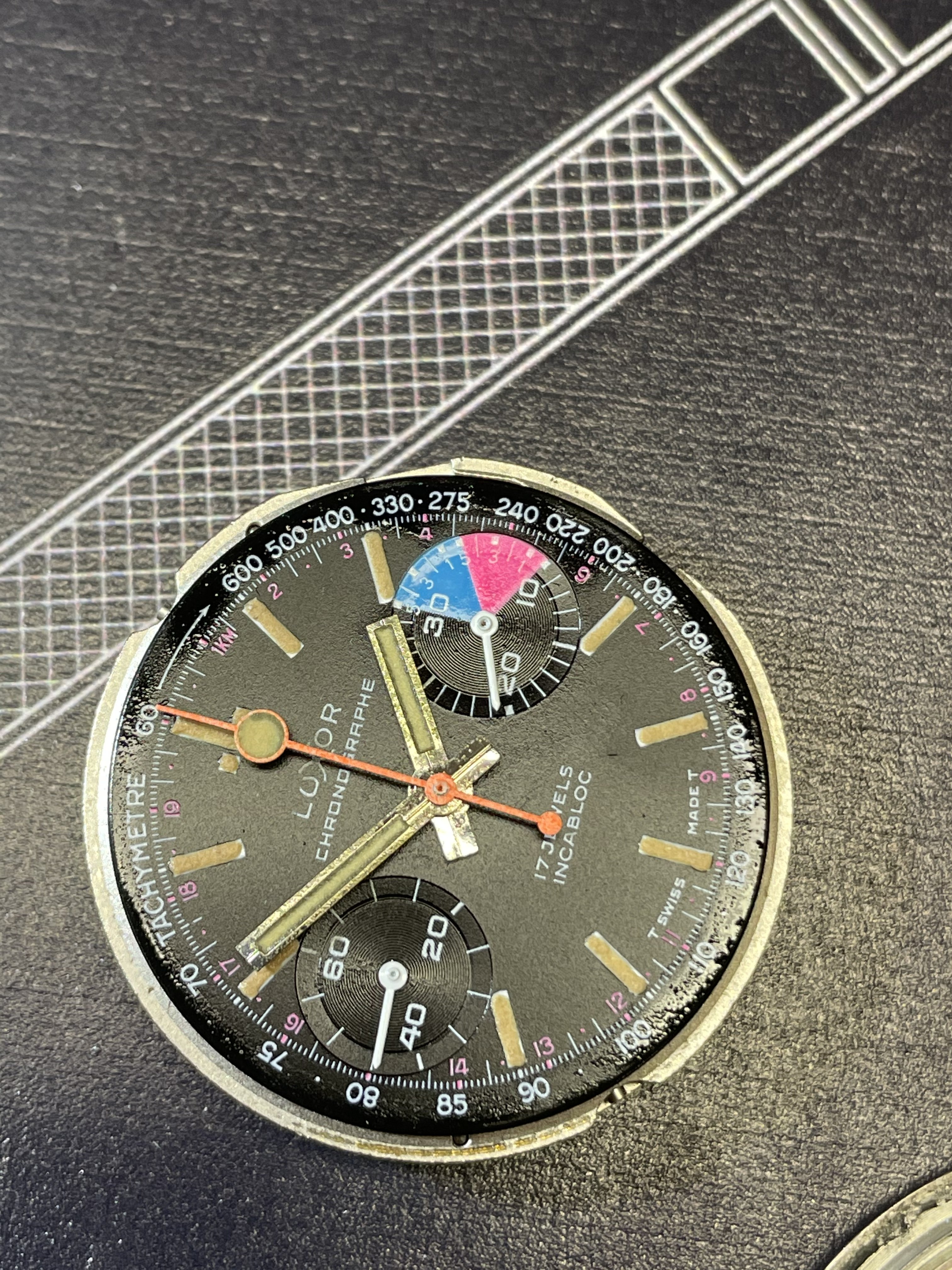

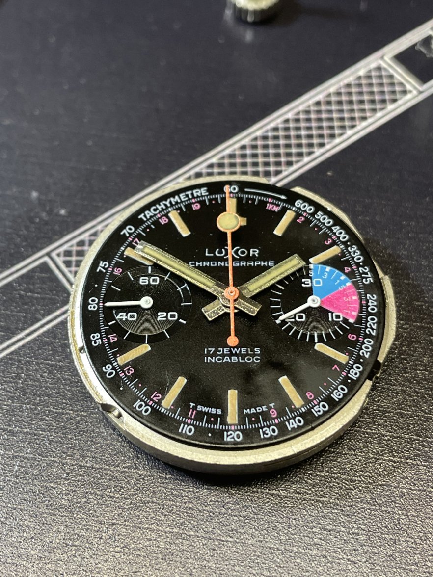

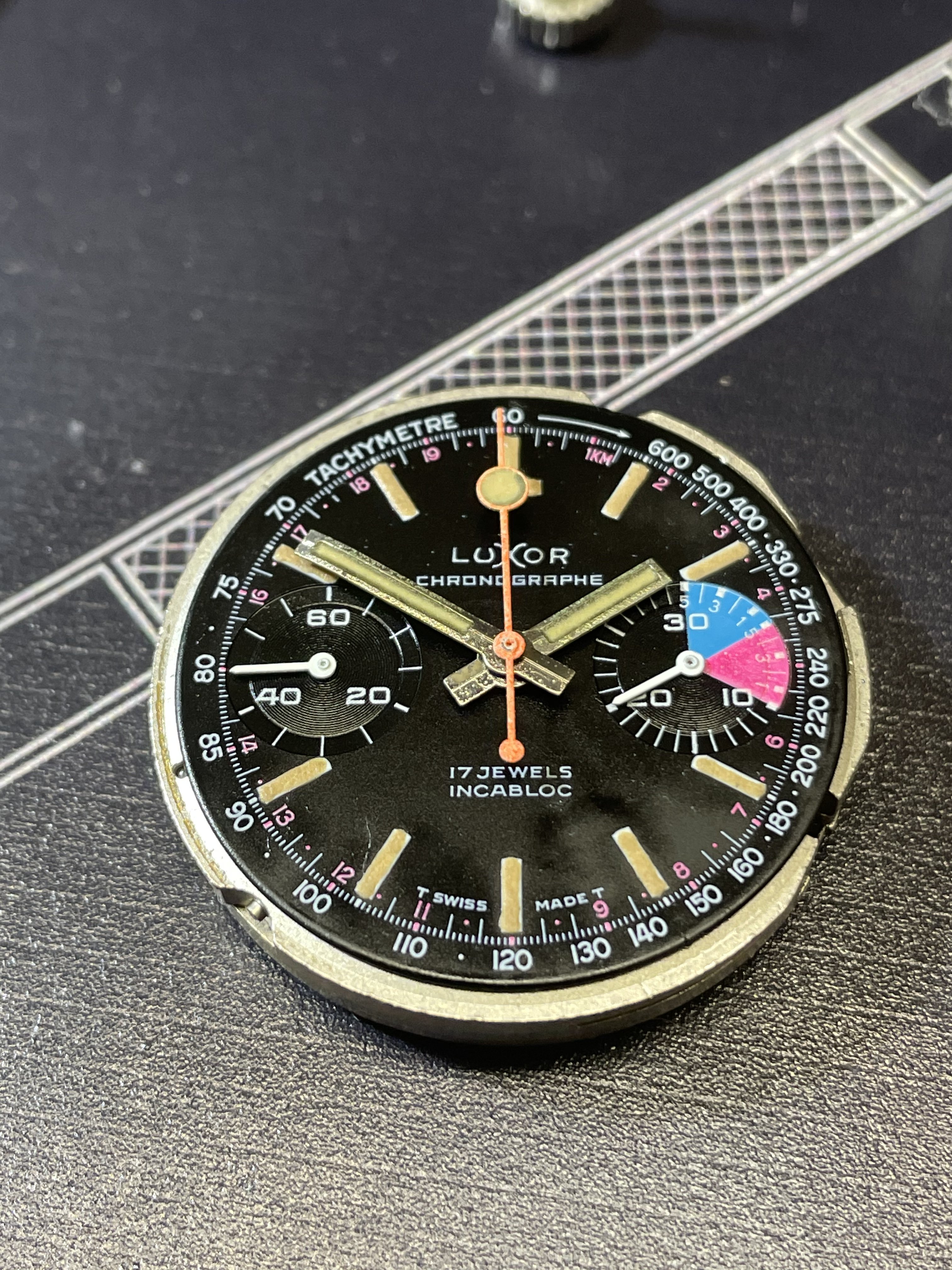

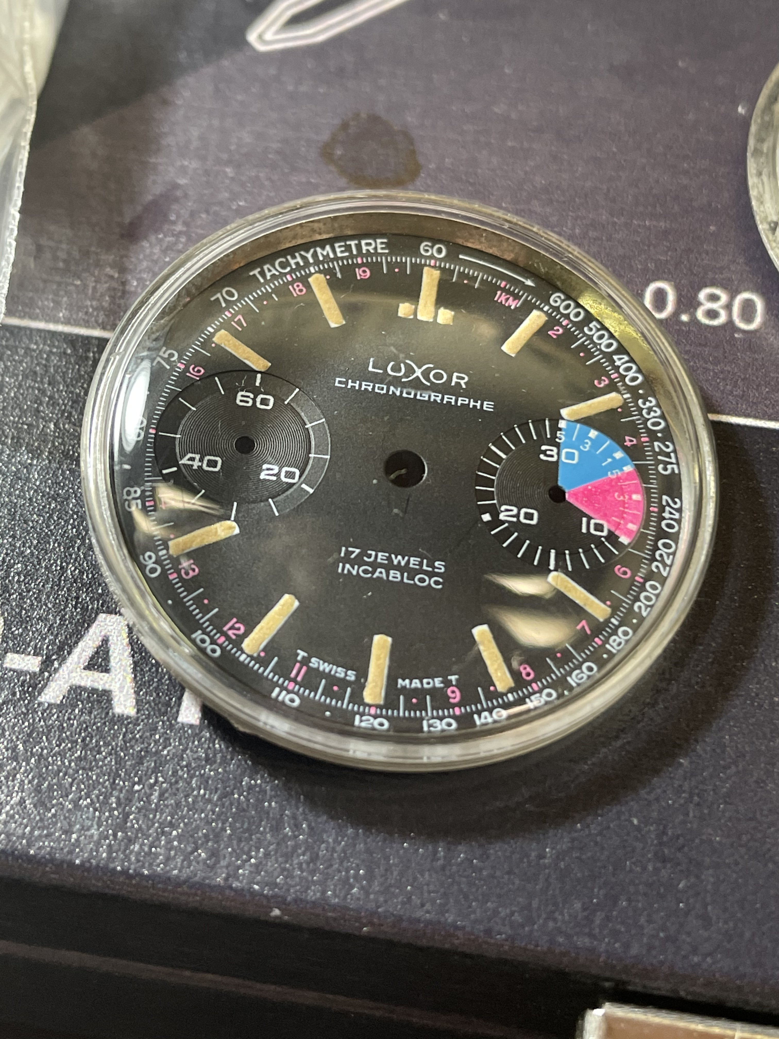

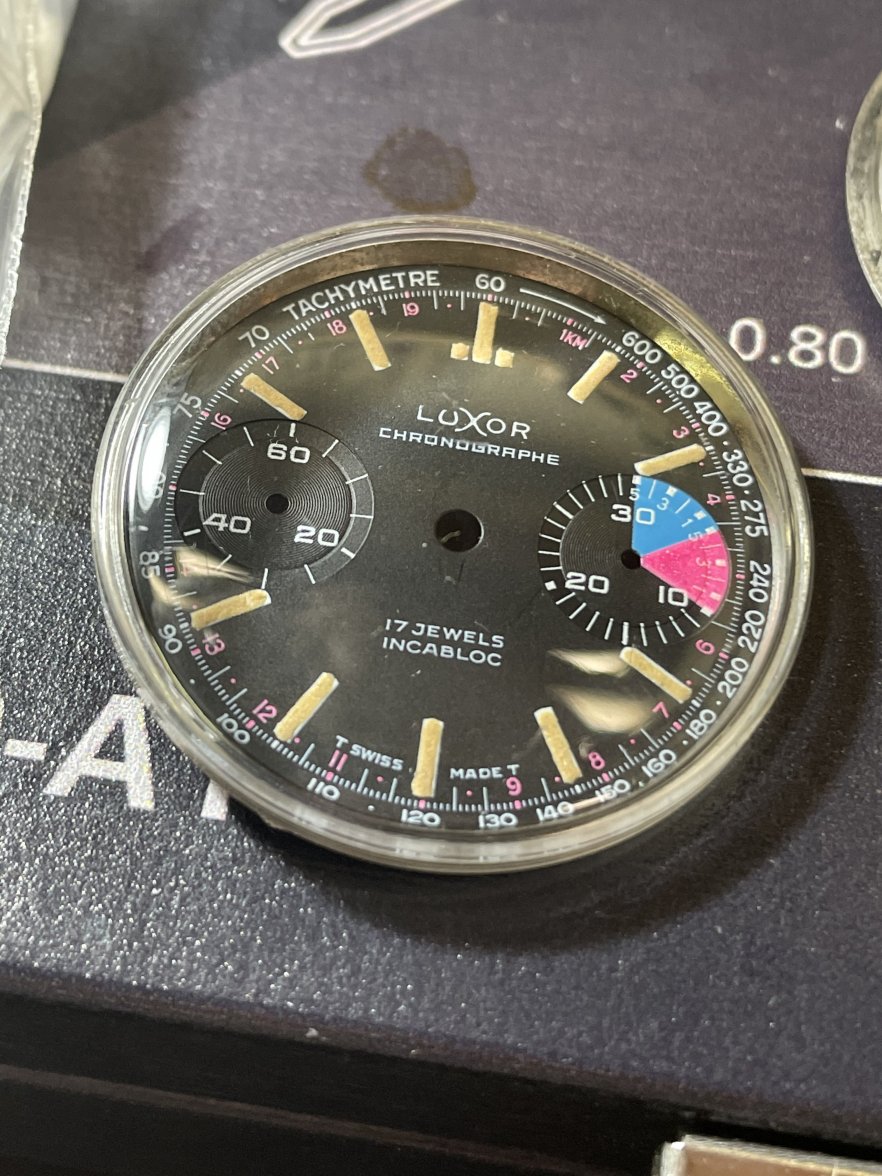

My buddy did manage to finally get it all off and it looks good, let’s hope the lume isn’t compromised.
I have another 7733 that’s freshly serviced in another watch I don’t wear much, so that’s going in this one and the Exxon Valdez is packed up and ready to go off to my watchmaker- he’s gonna love me.

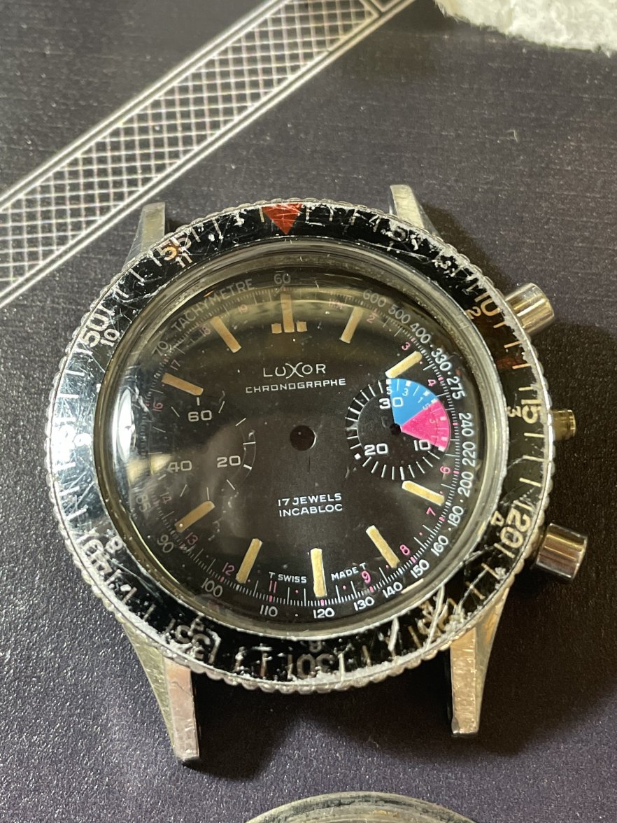

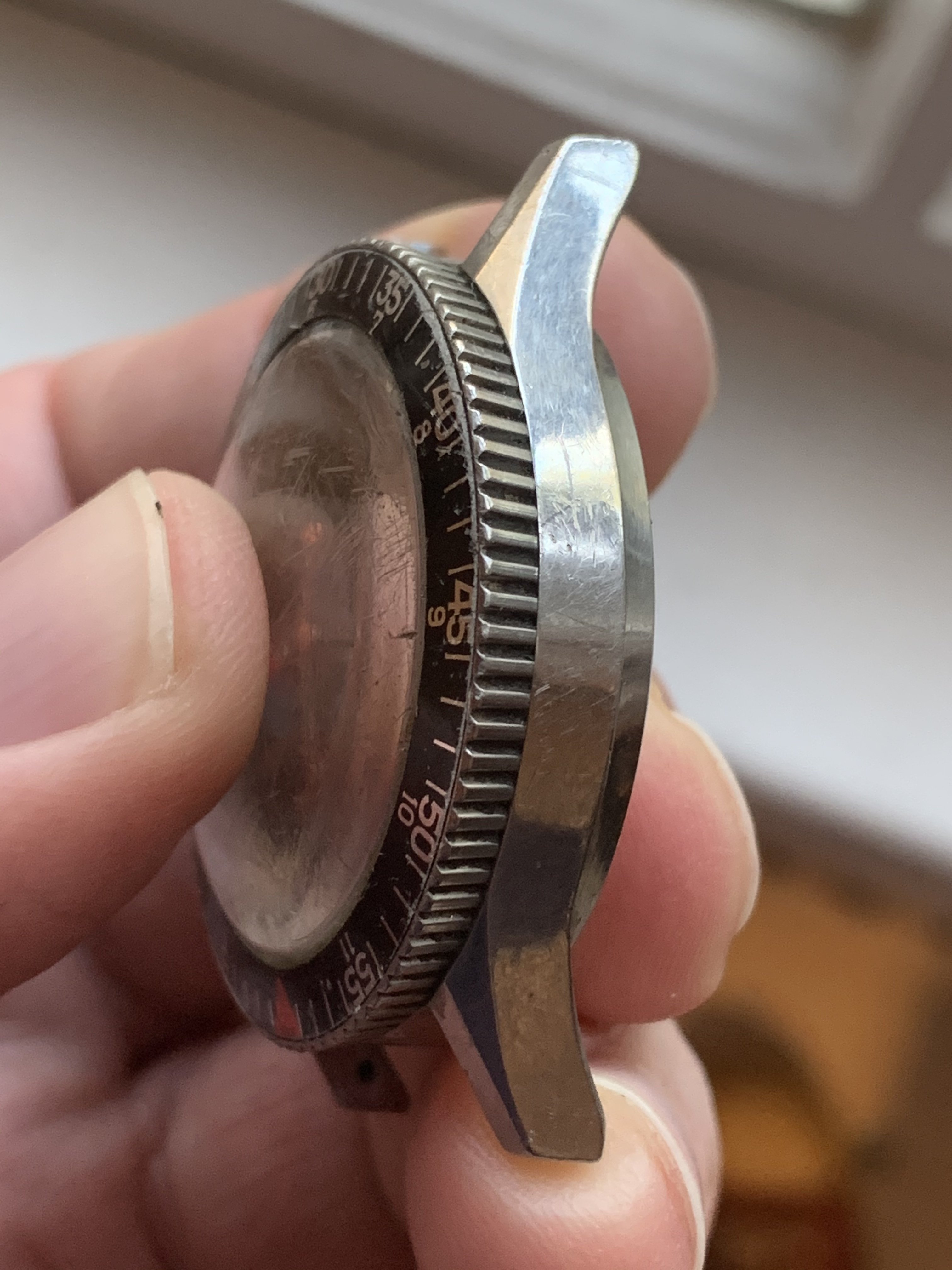

Oh- the case & crystal cleaned up nicely
This is going to be a nice watch- despite the Spray-can Menace.

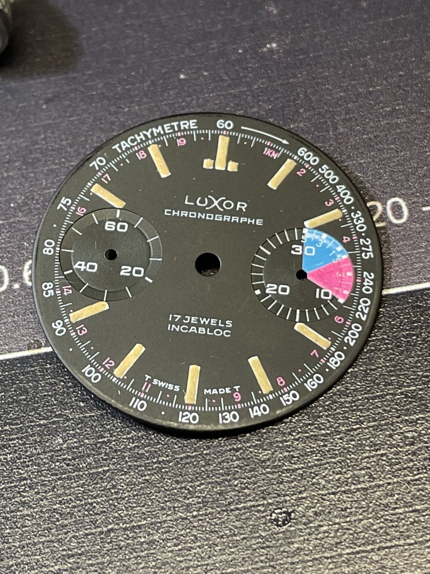

How in the world did he get that oil off the dial without damaging anything?!!
Those blue and red countdowns are primo. And all the painted numerals are so clear. I need to start spraying mine with the magical oil. (Not the lesson you hoped to teach.)
Congrats and enjoy wearing it (eventually.)

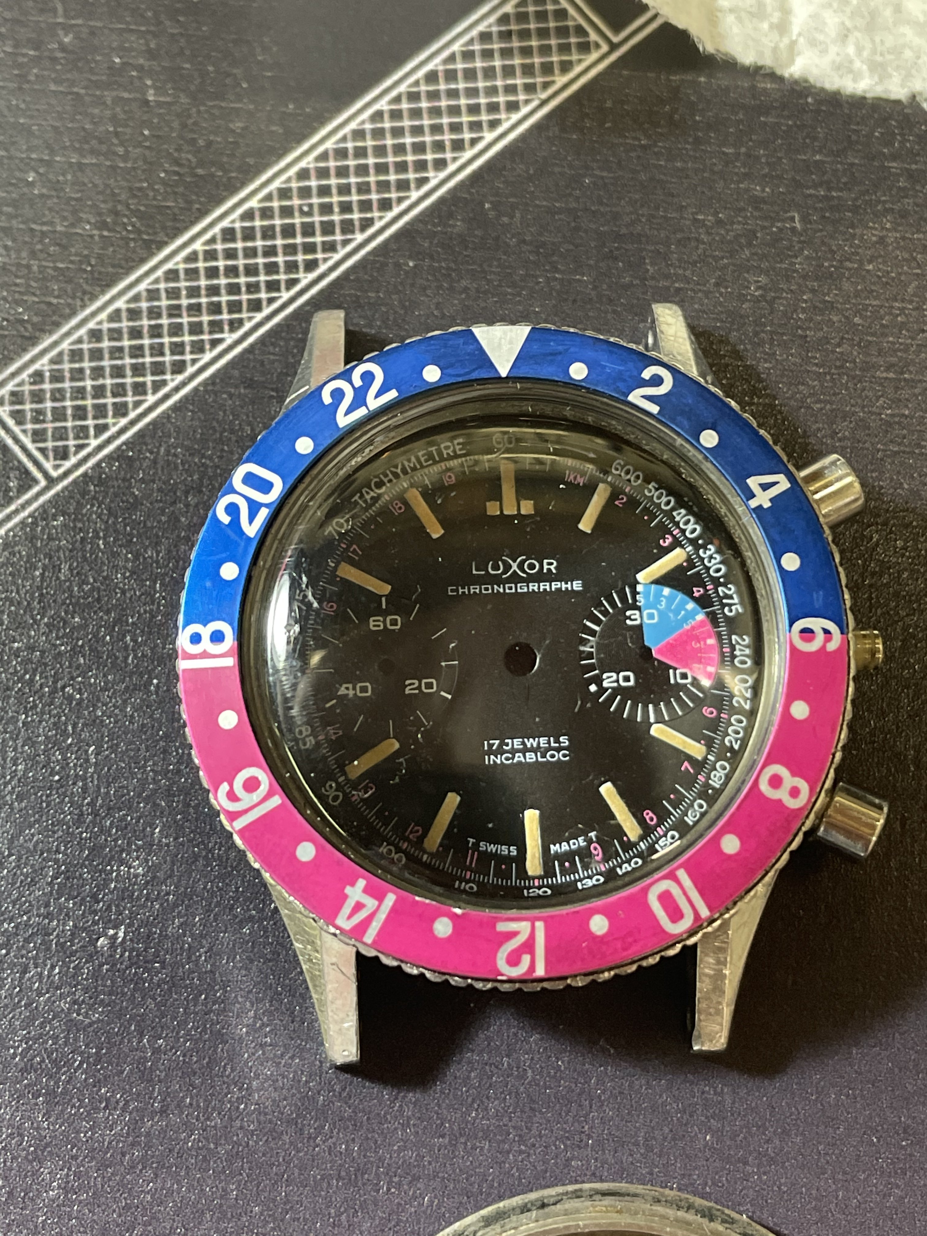

Don't stop the story was just getting good.

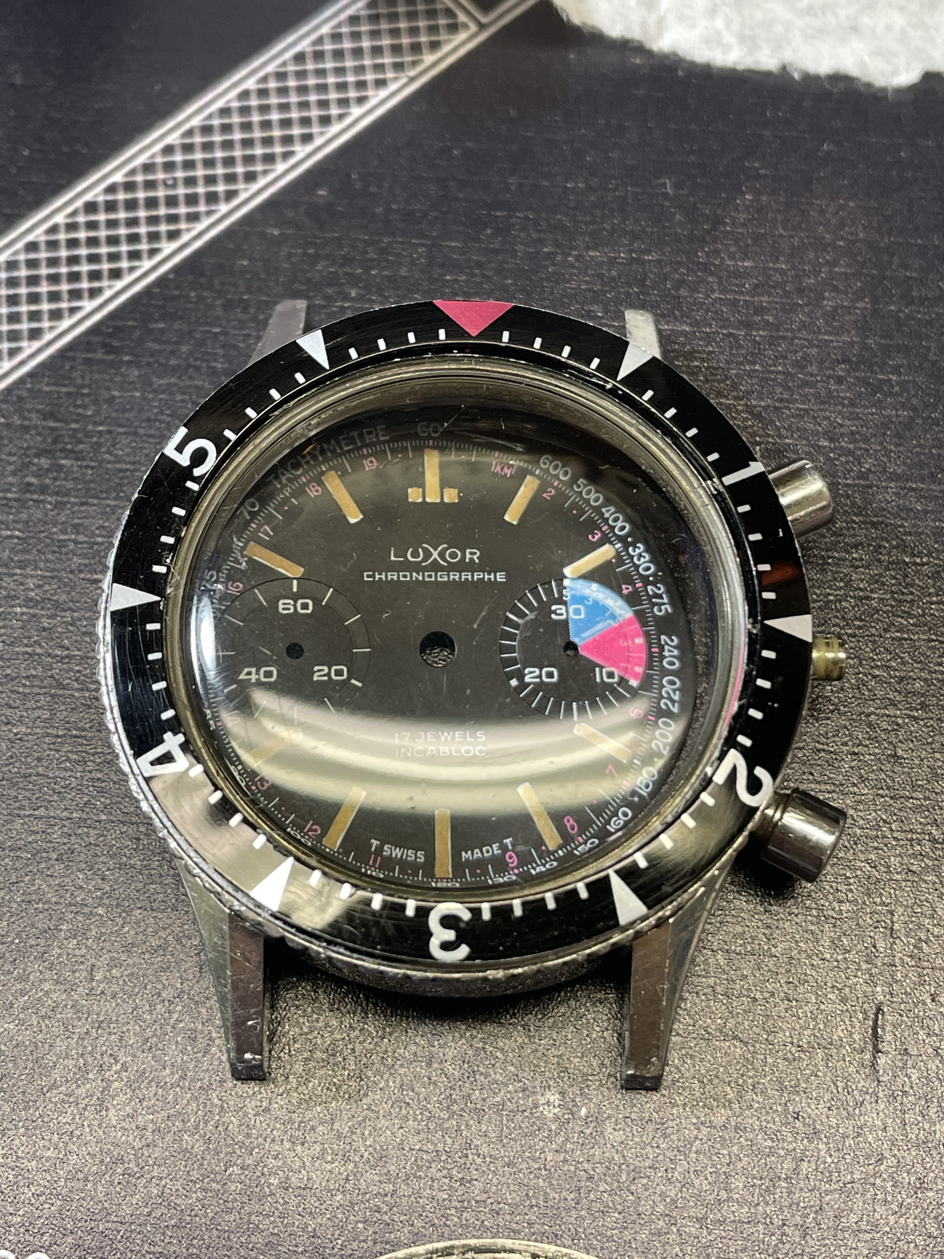

He keeps sending me pics of other bezel insert he had that he can modify to fit.
I admit, now that the crystal is cleaned up, the original bezel insert looks rather ratty
He sent this one as a joke
I kind of dig it, but it is a bit much- even for me. I have looked around for another yachting style insert but nothing I could find close to this size.
4,847
12,239
I kinda like the ratty insert, I mean if it works for @STANDY . . . The faded Pepsi gave me pause, but yeah it's too much. The other bezel doesn't look quite right for the watch IMO. Just another excuse to keep scouring the far corners of the bay. (E that is.)

Agreed. Although I have to say- the Pepsi is growing on me as a bold statement. Plus a GMT bezel can still be useful. Maybe a coke GMT bezel....hmmm
I would ideally want another identical to this, which is similar to the ones used on the Nivada/Croton’s.....anyone know of one that fits those?

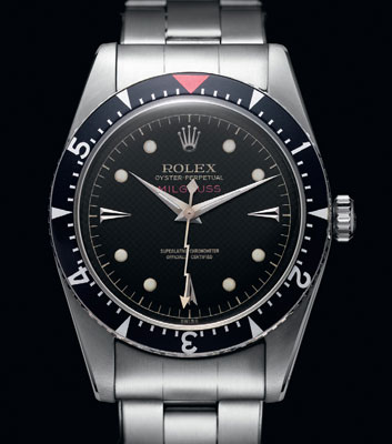

I don’t think a 24hr GMT bezel can be useful in a 12hr movement handset, but I’m here to learn...
As for the black bezel he sent: what sort of bezel counts up to 6 in apparent 2hr increments? Here extra for that...
16,305
45,011
On another thread we discussed methods of preserving a diver watch movement that was soaked with water after a seal failed.
Rinsing with clean water then drying and soaking with penetrating oil was suggested as a temporary measure till the watch could be properly cleaned and serviced.
WD40 pushes out water as it penetrates crevices. Its only real virtue.
WD40 is more of a preservative than anything else. Once the carrier evaporates it deposits a thin film of lacquer like material over everything it touches. Anything with tight tolerances will become locked up tight till cleaned with a solvent.
If the watch maker was able to completely clean and oil the movement and no corroded parts were found the oil did its job. Without the oil bath this would likely have become an unsalvageable mass of corrosion long before you ran across it.
Add a zero and it becomes minutes.
3,997
9,025
Thx; that became clearer once I saw it on a 3-hand watch. Had high hopes for something more than just a confusing design choice. (I see that they were attempting to fit the number between and preserve all of the minute indices; but boy does it give me an eyebrow twitch to see eg “50” denoted as “5”, especially since this is a rotating bezel)
Totally agree, the beauty of these watches is the nick’s and scratches they picked up over the years.
You want a pretty one buy a NOS one to start with....

Let's have a poll.
I vote for the original bezel, gives the watch character.
4,106
16,318
My vote goes also to the original bezel. 👍 Nothing worse than a like-new part on a watch that had a life.
912
4,421
Agreed. I think a nice distressed leather strap will sing on this beauty. Great story!
