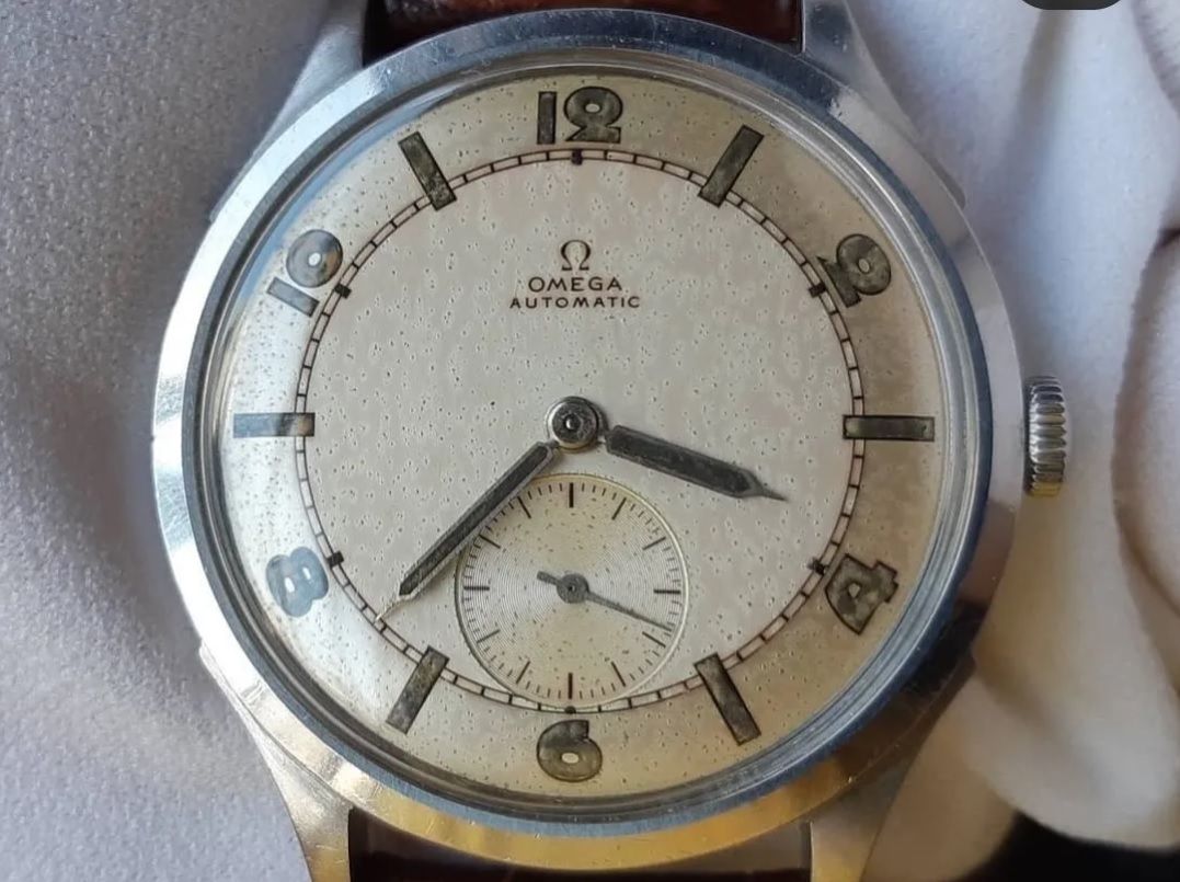

Hello once again guys. Thanks again for the space and for the earlier feedbacks on the previous pieces.

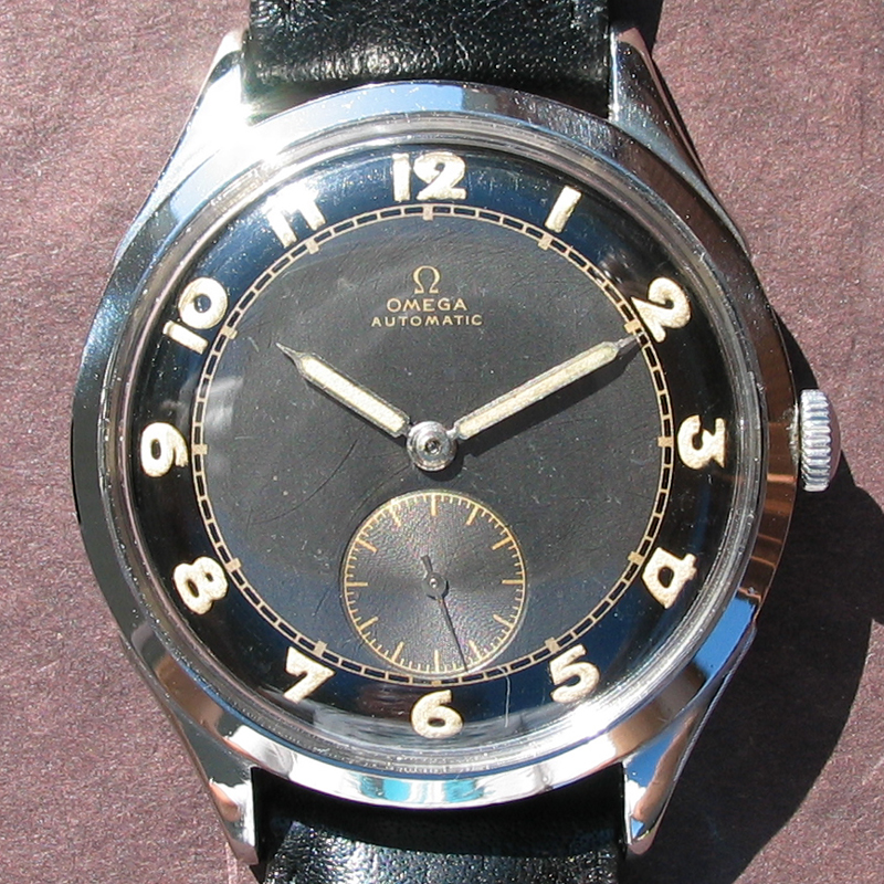

I searched throughout the forum for this reference and found plenty of material on the watch and also plenty of fotos. There is at least one member with almost the exact same reference, which has a very slightly different dial, but almost identical.
It is a steel sub second dial from the 40s. Ref. 2374-1
It seems to be in very very good condition to my eyes, talking about both the case and the dial. I am not sure about the crown but it looks identical to at least one of the watches in this thread.
https://omegaforums.net/threads/ome...mps-in-automatic-watches.113217/#post-1567036

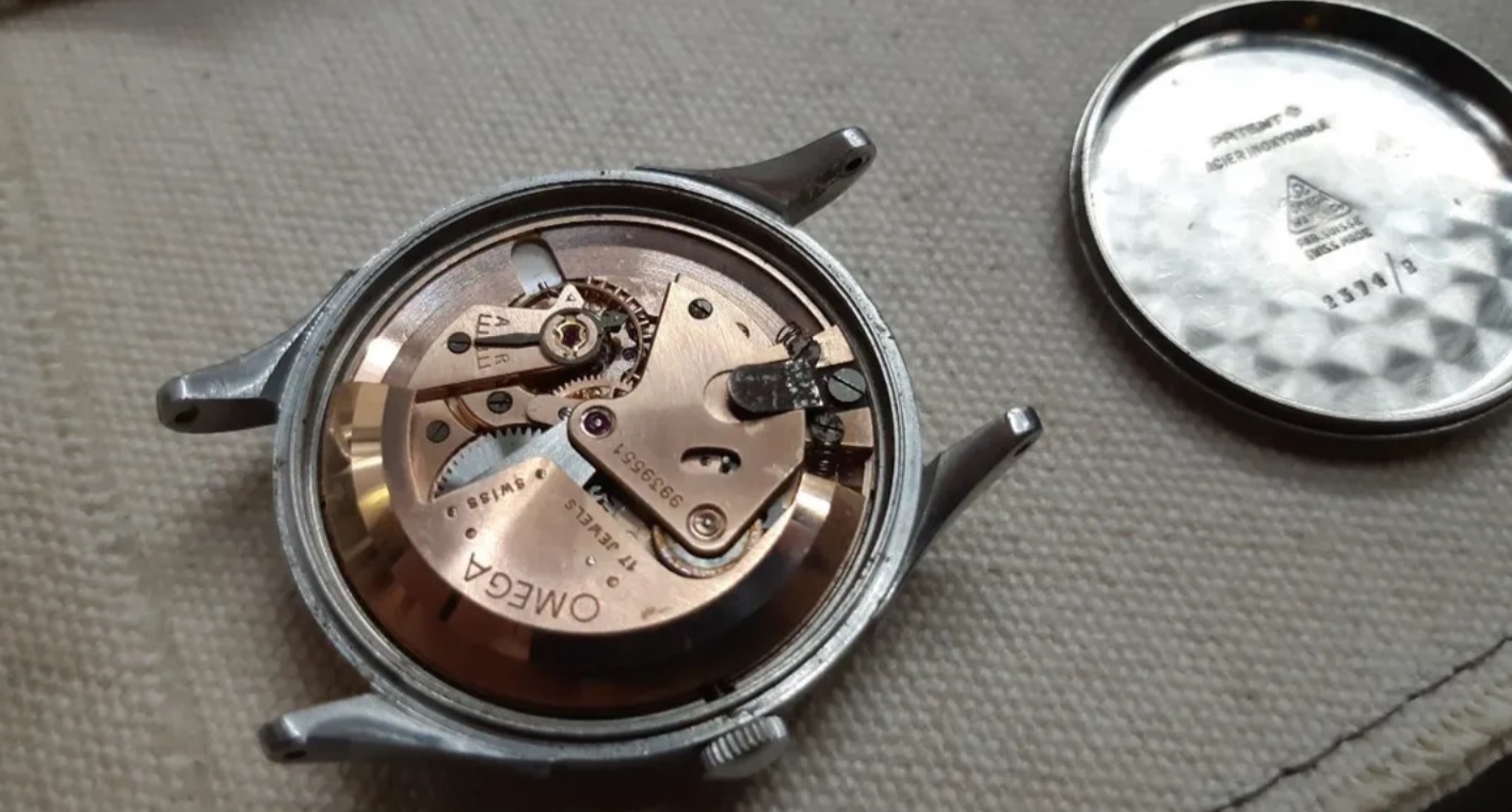

The movement also looks identical to the ones up there, being the 30.10 RA. Please correct me if the movement is not this one, as no number is written on the movement itself.
Being the case, that this watch is not a redial (it does not seem one to me but I am not sure.. O and A from Omega are looking odd to me for some reason), and the asked price is below the 500€ mark, would that be a good purchase or investment?
Thanks again in advance for the help!

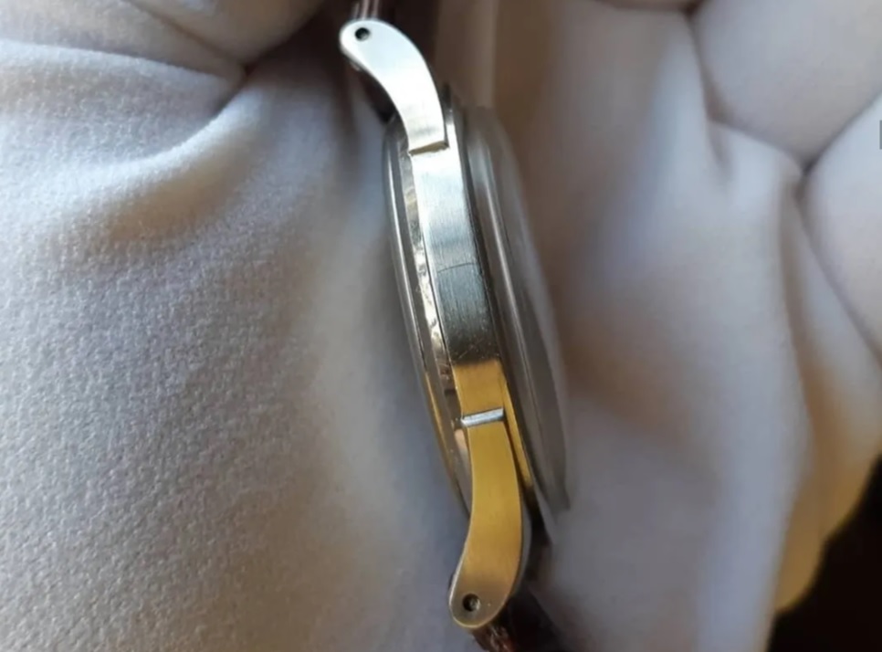

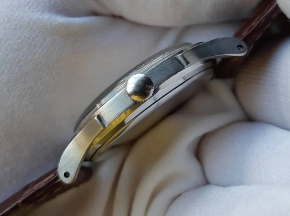

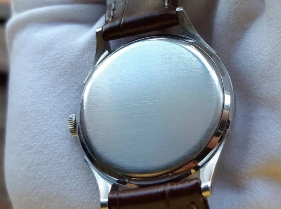

Looks good to me, the retaining ring is still there?
Do you mean inside the acrylic crystal? Or the rubber ring between the back and the movement?

No. I think he means the locking ring on the outside that holds the case back in place.

Looks like it is there in this picture.
This is a nice and fairly priced watch, but not for investment. Buy what you like and sell when you like. If you make money, great.
If you have no expectations, then you will never be disappointed.

Guys, thank you very much for the expertise and for the comments.
Regarding the tension ring, the seller, who is also a collector and not a dealer, told specifically that he also bought the watch because it was 100% the way it came from the factory.
